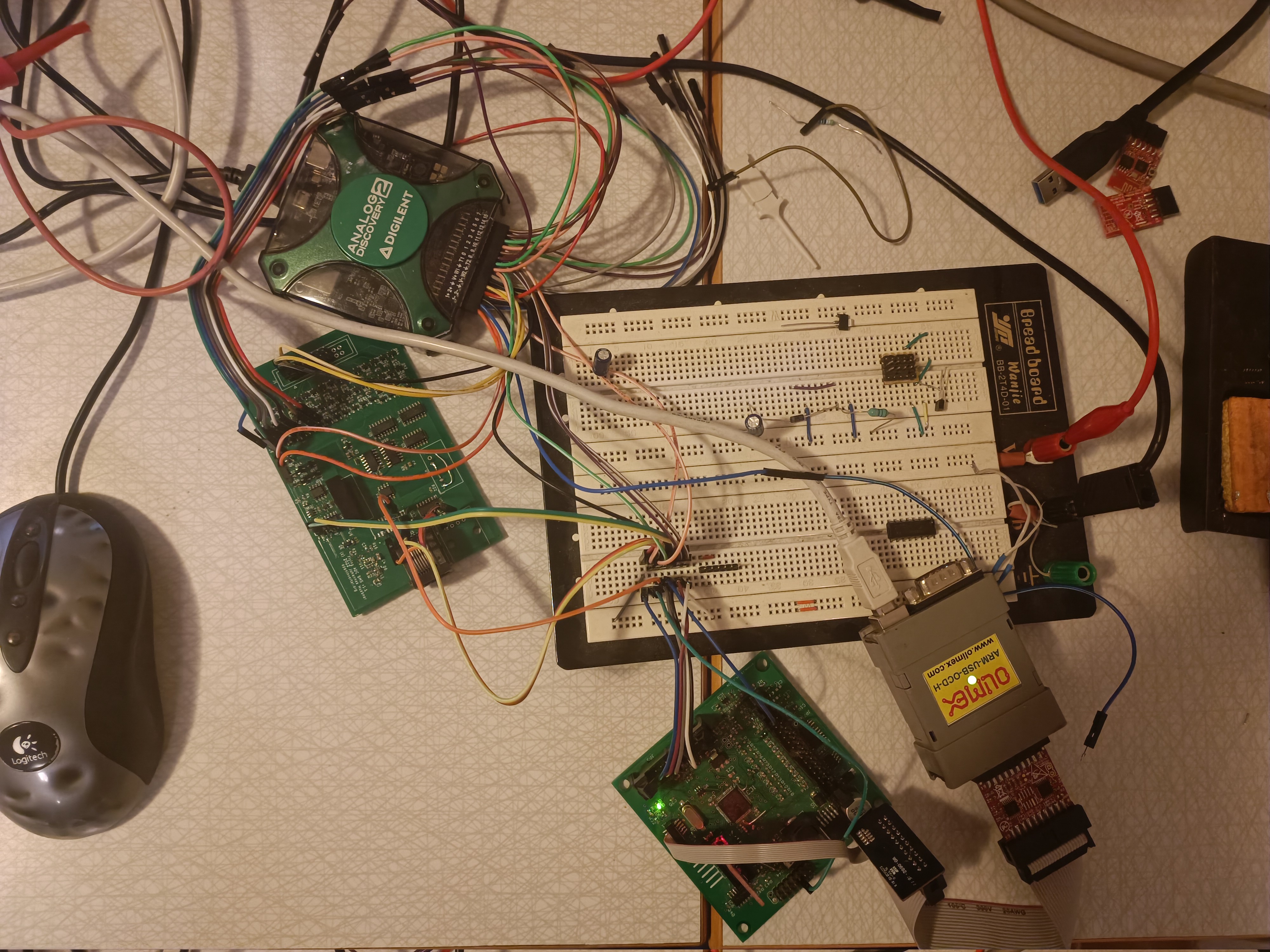

Finally had some time to work on the BMS again. I have removed all primary side logic and connected the isolators directly to an STM32.
The I2C peripheral can't be used as (it's quite broken in the STM and) SDA is split into a TX and RX line by the isolator where normally it is one shared line. Yes I could use an I2C isolator or I2C splitter but then I'm tied to some specialized (and expensive) IC again that I'm trying to avoid for resilience reasons.
So I'm running I2C with the SPI peripheral. It's pretty ugly, I have to bitbang the start sequence and address byte. Also the ACK bits need to be inserted requiring a lot of shifting. I'll also try sync serial or serial with a timer. On the other hand now that I've done the work I might as well leave it like this.

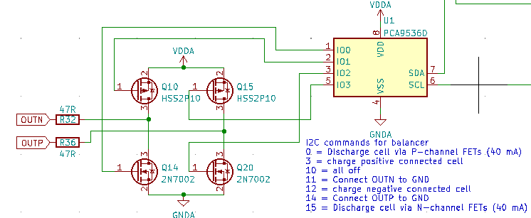

Also the balancing circuit runs nicely, I can either draw around 40mA from a connected cell or feed some (yet unknown) current to it.

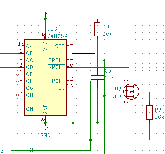

Other quirks are switching the multiplexer. I'm using the MSB for clocking the shift register to the output register. That works great when the shift register is empty but causes glitches when something is already in there. So either I'll add a dedicated latch signal (which would require a second isolator) or think of something cleverer.
Another improvement could be the attenuation for the ADC. It ranges from -2V to +2V. Remember odd cells deliver a positive voltage, even cells a negative one. So I need to divide from, say, 4.5V to 2V and -4.5V to -2V respectively. Right now I'm using a simple resistive divider (10k from both polarities and 15k across the ADC input) but it loads down the mux mosfets and slightly distorts the reading. This could also be temperature dependent.
How can I do "active" attenuation (opamp) with a single 5V supply rail?

Re: Switched ADC BMS
Glitchy mux issue solved:
QH' which is internally connected to the last bit of the shift register also provides the RCLK that latches shifted data to the outputs, as before. It means you always need to set the MSB to 1. Now the same signal is inverted and slightly delayed via a mosfet for the /SRCLR pin that clears ONLY the shift register when pulled low. Outputs remain untouched. Clearing the shift register also resets QH' so the reset signal self-releases.

Ah yes, I put a 1uF cap across the ADC now. Sampling cap if 3.2pF and impedance is 2.25 MegOhm (http://ww1.microchip.com/downloads/en/d ... 22003e.pdf). So upping the resistors should help.
To my surprise the latest measurement shows no voltage drop while it was 2mV on my first tests, without the capacitor across the ADC. Interesting.

Just started experimenting with the mux actually cycling. So 1uF doesn't work as there is always a polarity change between adjacent channels. Of course the sequence could be changed. Anyway, It takes a long time for the new value to settle. Now I put in 1nF because that's all I have in my limited exile lab. Now edges look nice and sharp.

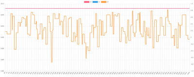

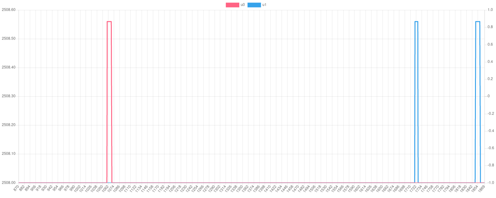

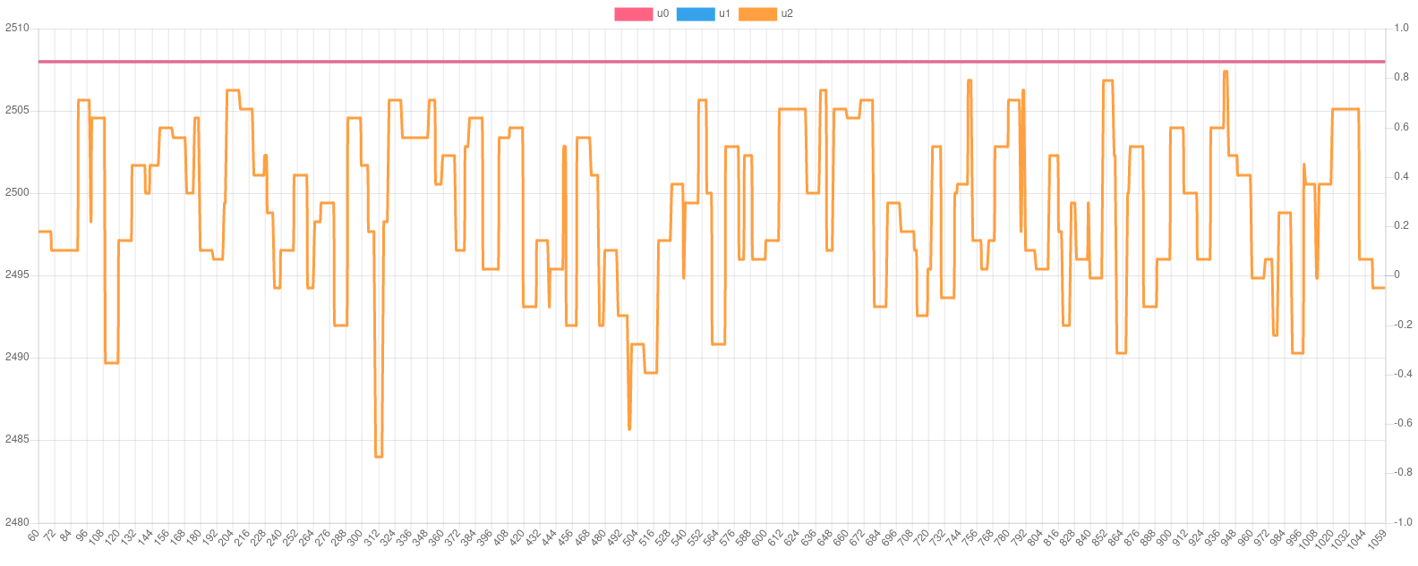

Here is a plot from 14-bit, 60 SPS mode
I set Analog Discovery to generate 2.5V and 5V. As you can see it is rather stable and only jitters 0.5mV.
I can add my SMPS as a third voltage but it jitters quite a bit.
Still useful to test the balancing feature, that's how I know it draw 40mA.
Also connected a camera battery to the 1st channel so I could actually put some energy into it. Current draw on the DC-DC converter rose by around 20 mA, so only putting in like 15 mA or so. It is via two 47R resistors, so (5V-3.8V)/94=13mA -> adds up. Maybe I could use some lower value resistors to make this a bit more effective.
Voltage reading was also dead stable. Of course as soon as you run any balancing the reading becomes useless. So balancing must be released from time to time to get a valid voltage reading.

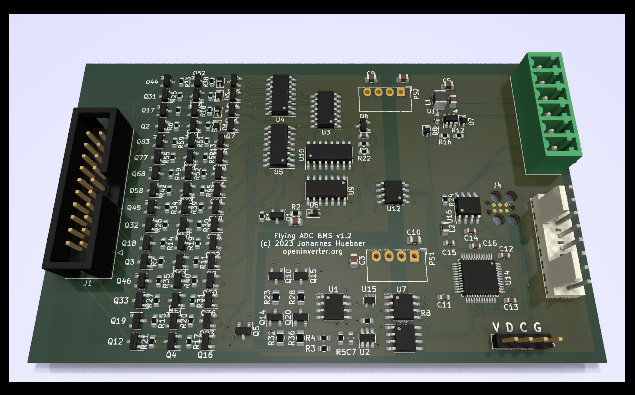

I have added programming headers now and am running out of space for current and temp sensor connector:
So I might get rid of the RJ45 connectors and do screw or crimp terminals instead
3.81mm Phoenix for connections going through, can be combined with screw or clamp terminals. Current and temperature sensor via Molex.
Could make the cell tap inputs single row Molex as well

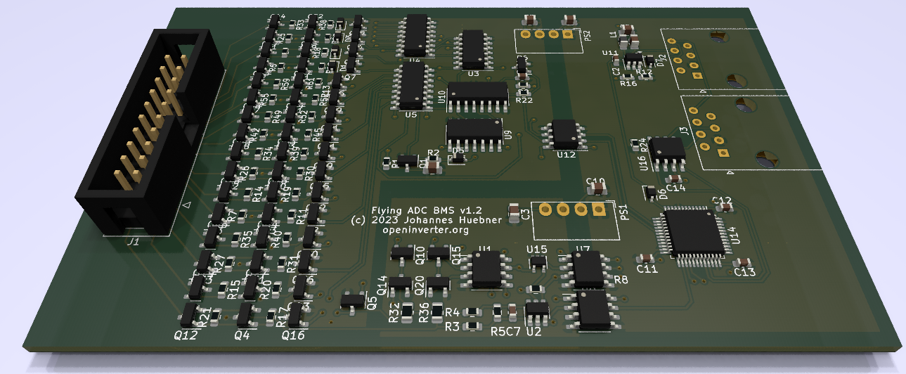

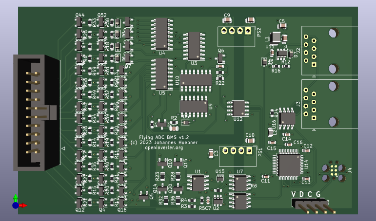

Another early forum release
Just had 10 of these quoted at JLC and they go for around 20€ each without connectors and shipping

Post by JockE28 »
Oh, one more thing that my brain is trying to understand.
Once you bleed one cell, this will go to waist through a resistor. It can't be used to another cell that needs it?
Forgive me for being a slow learner 😊
Been thanked: 1918 times
JockE28 wrote: Sun Jan 08, 2023 9:02 pm Once you bleed one cell, this will go to waist through a resistor. It can't be used to another cell that needs it?
I thought about placing an elcap on there and then rapidly switch between a cell that has excess charge and one that has too little. But there is so little charge being transferred that I dropped this idea. You could still have a strategy where you only ever charge low cells and never bleed any. Then energy would be transferred from the whole pack through your DC/DC converter into low cells. But it's not like there's a whole lot to gain...
