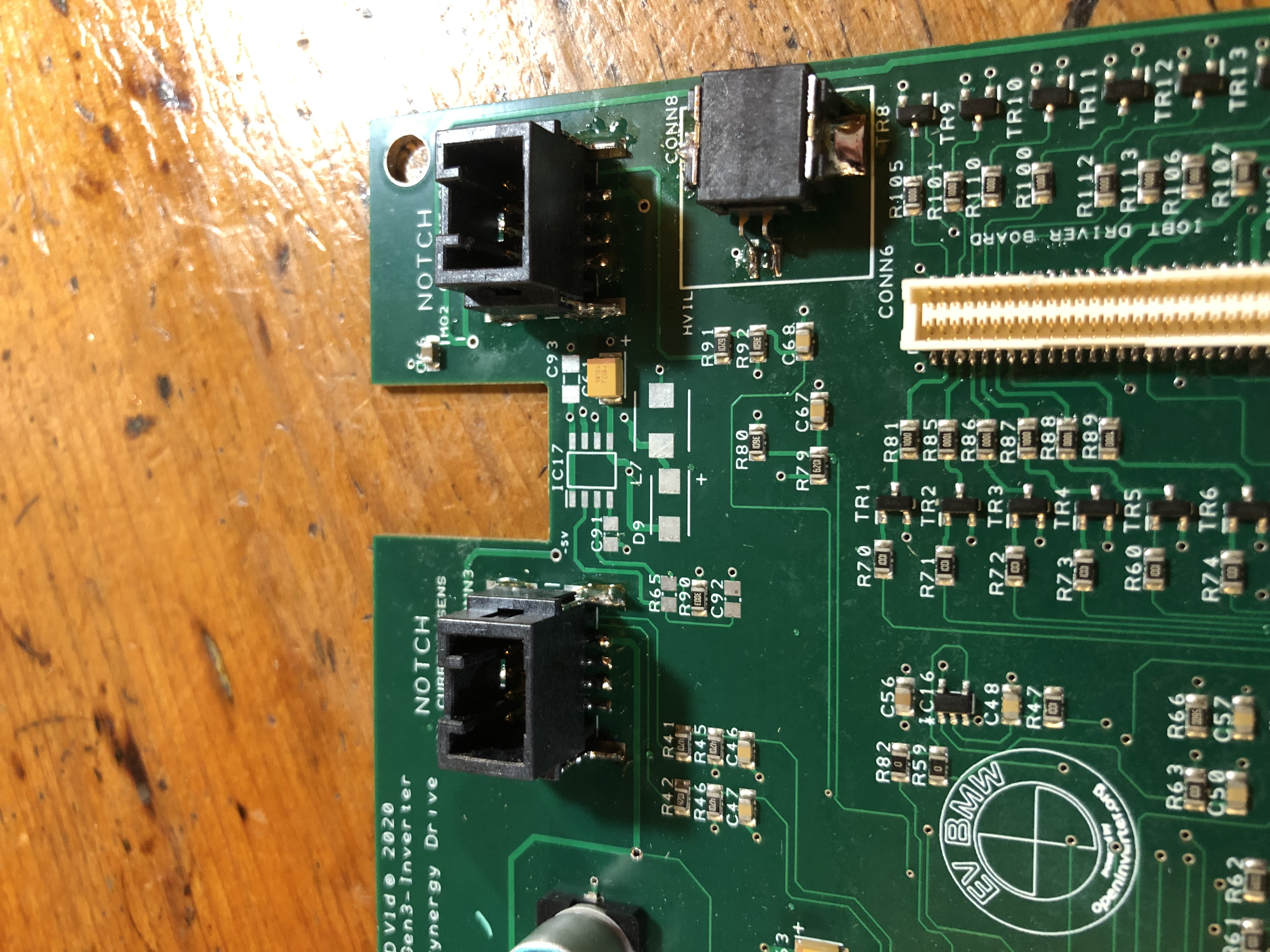

Re: Prius Gen 3 Dual Motor Logic Board Support Thread
Hello everyone,
I bought a Block 4 V1d board from Damien a little while ago, and am currently soldering it up.
It came with some pieces unplaced which I am tryying to track down: I need IC17, C93, C91, D9, L7, R65, C92, and also L5 (this one could have fallen off when I was soldering the 90 for the wifi module next to it).
I know that C93 should be a 47uF 0805 6.3v ceramic cap
But for the others I could only find the BOM for the V1c on Patreon and on the github page.
I believe these parts could be determined from the schematic, but I am not familiar enough with design files to do this.
Wondering if anyone has the info for these parts or can steer me in the right direction?
Also, my board came with the Atmega 328p unpopulated, is there a certain orientation in which I should install this?
Thanks in advance!

I saw the V1c B4 files Damien released, from which I can determine the L5, L7, and R65 (should be the same parts for my V1d right?) but the V1c BOM did not have the info for IC17, C93, C91, C92, or D9. Wondering if anyone can help with these.
Thanks!

It's helpful when asking questions, to do as much work as possible for the people helping you. If you can't get the answer, do everything you are able to do, so it saves everyone time. Set it up so it's as convenient to answer your questions as possible. I.E. If you're referring to something, link it so they know exactly what you're looking at and exactly what you're stuck with. Then they have confidence to know you're both on the same page, and, since you can't solve your own problems, you at least put the convenience work in so it's as easy to help you as possible. I say that as someone who needs help a lot more than I'm able to ever help anyone else.
For example, I spent some time digging around Damien's webshop, I think I found the correct Github, I think I found the right BOM... I did a quick scan, didn't find it, and I'm already kinda hit the "I'll just do a quick check and see if I can help" limit I was going to spend on this. I'm not sure if I'm looking at the right thing so I'd feel dumb putting work in and it's not relevant. Also, there's a slim chance I'm able to help anyways.
If I was in your shoes, what I would do is open up the schematic, take a screenshot of it, find all the components you're missing, draw red circles around them so they're lightning-quick for everyone to find. Then upload that image on IMGUR or somewhere, link the file directly in your post, so anyone casually reading can see exactly what you're struggling with without even clicking on anything.
At minimum, that should get you your component values. Then you only have to figure out the context of the component (i.e. what type of capacitor, diode, etc).
I've been in exactly these shoes on a BOM (which is why I probably can't help). My advice is what I should've done at the time too, and didn't.

Most of this info appears on the schematic. C91 82pF, C92 10uF, IC17 MAX735CSA+, L7 10uH MWSA0503-100MT, D9 SS54B, R65 130K, L5 MH2029-300Y.

Thank you for this advice, I will certainly use it in the future.MattsAwesomeStuff wrote: ↑Thu Nov 24, 2022 8:37 am It's helpful when asking questions, to do as much work as possible for the people helping you. If you can't get the answer, do everything you are able to do, so it saves everyone time. Set it up so it's as convenient to answer your questions as possible...
Thank you for the help, I wasn't sure where to look, but from this info I was able to deduce what I should be looking for on the schematic. I found parts that I think should work for all of the open locations on my board; in a couple weeks when they arrive and I have time to test them on the board, I'll post what parts I found that work in case anyone else is having the same issue.
