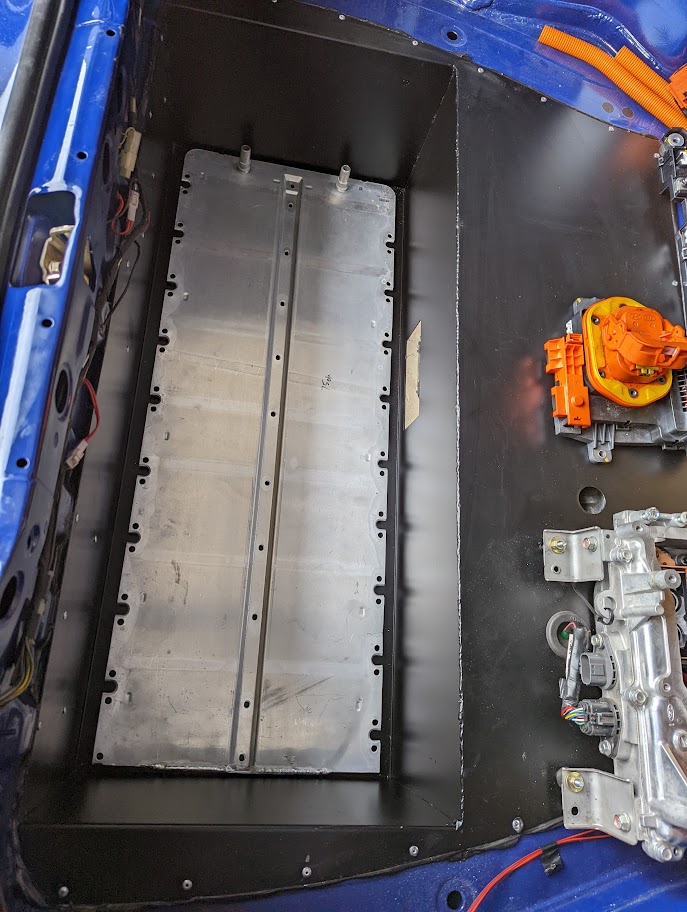

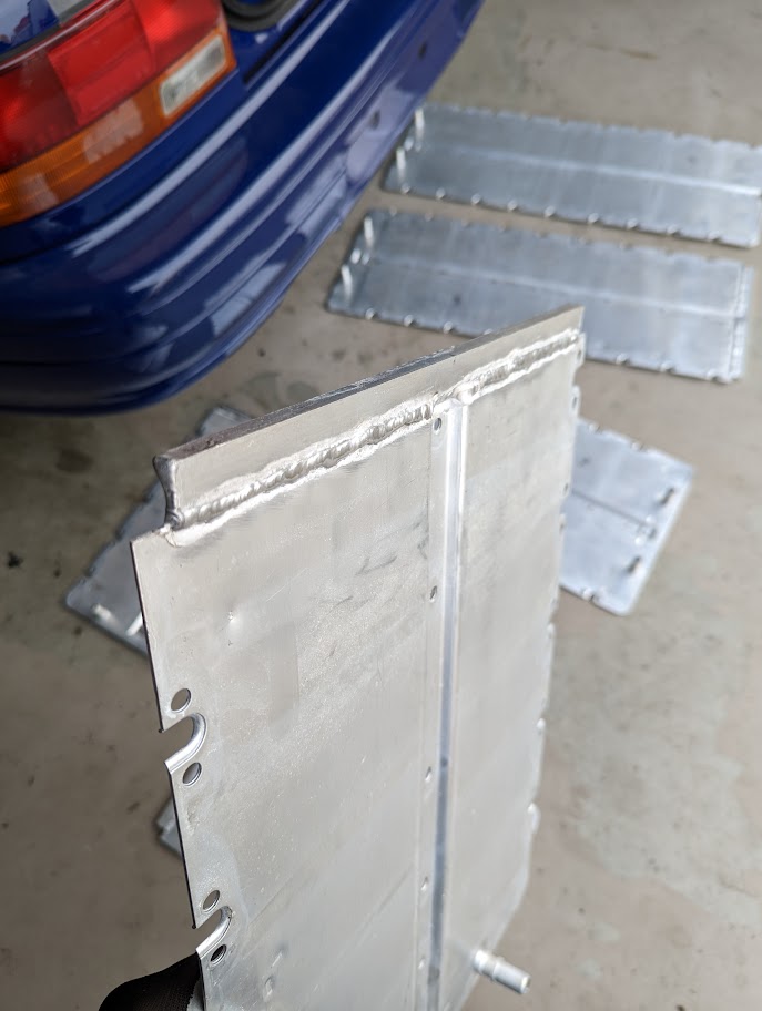

The cooling plates are welded now.
First i made end pieces out of a standard u shaped aluminum profile:
Then they have been welded on the end of the cut cooling plate, so the water can circulate again:
Fits nicely in the Box!

Nice work! But are you sure this works? Looks like the flow is quite limited by the deformation in the middle? Very cool how you shaped the U but I would have expected that in the middle you close that dent in the front. Maybe it's the picture fooling me, can't see the dept.
Just to help you ok?

EV_Builder wrote: Thu Oct 06, 2022 9:01 pm Nice work! But are you sure this works? Looks like the flow is quite limited by the deformation in the middle? Very cool how you shaped the U but I would have expected that in the middle you close that dent in the front. Maybe it's the picture fooling me, can't see the dept.
No i'm not sure this works :idea: , but the picture is irritating ;) Its just the front that's bend down, in the rear it's still all the way open. They have been pressure tested at 2 bar, but no flow test have been made. I checked resistance by blowing air through them, which worked very good. I'll try with water next.

Ah ok...you could improve flow by welding U shaped round tube on the top. Over the middle part. Another option could be to add 2 90degrees elbows with some hose if you have wall thickness for thread.
