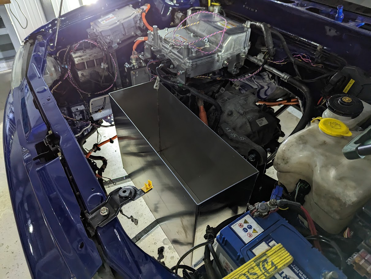

Hi fellow enthusiasts,
i'm restoring a 1996 Impreza Turbo 4WD at the moment and from the first moment i had the thought to build it electric. Now due to the rising costs of Gas the thought came to my mind again and i would need some advice. As the car is totally torn apart all options are open at the moment.
I was thinking:
Kona 64 KwH Battery
Front 80Kw Outlander Differential with Motor and Prius Inverter
Rear 80Kw Outlander Differential with Motor and Prius Inverter
I3 LIM for CCS capability
Custom VCU with help of Johannes.
Will 2 Motors at 80kw add up to exaktly 160Kw of power or is that not the case?
The car should have a at least its original Power wich was 155 Kw.

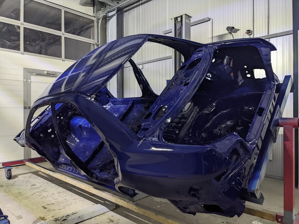

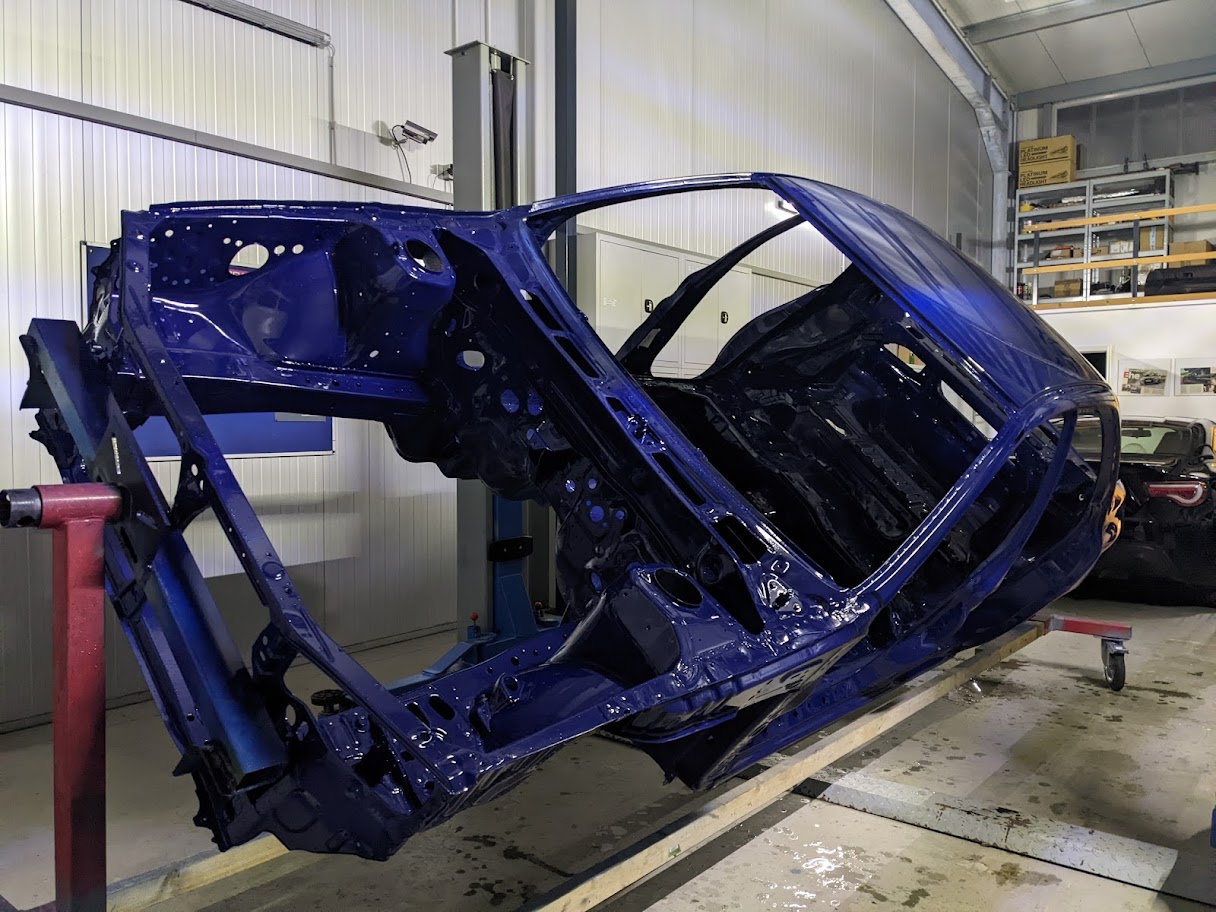

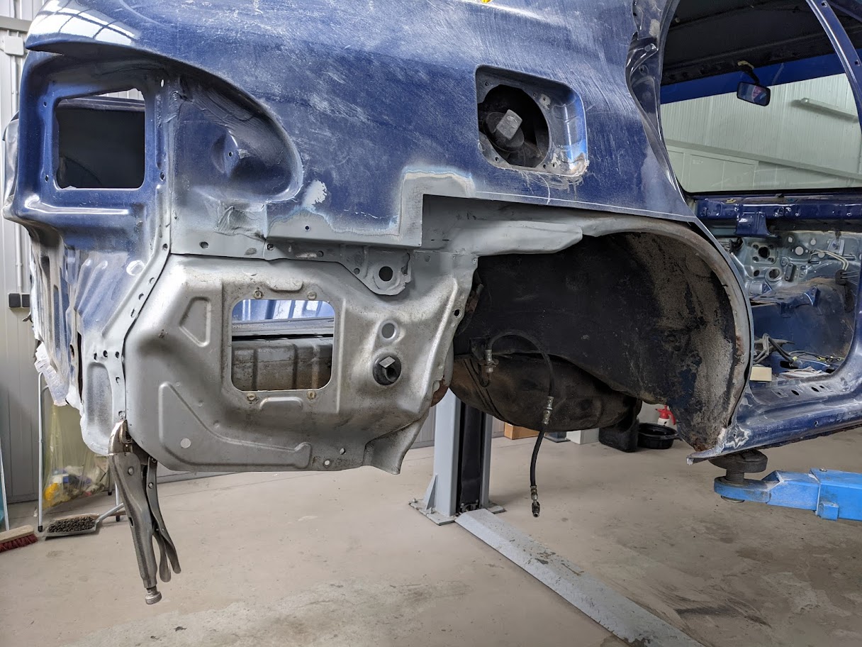

I repaired the body entirely and removed all rust, welded new panels in That's what it looks like now. Unfortunately one part is not fitting correctly so i have to paint it again anyways. That means i can still do intense modification to the body, if necessary, such as make room for the battery or the rear motor.

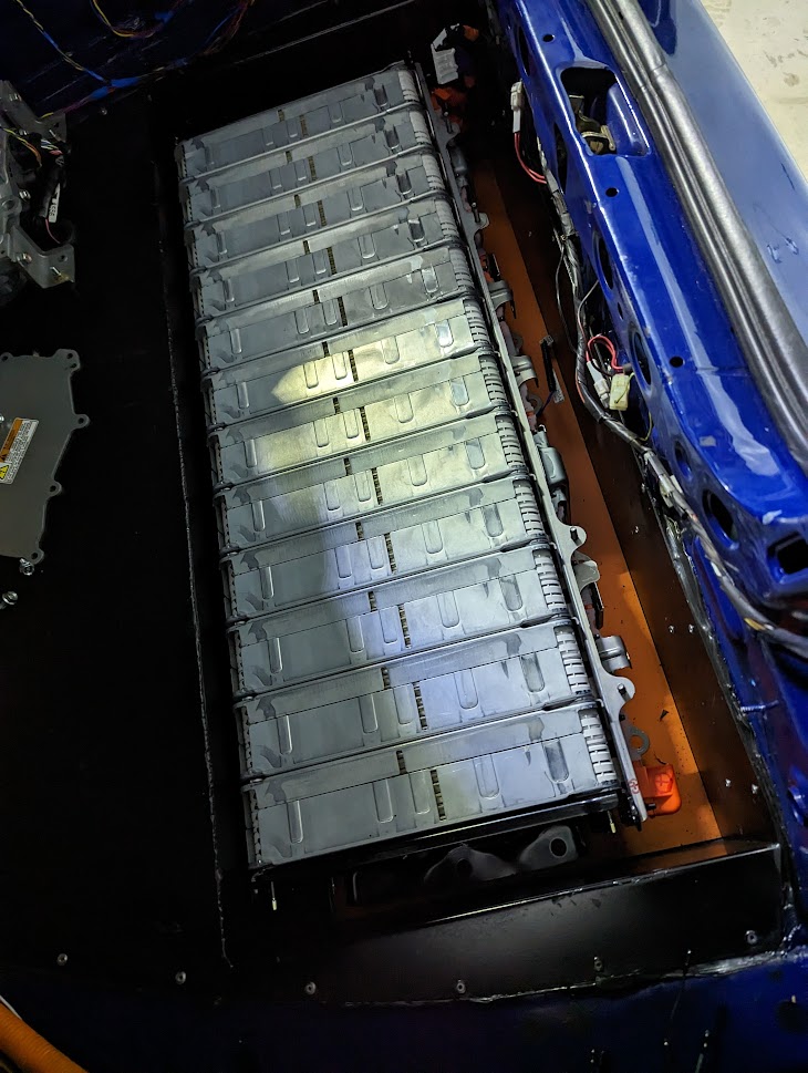

Kona 64 KwH Battery

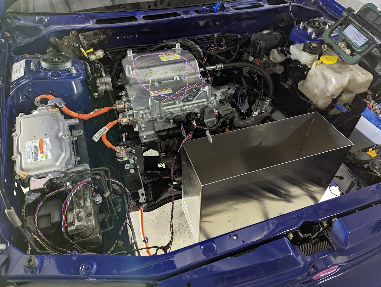

Now i'm bidding on a 64Kwh Kona Pack and also 2 Outlander Motors with Differential. That means i only have to sort out wich Inverters i'm going to use. The Prius-Inverter would actually be more expensive as i have to buy the inverter and the drop in board. So i think i'll try the Outlander inverters. From which model year on would they have 80Kw for sure? 2015?

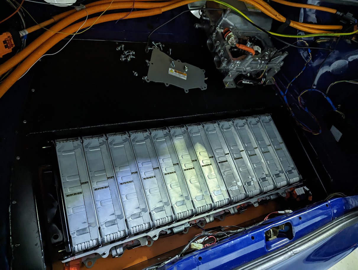

So the part list tends to look like this:
- Tesla Model 3 PCB with evbmw board as 10kw charger and DC converter
- 2 outlander motors with inverters
- evbmw Zombieverter vcu
- I3 LIM for CCS
-Kona 64kwh battery
-prius power steering
-Prius or GT86 pedals for analog brake and accelerator
The result should be a 250km range and fun to drive vehicle that charges rather quick and everywhere.
Does anyone has further suggestions?

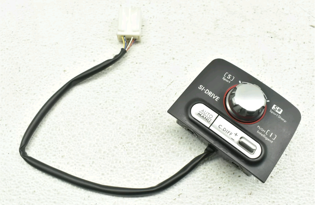

You could make it selectable RWD/FWD/4x4 by pulling to GND RSDN line on each of the inverters by selection disabling inverter in turn...Zapatero wrote: ↑Wed Mar 09, 2022 9:44 pm So the part list tends to look like this:

Re: Subaru Impreza 96 - AWD with 2 Outlander rear motors
Yes, cool idea to make it possible to choose whether or should be fwd or rwd! And also I'll find out if there is a hardware limit but o think arber333s knows what he's talking about

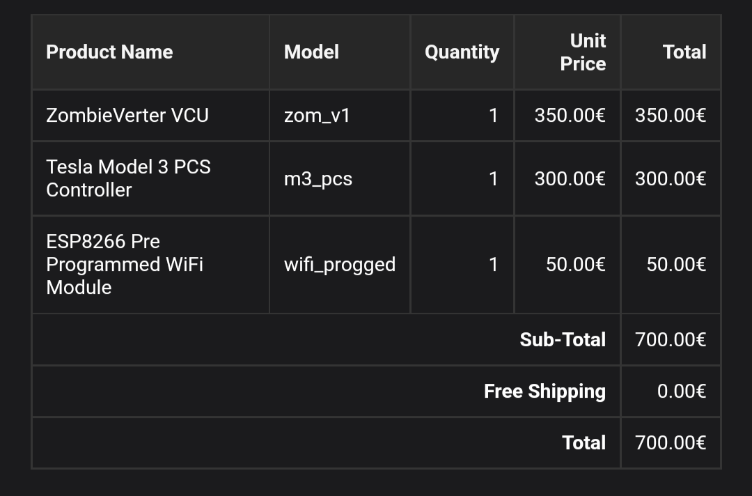

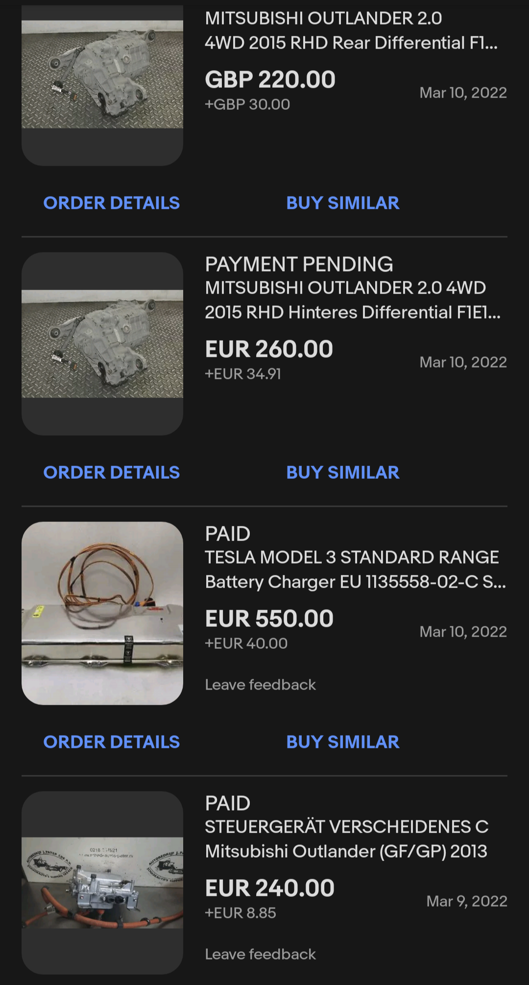

I've bought a lot of stuff already:
Also the web shop order for the evbmw parts will be ordered today! Then I need just another rear inverter and the battery. Also Prius power steering and pedals.

I can't find the link for the housing of the Zombieverter VCU. Probably I'm just too blind. Can someone help me out?
Also I'm confused. Could the Zombieverter control the Tesla PCS too and my order of the control board for the PCS was unnecessary?

I always wanted to have a “gear selector” that just changes the torque balance between front and rear. Manuel torque vectoring. As you enter a corner, start pulling the lever back to make it more rwd, and as you exit push it forward to make it more fwd.

I'm using this selector of a 2010 Impreza STI.
The parts for the project are mostly aquired:
2 outlander motors with gearbox
2 outlander inverters with all HV cables
1 BMW CCS charging cable complete with everything
1 BMW CCS LIM
1 Prius Power steering with ECU
1 Prius gas pedal and for the brake the just the sensor, with plugs and cables
1 Tesla charger and DC DC
1 Isabellenhütte shunt 1000A not terminated
1 Zombieverter VCU with housing and cables
1 Impreza selector switch
And a few other parts like molex connectors, cables etc.
Got my hands on the Kona battery pack, but prices seem to rise rapidly at the moment.
