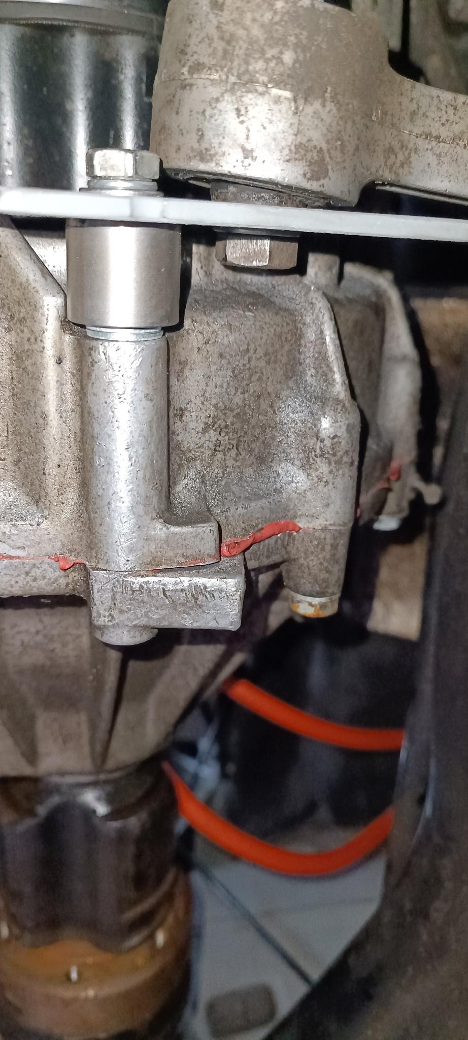

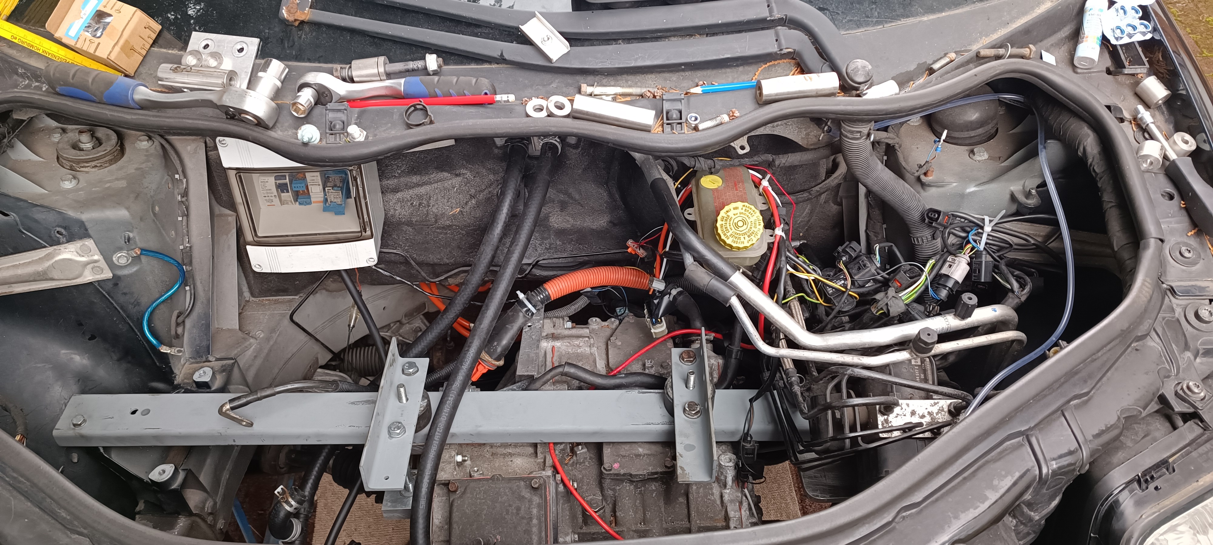

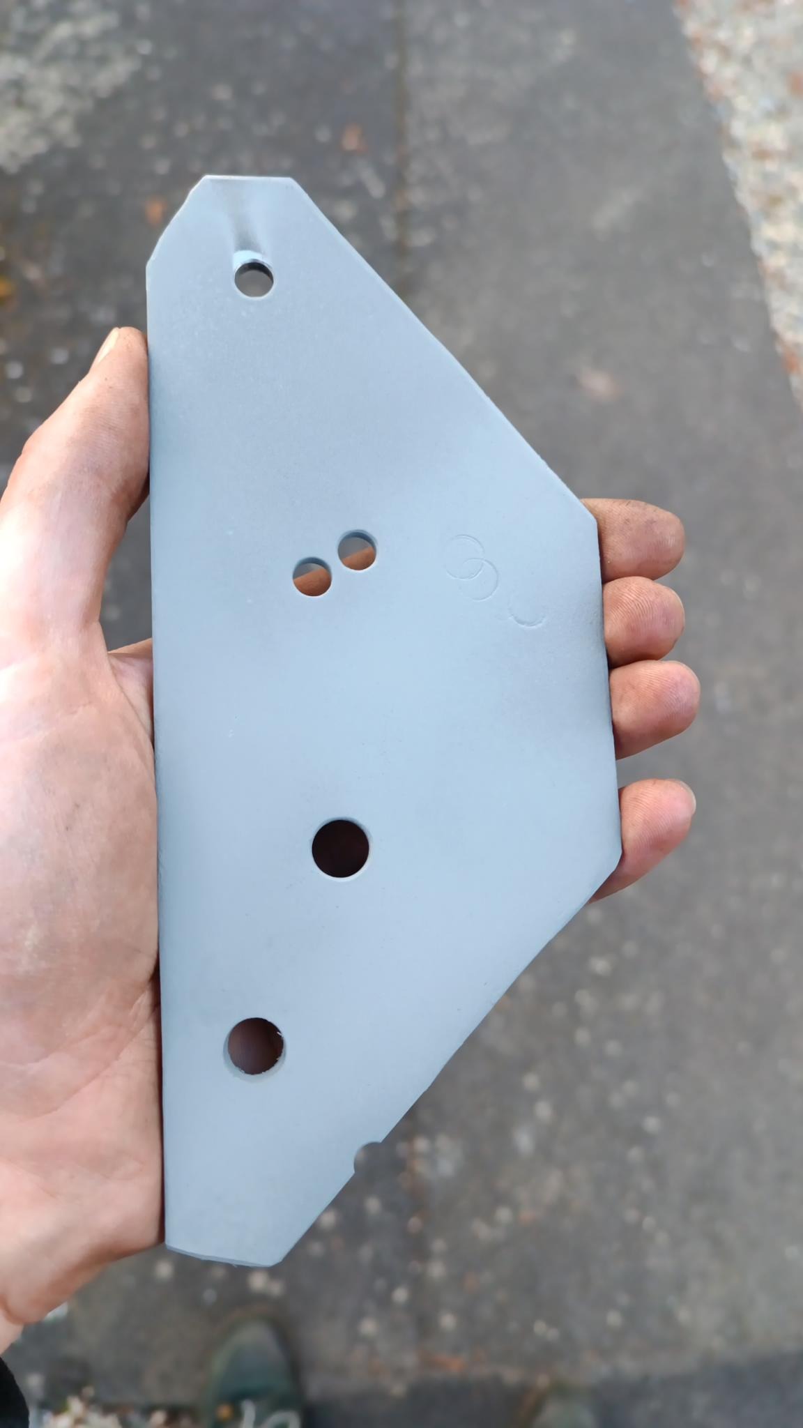

Finally some more progress to report.
Thomas, the owner of the Audi, came to visit for 3 days. Our main task was to move the transmission further backwards to straighten out the driveshafts.
In order to move it backwards, we also needed to move it to the left to avoid the steering column. Moving to the left meant the driveshafts would no longer fit. But then my genius neighbour came around and asked "what if you swap the drive shafts right to left?" And indeed, the length difference turned out to be only 70mm. So swapping them meant we could move the transmission 70mm to the left. And that meant we could move it backwards by up to 80mm. Winner!
The setup looks a lot neater now. We gained enough room in the front to fit the stock radiator fan (needed for A/C) and it's just generally less crammed.
We left off with everything back in place except the torque arm. That will need some parts machined.
Also the left hand (as on photo) mounting of the cross member will receive another bracket to use the other two bolting points.

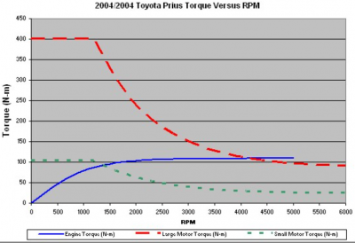

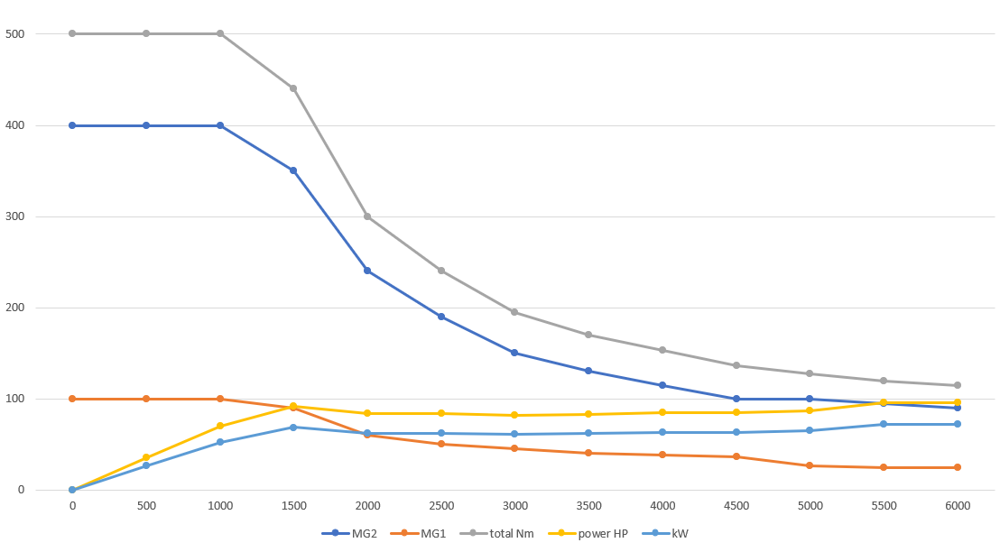

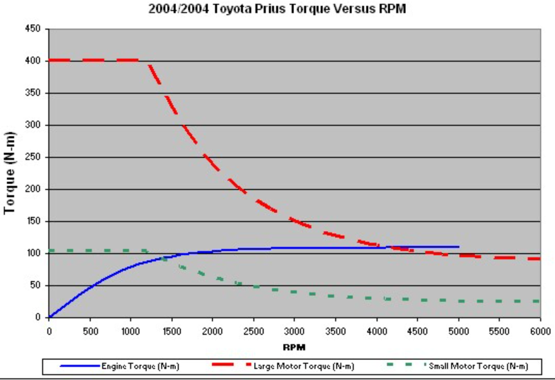

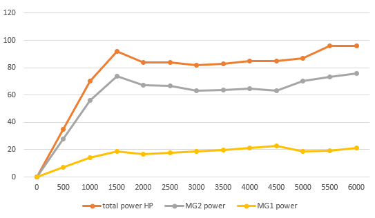

Re: Audi A2 /w Prius Gen2 Transaxle & Inverter
From this site shared previously:johu wrote: ↑Mon Nov 14, 2022 1:07 pm I'm not writing it off even with just MG2. Of course 28 kW isn't very performant but as a small commuter car it'll do. Heck, people used to drive around with 15 hp. Also the motor is barely heating up, so we're not pushing it here.
On a side note I'll do a first TÜV visit on Wednesday.
http://roperld.com/science/Prius/PriusPhysics.htm
Using this Torque/RPM graph I 'roughly' converted this total Nm (MG2+MG1) to power/RPM graph.
You can see constant power region from 1500>rpm is around 95hp - 70kW! Splitting out the 'approximate' power curve of MG2 and MG1 - MG1 can contribute 25-30% additional power so is an substantial benefit.

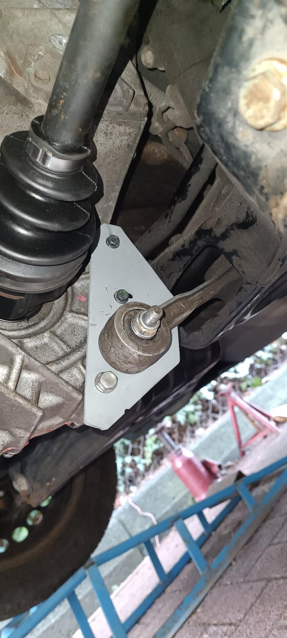

New torque arm connection
Rubber bushing gets a bit of a bend but think that'll be fine
