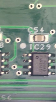

That all looks sensible. Last question. Can you please take a high res photo of the ICs you fitted to the board.

Just need a few pictures of the ics fitted by yourself.

As requested

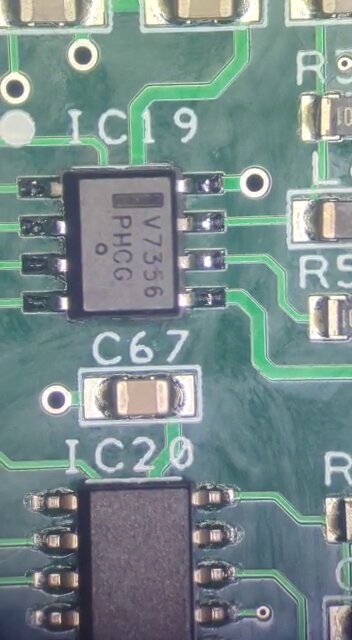

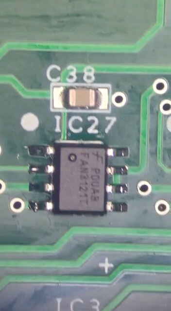

Also IC27,29 and 19 please.

As requested

IC19

That all looks perfect thanks. There seems to be no obvious reason other than a wiring error to cause this problem. I think next step is to get the board back to me for a deeper look.

I got the VCU board back from Beemer. A Fan3121 has been fitted in position IC12 in place of the NCV8461. This kit would have shipped without the NCV8461 in any event as they were not available until about a week ago. This would have fed 12v into the 3v3 line and destroyed the microcontroller as well as most other devices I would imagine. Whoever fitted the parts failed to verify the positions on the schematic and BOM for IC12.
