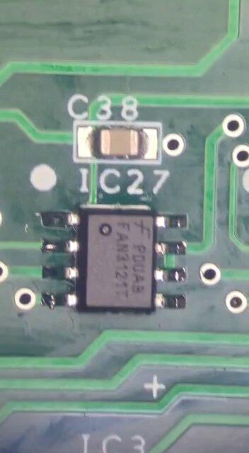

That all looks sensible. Last question. Can you please take a high res photo of the ICs you fitted to the board.

Just need a few pictures of the ics fitted by yourself.

That all looks perfect thanks. There seems to be no obvious reason other than a wiring error to cause this problem. I think next step is to get the board back to me for a deeper look.

I got the VCU board back from Beemer. A Fan3121 has been fitted in position IC12 in place of the NCV8461. This kit would have shipped without the NCV8461 in any event as they were not available until about a week ago. This would have fed 12v into the 3v3 line and destroyed the microcontroller as well as most other devices I would imagine. Whoever fitted the parts failed to verify the positions on the schematic and BOM for IC12.

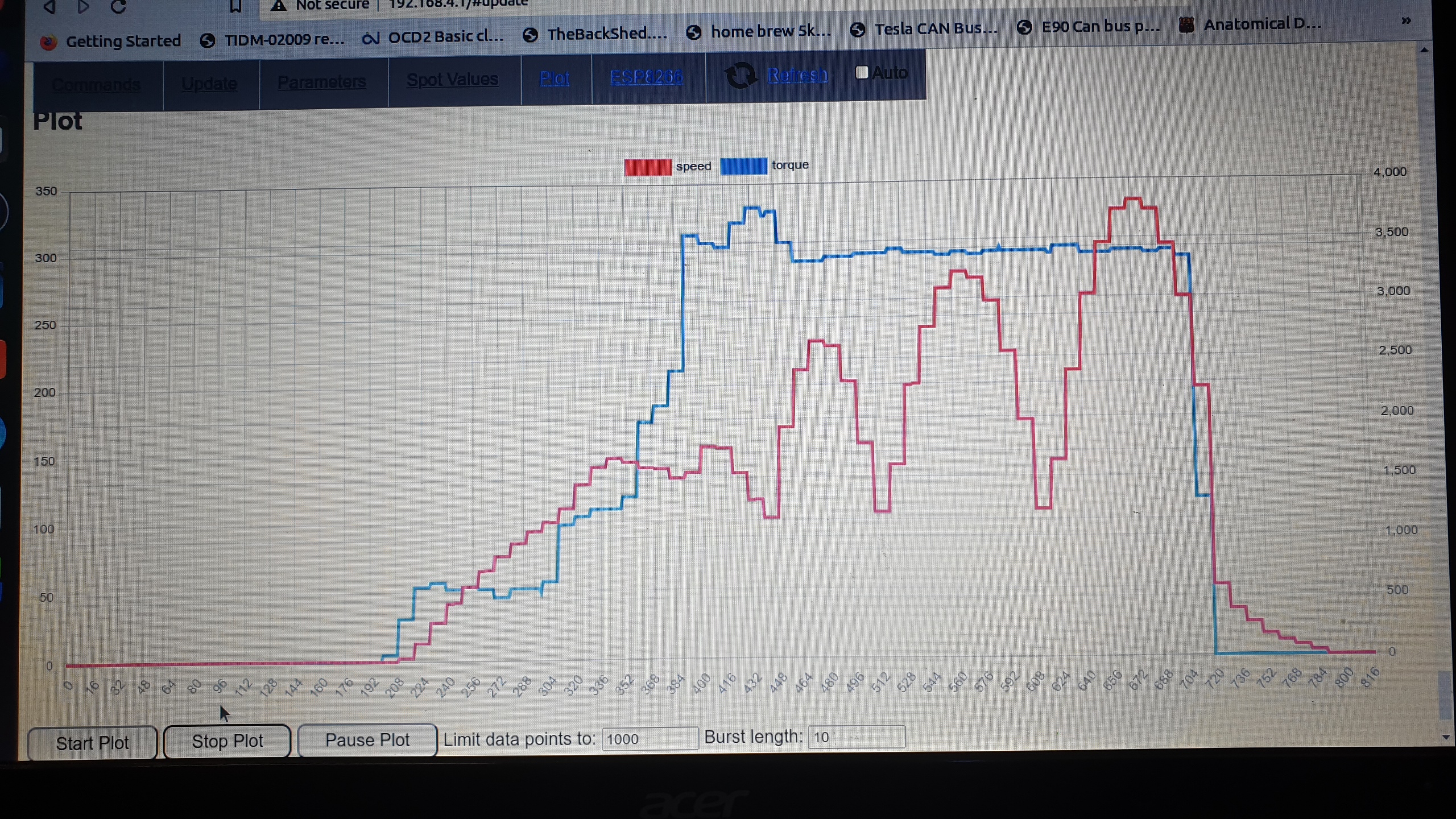

The difficulty I have is I can't replicate that problem. I bench tested this firmware and then built the drivetrain into a car and took it on the road. Not sure what else I can do. This morning I went 40 miles in the E39 with no problems. Car is on charge right now as it happens. I'm in now way saying there is not a problem its simply that I cant see it here and I've exhausted my options for testing. Perhaps someone else could do some diagnostics and help us all out ???et0 wrote: ↑Tue Nov 15, 2022 12:23 pm Awesome, DM_WORK built and loaded OK. Showing version 1.00 A

Lets try this : Do a plot of speed and torque. Speed on right and torque on left.

Will do this tomorrow (I actually did it today but didn't capture it - it did show roughly the same as your plot above though).Jack Bauer wrote: ↑Tue Nov 15, 2022 1:42 pm Lets try this : Do a plot of speed and torque. Speed on right and torque on left.
Assuming the .hex on github is the same one you are using, I guess the only difference should be a setting. I am using "none" as the car type for example. I will try to debug it anyway.
