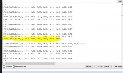

Hi tom,
Unfortunately the current garbage values still exist.
I added the couple of lines to my code and the problem still presisted,
then i decided to flash the hex file you uploaded yesterday to make sure it isnt my code and issue still there.
check the pictures i took from the debug.
that's the current sensor reporting on canbus, the current is really zero no flow going through it.
and this is the current debug and shows way big or garbage data.
i think RawCur and getcurrent functions are the trouble here,
will look at the code and hopefully i can catch the issue.
best,

7yatna wrote: Thu Oct 27, 2022 6:17 am check the pictures i took from the debug.
The standard broadcasting is defined the user manual for the shunt. so you need to see 0x521 for current.
I bench tested it, so the problem is on your end.
So if you do not see 0x521 on the canbus it wont work.

tom91 wrote: Thu Oct 27, 2022 9:03 am The standard broadcasting is defined the user manual for the shunt. so you need to see 0x521 for current.
Hi tom,
Yes i agree and that's the very first thing i verified since last July when the problem started, and of course this week when the problem persist.
so if you see my attached picture sorry i didn't highlight the 0x521 but it is in the middle to lower end line but here it is highlighted in this one
the current sensor is reporting 0x521 all the way to 0x528 and is working fine. as well if i disconnect the current sensor from the network the garbage values stops.
meaning the 0x521 id is contributing to the issue.
i agree the problem might be on my end, but the current sensor and can network and 0x521 is out of the picture.
sorry to pick your brain on that. i will debug code and see where the problem might be.
Karim

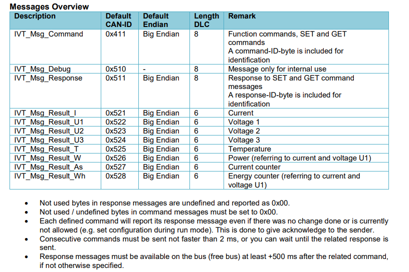

Garbage probably due to you having set the byte value in reverse so its little endian as byte 2 contains something.
The standard message is Big Endian.

tom91 wrote: Thu Oct 27, 2022 4:43 pm Garbage probably due to you having set the byte value in reverse so its little endian as byte 2 contains something.
that what i actually was thinking. little vs big, i didn't intentionally do so but i will figure a way to reverse it :D
so after all it is my current sensor being a square ??
haha sorry tom. will spend sometime reversing that then report back. need now to figure it out.

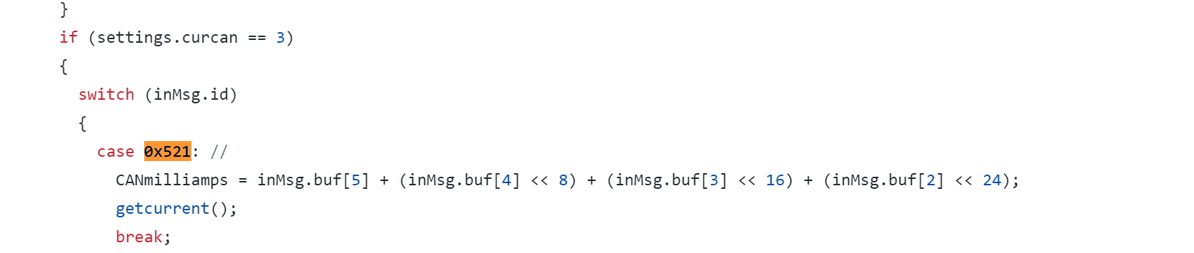

so here how i initialized that IVT-S Sensor,
I followed this wiki here on openinverter,
https://openinverter.org/wiki/Isabellen ... te_Heusler
and i got the correct Values as expected,
unless the libraries got updated and somehow the fix meant for addressing the little endian problem associated with arduino.
my senbsor is now configures as little endian ? if so is there away to tweak the in.msg buffer to get the correct information from the sensor without reinitializing,
have no idea how to reinitialize the sensor if this sketch is broken.
im trying this format hopefully it will work.
CANmilliamps = inMsg.buf[0] + (inMsg.buf[1] << 8) + (inMsg.buf[2] << 16) + (inMsg.buf[3] << 24);
instead of
CANmilliamps = inMsg.buf[5] + (inMsg.buf[4] << 8) + (inMsg.buf[3] << 16) + (inMsg.buf[2] << 24);
thanks again tom, im very excited as this is the very final stages of getting the car driving.

7yatna wrote: Thu Oct 27, 2022 5:51 pm so here how i initialized that IVT-S Sensor,
Please insert the (long)(.....) back as it keeps it formatted right and you do not get errors with the signed value.
I must say I never initialised it I just ran it as it came. Have done so on all ones I used so far.

tom91 wrote: Thu Oct 27, 2022 6:11 pm Please insert the (long)(.....) back as it keeps it formatted right and you do not get errors with the signed value.
Hi Tom,
wanted to report back that indeed it was a little endian vs Big endian issue. i confirmed it by looking at the script code i used to initialize the IVT-S Sensor it was reading back in little endian.
so after adjusting the SimpBMS to little endian, All is good and i have fully working system.
over the weekend i did the first full charge cycle on the pack. current is reporting Ok both ways, Balancing is active and with my little modified code it can report on the screen if it is balancing or not.
