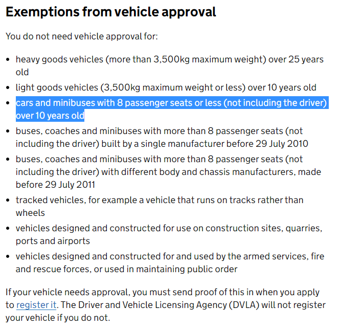

catphish wrote: Sun Sep 11, 2022 2:18 pm I informed the DVLA of my (2001) conversion 6 weeks ago. I finally got a response yesterday. It was essentially just asking for information I'd already provided. As expected, they are primarily just checking whether the chassis has been modified, and hence whether an IVA is required.
They've also asked for before and after photos of the vehicle, and confirmation of the chassis number. Nothing too onerous, but just another reminder to everyone: do not modify your chassis in any way!
I've send off the details they requested, so waiting again. I won't be expecting free tax, just making sure I do everything by the book.
From here:
https://www.gov.uk/vehicle-approval/exe ... e-approval
I was researching about 'if you modify the chassis you would need vehicle approval' can of worms - and noticed this list of vehicles EXEMPT from vehicle approval & it includes 10year + old cars!

Very interesting, wonder what they will say if you send a copy with your application ?

Peter wrote: Mon Oct 24, 2022 1:10 pm Very interesting, wonder what they will say if you send a copy with your application ?
They'll change the page and say that never stood there :lol:
Here's the Web Archive link, so at least THAT won't happen: https://web.archive.org/web/20221024140 ... e-approval

SuperV8 wrote: Mon Oct 24, 2022 12:54 pm From here:
I looked into that already because on the face of it this seems like it solves our problem entirely. Unfortunately, it's been confirmed that this rule will only be applied to imported cars unmodified from their original form.

Unless the rule actually says that then it would be hard for them to enforce it.

Scubascooby wrote: Tue Oct 25, 2022 10:00 am Unless the rule actually says that then it would be hard for them to enforce it.
Unfortunately these "rules" found on the gov.uk site are not legislation, they're just a simplified version of the current policies.
In their defense, I don't think it's reasonable to argue that one should be able to build a car, wait 10 years, then drive it on the road regardless of its construction.
It really is a shame that the regulations on modifications aren't more clearly defined in legislation.

I would not expect it to be that hard for Bitsilly to get an IVA for his mini particularly as the car was in production till 99 (im not suggesting he would pass first time), but there is nothing that would shout i'm more dangerous than a home built Haynes 7.
most stuff isn't needed for an IVA i.e airbags etc, you have to remember that all an IVA is a super MOT for kit cars, there are rules about external fittings like wing mirrors (basically so you cant clip someone and drag them along etc) so you might have to change them for the test but nothing that would stop an old car from being put back on the road, the duel circuit brake system might mean you need to re plumb your brakes with a valve that triggers when 1 one starts to leak, but all in all quite minor.
the hardest part is the HV battery although i believe janosch has done this a few times with his taxis (quoted below)
I don't know why people are talking about battery box certifications, we didn't have to do that:
The path for this that we found is:
MOT
write a report about electrical compliance (this is pages and pages of literature and boring writing)
get an appointment for an electrical safety inspection for ~£750 and get a certificate
submit all of this to get an IVA appointment ~£400
pass the IVA appointment
To re iterate what i have said previously
1. don't drill any holes if you can
2. if you cant its an IVA but that not the end of the world you'll probably be out of pocket by an extra £1500-£2500.
