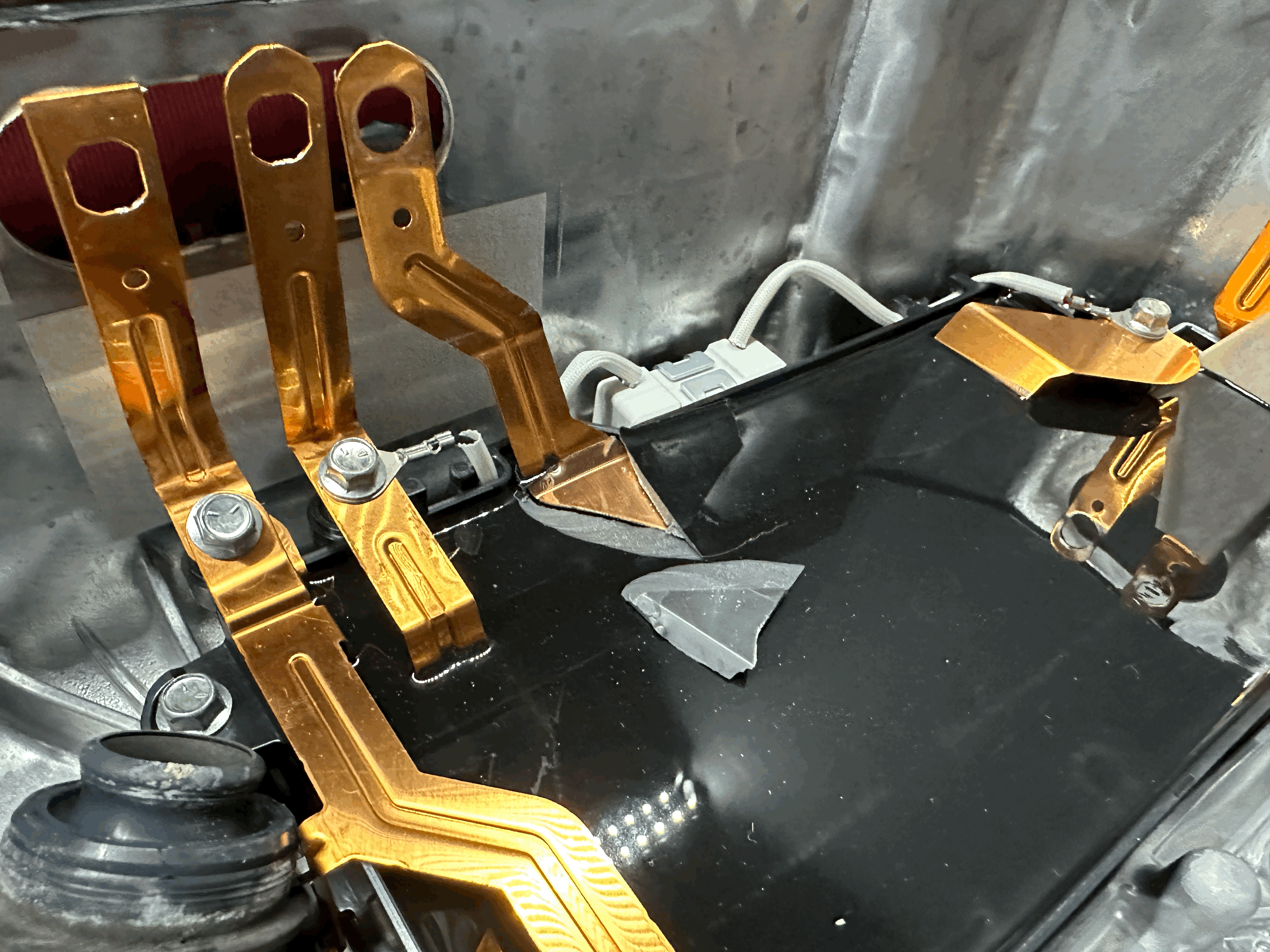

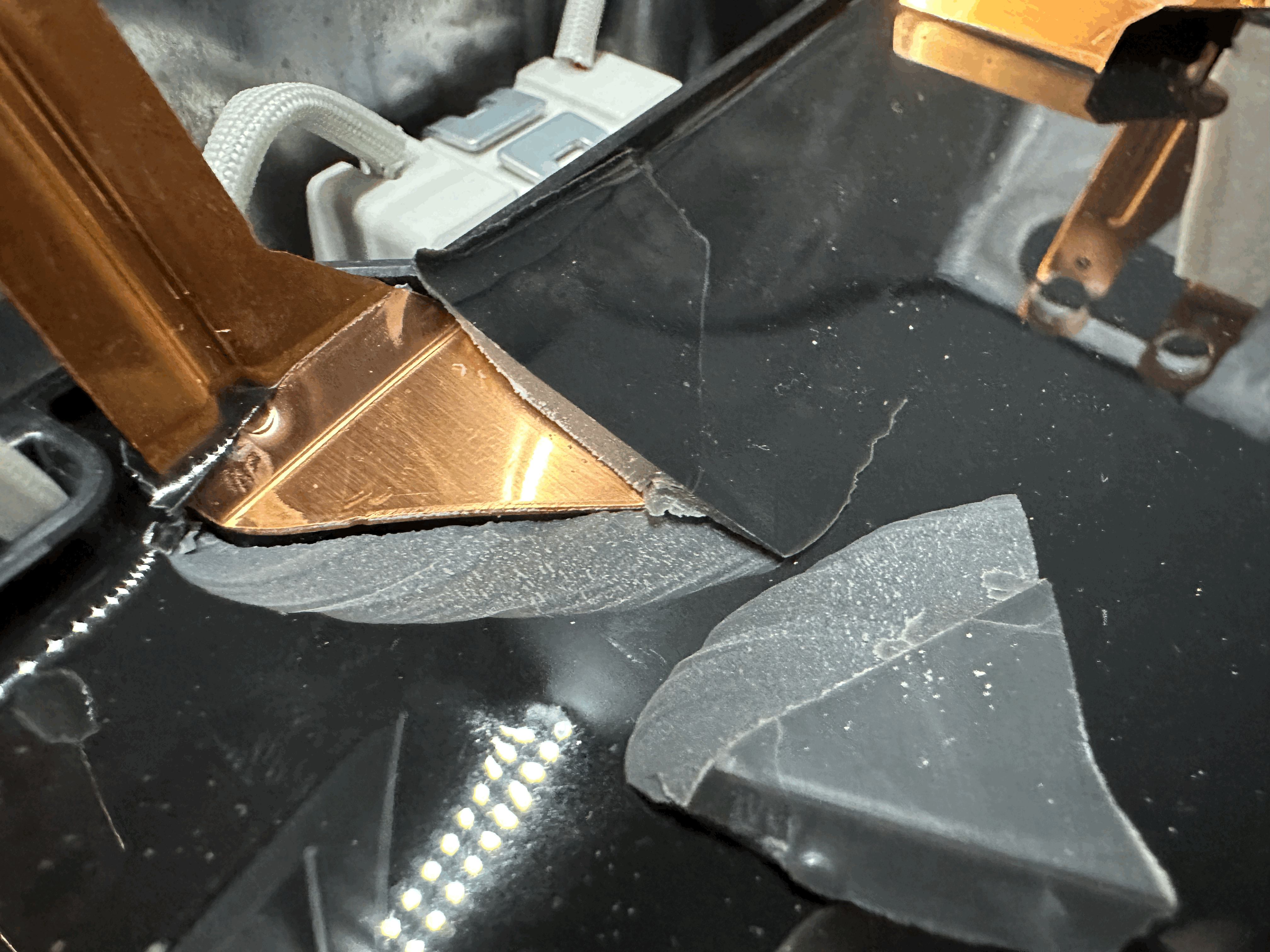

On a scale of 1-10 how much have I cocked up after getting over enthusiastic taking the case off?
It was £18, and 'not working' so can live with it if I've completed borked it.
Not sure if you can see the full damage, will that glue back on? Should I not attempt it?
