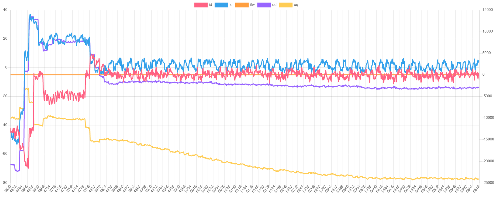

Got up to 100 kph and still accelerating. Not controlled though. But I can drive 80 kph with full control now. Here is the 100 kph run
So 250 Hz or 3750 rpm makes 100 kph with the small Audi tires. Lot of drama for that kind of speed.
Also still haven't arrived at good curkp/ki values, you can see (and I could feel/hear) that they are oscillating slowly.
That is interesting with the FW limit. How to find out?
I definitely saw 300A on the DC side when I had to force the motor to stop.Jack Bauer wrote: ↑Thu Oct 13, 2022 10:33 am But Johannes! the internet tells us the prius inverter can only do 100amps...

Just noticed at time 21445 is when I came off the accelerator. Uq changes from -8000 to 0. Apparently it wants to cross 0 but I don't let it, therefor it doesn't regen but keeps driving

There are some very odd things going on with the voltages there, is that with syncadv=6? Also is that plot for ifw proportional to freq?
Edit - Also how are you combining mtpa and fw Id in the plot, looks a little different to normal?
- Been thanked: 1914 times
Re: Audi A2 /w Prius Gen2 Transaxle & Inverter
syncadv=5
TBH I'd prefer to try and understand what is going on in there at the moment before adding more things. There are just so many things I don't understand there!
You mentioned that you came off the throttle at 21445, did you then get onto the brakes at around 21600? Were there any other throttle or brake changes during the plot, or anything else that might affect the data?
Edit - The following are the things that don't make sense to me. I anyone could explain any of these I'd appreciate it as they are winding me right up
Ud appears to be saturated full negative for most of the duration of the plot. This means that the increasing Ifw can't be having any effect as it can not decrease Ud any further. So
All FW current needed to get above base frequency must be being provided by another source, what is it (Mtpa or something else)?
If Ud us unvarying then what is causing the ripple seen in Id, it can't be the PI controller stability so what is it?
Uq appears to be saturated for most of the plot (limited by available modulation index for 1st half and zero limit for second), so
It can't be responsible for the ripple on Iq so what is?
When it does change at 21445 it has virtually no effect on Iq - why not?
When it does change at 21445 it appears to have more effect on Id (increasing its absolute value) - why?
At 21830 what changes to trigger Ud to increase?
Why does its increase have little effect on Id?
Why does its increase have significant effect on Iq?

Yes, good questions.
I'd still try above change to see what happens when voltages are kept from saturating.
I noticed sometimes the takeoff is silk smooth and sometimes it judders about. That's why I think it is something mechanical. The driver side drive shaft is always in bent state because the transmission sits too far forward and it makes a tick tick tick noise the more torque is requested. I think I'll take that apart and check.
Yes I did use the mechanical brake to force the car to slow down, regen was not possible.
Yes, MTPA is active otherwise the motor is too sluggish.Pete9008 wrote: ↑Thu Oct 13, 2022 3:14 pm Ud appears to be saturated full negative for most of the duration of the plot. This means that the increasing Ifw can't be having any effect as it can not decrease Ud any further. So
That's what I also thought soon after. I wonder if it is something mechanical. If some cyclic friction were to slow down the motor then it would draw more current, right? Also the gate driver is a bit too "intelligent" for my taste. I mentioned before it maps, say, 49/51 duty cycle to 50/50. What other funky stuff will it do?Pete9008 wrote: ↑Thu Oct 13, 2022 3:14 pm If Ud us unvarying then what is causing the ripple seen in Id, it can't be the PI controller stability so what is it?
True, didn't even notice. If you simulate an ideal inverter, what can you say about the relationship ud/id and uq/iq. Are they both frequency dependent? At an equal slope? I somehow suspect there is still a mis-map between what split the controllers output and what the motor sees.
I had slowed down enough for the controllers to come out of saturation and I finally got the regen I wanted. I noticed before that the transition from positive to negative torque triggers a sign change of ud. Why I don't know.
because regen
Is it? Currents are on the left axis. So iq would be 40A on average, id about -40A. I reckon that's still the MTPA split. Ripple must have the same cause as before.

Good point, could well be. Either mechanical binding or the driver doing something similar to the 50/50 but near 0% and 100% could explain it. Thinking about it it has to be reasonably intelligent to add the dead time control, could the offset introduced by that be causing the effect?johu wrote: ↑Thu Oct 13, 2022 6:21 pm That's what I also thought soon after. I wonder if it is something mechanical. If some cyclic friction were to slow down the motor then it would draw more current, right? Also the gate driver is a bit too "intelligent" for my taste. I mentioned before it maps, say, 49/51 duty cycle to 50/50. What other funky stuff will it do?
Agree, I think there is still something not quite right in the mapping of uq and ud onto the motor. It looks like the motor is seeing some Ud as Uq and vice versa. Might be worth increasing syncadv to say 7 to see if it improves?johu wrote: ↑Thu Oct 13, 2022 6:21 pm True, didn't even notice. If you simulate an ideal inverter, what can you say about the relationship ud/id and uq/iq. Are they both frequency dependent? At an equal slope? I somehow suspect there is still a mis-map between what split the controllers output and what the motor sees.
Neither do I
Ditto to above.
Good point! I was looking at the wrong axis.
CV joints can take quite a bit of angle (inner one to a lesser degree), in fact they don't like being perfectly straight as it concentrates the wear points. Have you got a picture of the angle? If it's making a noise then it is definitely worth checking out - could be causing the ripple too.johu wrote: ↑Thu Oct 13, 2022 6:21 pm I noticed sometimes the takeoff is silk smooth and sometimes it judders about. That's why I think it is something mechanical. The driver side drive shaft is always in bent state because the transmission sits too far forward and it makes a tick tick tick noise the more torque is requested. I think I'll take that apart and check.
The thing that is complicating everything is it running open loop for so much of the time. While it is doing that iq and id will not be achieving the iqref/idref targets and so making sense of the plots becomes difficult. Would it be possible to get a plot for a part throttle run (enough to push things and get above base freq but not enough to drive things into saturation)? That might be a lot easier to read and if it makes sense it is a good sign that the 2nd P controller would help (it is going to be needed but adding it too soon just adds another layer of complexity that makes it harder to understand what is going on).
Another plot that would be useful is one with FW disabled. The results above suggest that Mtpa is generating more than enough -Id to do the job by itself and it would be interesting to know if that is actually the case. Part throttle again to prevent saturation/open loop.
Would it be possible to add ESP32 based data logging to this install?
I'll try to have a go at adding the missing equation terms to the simulator today. It's unlikely to shed much light on what's going on in the above plot but it should help understand what the limits on -Id/FW current are.

Yes, with syncadv=5 and ldminuslq=10 I could also accelerate to 80 kph uphill, if I remember correctly without saturating the controllers. FW off and was only giving it mild throttle. That's why I hope to throttle limiting controller will help.
Of course coming off throttle gave excessive regen because FW is gone then.
Yes I could add the ESP32 to this build as the controller lives in a well accessible ModICE enclosure
Any yes I will try syncadv=7

ldminuslq of 10 seems quite high, that would explain why you don't seem to need any FW current! Do lower values reduce performance much?
The throttle limiter will help (and is needed in teh final solution) but my concern is that it could also mask problems and make diagnosis more difficult.If it would make testing safer now though then it's time to add it.
Be careful of higher syncadv values on the Touran. Simulation suggested they can have nasty side effects if you go to far beyond base freq (2x base seemed fine at any value of syncadv though). Personally I'd wait till the Audi is ready, I'm fairly risk adverse and the lower base freq speeds would be attractive!

Been thinking a bit more about this and the best plot for checking the interaction of uq, ud, iq and id would be one showing them, plus frq, while coasting (no regen, no throttle, target of 0A for id and iq) down from just below base frequency.
The theory says that this should show uq ramping down from 100% modulation with ud, id and iq at or close to zero. Anything else suggests either a misunderstanding of the theory or a setup that needs adjusting.
Motor mounts and other shaft seal fixed, now the torque arm was ripped apart. 4mm alu, just ripped right off! Small problem, easy fix.
Anyway, made that idle plot on a downhill (a BMW driver got very annoyed and overtook before a bent).
Of course I forgot frequency. I "accelerated" from about 30 to 55 on the downhill:
I also deployed the throttle limiter and now indeed there is no more controller saturation. I had to bump up curki=10000 though, otherwise I got short lumps of unwanted regen with regen disabled. Otherwise it seems to drive fine at speed
EDIT: aand I just discovered why performance was a bit suboptimal. Had limited is to 100A (was supposed to be % limit)
So here's the limit code

That plot looks pretty much perfect
All the strange bits in the previous plots must have been due to the controller saturation?
How is it driving with the limiter?

Yeah, looks like now there is hardly any frequency dependency on ud. Maybe because I increased syncadv to 7?
Driving with the limiter I can't yet say, see edit above
