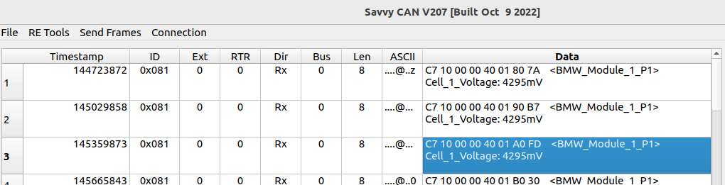

I took the liberty of using your .DBC file for the BMW PHEV. I'm a complete newby to SavvyCAN and CAN in general. I've got SimpBMS working on a BMW 530e battery pack using a Teensy 3.5. The output shows on the batteries found and a voltage delta of 3mv (on the Arduino console screen).Bigpie wrote: ↑Tue Jul 26, 2022 8:36 am I started a collection of dbc files. I made one for the isa shunt when configured as the wiki https://openinverter.org/wiki/Isabellen ... te_Heusler on my github https://github.com/jamiejones85/DBC-files
I've now added the SavvyCAN via a Due and can capture lots of lovely frames.
When I apply the BMW PHEV .DBC to the captures frames, it shows my Module 1 P1 cell to have a voltage of 4295mV The arduino console shows all cells to have a voltage of about 3650mV
What am I doing wrong as I'd expect the SavvyCAN output to be the same as the arduino console values?

Re: CAN DBC files
The BMW PHEV DBC is very much WIP and inadvertently pushed, if you correct it, please do a PR.
