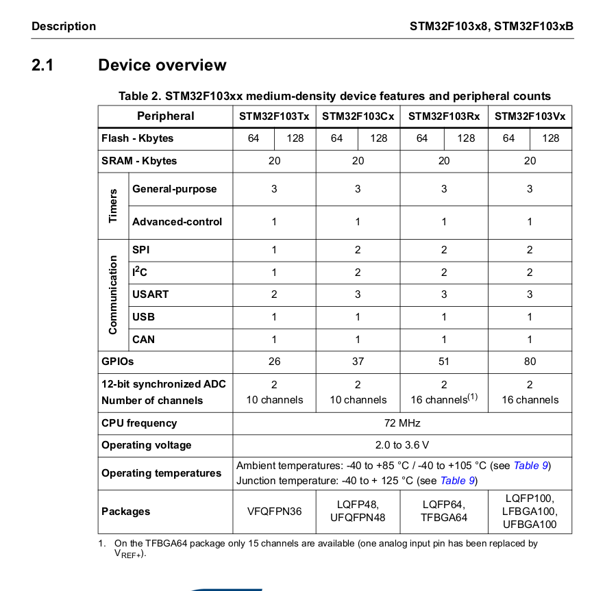

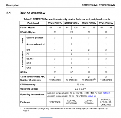

Also just came across this:
I'd been sure that the processor had only one ADC (changing to 3 on the high density devices) but this seems to indicate that there are 2. It is the STM32F103R8 that's used isn't it, what am I missing?
Pete9008
- Posts: 1801
- Has thanked: 102 times
- Been thanked: 351 times
- Been thanked: 1913 times
Wait, really? It's the STM32F103RBT6 and sometimes R8T6 (64k flash)
Says the same here: https://www.st.com/en/microcontrollers- ... 103rb.html
2 ADCs. Ok, some things to try when I get back!
Pete9008
- Posts: 1801
No idea, completely bemused, even the low density parts seem to claim 2 now.
I'm positive that when they first came out they just had the one as I remember choosing the high density part because of the extra ADCs.
Definitely opens up a number of very interesting options if true
