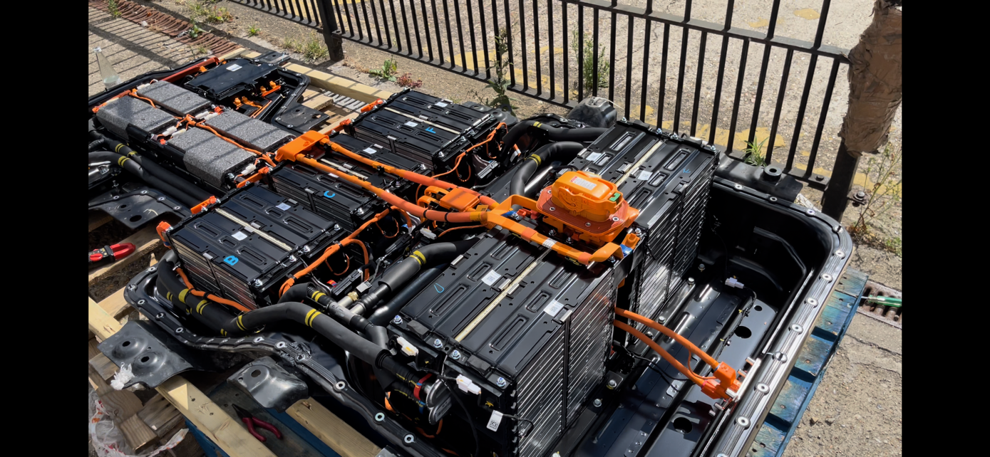

Hi All, so I’ve recently purchased a 2020 Hyundai Ionic EV battery pack 37501-G7650, and I’m hoping to get it working in my EV conversion, and hopefully spread some of the information that I find on here.
I do have some questions, so if anyone is able to, your input would be greatly appreciated.
1. Is it possible to read the BMS information via CAN?
2. Is battery balancing a standard operation on BMS systems and is it activated as soon as there’s power to the BMS.
Is the BMS involved in Grid station charging? What sort of information is required for a grid station to output power?
Thank you all in advance, I have attach photos of the pack? Please let me know if you require any information from it.

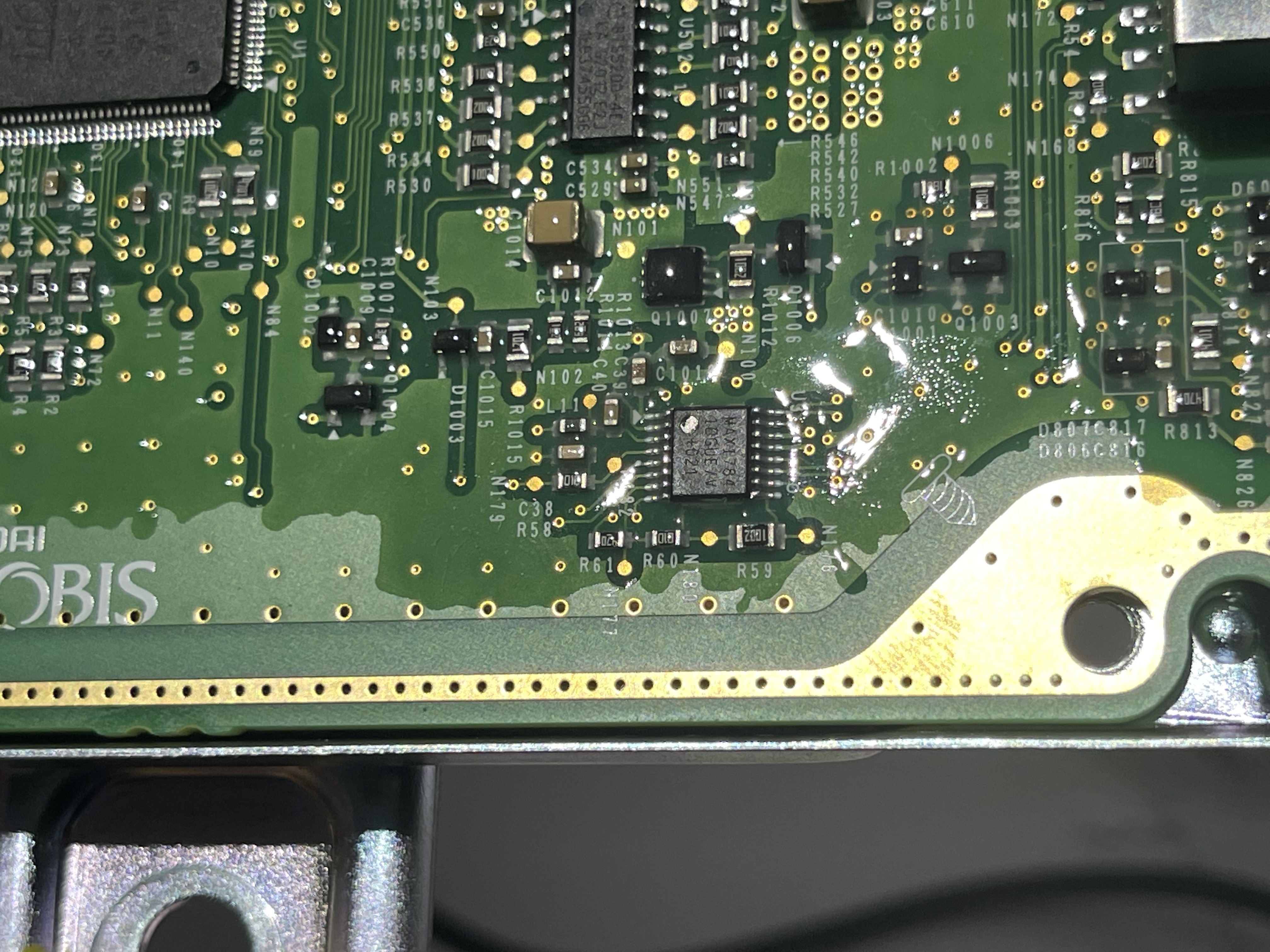

I' attempting to find the CAN signals connections with my limited PCB knowledge, and here's what I've found

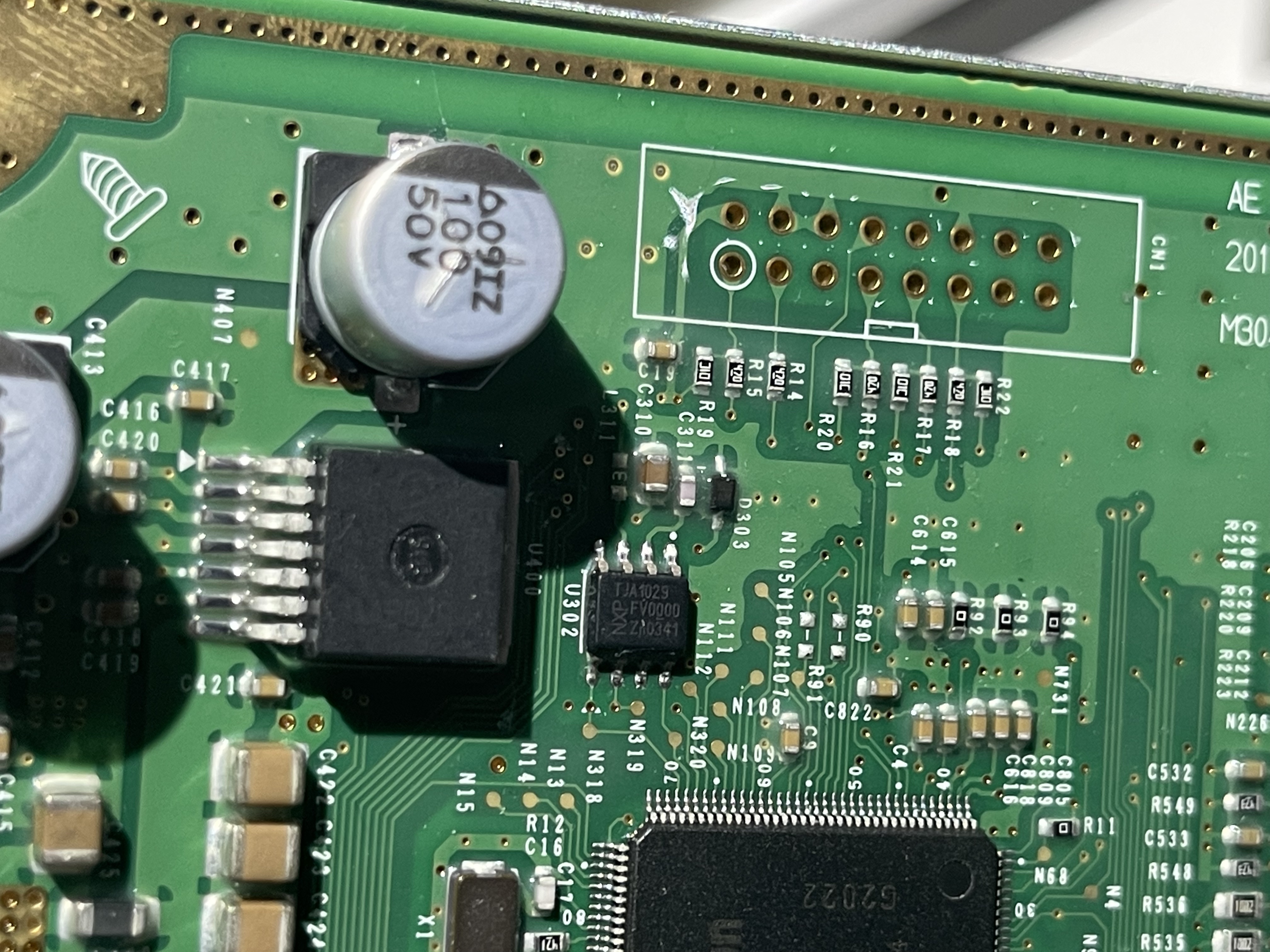

So I've taken out to BMU and opened it up and found some interesting chips on the board.
Infineon SAK- TC2640 40f200w BB Infineon 14 84pnat74x06
Max1784 1bgue/v +021
Tbs5200-4E KA G2012 e2j 1E937455g06
NXP TJA1029 FV0000 Zn0341
T251V 443 G2025
TI 04 OVDQ
I think I've managed to figure out power input into the board, However i'm unsure of whether an enable/ignition signal is requires
I'm assuming the NXP is CAN related, Maybe One of you legends could tell me differently.
And of course you have the Massive Infineon processor chip.

TJA1029 is LIN bus transceiver. U300 looks like CAN interface, possibly TJA1050 but can not read it in photo. U3 is MAX17841 which is ISO SPI, which I assume is the interface to the battery modules.

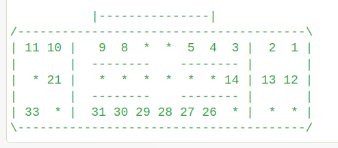

Nice stuff! I have a crashed 2019 Kona sitting outside. I'm hoping to run the full BMS in a transplanted vehicle (rather than going one layer down and talking to the the cell monitor units, as some others on here are successfully doing.)
I am hoping the battery pack control would be similar between 2019 Kona and 2020 Ioniq, It's hard to tell from the photo how many pins are in the external socket in your photo, it looks like it could be similar or maybe it has fewer pins?
On the Kona, the plug is KET MG656922-5 and the pinout (Kona connector number EB11) is:
EDIT: ASCII art seems to only work in some browsers, so here's a screenshot of the ASCII art!
(This might be mirrored left-to-right for you, I wrote it down based on the harness connector. My car is still mostly intact so I haven't verified it.)
Here are my (unverified) notes on the external connector pinout:
BTW, if you're in EU or some other places then you can pay 15 Euro to Hyundai Global Service Way then you can access the exact schematic diagrams, connector pinouts, etc for the Ioniq including schematics for inside the battery pack. The above is from notes I took while looking there.
Hopefully this is similar or the same as your pack. I plan to take some P-CAN logs from my Kona soon, and will post here when I do.

| 11 10 | 9 8 * * 5 4 3 | 2 1 |
| * 21 | * * * * * * 14 | 13 12 |
| 33 * | 31 30 29 28 27 26 * | * * |
- 1 & 2 - Memory Power 12V (powered all times, 15A BMS fuse)
- 12 - "IG3" relay power 12V (on when vehicle is "on", 10A fuse)
- 10 & 11 - P-CAN High & Low (powertrain CAN, main control channel for BMS)
- 15 & 16 - QC CAN High & Low (marked unused and not populated in the harness diagram, I guess this is used in-factory)
- 3 & 14 - Service plug interlock (in engine bay, connection closed for normal operation)
- 4 - Quick Charge (+) relay control (to HV Junction block)
- 26 - Quick Charge Relay ground (to HV Junction block)
- 5 - Quick Charge (-) relay control (to HV Junction block)
- 9 - Quick Charge temperature signal
- 31 - Quick Charge temperature GND
- 13 - Crash Output from SRS ECU
- 8 - Radiator Outlet Temperature Sensor Signal
- 30 - Radiator Outlet Temperature Sensor GND
- 21 - Coolant 3-way Valve Control (coolant valve)
- 29 - Coolant 3-way Valve GND
- 27 - BMS Heater Temperature Sensor Signal (I think not there on my AU car)
- 28 - BMS Heater Temperature Sensor GND

Huh, that looks like the same plug but with different pins populated in the centre rows. I guess it was too much to hope that they'd make the packs plug-and-play swappable.
If you've got the battery pack open then you can probably have a look behind this connector to see some of the connections (CAN will be a twisted pair, main power will be thicker wire, etc.) But would recommend diving into the Hyundai site if you can, 15 Euros to look at the schematics can save a lot of headaches.

Re: Hyundai IoniQ 2020 HV battery pack
Hello Royboy, any luck by checking my EB11 wiring sheet?
https://docs.google.com/spreadsheets/d/ ... sp=sharing
This is amazing. I am going to try this on a Ioniq 5 battery at a junk yard to verify it's health before purchasing, but have a couple of questions if you don't mind.
1. I can't tell from the video where you tapped into the CAN lines - can this be done without opening the battery, or do I need to tap in to the internal wiring connection to the BMS? I am hoping to do this all via the EB11 connector (or equivalent for the Ioniq 5) without opening the pack.
2. Did you have to do anything special with CarScanner settings, or does it just think it's talking to a car without issue given most of the car is not there?
3. If this doesnt work for me I am going to try get the raw canbus using SavvyCAN. From your first video it appears to have just started spewing messages without you activating it with any messages - is that correct?
