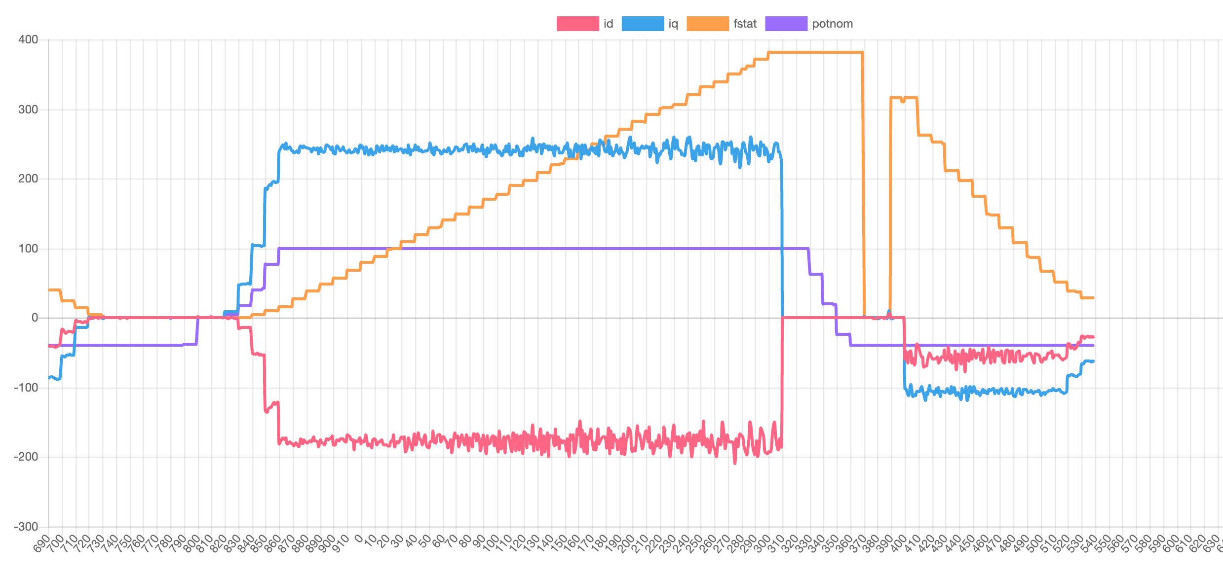

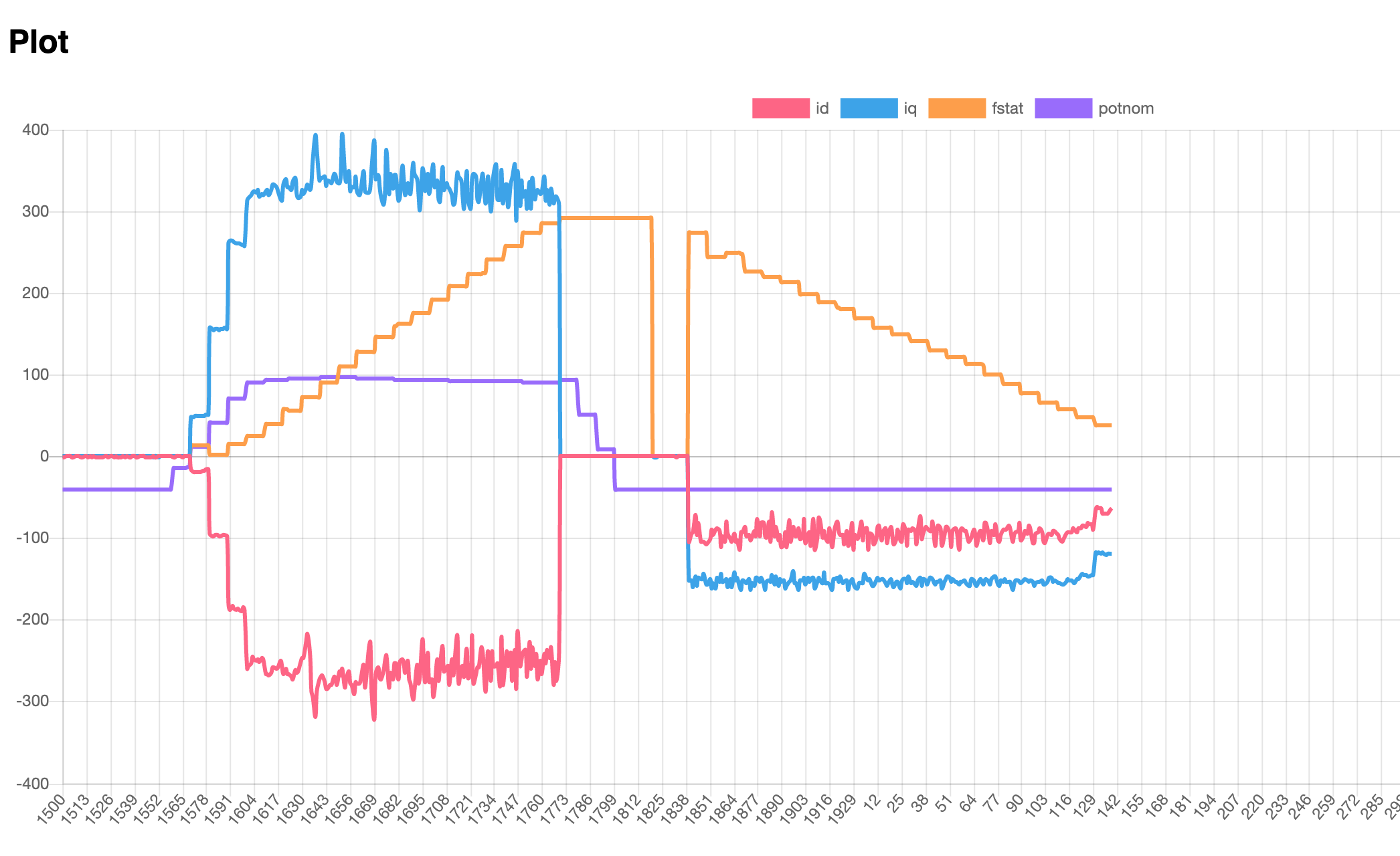

Anyone know about the temphs? Chasing my cutouts I noticed the temperature feedback seems to have a ceiling of 100 degrees
Graph shows where inverter shutdown current and fstat tanks as auto resume
Posts: 3661
Has thanked: 10 times
Been thanked: 335 times
The inverter will not cutout on overtemp but it will limit. The only source for a cutout is the IGBT desat detector outputs.
Posts: 1771
Has thanked: 82 times
Been thanked: 422 times
It looks to have cutout at lower currents on the graph, unless something spiked and Mr Toyota said now before Johannes gets the info.
2.5 Throtcur, if I'm reading this right, it's happy at about 250 amps then at 380Hz ish Mr Toyota sits down.
4.5 Throtcur, current 100 amps higher, but again at 380Hz ish Mr Toyota sits down.
Posts: 1771
So wondering if it's DC max current? Anyone able to post some graphs of idc, iq, id and stats? Are you able to get over 100 amps DC?
Posts: 6716
Has thanked: 369 times
Been thanked: 1543 times
I don't think the inverter even knows the DC current. Rather looks like some event that happens at full throttle and 380Hz. Could be the point where the amplitude is so high that the IGBTs can stop switching for parts of the period. Actually that's a good thing because it reduces switching losses. But perhaps Mr. Toyota don't like it?
You could plot "amp" to see that
Posts: 1771
I shall plot that next time.
Setting to derate at 100 amps has stopped cut outs for the most part. Stamping on it from 0 mph will still do so, but I can now floor it after rolling a little. Removed fmax and can now get the rpm back up high again. It's even allowed me to bump the throtcur further. Pretty pleased.
