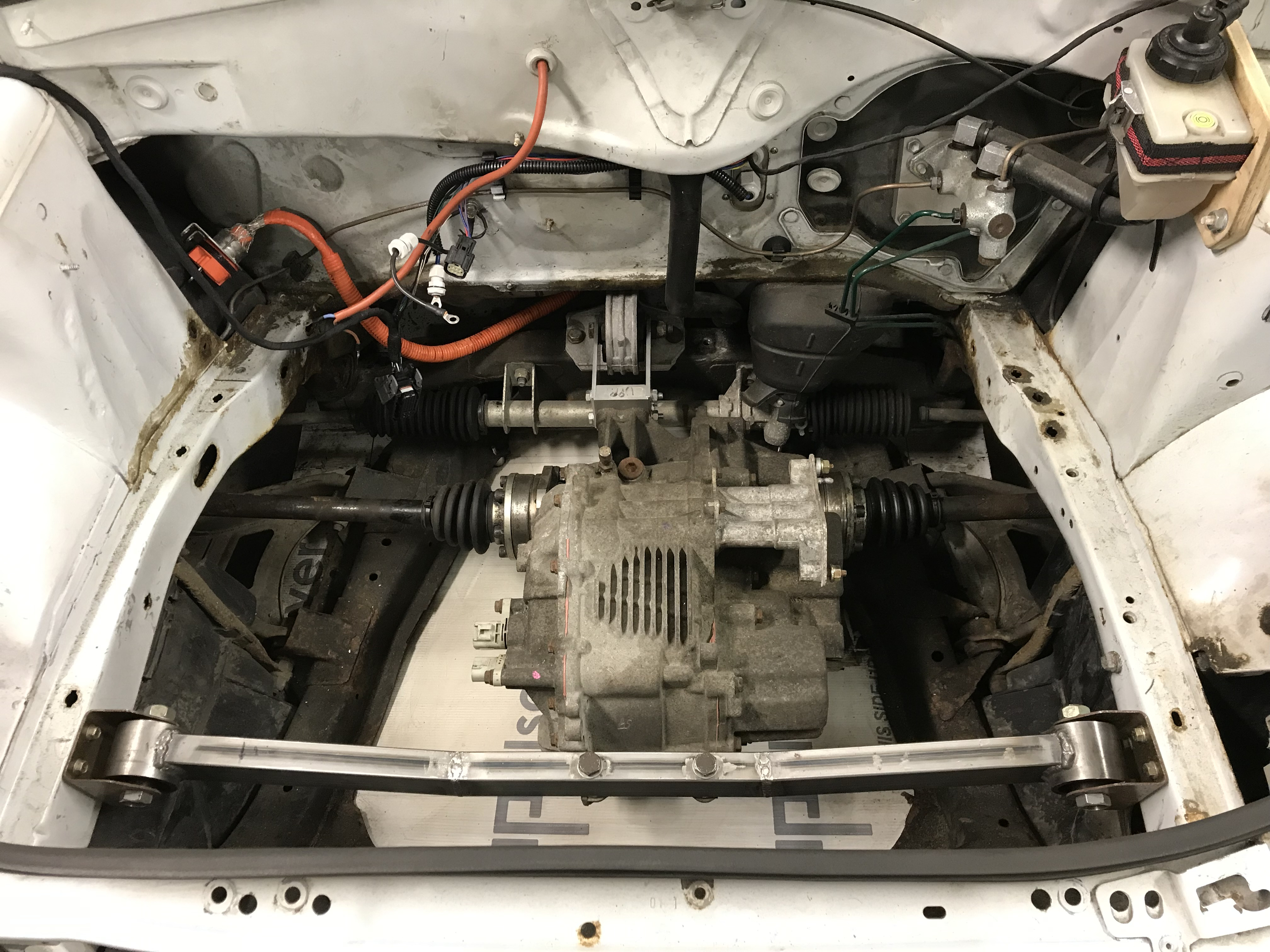

I received a question via PM regarding how I implemented the CAN-control of the Leaf inverter so posting it here if someone else is interested.
It is based on work from others, mostly celeron55, http://productions.8dromeda.net/c55-lea ... tocol.html but also Zombiverter code and others.
This is my entire code used in my "Human Machine Interface", however the Leaf parts can be traced from functions readPTCAN() and sendPTCAN().

johu wrote: Thu Jun 30, 2022 8:39 pm Like you could put the MGR back in there :)
Would it make sense to try the MGR once more in the Clio? To my understanding there have been a lot of progress made with the SW lately and it is likely that the MGR will work with this latest release (5.24)?
Posts: 6969
Has thanked: 455 times
Been thanked: 1771 times
Re: Renault Clio Electrique -97
Yes I expect it to perform well now, so if you have the time that would be very interesting.
Greetings from Jämtland and sorry we didn't manage to stop by this time
bexander
Posts: 883
Location: Gothenburg, Sweden
Has thanked: 75 times
Been thanked: 98 times
Post by bexander »
I'm a bit unmotivated to work on the C30 at the moment so I might have a go at it. Not promising anything but have started going through my old documentation and thinking about what needs to be done in order to make it work.

Well the MGR is such a neat package for a small vehicle that I have to give it another go.
Leaf powertrain is out and MGR is mounted.
Next is to mount inverter and inverter cooling system.

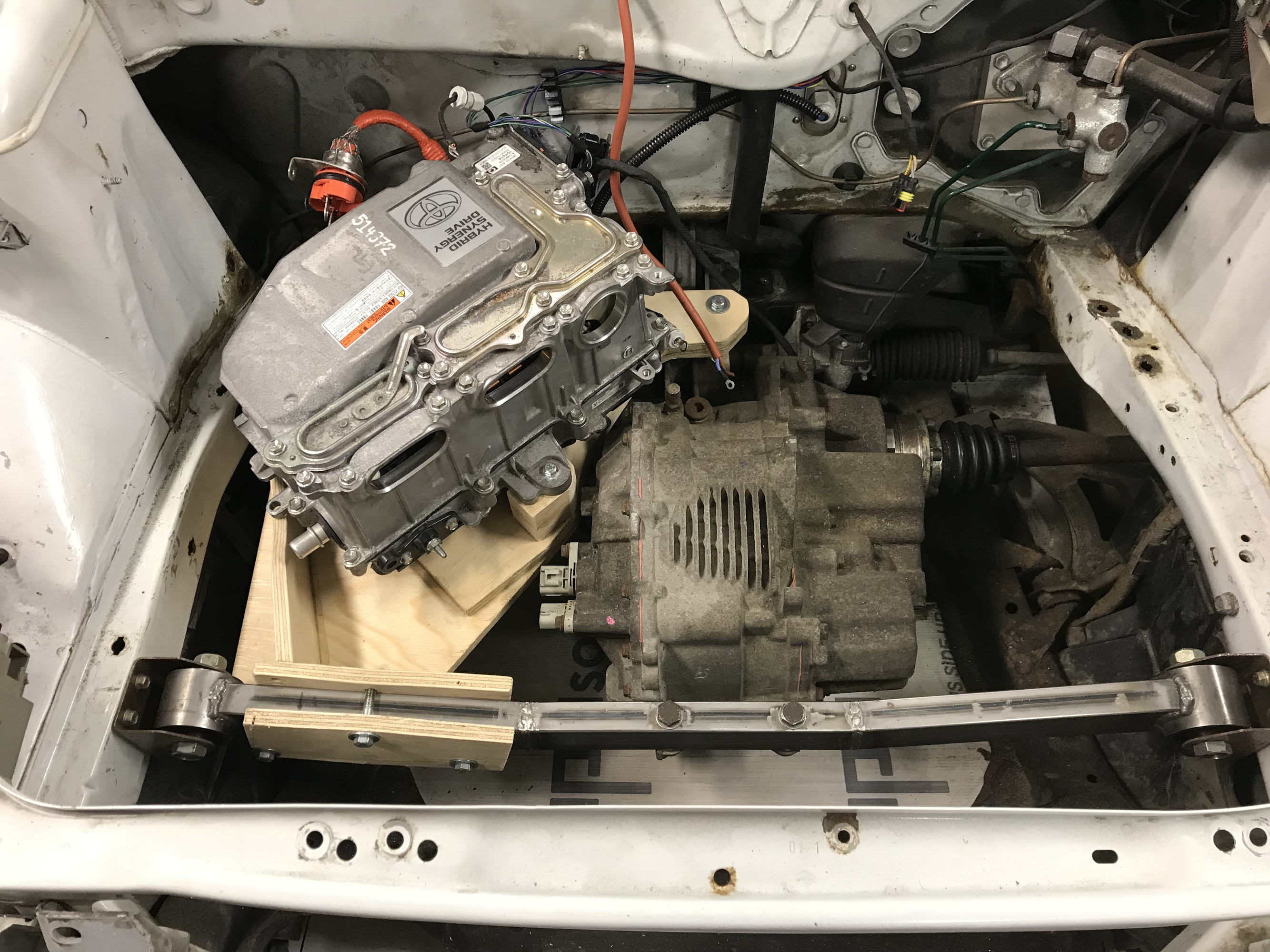

More progress, inverter is in the car. Yes, the mount for it is temorary, will be replaced if MGR behaves.
Next, cooling system for inverter.

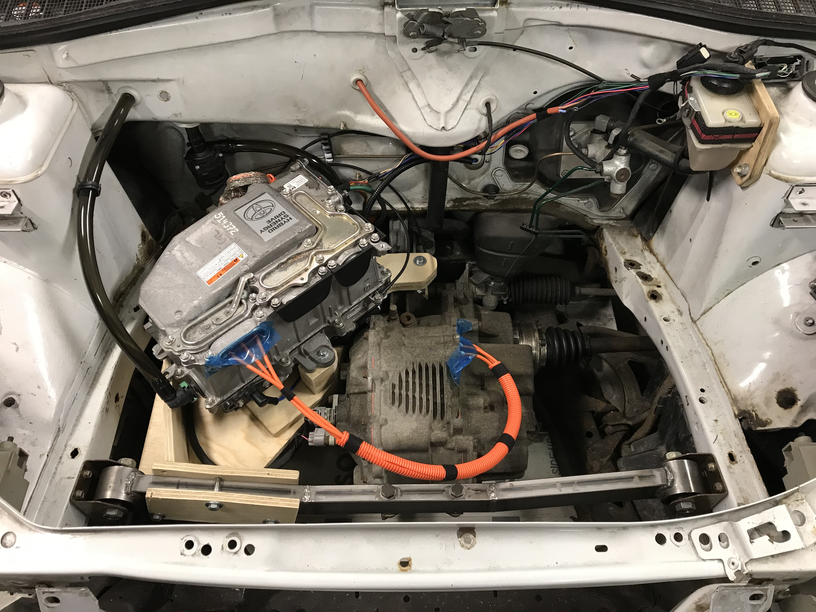

Post by bexander »
Indeed, very exciting.
Everything ready for test.
Have moved the car with its own power in the garage. Unfortunately it is raining outside and the road is wet so I will wait for better weather as my HV wiring is far from watertight. Hopefully road test tomorrow.
Latest parameters.
Yaris_MGR_FW5_24_2023-01-04.json
(1.45 KiB) Downloaded 201 times
At first the motor would not spin but draw current. I had swaped the phase cables... :( Glad nothing bad happend and it was an easy fix once I realized what was wrong.

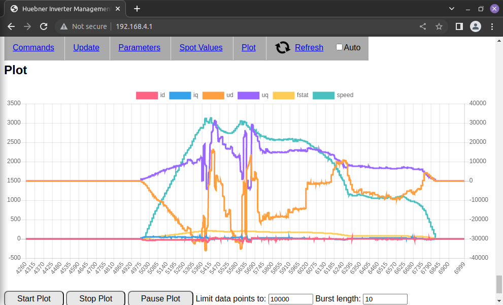

Ok, first test drive done.
It needs tuning for shure. I get oscillation when speed goes above approx 40km/h. Can this be due to my high lqminusld at 4mH or should I start somewhere else with the tuning?
It also feels a bit "raw" or "cogging" at 0-2km/h. This is minor and not important right now.
