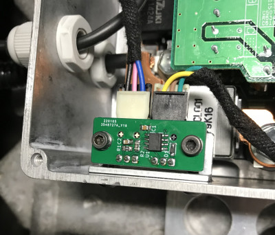

Yes, the backplate is from the the converter you sent. The electronic is from my inverter.
In the converter you sent me the 30A fuse on the PCB is blown. I haven't found a suitable replacement fuse yet. Might look into this more when I have the car on the road again...

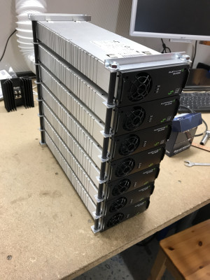

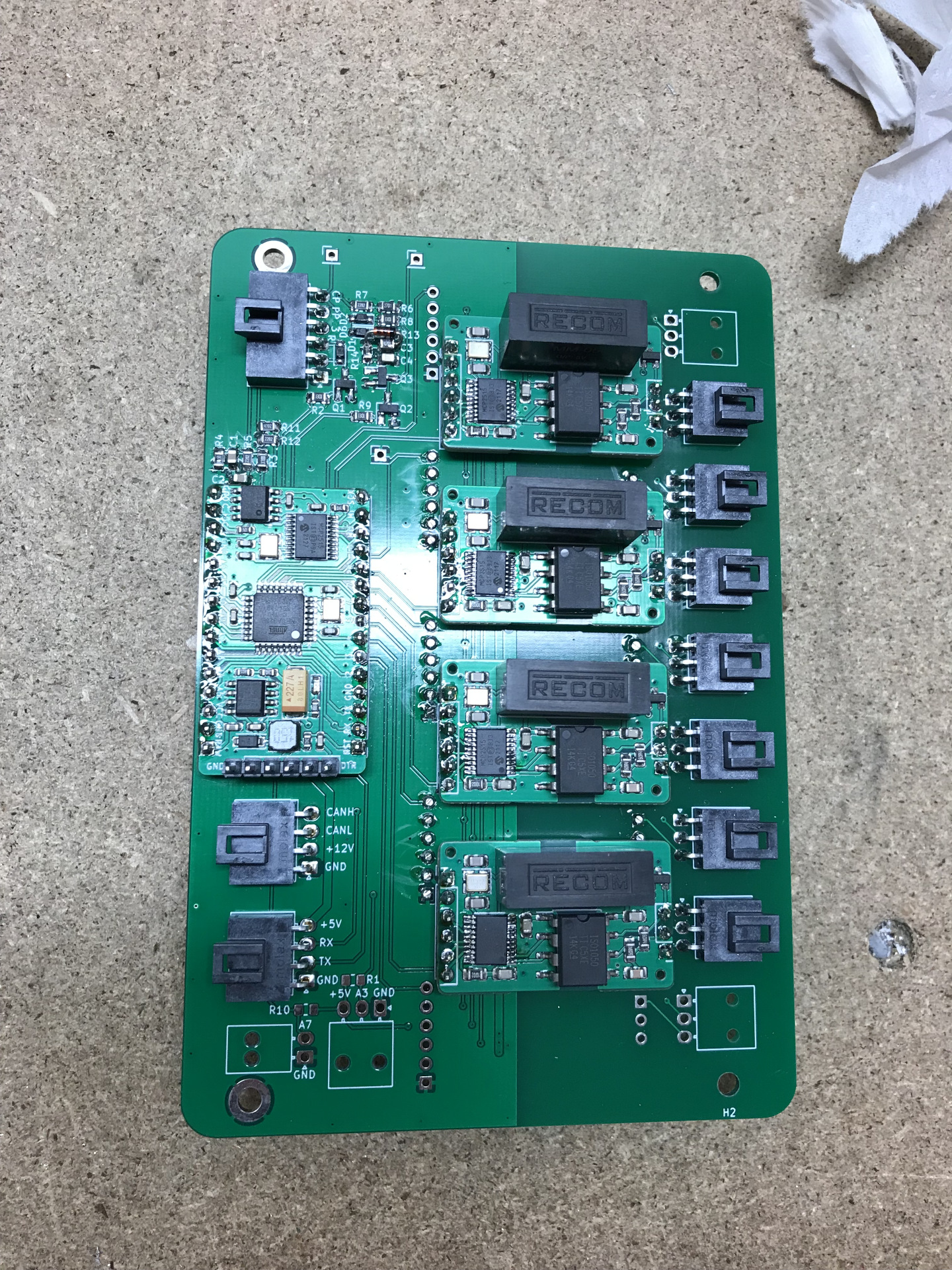

While waiting for the last parts for the DC/DC I have been working on the charger.
Will be using 7pc of Eltek FlatPack 2 HE 48V power supplies. Will also have detection if 1- or 3-phases is available. With planed configuration I will be able to charge up to 17kW if 32A 3-phase is available and down to 2,3kW if only 10A 1-phase is available.

I like your charging solution, makes nice reuse of those flatpacks. tchip/elcon are pricey. looking for a way to supplement my 2011 ze0 leaf for 3phase to compete with what zoe's have as standard. coming from the ebike crowd this method of stacking server supplies and a meanwell for cccv is not new to me. any more elaboration on how your 1 phase/3 phase automatic switch works would be appreciated.

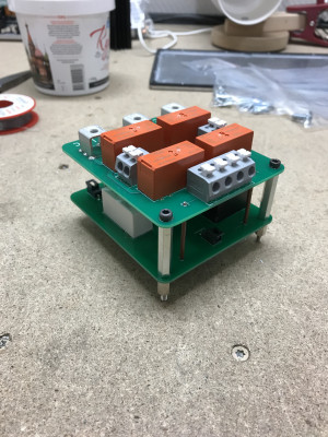

The shift between 1- to 3-phase is done by four relays. Two would suffice but I could only find PCB mountable relays for 16A with resonable price. The relays are of "type c" NO/NC.
If coil is magnetized the FlatPack is powered from L2c, if coil is not magnetized the FlatPack is powered from L1c. L2c and L1c is Line 2 and Line 1 after the main contactor in the car.
In my case I have two shifting relays and hence two FlatPacks connected on L2 and two relays and FlatPacks on L3. The remaining three FlatPacks are connected to L1 permanently.
This is still untested but will be tested soon.
L2 is Line 2 and L2sens is basically Neutral (via a opto coupler). Should result in the relay coil is magnetized if the L2 is present. If coil is magnetized the FlatPack is powered from L2c, if coil is not magnetized the FlatPack is powered from L1c. L2c and L1c is Line 2 and Line 1 after the main contactor in the car.

Where did you source your flat packs from and for roughly how much? Also whats the combined weight and size?
- bexander
- Posts: 866
- Has thanked: 71 times
- Been thanked: 97 times
Re: Renault Clio Electrique -97
Some of them at two different occasions from private persons in Sweden. For the first three I paid 1500 SEK a piece and the remaining four I got as a thank you for helping a friend with some other stuff. I would turn to ebay or similar website to find them. You will also need a PCB to connect to them as there is only a slot at the back, no externa connectors.
The datasheet states 109x41.5x327 and 1.95kg.
My stack takes about 140x330x327 an then with above mentioned PCB in the back the length will increase a further 60mm or so. I have not weight the tack but I guess 15kg is a resonable guess.

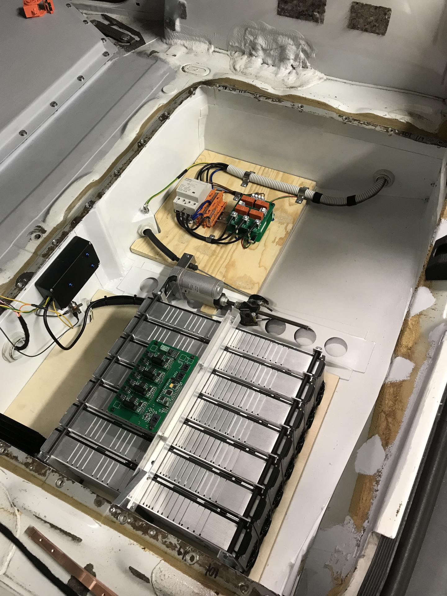

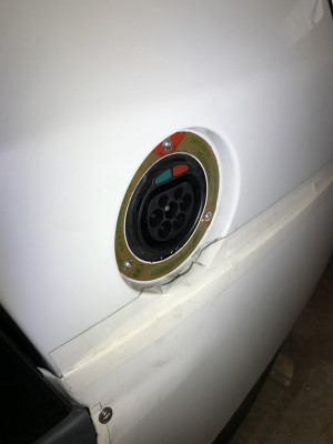

More things mounted in the car.
Anyone have a good idea for a cover for the type 2 inlet? The lid that came with the inlet sticks out outside the car so not good without modification. The cars stock one will not work as it is also the filler cap and at an angle.-

Plastic print one then cover with metal and paint you could print a ring which fixes around the socket and uses those 3 screws for mounting and implement a nice hinge
I'd look to modify the original too for aesthetics once closed.
Also i measured up my leaf boot and its 110cm wide roughly so 7 flatpacks will fit width ways. I am constrained in my leaf as the muxsan battery extender already takes up a large chunk of the boot space and the remaining space is often occupied by my husky. I think i maybe able to maybe mystack long and thin. I.e.
Have them sideby side and strap them to the backs of the rear seats. Also its a good location as its close to the inbuilt charger which is under the hump just below.
I think i will mockup a cardboard model to see whether the husky will cope with the space loss due to this propose charger location.

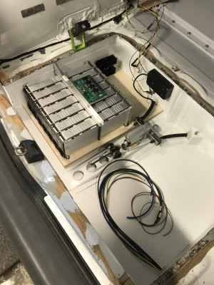

The full charger installation. The low voltage wiring to the left is temporary.
Have done more driving but the wether was wet, cold and windy so not to concerned about 1,02kWh/10km. This will most likely improve with better weather.
Working with improvments to charger SW and BMS SW at the moment. Have done more driving but the wether was wet, cold and windy so not to concerned about 1,02kWh/10km. This will most likely improve with better weather.

Forgot to mention that the consumption is measured at 70km/h cruise. Consumption will increase approx. 15% if speed is increased to 80km/h as per measurements done before.
I have 3pc of FP on one phase and then 2pc per each other phase so will only be able to get max 18,5kW of charging power but should still go from "empty" to "full" at about 30min.
