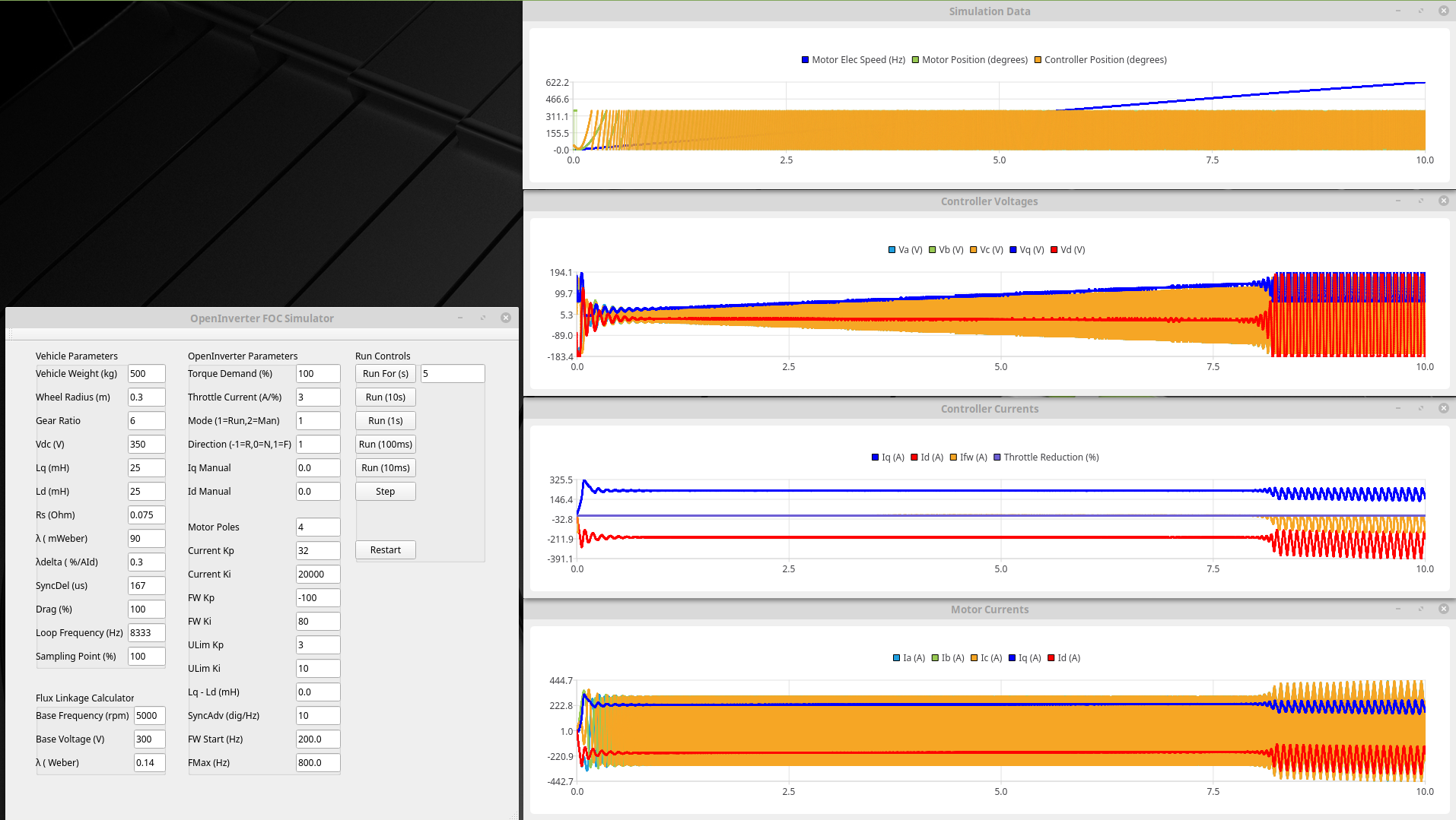

Good news, bad news!
The good news - been having another look at adding the mid period sample point and in the process have discovered why SyncDel needs to be set so high :)
The bad new - it's a fundamental error on my part that throws some of the results to date into question :(
The motor model had been taking the angle and phase voltages to calculate Iq and Id then using the equations to calculate the new Iq and Id values before translating these back into phase currents. Unfortunately it was doing the conversion from Iq and Id to voltages before updating the rotor position, it should have been calculating them after updating the motor position. Fixing this removes the extra 113us on SyncDel that has been bothering johu and I for a while. The other 167us correctly matches the SynDel setting of 10 (which is probably too high for other reasons).
Unfortunately this change does bring into questions some of the results produced to date so this evening job to go though the results and check whether the conclusions drawn from them are still valid.
I've also messed around with the model code a bit to allow it to produce phase voltages at variable sample points within the preiod so that it can be used to gauge the impact of the various ADC sampling schemes that could be used in the OpenInverter software. So the first question is does it all still work?
First plot is a rerun of the simulator agains the original OpenInverter software using all the same settings:
Near enough for me to say it's still working. You can see the effect of the code change though. The Iq and Id in the motor plot are gently drifting with motor speed because it's still running with SyncDel of 280. Changing SyncDel to 167 (280-113) gives:
Much better.
The next question is does it still demonstrate the unexpected deceleration so a 15sec run to above base speed followed by a 5sec coast:
That's a yes so that finding still stands :D
I'll run though the next few tests/plots now and post when they are ready.

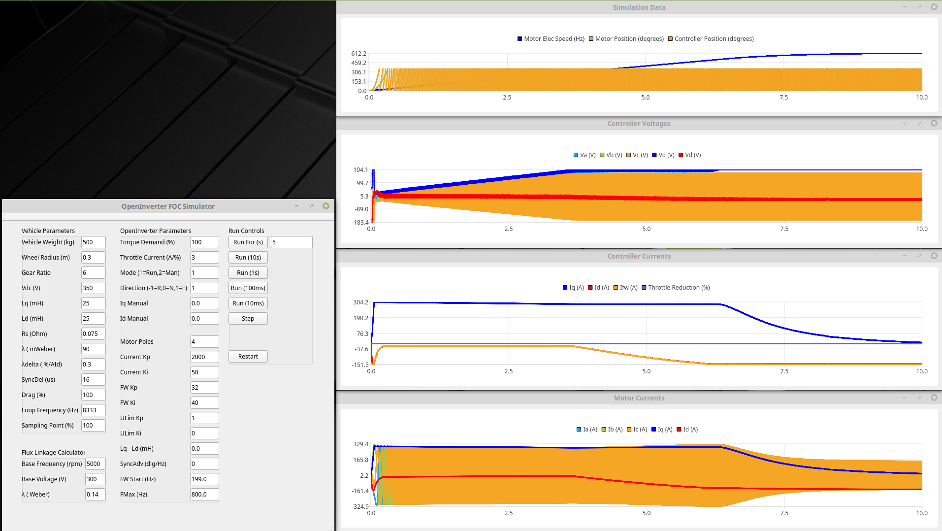

Next set of plots using the revised code to see if that still behaves. First a simple run using all the same PI parameters as before:
Looks OK so one with SyncDel dropped from 167us to 16us and ScynAdv dropped to 0:
Looks unchanged which is correct. Finally a 100% run to above base speed followed by a coast and then 100% deceleration:
Again looks good.
Based on that I'm going to conclude that fixing the error hasn't significantly affected any of the results/conclusions made so far. That is also a relief :-)

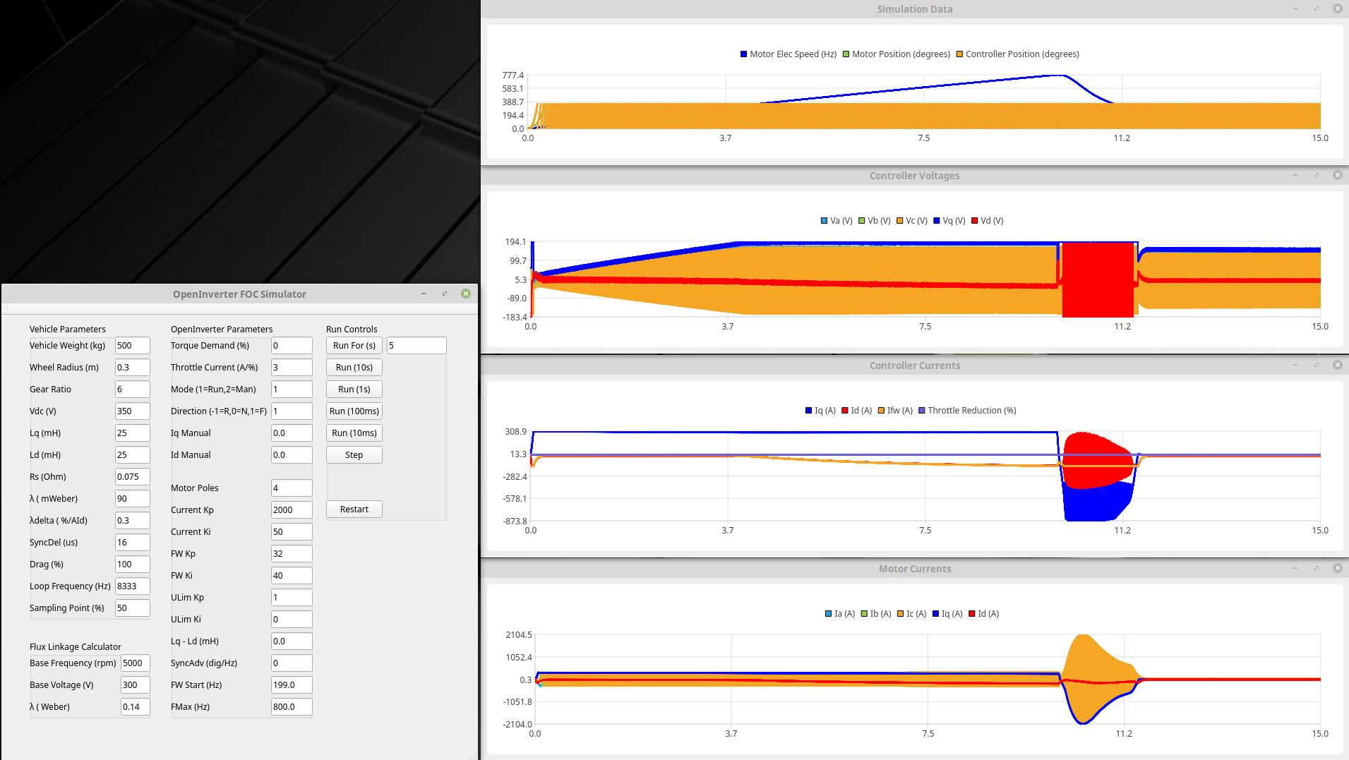

And here is the downside wit hthe 50% sampling position, if the model is run for 20seconds this happens:
And if you try to coast after accelerating for 10sec:
We're back to the unwanted deceleration due, I think, to the control loops running out of headroom due to the under-reported currents. :(
Options I can think of to fix are are either leave more headroom on the ud and uq calculations to allow for it, but this will reduce max power too, or move the sampling points to later in the period. Any other ideas?

And one last plot showing what is happening at the point where control is lost:
You can see in the controller voltages where it it cuts the Iq in response to the throttle cut. It also seems to reduce the -Id which doesn't quite make sense. These seem to recover pretty quickly but it's already too late and they have caused a slight drop in -Id and the loops never recover. Motor currents peak at around 2000A but the controller only sees around half this.
@johu - I would strongly suggest that you don't do ANY testing above base speed for the time being!

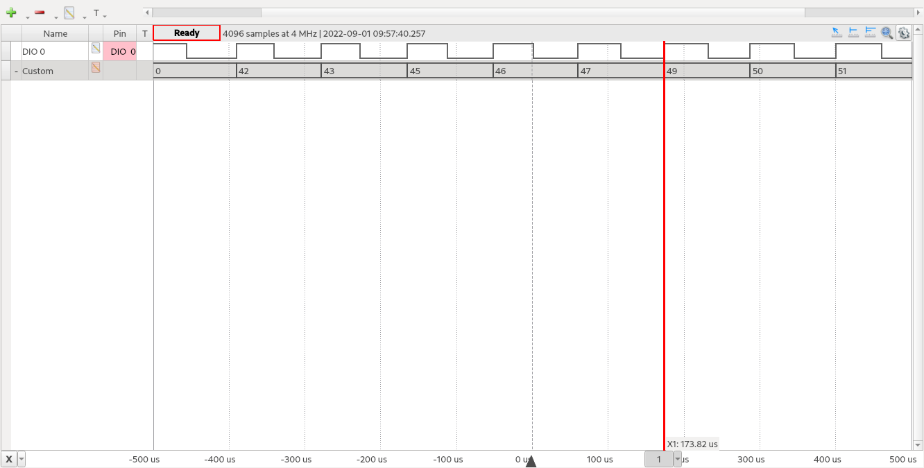

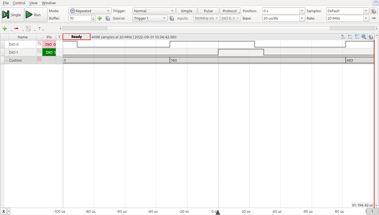

I did a little experiment myself but I'm not sure I found out anything.
I'm feeding one of the current inputs with a 100 Hz sine wave and then output the measured value on the first PWM channel. That way I was hoping to see the phase shift between sampling and outputting. Not sure if that's what I found as the scopes butterworth filter adds a bit of phase shift as well (set to bandpass-mode 90-110 Hz)
The bright blue line is my input waveform and the dark blue line is the filtered PWM output. The phase delay is 250 us with 12 samples. It isn't just the average but the average of 4 medians. (Median(1,2,3)+Median(4,5,6)+Median(7,8,9)+Median(10,11,12))/4
Then I repeated with 3 samples and decreased S&H time to find the delay dropped to 208 us
Also added a GetIIR function to AnaIn class but since that is a ring buffer it wouldn't feed the latest sample to the filter last but rather weigh some random sample as the last one. Little surprise the phase delay was all over the place on that one

Good idea and that's an interesting result. It does agree with the 1.5 period delay mentioned above. As long as you are using the same filter on both scope channels it should be common to both channels so shouldn't add any error to the measurement. Shame about the IIR.

Ok, I'll let you figure that out. Suffice to say that the discontinuity also exists in reality so your model is in check here. We can't work around the basics of discretised control loops I'm afraid. You always take the results of the current interval and use them for the next interval. But of course the delay of the acquisition can be worked on.
EDIT: thought about this again. So you calculate your next duty cycle and at the very instant they go in effect your ISR is called. So currents are from an early point in time of that PWM interval. By stretching this back almost an entire interval (104us) to the past you are effectively using values from the previous interval as well. Probably not a brilliant idea.
So I extended my experiment a little. I should also mention that the waveform generator is phase locked to the internal "oscillator" by means of a sync pulse. Whenever the angle wraps around a rising edge is generated on an IO pin and that is connected to the trigger input. The falling edge is the end of the ISR
So the instant we trigger is already towards the end of the ISR, like 30us into it.
From the digital capture we see that increasing the sample window does indeed move the reaction to the input one PWM interval later. Don't worry about the exact time value for reasons stated above. Also note that the duty cycle in the diagram always belongs to the previous interval as it can only be computed after the interval is finished

So which of those plots is normal operation, the 282us or the 174us? Also am I understanding that plot correctly in that the ISR execution time is around half a period or 57ish us?

Sorry for all the questions but need to get this clear in my mind - On the plot above does the isr start when the pin goes high and end when it goes low? Is the timer duty cycle reload on the rising edgeof the line? Where would the analogue and current sampling points be with respect to those edges?
Posts: 6716
Has thanked: 369 times
Been thanked: 1544 times
Went into this also and added the trigger signal to the plot. Also moved it more to the beginning of the ISR, but we still have the position sampling before it. It still shows that the ISR is called right at the mid point. So taking a single sample early in the ISR would yield mid point sampling

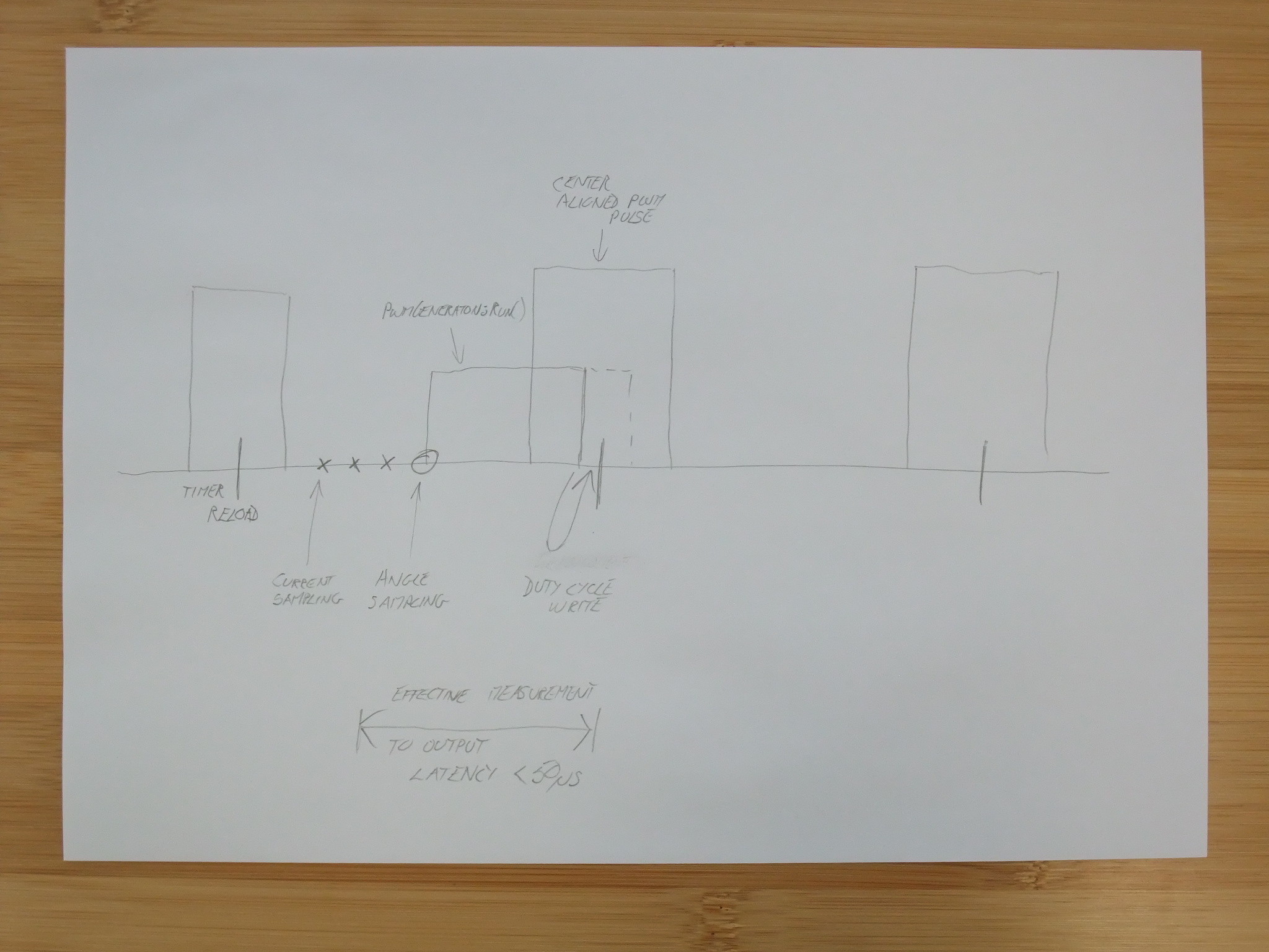

So is this anywhere near right?
Ignore the number of analogue sampling point shown (I didn't count them when drawing)
I think that observer code is a software implementation of the phase locked loop approach so might be worth another look. The trouble with them is the control loop does need tuning to be stable otherwise you do get a lot of jitter.
Edit - Ignore the above about the observer, its nothing to do with the phase locked loop. Unfortunately the original TI link doesn't seem to work - if anyone has a saved copy I'd be interested to read it.

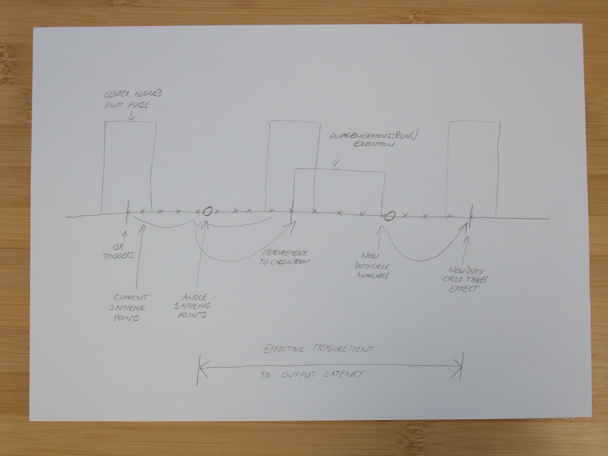

Assuming that the above is what we currently have I think this is what we should be aiming for:
Move PwmGeneration::Run() so that is triggered on completion of the injected ADC capture for the resolver. Remove everything from the front of the Run() routine except for the Id and Iq controllers with the aim of getting to the new dutycycle values in as short a time as possible so that the new values can be written back to the timer before the reload. This should reduce the latency down from 180us to below 50us and make life for the control routines MUCH easier. PwmGeneration can continue to execute past the reload (the dotted area in the diagram) to perform tasks that do not affect the duty cycle (such at FW and voltage limiting control loops, maybe even Mtpa although I like johu's idea of moving it to the 10ms task) so that the values are ready to use on the next pass round.
One thing that would also be worth adding in this scheme is a read of the PWM count value and direction just after the dutycycle load and a save of the worst case value to a parameter. From this it would be possible to check whether the ISR is reliably meeting timing and raise a warning if not.
What do you think?
Edit - the 50us above is probably pessimistic, hopefully we could get well below this. If it is would it be possible to move the injected conversion back a little to gain the benefit of any reduced latency?
Edit2 - Have just run the simulation and to guarantee stability need to get the latency down to around 20us! Might be a bit ambitious but is it worth a try?
Pete9008
Posts: 1801
Has thanked: 102 times
Been thanked: 350 times
Post by Pete9008 »
The simulator is now on github, here is the link https://github.com/Pete9008/IPMMotorSim
A warning, I really don't get on with github and have no idea whether I've done this right. The directory structure on there looks right and when I check it out it looks OK locally but Qt is complaining about not being able to find the OpenInverter files. They are correctly listed in the Qt browser tree and open from it so I've currently got no idea what the problem is. If you would like to give it a try feel free. I also don't seem to be able to push changes!
It needs the stm32-sine source code dropping in as a subdirectory of the IPMMotorSim directory.
One other comment, I'm still using Qt 5.11.2 (because I use it to do static builds for another platform and can't face rebuilding all the libraries if I update). It should work fine on newer versions of Qt but it hasn't been tested with them.
Final question - can anyone recommend a 'Dummies Guide for Git' because I could do with one!
Edit - It's compiling and running now, if anyone else has the problem just delete the backslash from the end of the 'stm32-sine/libopeninv/src/params.cpp \' line in the IPMMotorSim.pro file, save it, try to compile (it will fail), put the backslash back in, save it and it should now compile. Still no idea why though!
Edit2 - Please bear in mind that this is a work in progress!
