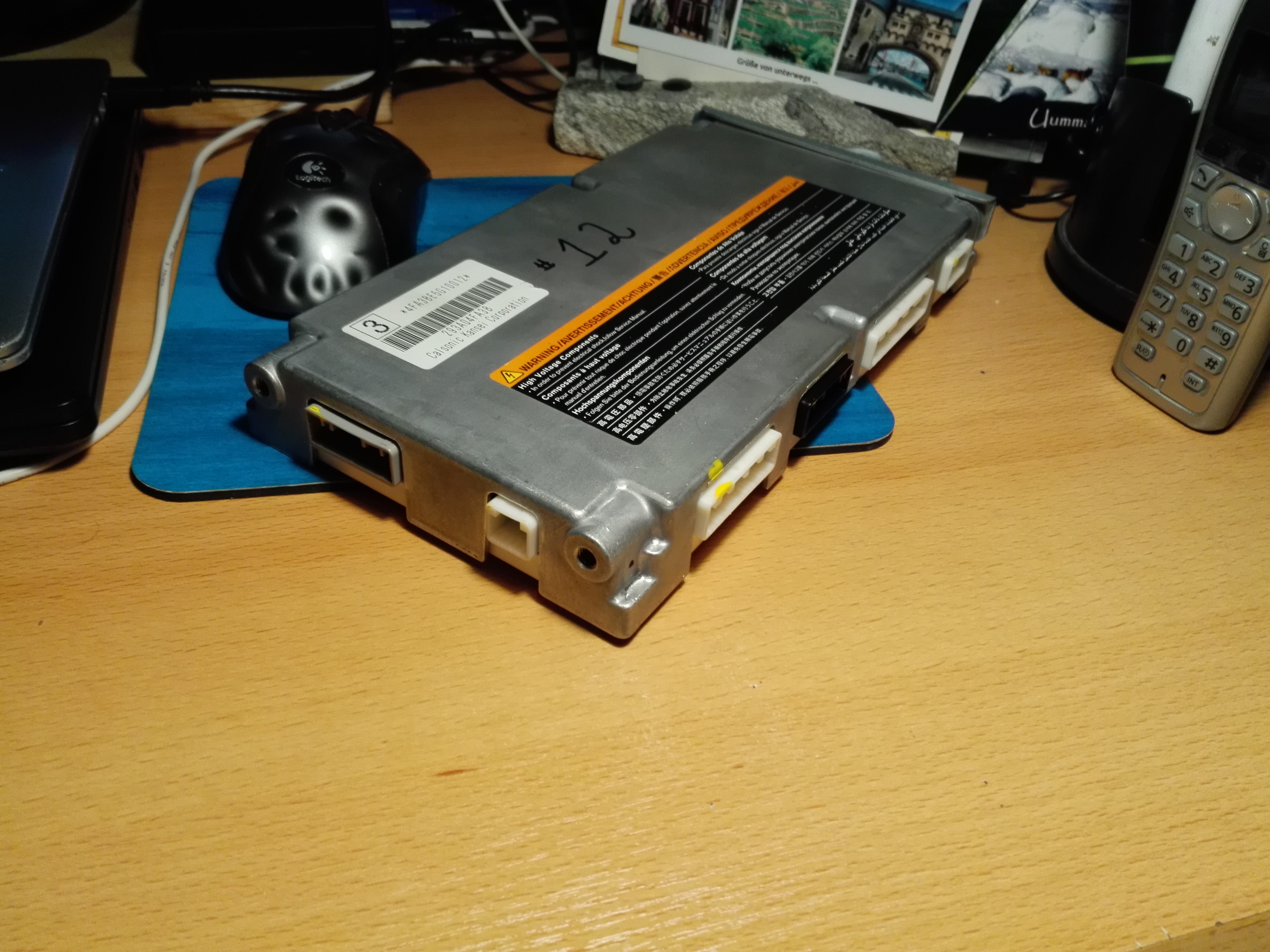

So I think I'm one step further to solving the interlock issue.
The LBC that came with the original pack looks like this The one that SciroccoEV sent me looks like this I had to go to work on the logic connector to make it fit. I found that odd.
So now I put the original BMS back in (with a blown BMS chip) and observed the interlock bit. And indeed, when the safety disconnect is plugged in it shows "1" and "0" otherwise. The new BMS always shows "0". Does anyone know the pin map of the "all white connectors" LBC?

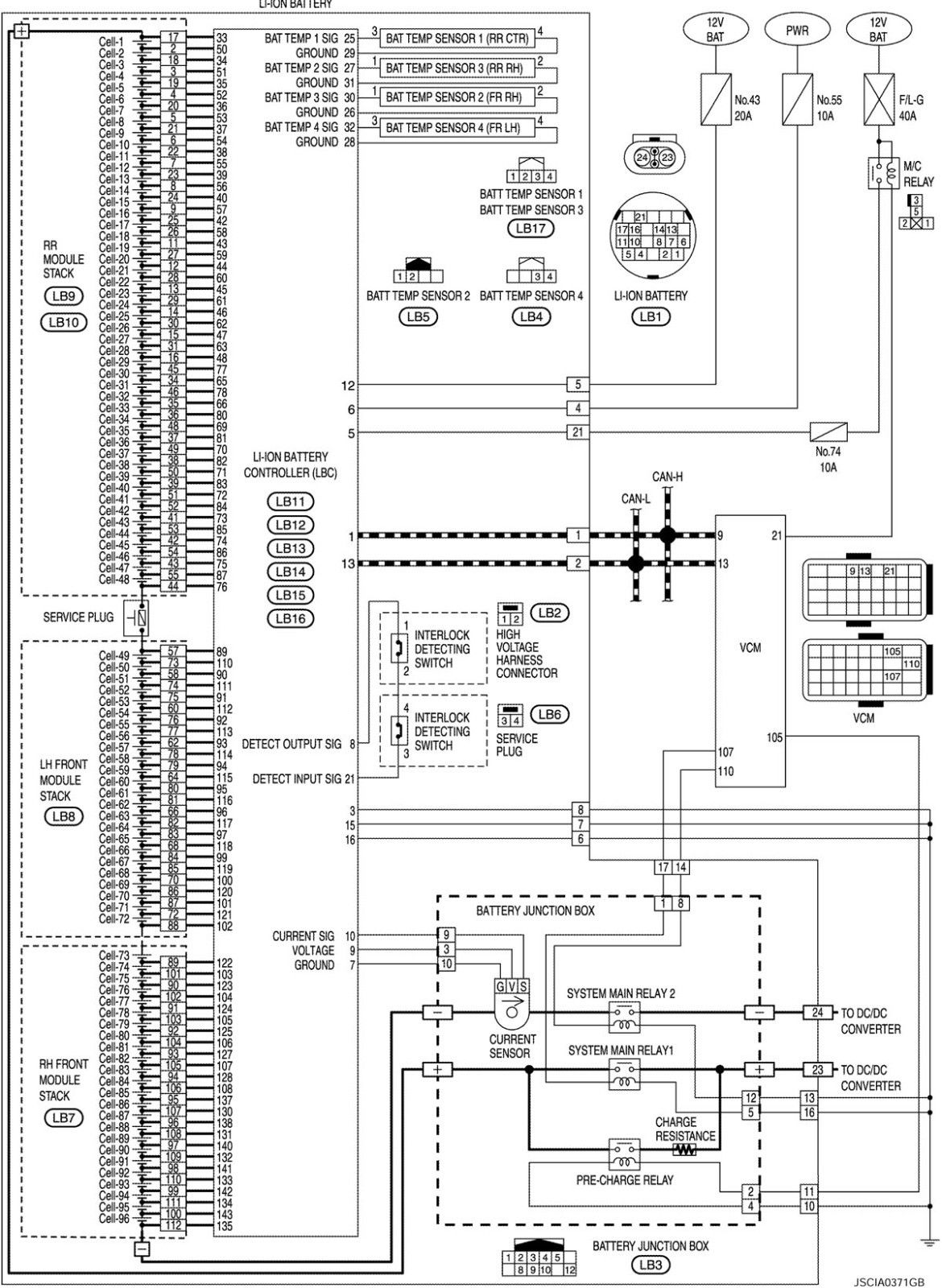

Yesterday I did the famous 'blue smoke' trick on one of the (all white ports) LBC's by accidently connecting the rear 48S battery stack WITHOUT the interconnecting cable causing some fumes and burned diodes
I have created a conversion cable for connecting a second 48S stack to the last 2 connectors that normally connects the two side battery stacks.
Looking at the diagram and comparing with the wiring loom I discovered some unregistered wiring on the LBC. Presumably these are for the 'winter edition 'Nissan Leaf for enabling pack-pre-heating for Scandinavian countries.

I've noticed a difference between the 'white' and 'grey' versions of the LBC wiring on connector LB11 (top left).
The grey wiring loom has empty slots at pin 4, 11, 16,17,18,19,20,21,22,23,24.
The white wiring loom has empty slots at pin 2, 7,11,14,18,19,22,23,24.
The 'present/interlock' signal is (according the schema) populated between pin 8 and 21.
So pluggin in the white loom in grey LBC (and vice versa) doesnt fully work.
According schema (white LB11 connector) pins are as follows
1 CAN High
2
3 GND
4
5 Charge mode +12V
6 Ignition mode +12V
7 Current sensor GND
8 Interlock output

Re: Nissan Leaf BMS
And the wiring loom with grey connector is as follows:
1 CAN High (LB1 pin1)
2 GND1 (LB1 pin8)
3 GND3 (LB1 pin6)
4
5 CHG IGN (LB1 pin31)
6 interlock
7 IGN (LB1 pin4)
8 interlock
9 current sensor Voltage
10 current sensor Signal
11
12 +12V Bat (LB1 pin5)
13 CAN low (LB1 pin2)
14 GND2 (LB1 pin7)
15 current sensor Ground
16
17
18
19
20
21
22
23
24
2 GND1 (LB1 pin8)
3 GND3 (LB1 pin6)
4
6 interlock
7 IGN (LB1 pin4)
8 interlock
11
14 GND2 (LB1 pin7)
16
17
18
19
20
21
22
23
24

Great, thats valuable information (diagram) for the grey connector version LBC's.
So now we know why Johu gets a different result on the interlock signal when using the white or grey LBC on the same loom because they changed the pins from 8-21 on white to 8-6 on grey.

Re: Nissan Leaf BMS
Oh you're right! That is really strange. When I remove the connection between 6 and 8 the BMS sets the discharge limit to 4.5kW and I think it displays some error. But now I see they just tie pin 6 to 12V - permanently or on ignition? When is pin 5 activated?

Re: Nissan Leaf BMS
I see that according diagram pin5 is enabled by the VCU and i guess when you plug the charging connector it enables the BMS in 'charge' modus and probably onyl then starts to balance ?
