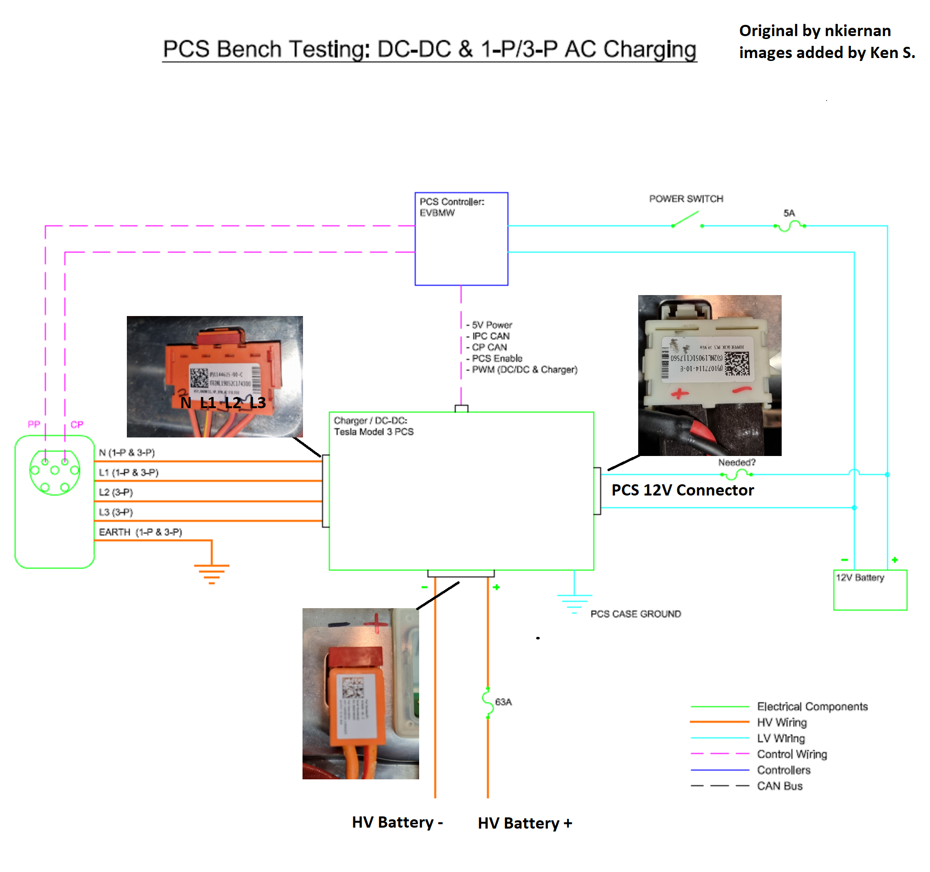

As there's some discussion on testing if PCS's are working with the PCS controller, I'm setting mine up to check. If its not working I can get it to Damian quickly if needed.
To play it safe, I wanted to get some confirmation on the safest setup for testing as some of the group have already worked through this and looking through the thread and wiki there are a couple of things I'm still not sure on, others have asked but I can't find all the answers. I'm hoping to keep the setup as simple as possible to rule out adding in issues with too many components. Once I get this sorted I will do a layout for DC fast charge testing with the i3 LIM.
Attaching the same quick layout in image and pdf below in case it needs blown up to read.
Queries:
1. My understanding is that pre-charge is needed for the PCS. Some chargers do not, but the PCS needs this. In the HV controller thread the pre-charge system has been working via CAN, but I've drawn in a typical contactor and resistor setup as a straightforward option. Query is if this is definitely needed and what is the simplest way to implement? I don't see that the PCS controller is set up to control the contactors and then a shunt is needed to measure the pre-charge voltage so to me its looking like I need to introduce the VCU as well?
2. For the charge port ground/earth pin, this goes to chassis ground, so the 12V system ground, same as the PCS case ground?
3. I expect a fuse is needed on the 12V positive line from PCS to 12V battery, but this wouldn't be typical in an alternator to battery set up, just extra precaution?
4. Can the PCS firmware version be read from the web interface or in the CAN data to help share what versions might work or not?
5. What CAN data is useful to capture to help troubleshooting, CP, IPC, both?
PCS_Testing.pdf
(130.45 KiB) Downloaded 322 times

I was going to add this directly to the Wiki but having never edited the wiki here before I don't know the ettiquete, and upon second thought I decided to share here first so that my work can be checked.
I put together the attached diagram in preparation for bench testing my PCS before installation in the truck. It is just a rollup of snippets of information shared by others in this thread, including the helpful diagram from nkiernan and labeled connectors from fredd90... good thing I did because I was confused about which connector was the HVDC and which was the 12VDC! I am glad I didn't get to see that fireworks show. If anyone sees anything else wrong, please share!
There is one remaining question I have: What is the minimum DC pack voltage needed for testing functionality? My vehicle pack is currently disassembled, but if I can use just 1 (92v) or 2 (180v) of the model 3 modules in series, I will use them... if I need a higher voltage, I have a large number of new 18650 cells and a spot welder... my backup plan is to assemble a temporary 96s1p pack :shock:

Ken_S wrote: Wed Aug 17, 2022 4:39 am What is the minimum DC pack voltage needed for testing functionality?
According to V3 parameters min battery is 50V. Set the max voltage for the charger to a conservative lower number this is to verify the charger is functional. Once you verify that it functions as intended, set the normal charge voltage. Remember to "save to flash" with each parameter change.
Posts: 4006
Been thanked: 1136 times
Given past experiences with Tesla chargers I would not try using the PCS with anything under 200v (250v to be safe) but I could be wrong. Finally got around to building up a controller and connecting up to my first non working PCS. Noticed the wiki page is very sparse so a few diagrams on there would help for sure. I drew out a rough diagram showing the pin assignments from the PCS data connector to the V3 controller. Perhaps someone more artistically inclined than myself could make it look nice. First order of business is a log from IPC can with just 12v connected to the pcs. No need for HV DC or AC at this point as there is no point trying to enable the unit if it is reporting faults due to CAN in the error matrix previously discussed. To that end CONN2 on the controller provides access to IPC CAN and the white and black wires in the picture can be seen connected to a logger running SavvyCAN. If anyone genuinely wants to help with the process then a log from IPC CAN under the circumstances described along with as much info about your particular PCS would be ideal.
Logging setup : 12v only, connect Input 1 on the v3 controller (pin 5) to 12v. Commence log recording, On the web interface set "inputype" to manual. Record log for 30 seconds , power off and save log then post here.
