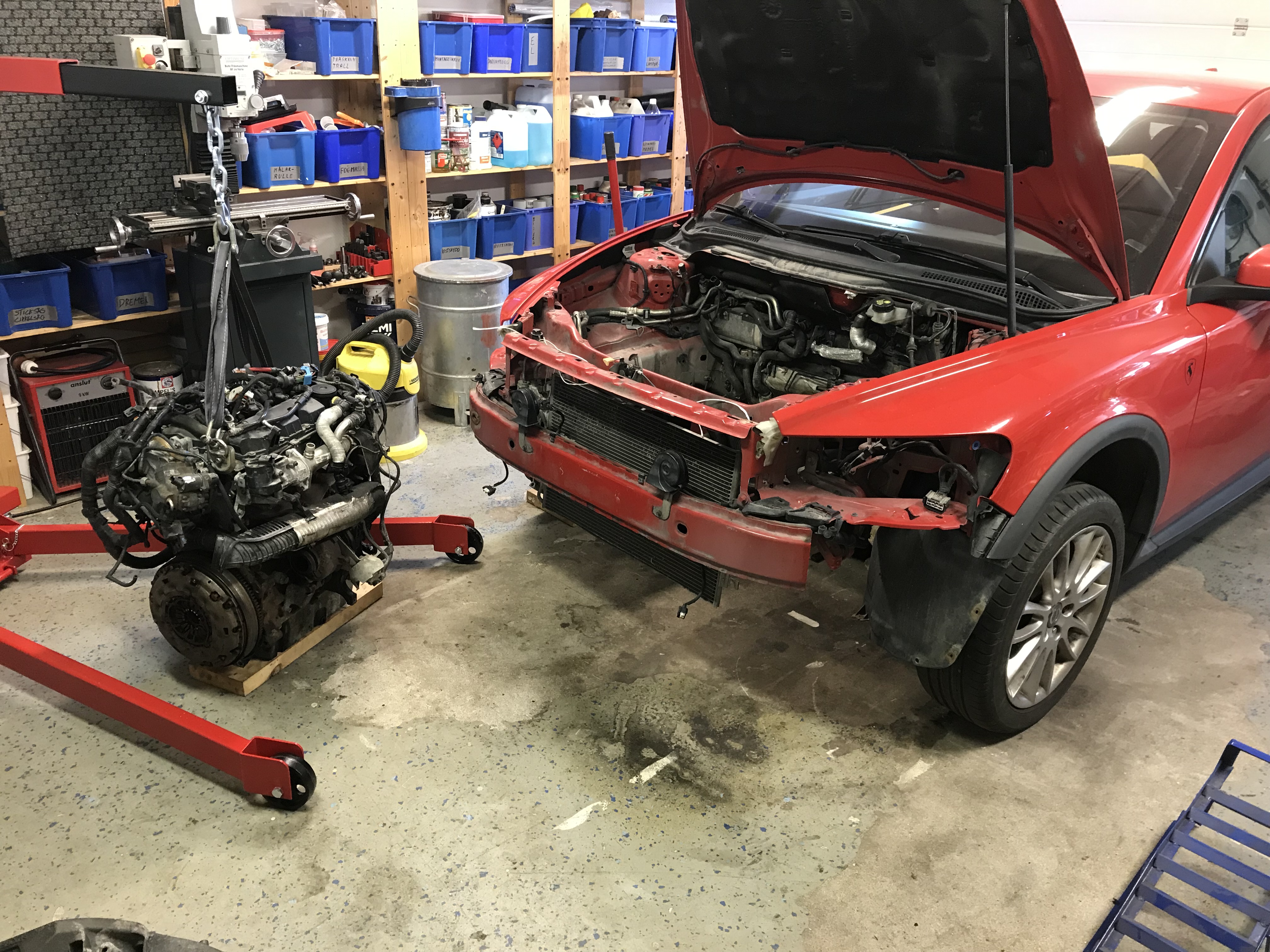

Oil burner removed.
Left to remove is shift linkage and diesel powered auxiliary heater before I can start fitting the electric drivetrain.
