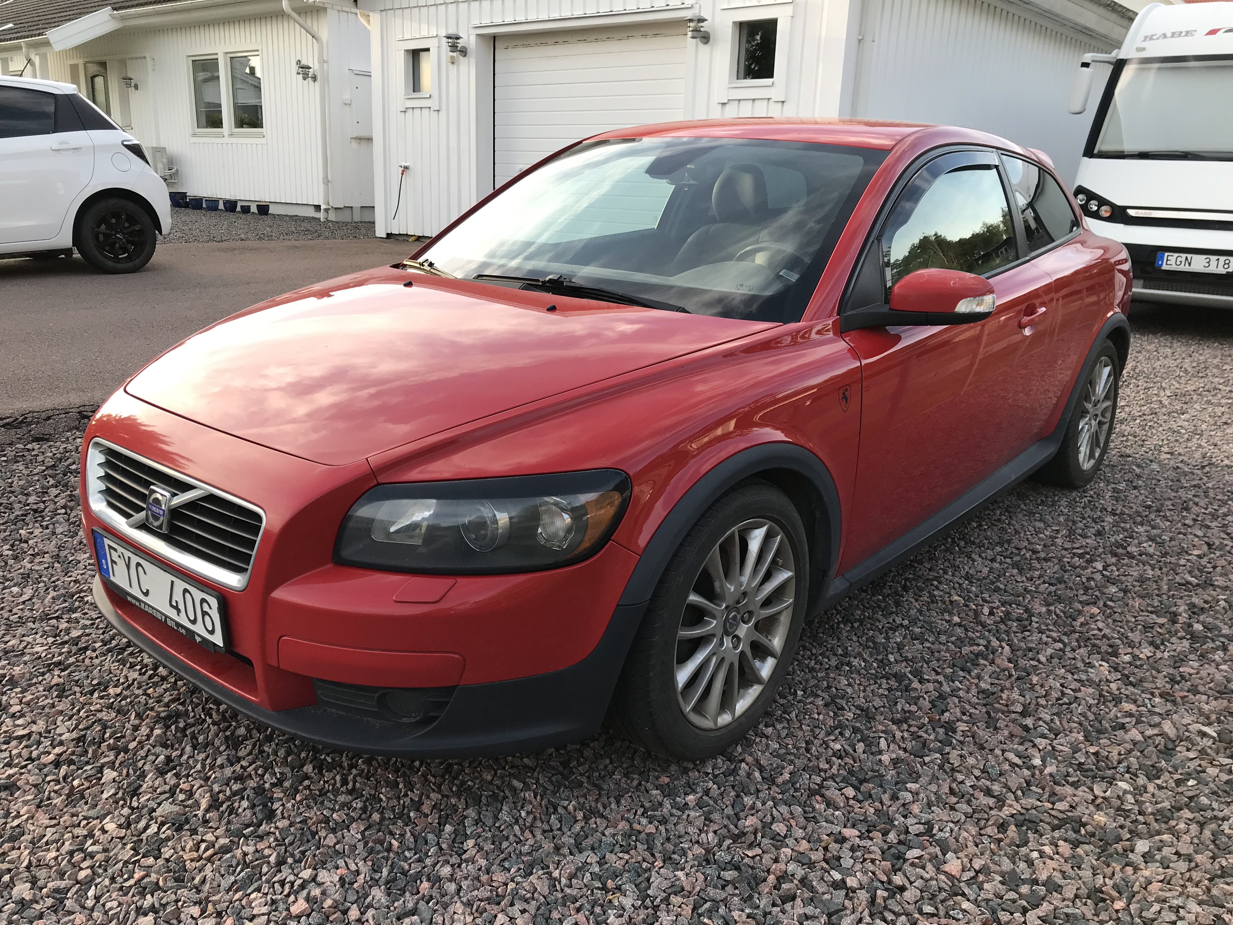

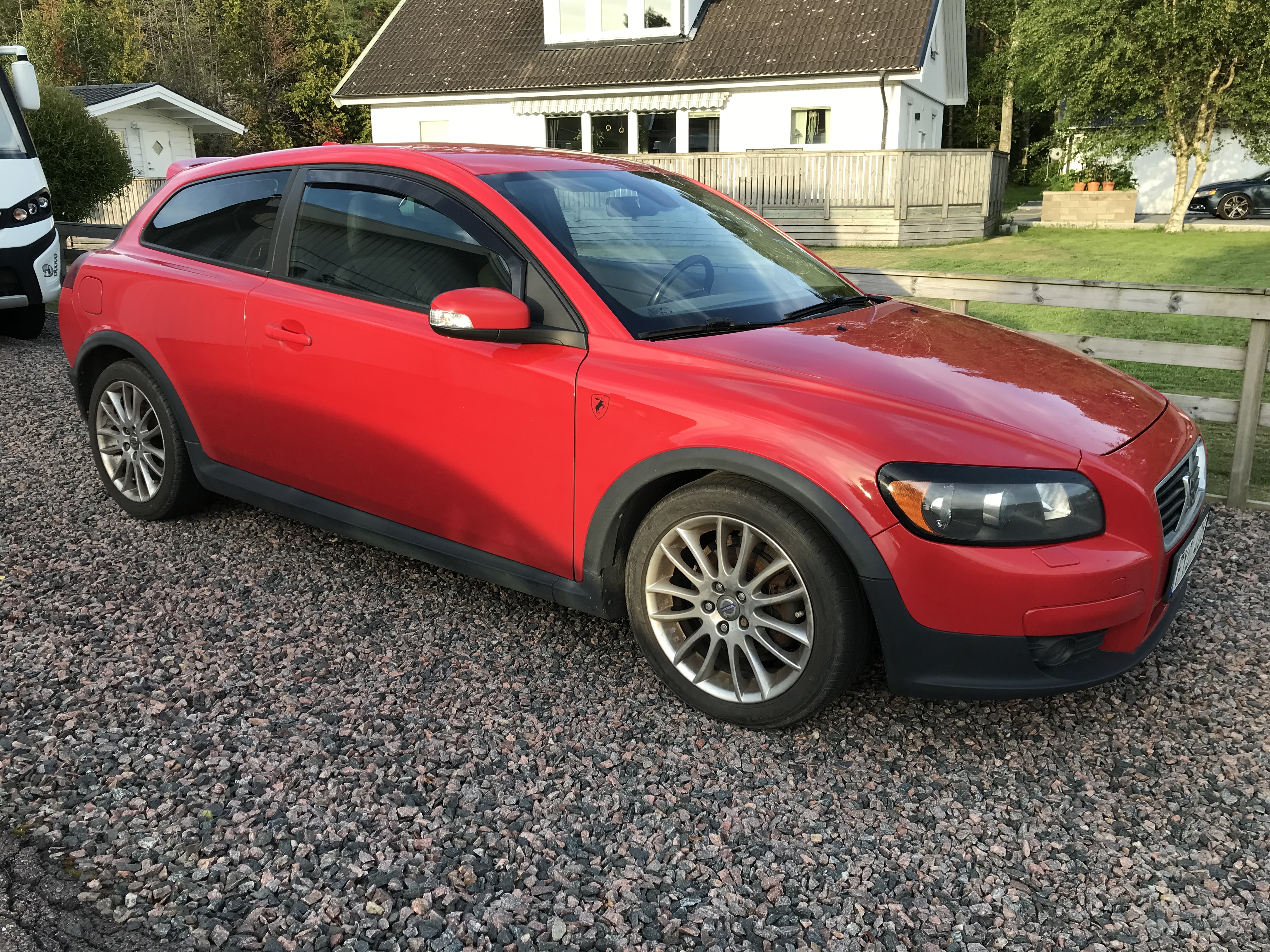

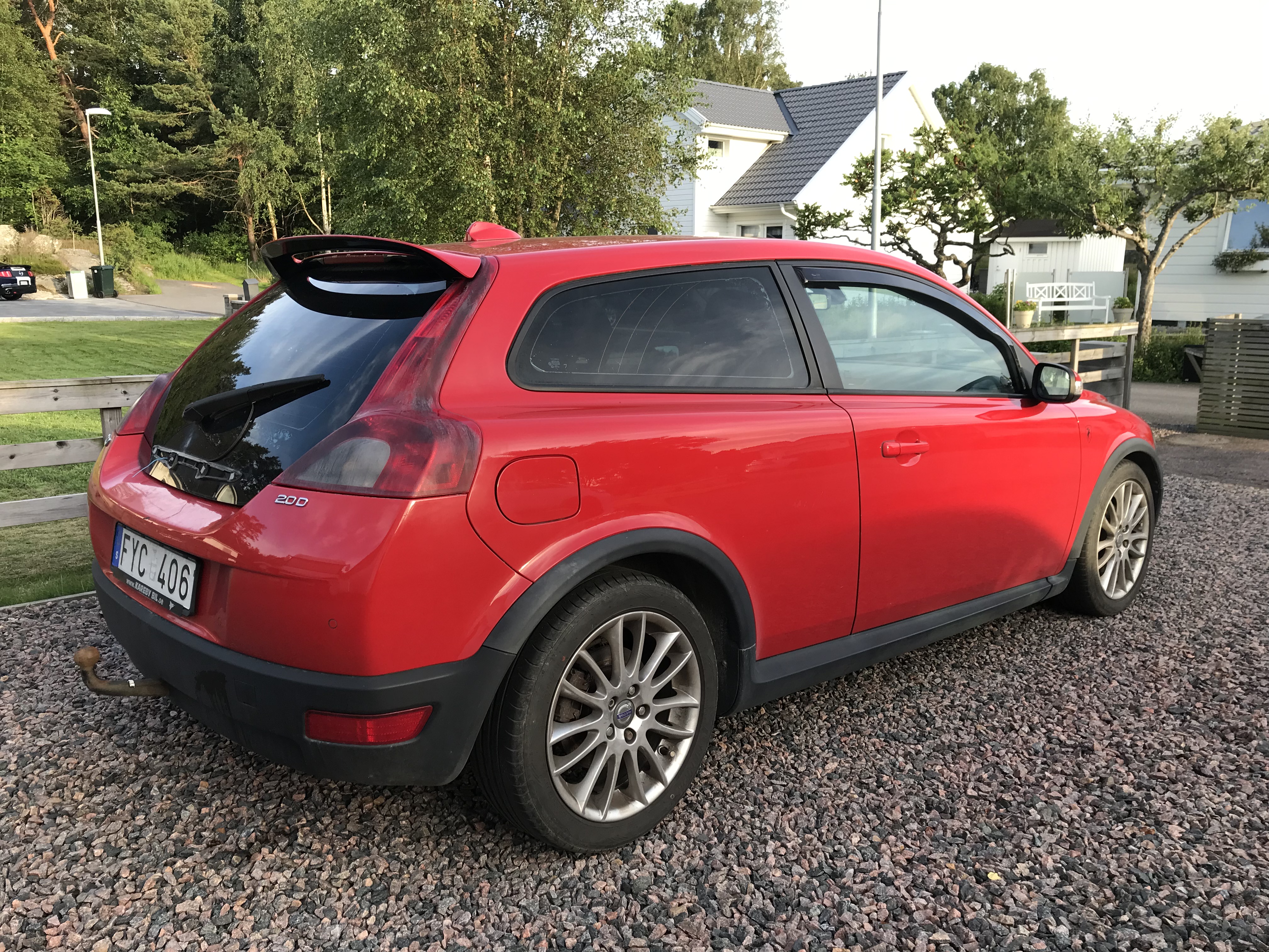

Creating this thread as I just bought my next project car, a Volvo C30.
My plan is to replace the sad old diesel engine with the motor, inverter and gearbox from a Leaf or more specific, the drivetrain I'm currently running in my Clio.
Battery is not yet decided but 80-96S and 15-20kWh is the baseline.
Charger will be based on Eltek FlatPack's.
The hardest work will most likely be to hack the HSCAN-bus to be able to emulate the removed ECM.
The C30 platform is shared with Volvo S40, V50, C70, Mazda 3 and Ford Focus. I think the S60 shares the same electric architecture as well. But I haven't found a great deal of information online.
Some basic information about the Volvo CAN: So if anyone knows a good source of information regarding Volvo HSCAN messages, please share.
I have installed SavvyCAN and just bought a Arduino Due so will start diggin in to CAN-messages soon.

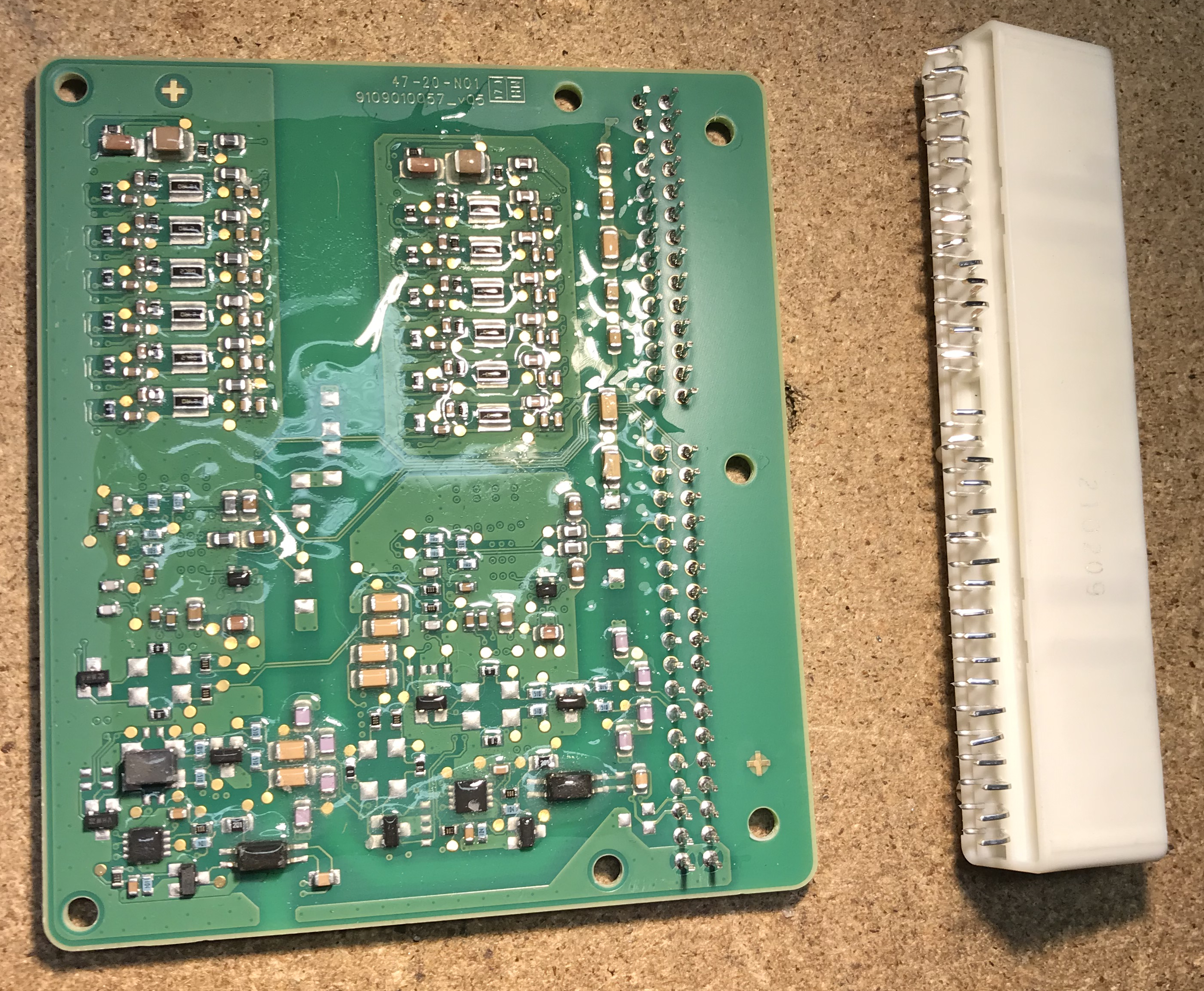

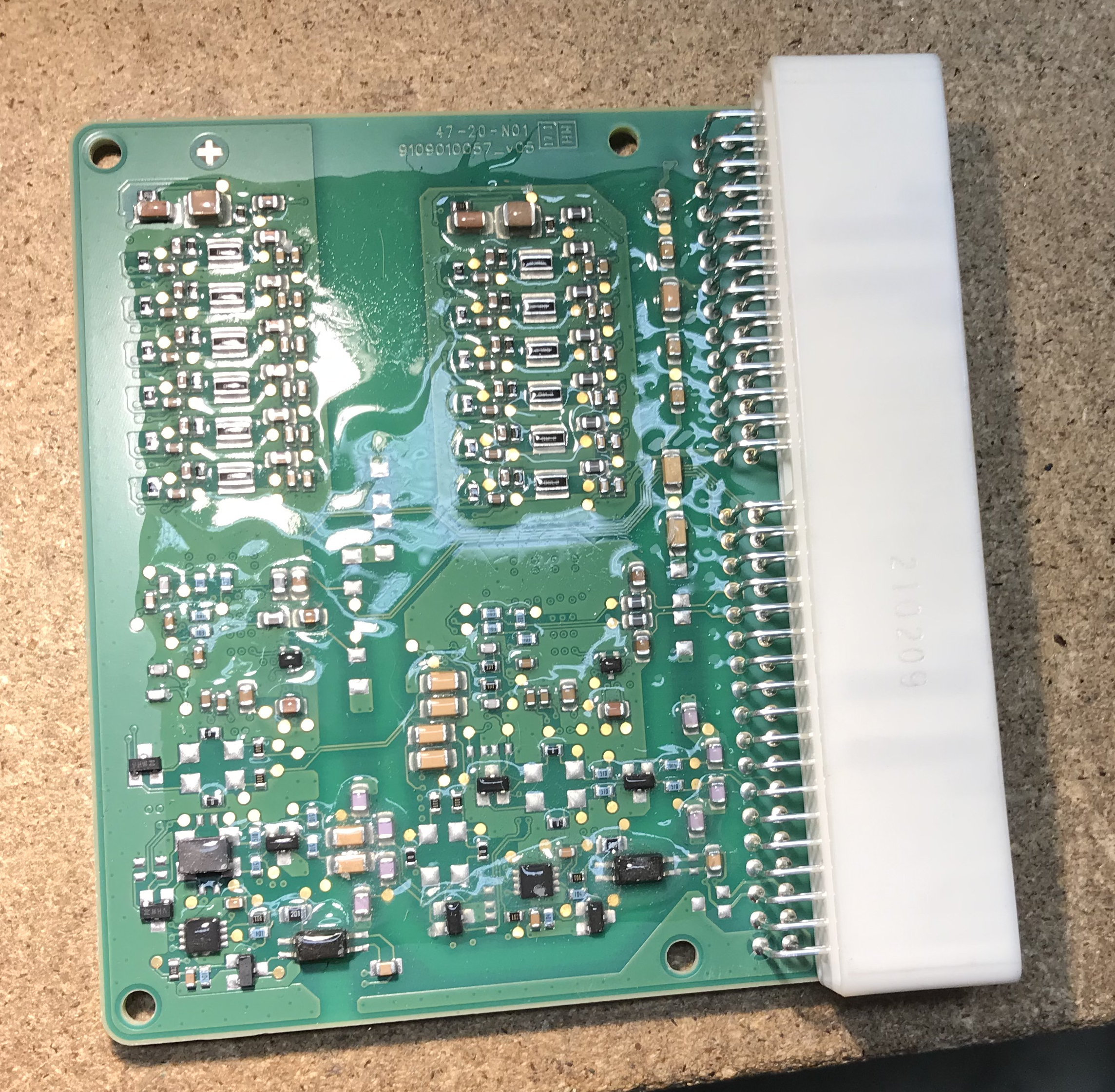

The CEM cracker history is described in the first link on the edit.
To explain what it is I have to tell a bit of a longer story:
VIDA does not contain any software for any of the modules in the Volvo. If you want to flash a module, you have to access it from the Volvo servers (which is obviously not possible for the *cough* copies of VIDA). This is usually quite an expensive endeavour as well.
There is some software from Eastern Europe (like VDASH from the d5t5 Website) which can read and flash modules without accessing the Volvo servers from previously read images. This can be important when you change any module in the car, because it's usually programmed to the VIN.
The CEM however is different from other modules because it contains a PIN that is necessary to initialize the flash mode. The CEM Cracker software uses a quirk in the microcontroller to guess the PIN. With that PIN you can read and flash the CEM with VDASH etc.
For your application, this is not incredibly useful though. I don't think there's a need to flash the CEM (except if you want to reverse engineer the CEM microcontroller program and disable the immobilizer
All of this trouble can be circumvented though if you just access the programming port on the PCB of the CEM. VDASH works via OBD/CAN and doesn't require opening the module.

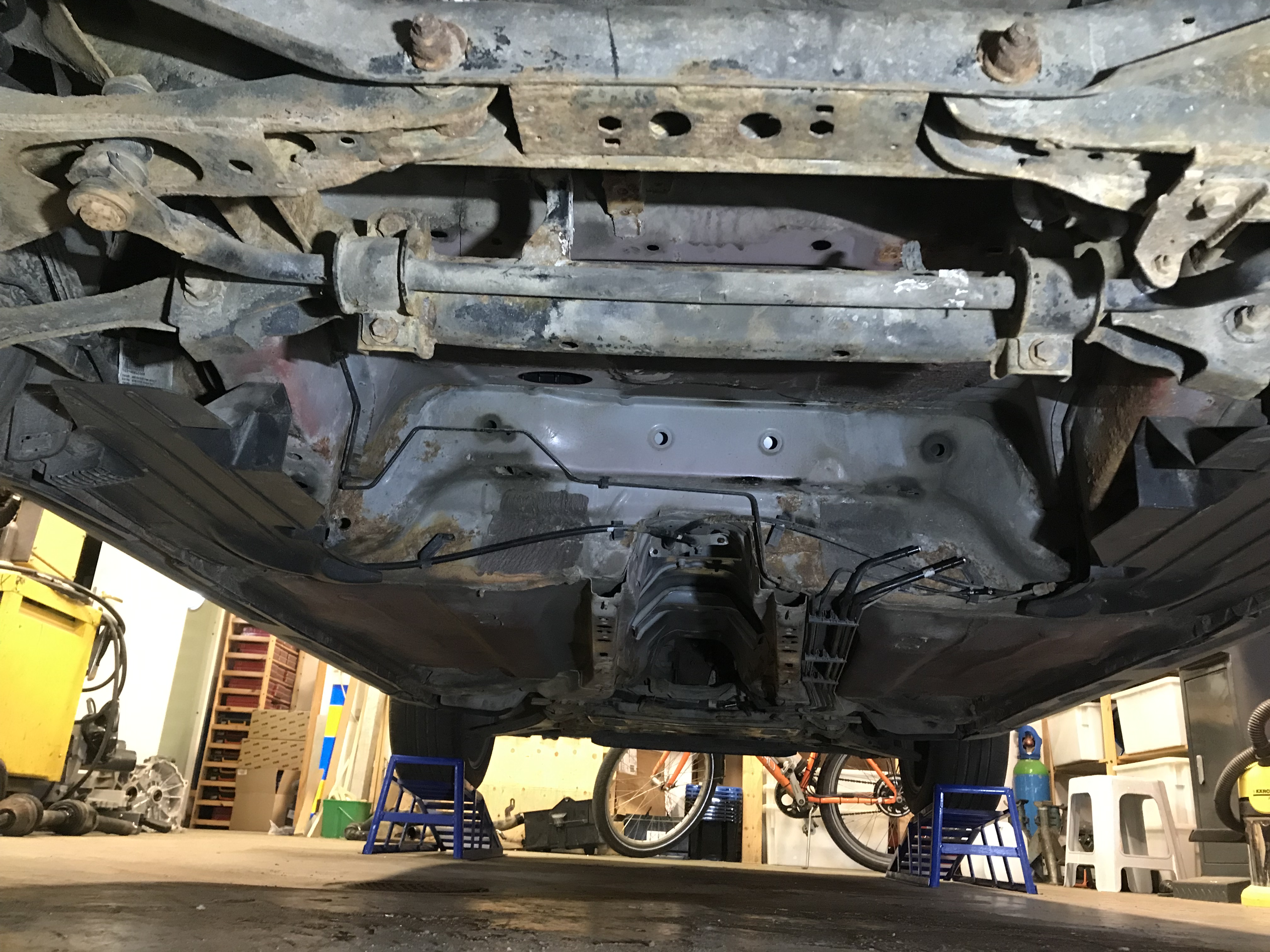

Re: Volvo C30 with Leaf drivetrain

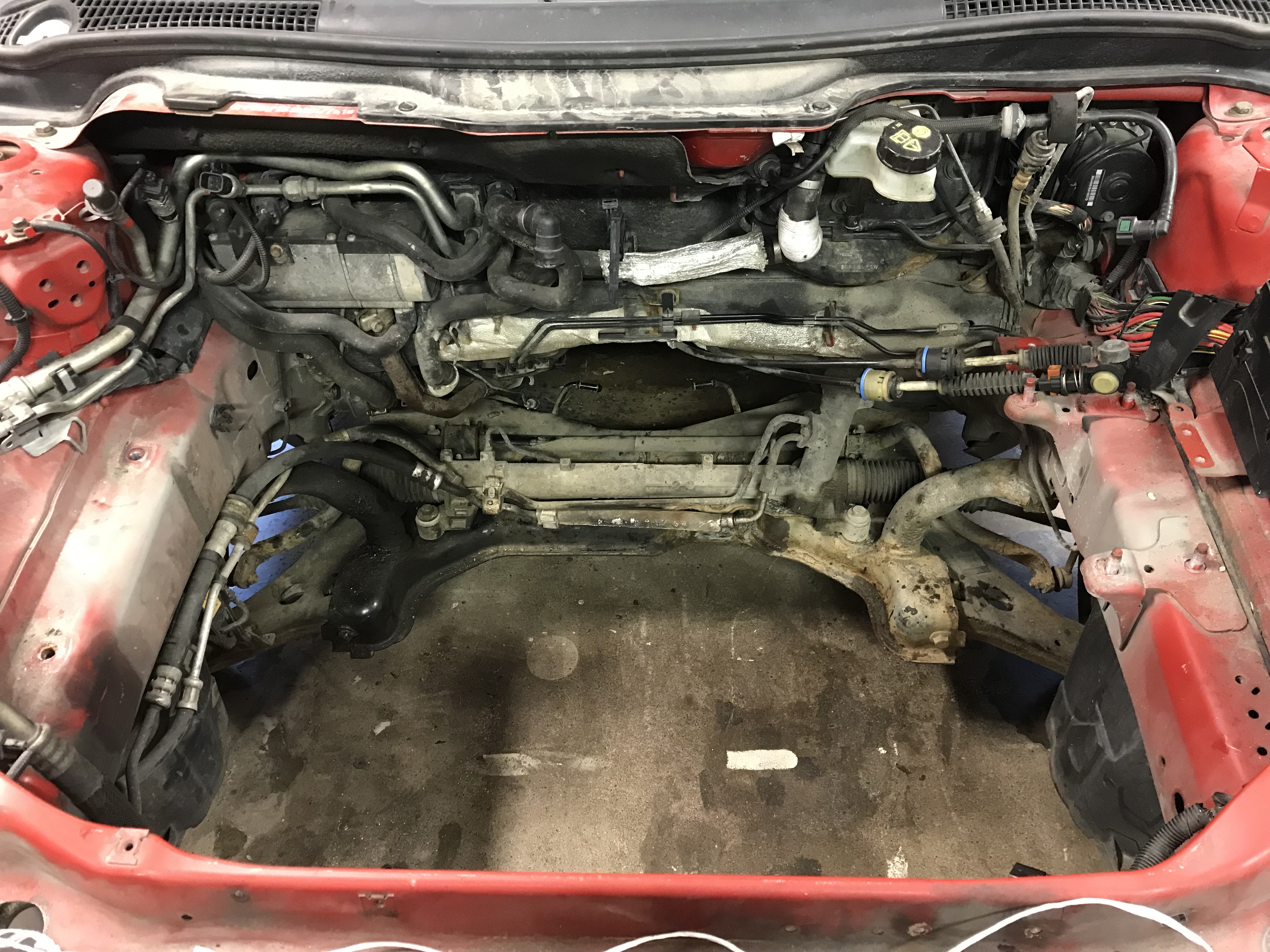

I have now removed entire exhaust system incl. cat and dpf and fueltank to find out how much space there is to use for batteries.
E-up battery is 36kWh with a weight close to 200kg for the modules.
I have found another option by using cells from Kia Niro. Will be more work but a 84S1P configuration would provide 19kWh with a weight under 100kg.
Niro option easier to fit, but I think there is enought room to fit e-up battery if some moduleas are placed above the rear axle subframe.
Leaning towards the Niro option as I really like low weight and rarely do longer trips.

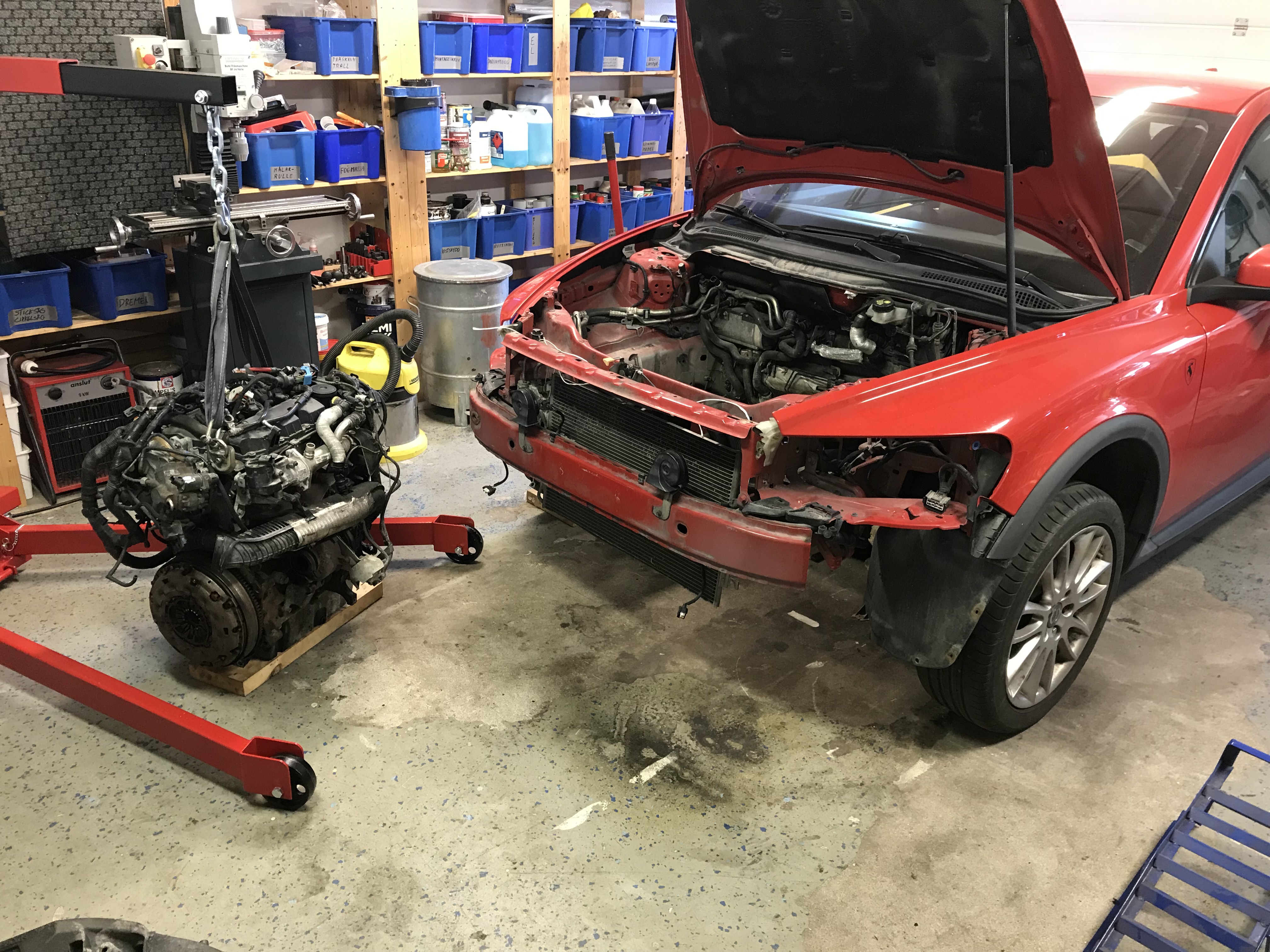

Oil burner removed.
Left to remove is shift linkage and diesel powered auxiliary heater before I can start fitting the electric drivetrain.

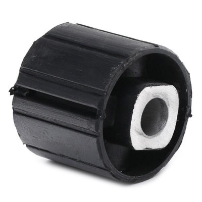

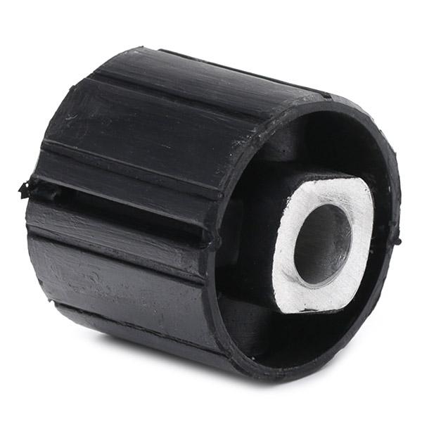

I've started mocking up drive unit mounts for the leaf motor/gearbox. In my Clio I used differential bushings from a BMW E39 as motor mount.
Fits well in a tube with ID: 53mm, 45mm length, and works well with a M14 bolt. It is very easy to use but it is quite stiff an so I ask if there are better bushings out there that might be a bit softer?
To my understanding the Outlander rear diff mounts are quite soft. Would love to use such bushings but I have not found them as lose pieces, only together with aluminium bracket?

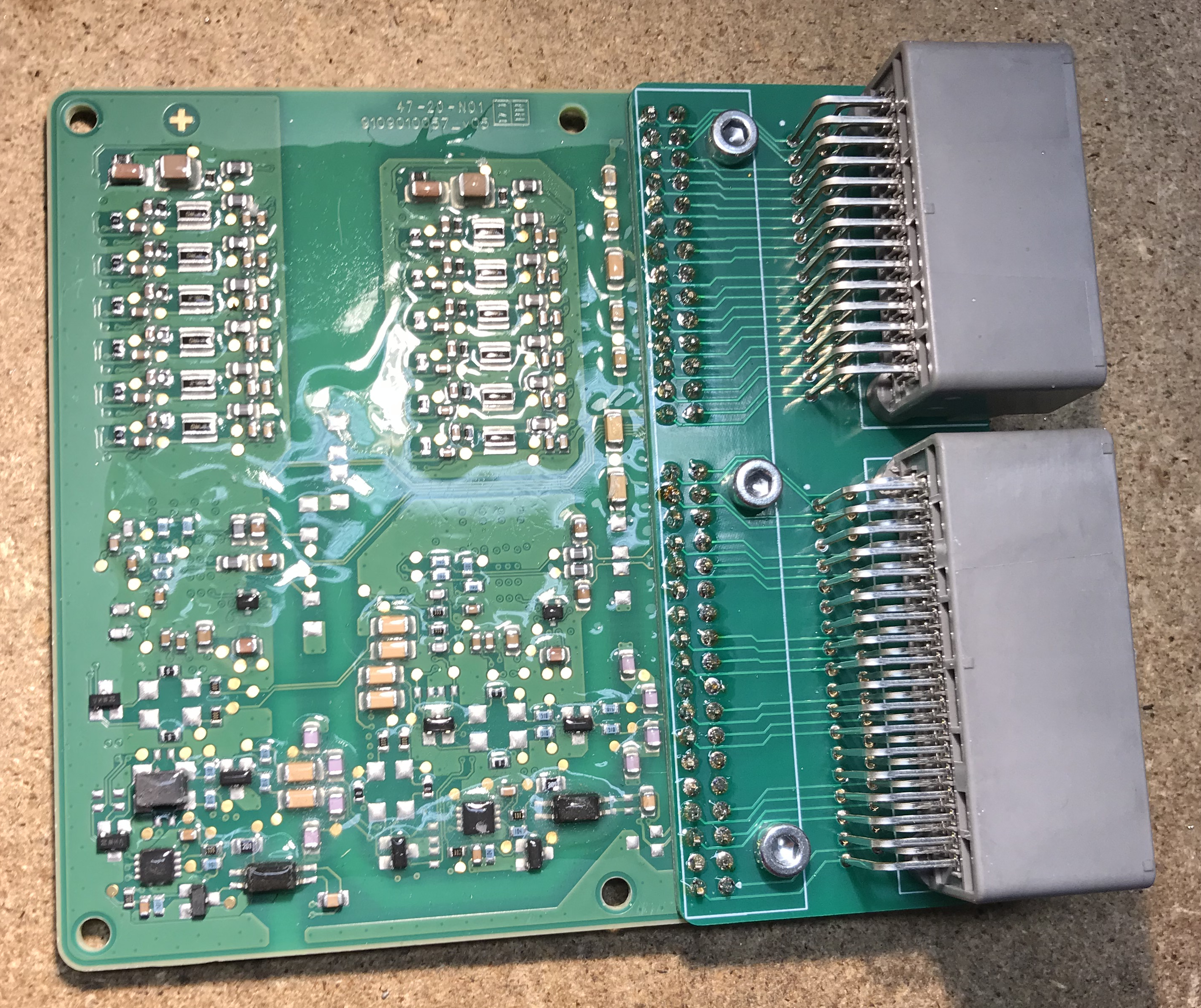

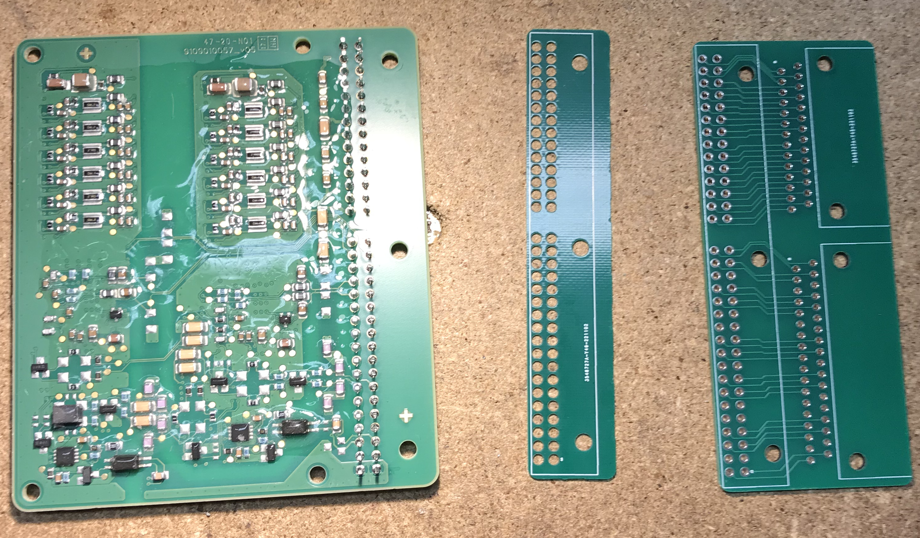

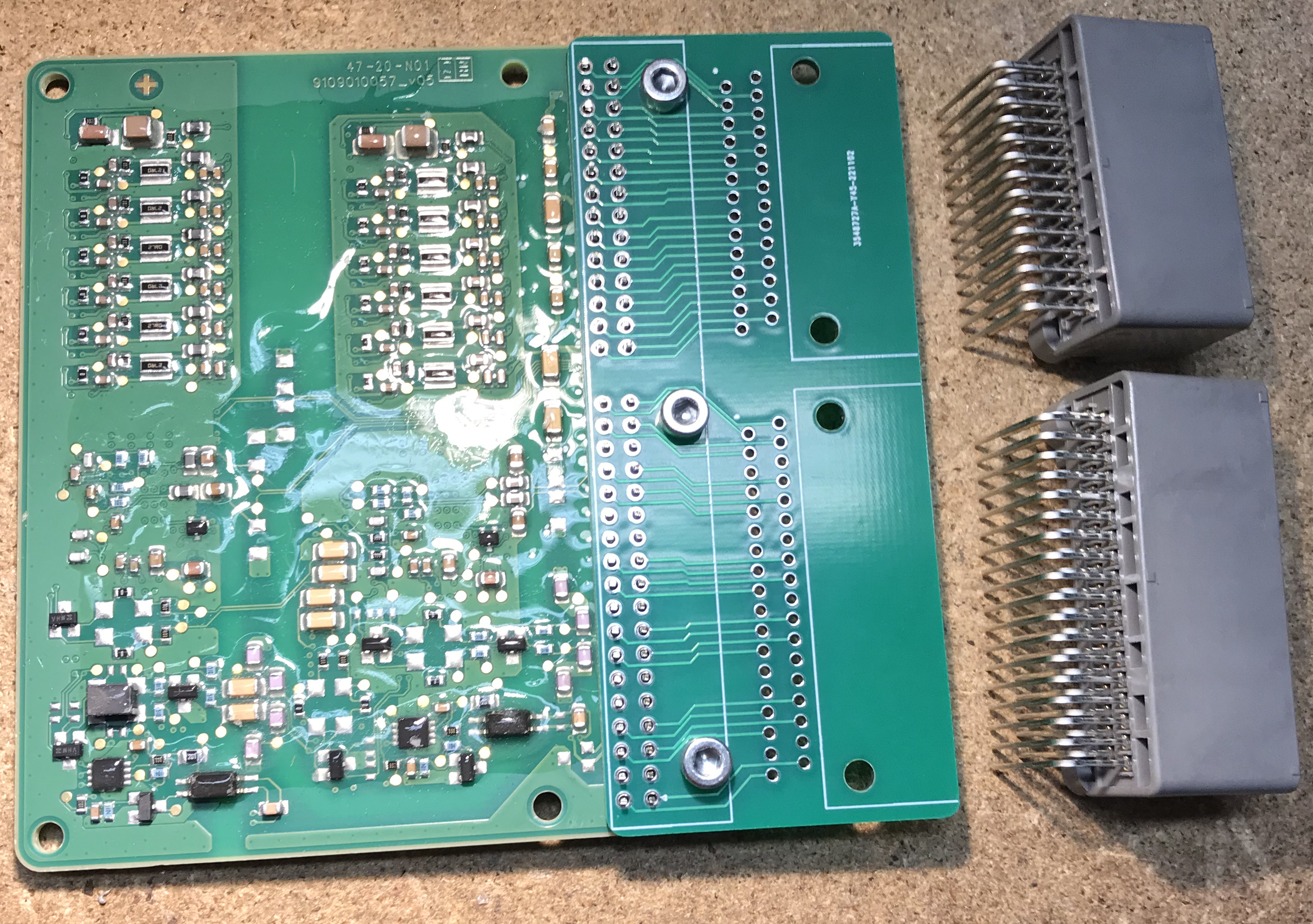

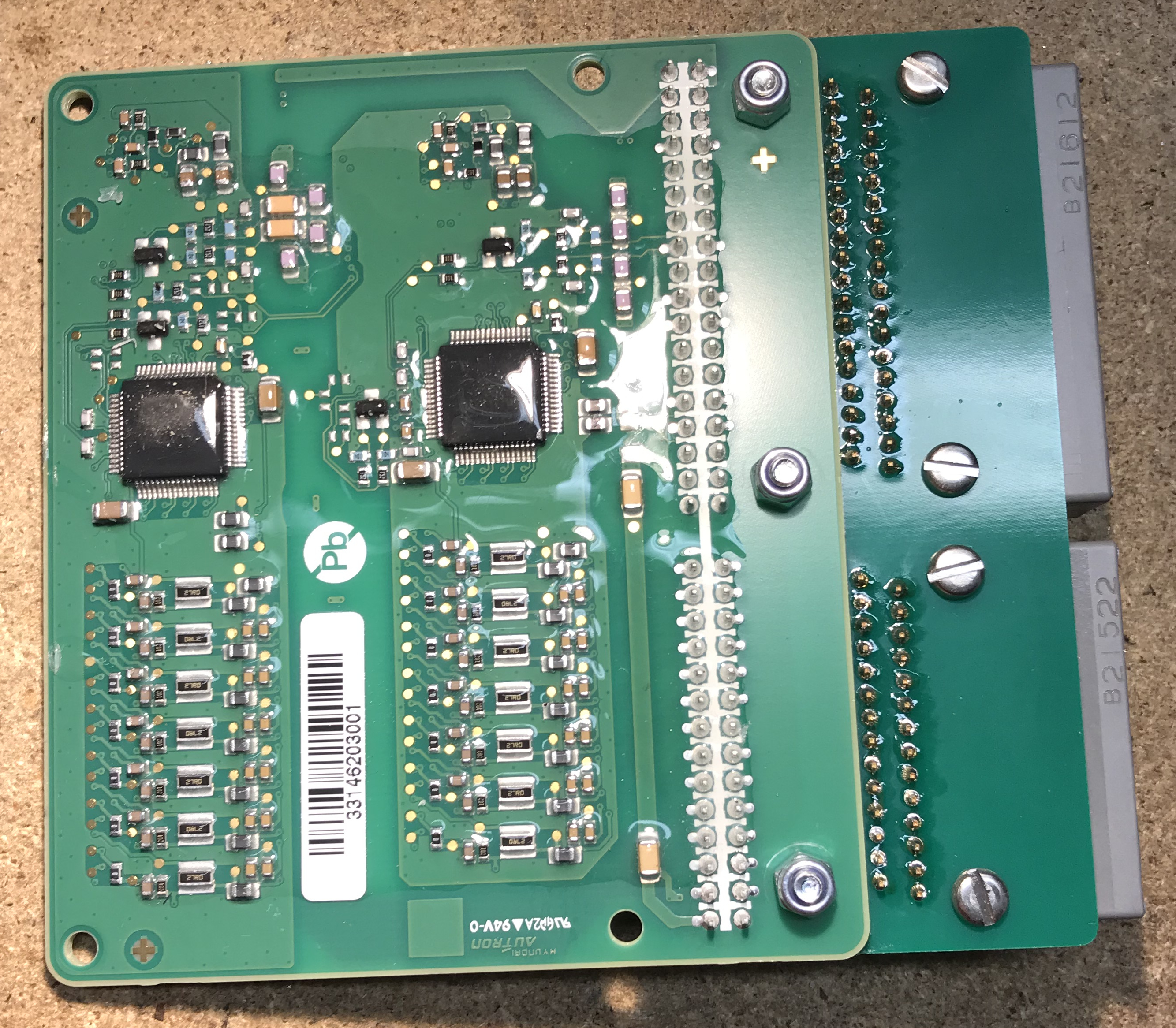

I'm currently building the battery pack and it consumes a lot more time then expected... Will post pictures once it is built.
I have made an adapter board for the connector on the E-niro BMS slave modules. I don't like pigtail wiring join mid-wire but rather connectors that can be bought with new crimp pins for neat wiring harnesses. In order to do so for the slave modules the connectors need to be replaced, hence my adapter boards. This mod makes the slave board 20mm longer and a few mm higher.
BOM:
https://se.rs-online.com/web/p/pcb-headers/6908903
https://se.rs-online.com/web/p/pcb-headers/6908916/
https://se.rs-online.com/web/p/automoti ... s/6909855/
https://se.rs-online.com/web/p/automoti ... rs/6909868
https://se.rs-online.com/web/p/crimp-contacts/6909899
Gerber-files:

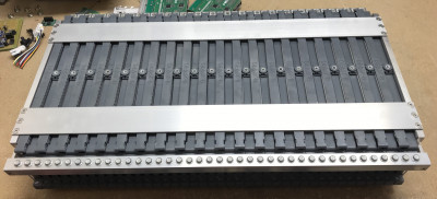

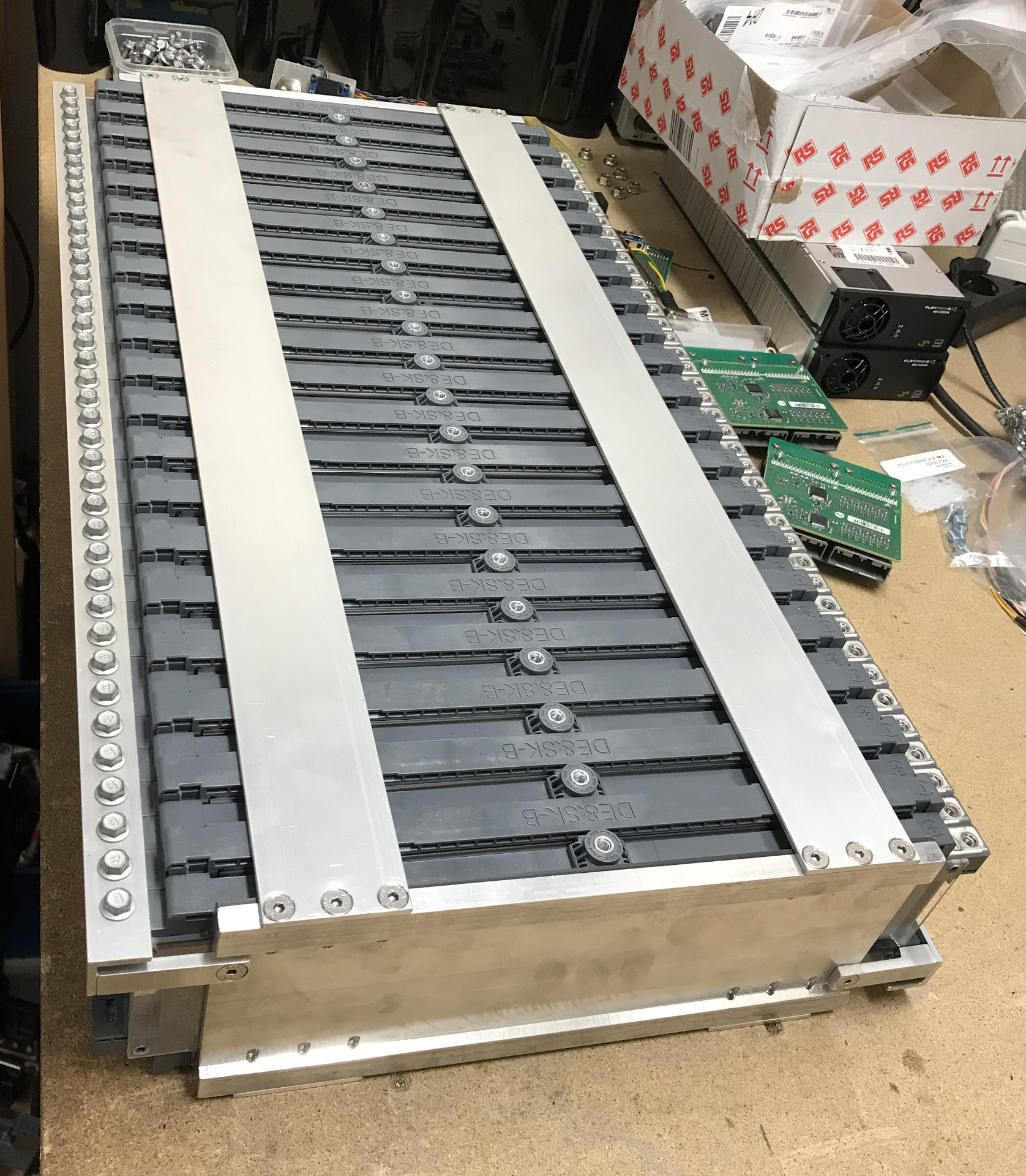

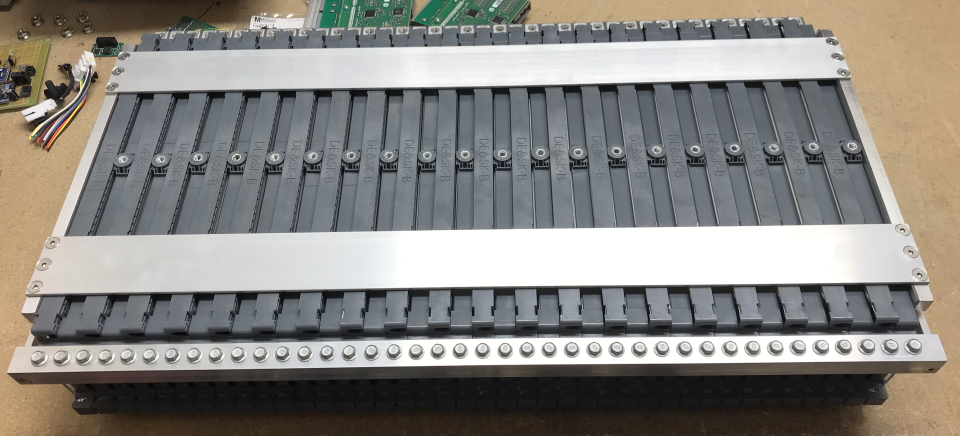

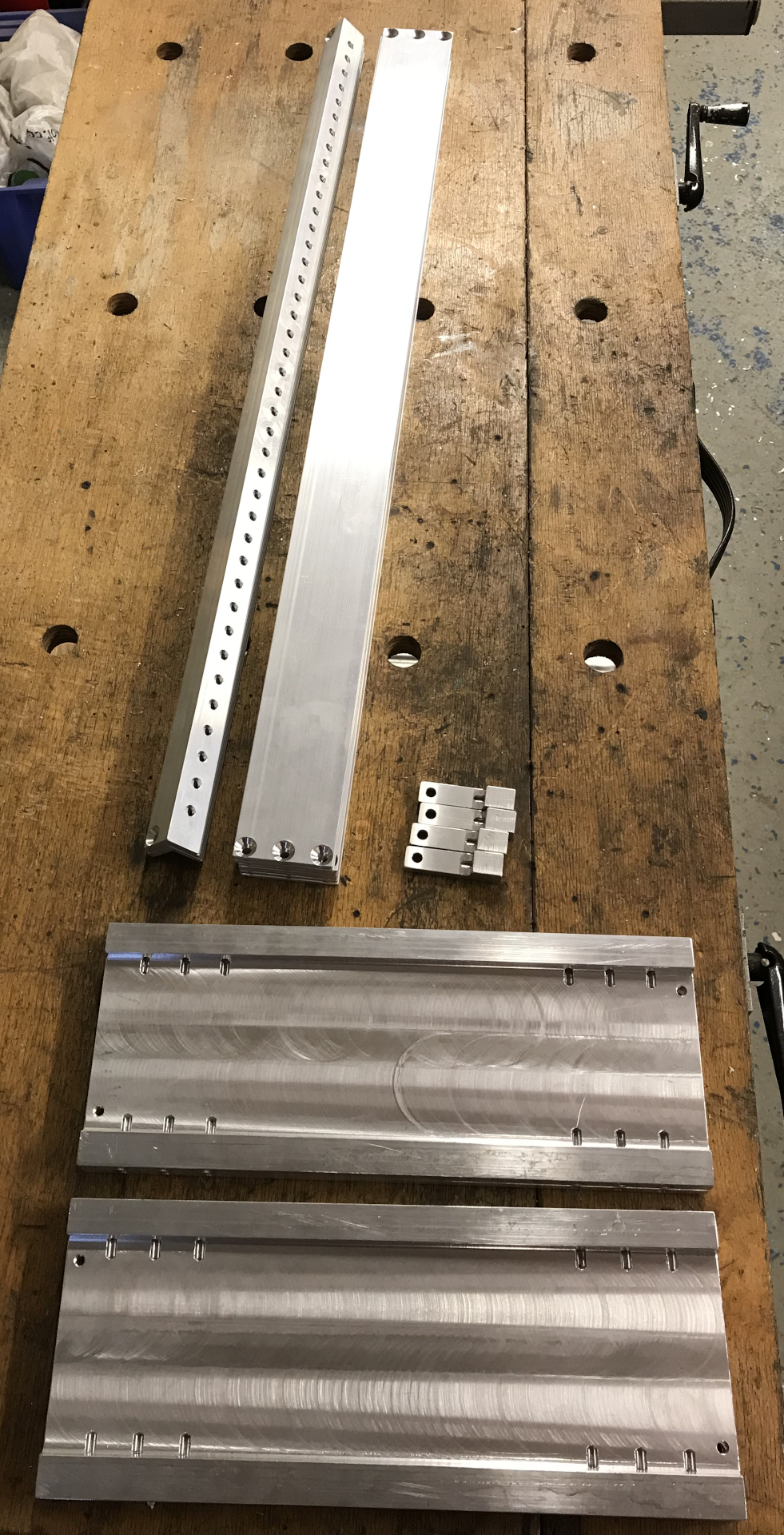

Finally some progress with the batteries. Have been spending quite some time with my mill to produce this:
Today I was finally ready to assemble:
Both modules are done even though the pictures only show one, 40S in each. Weight is just shy of 44kg per module.
Next is the contators and precharge. Also need to sort out busbars and BMS connection boards.
