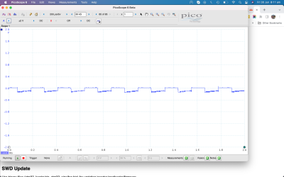

I'm having trouble spinning a motor in open loop mode with a block III board. I'm pretty much just following the steps I did for the gen 3 prius setup I've got in the car.
The gate driver pwm signals are present when probed in manual mode. I've tried various firmware versions. I've probably missed something silly or have a dead inverter.
Any ideas to try/debug?

2nd inverter also not spinning the motor. I must be doing something wrong.
EDIT Does the PWM look ok? I don't think 0 to -0.1 looks right?

Assume that is on a phase output with the ground on battery 0v? In that case no it doesn't look right but it is encouraging that there is something there.
Any more details/pics of how you have it connected/wired up?
Assuming that you are running the HV at a low, safe voltage I'd be inclined to run it without the cap pack so that the board is accessible for testing. Without a motor connected check that all the power rails from the logic board to the IGBT board are right and also check the pwm waveforms to the igbt board. If they are all correct look at the main phase outputs, if everything is right you should see a square wave at the full pack voltage with varying duty cycle. Even without the main cap pack there are still a couple of caps on the HV bus bar (one in the middle and one on the far end) so it should be safe to also try running a motor without the cap pack connected but keep the currents low (say 10-20A).

Re: Toyota Auris and Yaris Inverter Logic board
This is the driver signal. There's nothing on the phase outputs. Got a 44v battery hooked up to HV.
Probed each via in turn and the gnd attached to the 12v gnd. Using a sine version firmware I know works 4.94, starting the inverter in manual mode, the noise starts as expected, set ampnom to 100 and fslipsnpnt to 10 then probed.

I did notice on my Prius inverter that when in the fault state the igbt board turns off the supply to the pwm input pullups (effectively disabling them). Could that fit with what you see?
The pwm signal into the board should normally be a few volts (think the pull up is to 5v).
Don't understand what the noise is if there is no PWM?
Edit - have you checked all the 5v and 12v supplies to the igbt board are ok?

Not sure where to probe on the IGBT board. I've checked the voltages on the logic board, those are still good.
There's PWM at the transistors, though voltage is pretty low.
Double checked the IGBT connector soldering, that looks good.

On the base of the transistors you should see a square wave between 0v and around 0.6v. On the collector is should be a few volts.
If you can see 5v/12v on the igbt board side connector pins it should be ok.
Could the pwm transistors be the issue, duff or incorrect parts? Do you have any way to test them (should be possible to check with a multimeter in diode test mode)?
Edit - still don't understand noise without pwm, you must have pwm if you can hear the inverter whine?
Edit2 - what do you see on the other side of the collector resistor (or connector pin)?

The IGBT connector looked fine under magnification, but I hit it again with the heat. Now have spinning in Sine mode, so can play this weekend with the auto tune branch
Now got a spare inverter

Guess it was a poor joint on whichever connector pin supplies the pwm optos?

Must have been. I guess the general rule for the Toyota boards, if in doubt it's the white connector.
