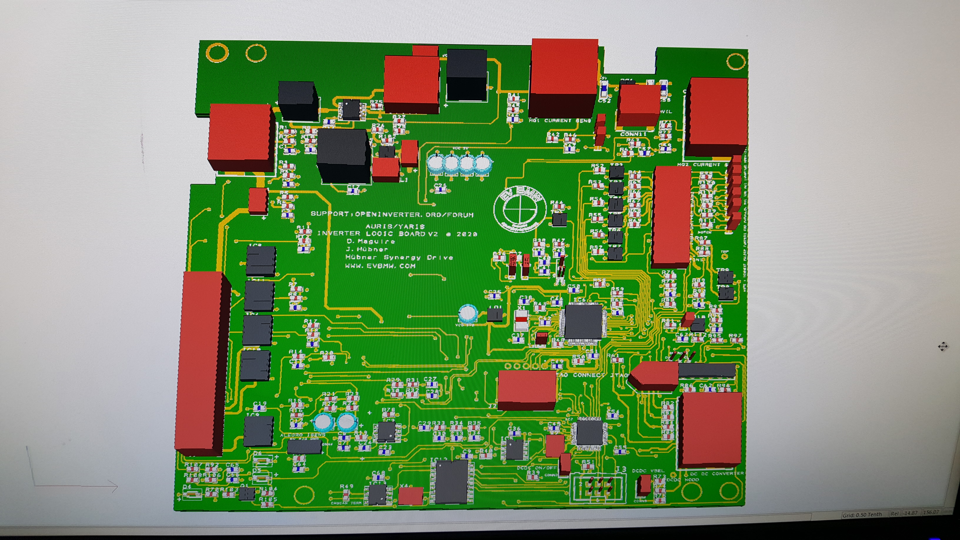

Setting up a thread for the new logic board for the Yaris and Auris inverter. Based on the V1c Prius board.
Resources and design files on Github :
https://github.com/damienmaguire/Yaris-Auris-Inverter
Available on the EVBMW.COM webshop in partial built and full kit format.
17/05/20 : Prototype build commenced at JLCPCB.
28/06/20 : Block 2 boards with corrections to incorrect pinouts and component values now available from the evbmw webshop. https://www.evbmw.com/index.php/evbmw-w ... -board-kit
UPDATE 24/09/20 Firmware now available to run the buck/boost module as an AC onboard charger:
https://github.com/celeron55/prius3charger_buck
Uploaded schematic and pcb layout to github : https://github.com/damienmaguire/Yaris-Auris-Inverter
Design files available to Patrons only as of this date. https://www.patreon.com/evbmw

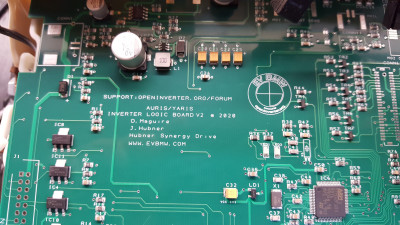

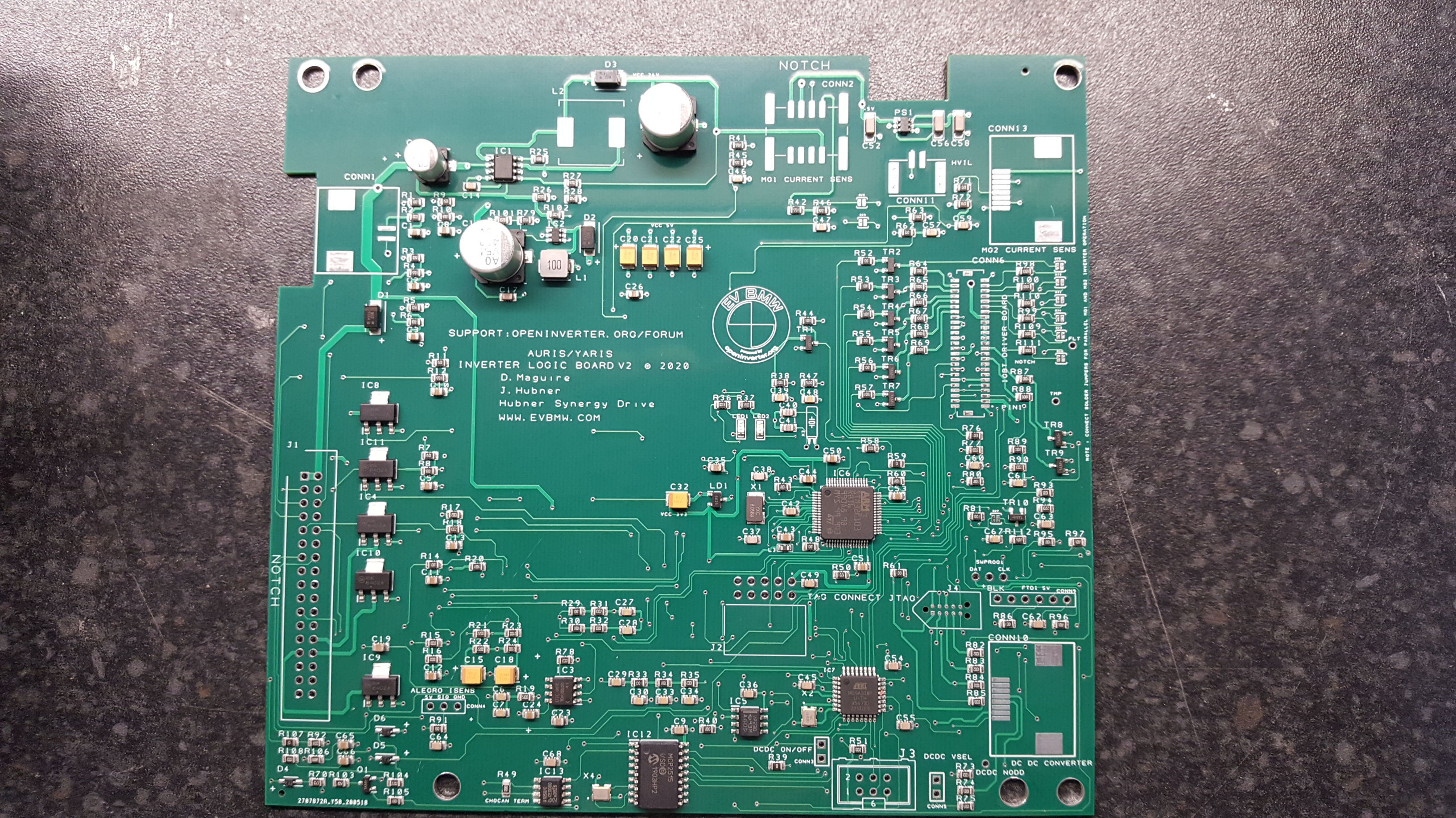

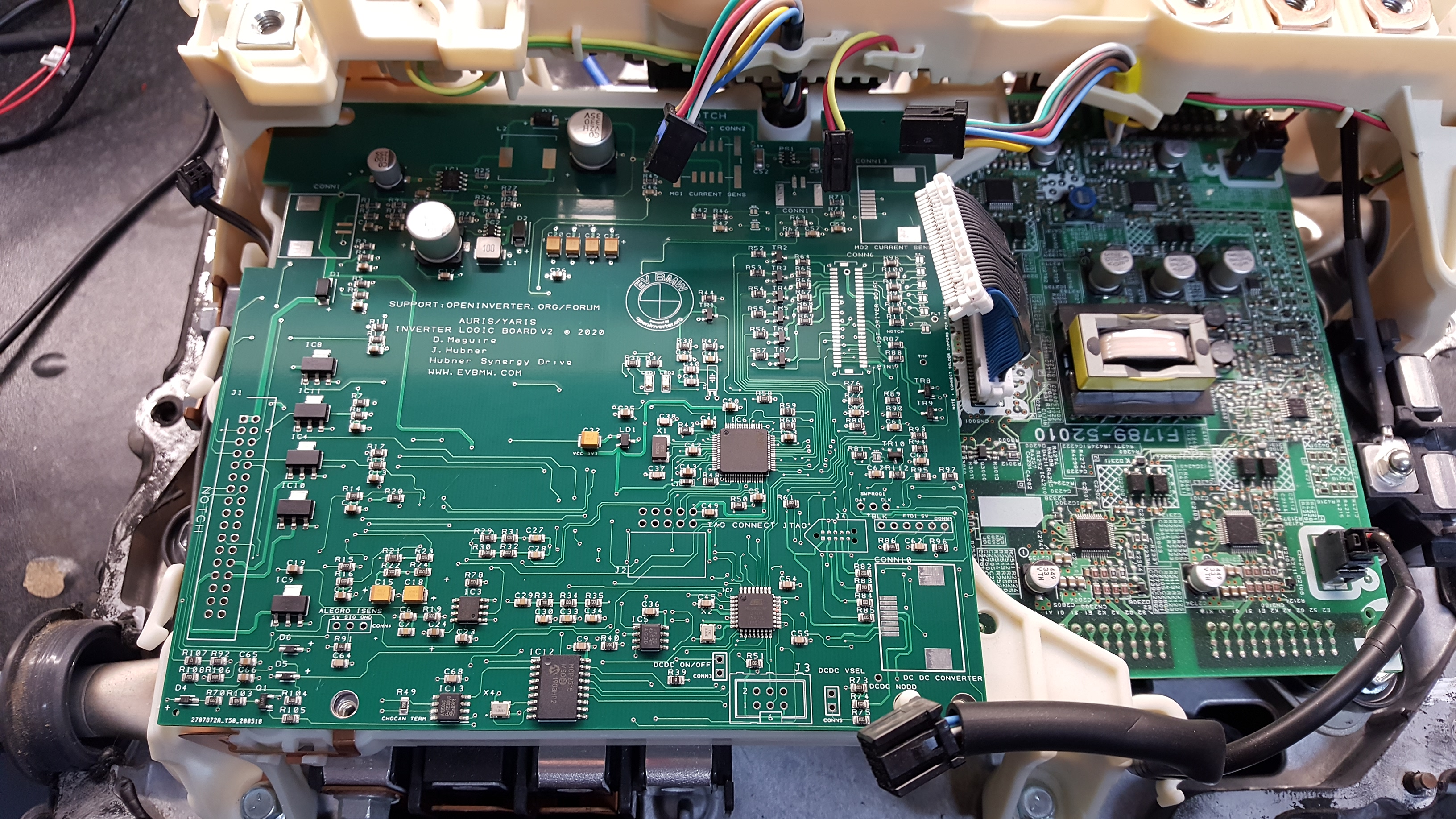

Boards are here. And it fits:)
- Posts: 3999
- Been thanked: 1114 times
Re: Toyota Auris and Yaris Inverter Logic board

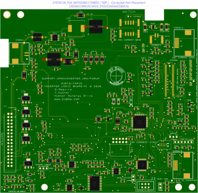

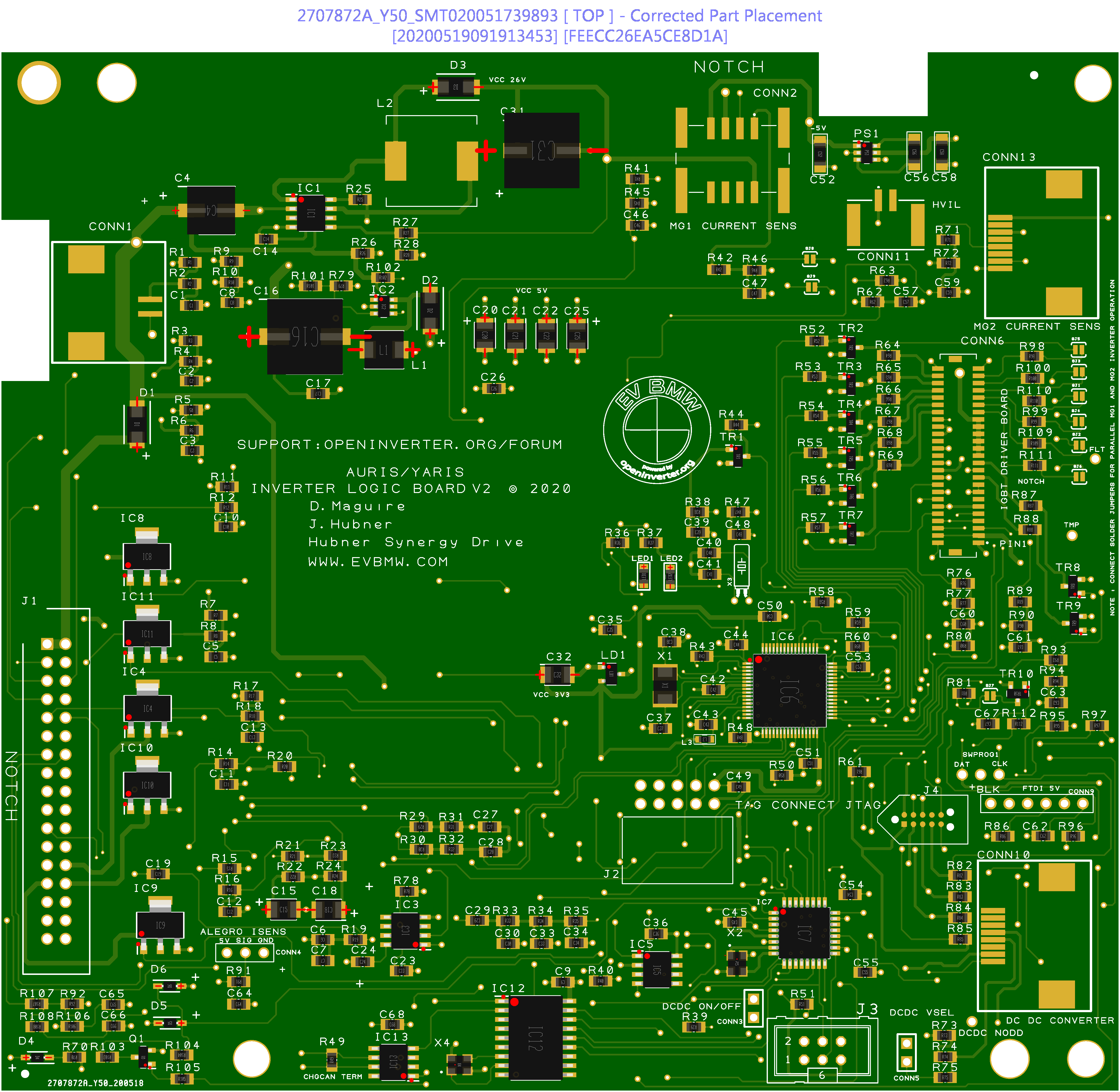

Good news , bad news here in Auris/Yaris land.
Good news : Baord fits, works, makes pwm and reads current sensors etc.
Bad news : MG1 resistor divider values are wrong. My fault not JLC. R42 and 42 should be 6k2 not 4k7 and R46 and 45 should be 3k6 not 4k7. The MG2 current sensor socket has the pins reversed. I hacked it up to let the plug go in upside down and it works fine. Another (better) option would be to leave the socket as is and swap the wires around on the plug side.
So in light of this I'll sell this batch cheap. My loss is your gain as they say on the tv shopping channels. Next batch will correct these errors and be priced as the prius board.
Available on the webshop soon.

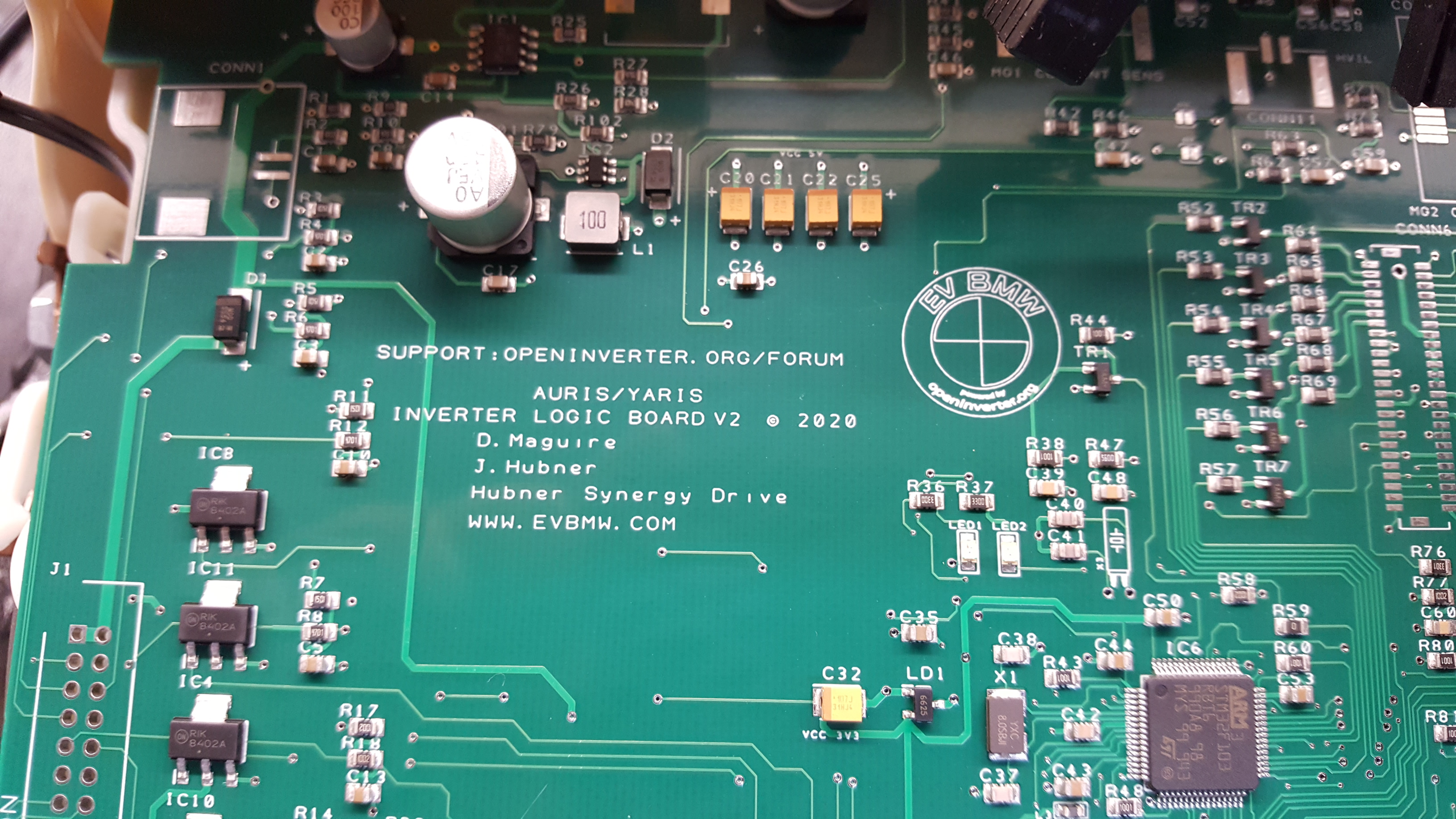

I assume you mean R42 and R41 should be 6k2?Jack Bauer wrote: ↑Fri May 29, 2020 2:25 pm Bad news : MG1 resistor divider values are wrong. My fault not JLC. R42 and 42 should be 6k2 not 4k7 and R46 and 45 should be 3k6 not 4k7.
I received the board just now, less than 48h from order, much wow, such thanks.
- Posts: 3999
Yes sorry typo. R41 and R42 should be 6k2. I've found tnt deliver to most European countries next day for cheaper than the post office was taking for over a week.

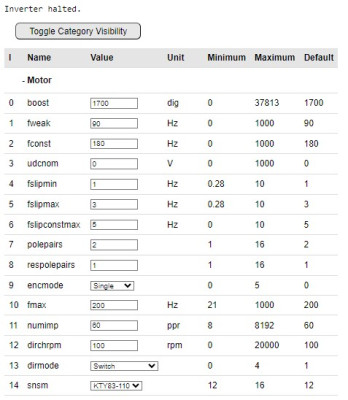

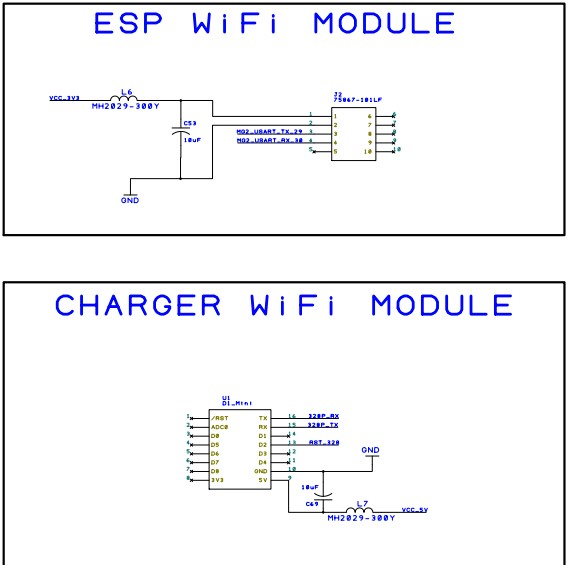

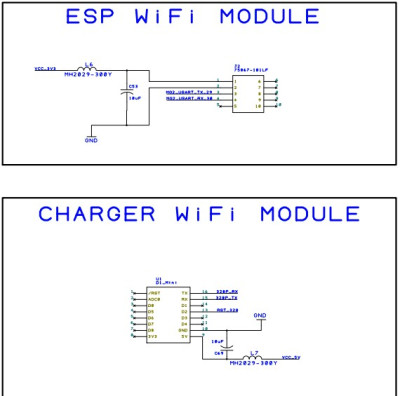

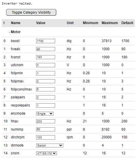

Little bit of an update on this from my side, I managed to solder everything including replacing the resistors and the reversed MG2 current sensor connector and the IGBT driver board connector.
I think I managed to kill the -5V power supply somehow however. I saw a spark fly on my mg2 connector hack job. I'll order a new one and see how it goes, it's inputs have the correct voltages but there is no output. Also one end of the big connector wants to rest on R107 and R92. I left a little gap for them just in case. Conn 11 was missing from the delivery but I managed to harvest the one from the Toyota board so all good.
The board boots up and wifi has all the interesting things visible but as the -5V looks to be used by the current sensors I won't be able to try spinnage this weekend.
Thank you Damian for the engineering of the board and I find the new long form very detailed walk thrus very helpful so please continue with those!
- Posts: 3999
Conn11 is the external hvil which is not used on the board anyway. I usually file down the plastic of the big idc connector so it fits flat. On my list to move those parts on the next batch.

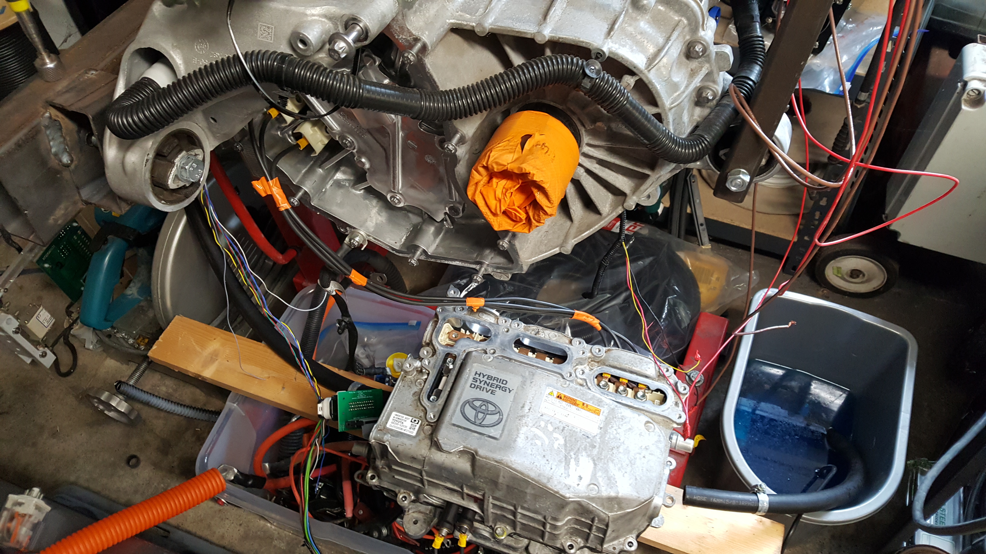

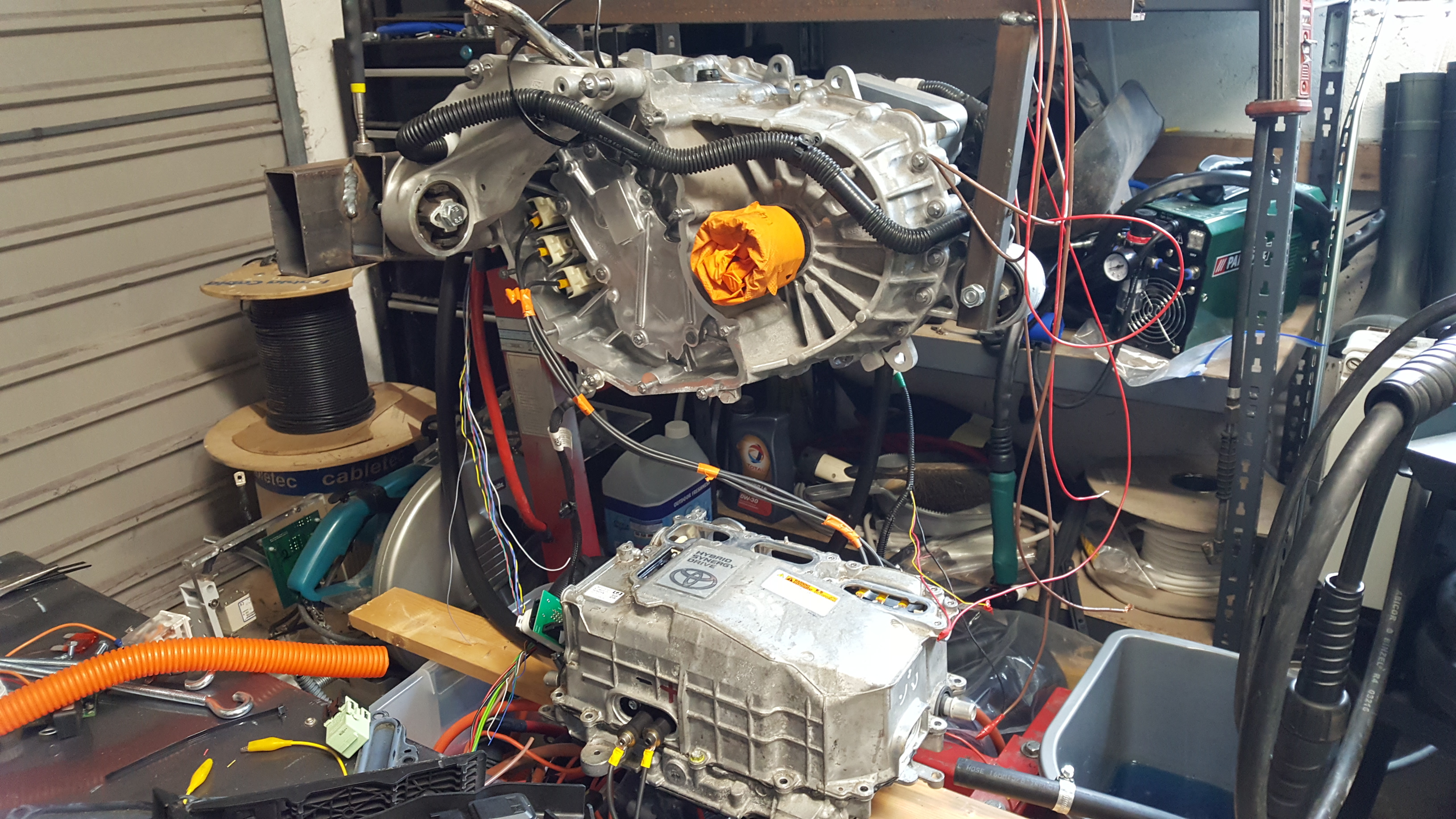

- Posts: 3999

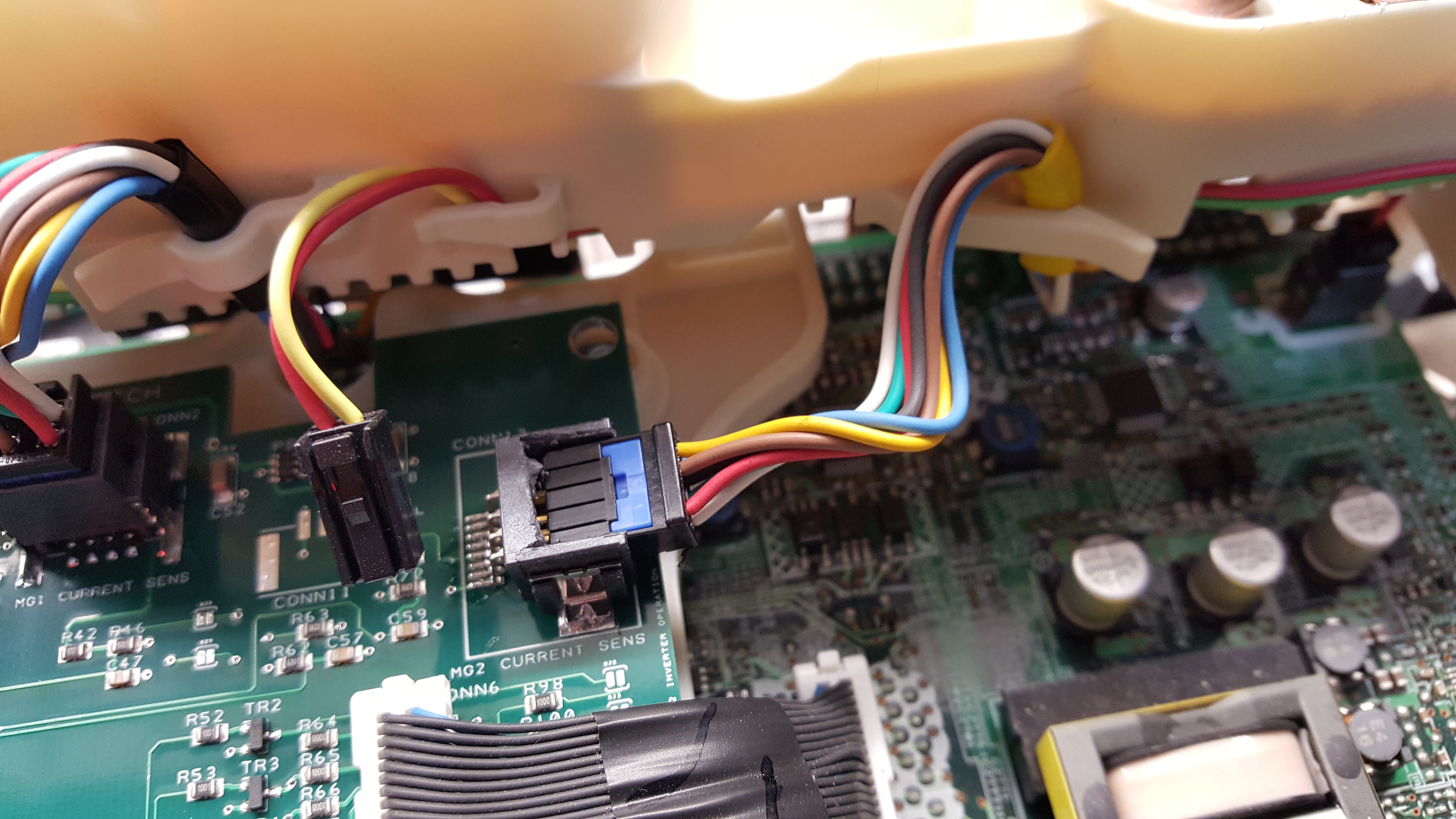

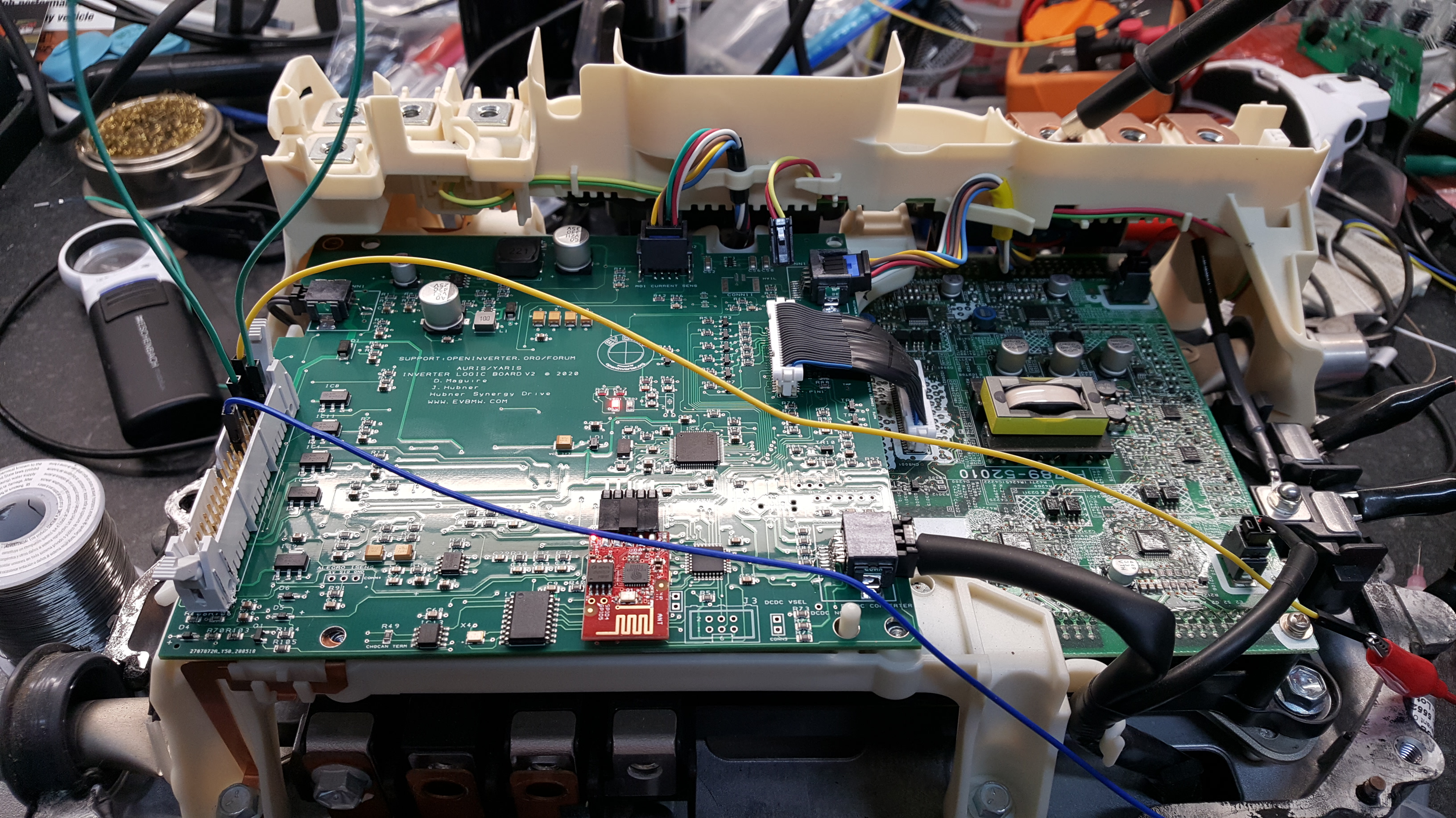

Managed to get my Yaris inverter fired up today as had to use the spare prius one for the E39. Decided to test it on the Model 3 rear drive unit. works a treat:) Exact same firmware and params as the prius. Now using the new HV connection points on the side.
