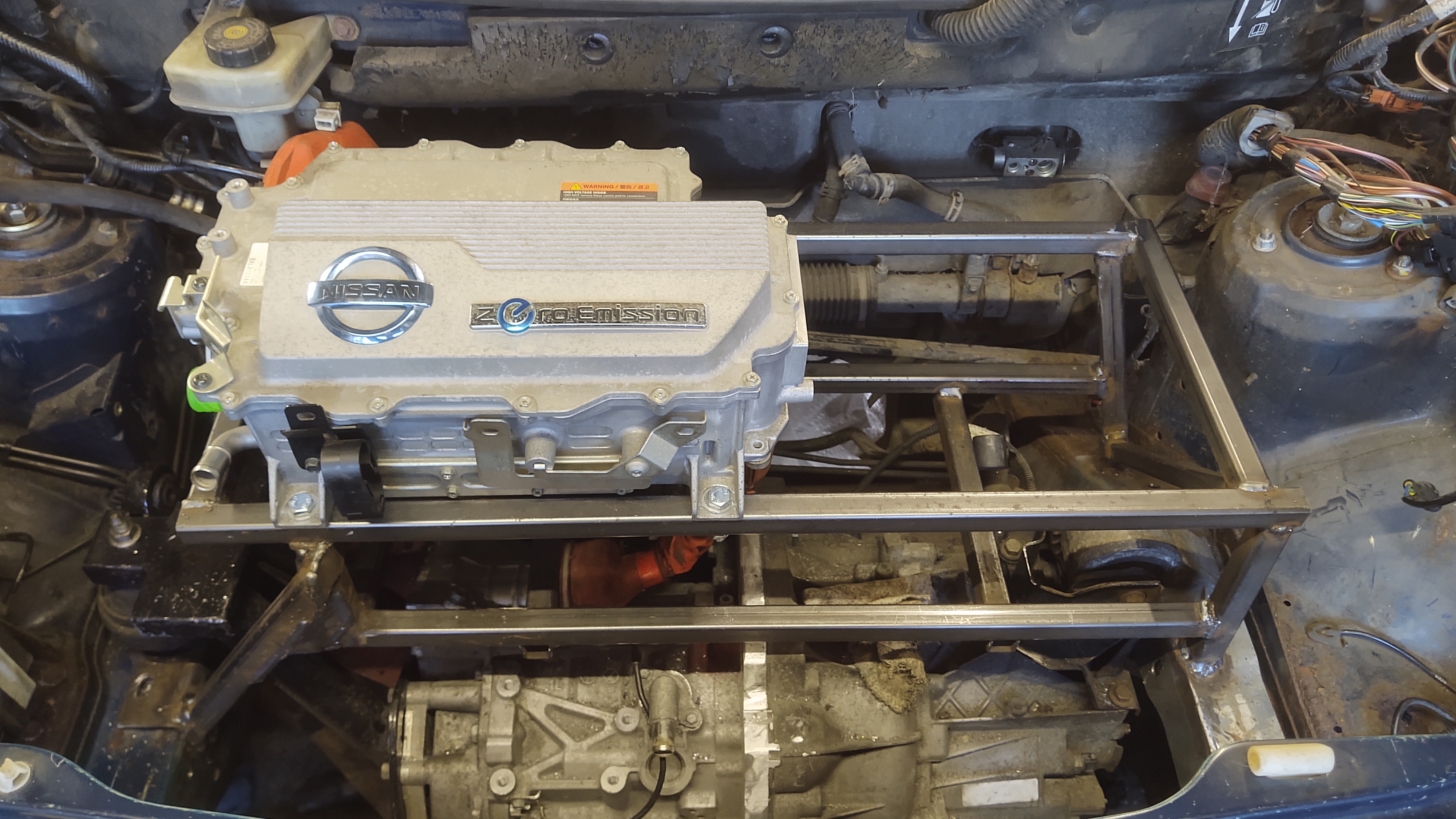

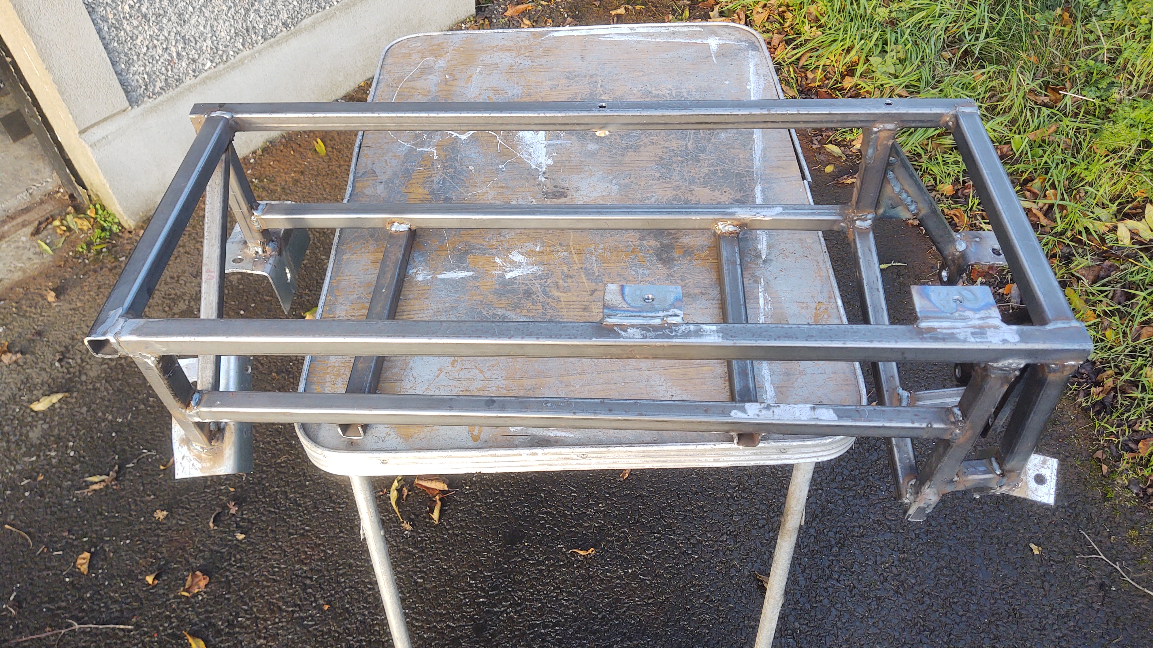

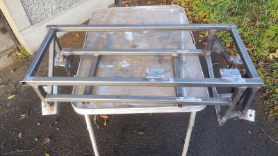

I've built up a frame to hold the electronics and maybe some batteries (if there's room) under the bonnet.

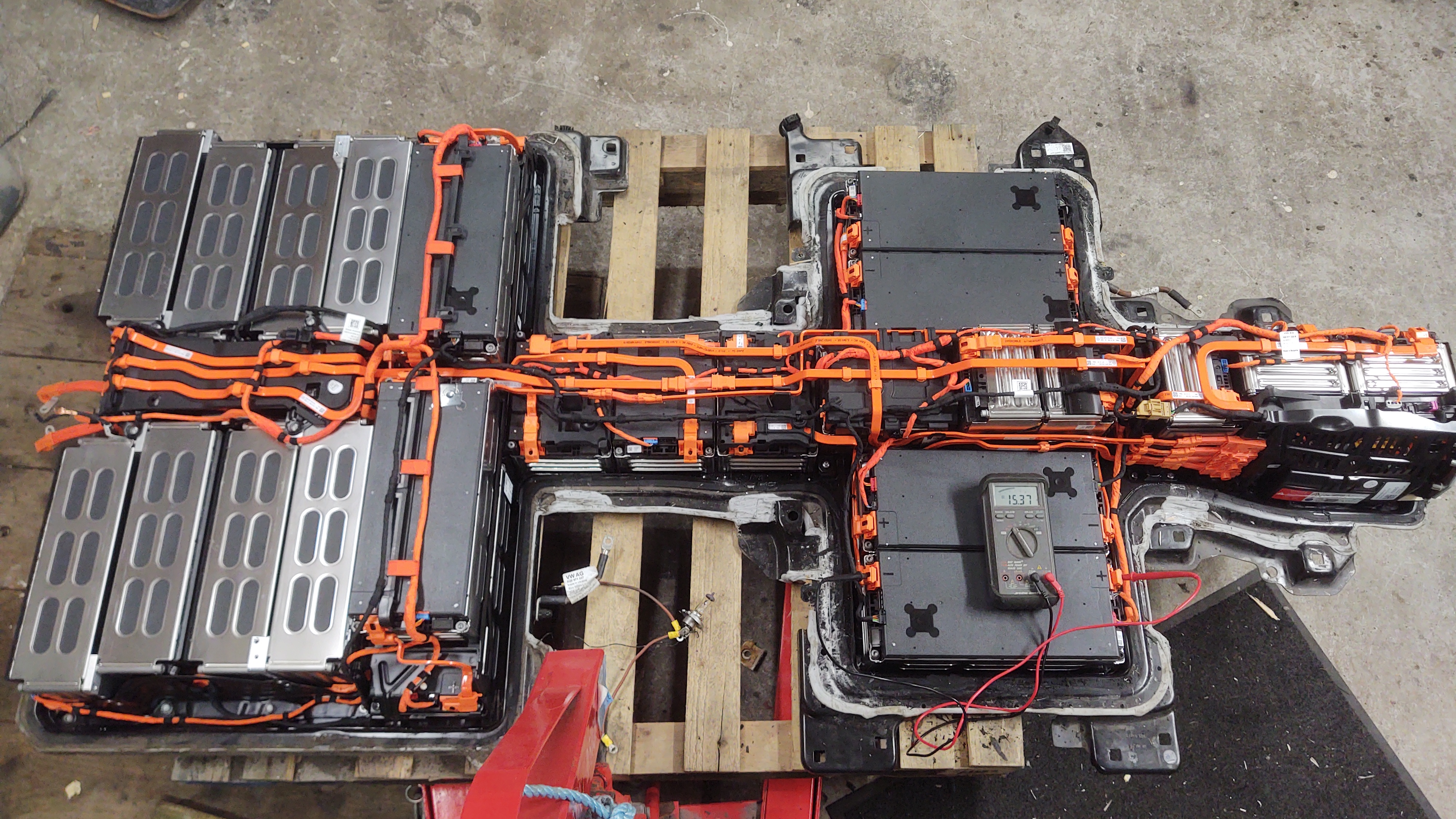

Only thing is the two modules came with a few friends. :eek:
Buying two modules was more than 1/4 the price of a full pack so made no sense.
This pack is the same age as my first one so the modules should be close enough mileage wise to be OK.
Having the two packs also means I have more options for packaging the modules, I can use more 4S or more 2S, whichever fits better.
I haven't decided whether to sell the extra modules or hang on to them for future projects but will worry about that later. ;)

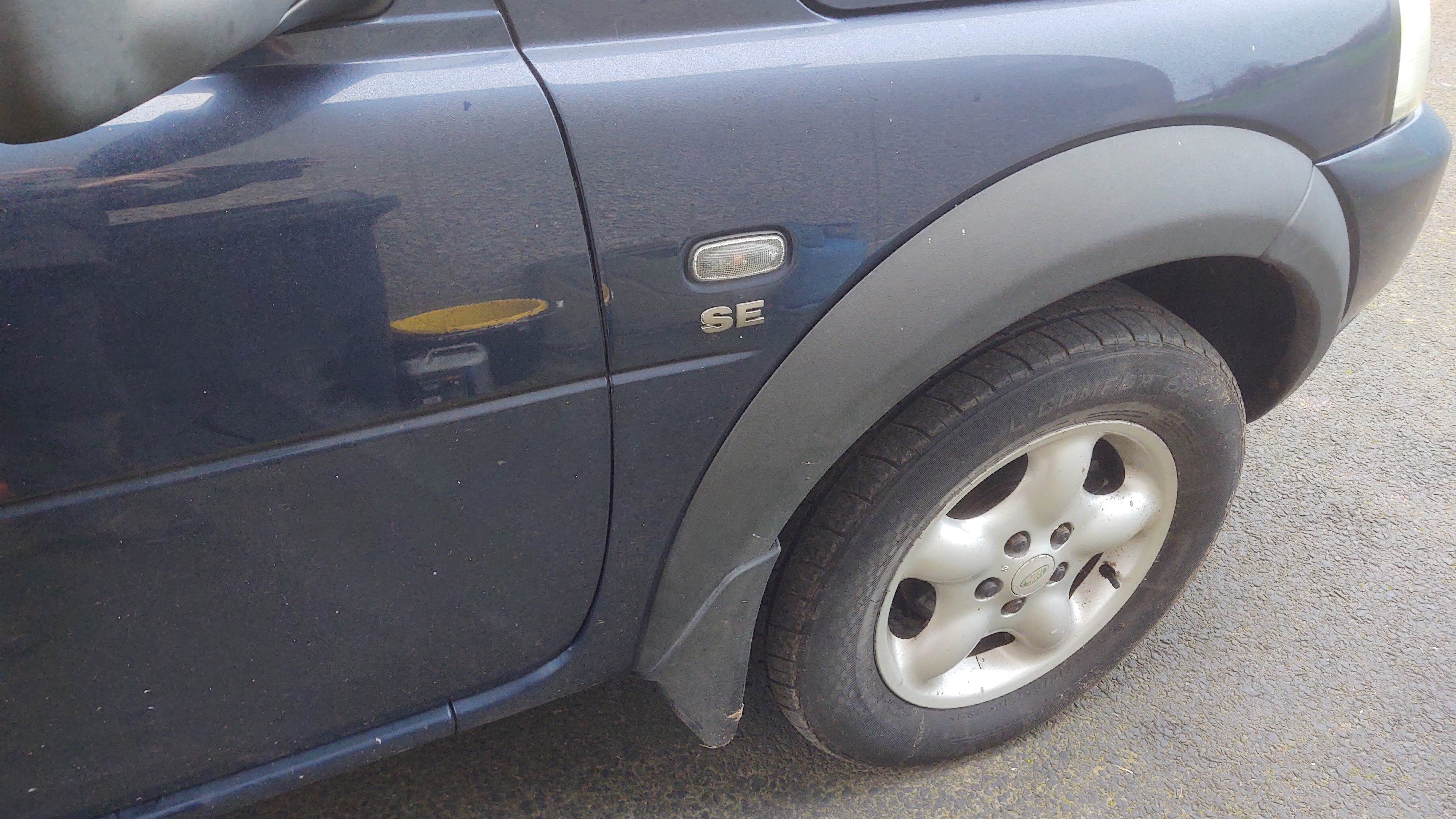

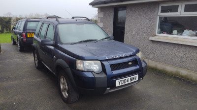

The other big update is this
It's a 2004 Freelander SE with all the usual SE options. :P
It was being sold as spares repairs because of a few minor issues but is running and driving so I'm hopeful this will be the one. ;)

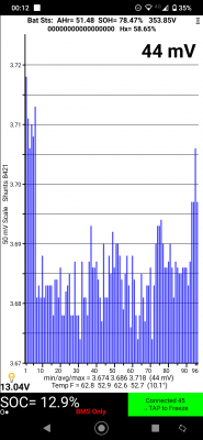

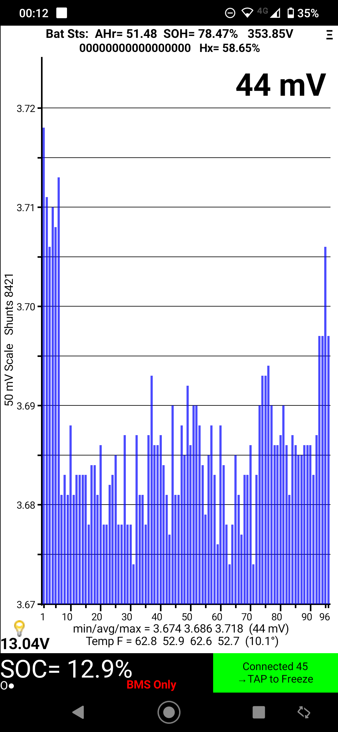

So have you got the Nissan Leaf BMS working with e-golf cells? Balancing and voltage reporting? Is there a way to monitor voltages with Leaf BMS?

m.art.y wrote: Fri May 27, 2022 10:02 am So have you got the Nissan Leaf BMS working with e-golf cells? Balancing and voltage reporting? Is there a way to monitor voltages with Leaf BMS?
Yes mate. It was really simple in the end.
I took the BMS CAN wires to an OBDII socket, plugged in a Bluetooth adapter and used LeafSpy.

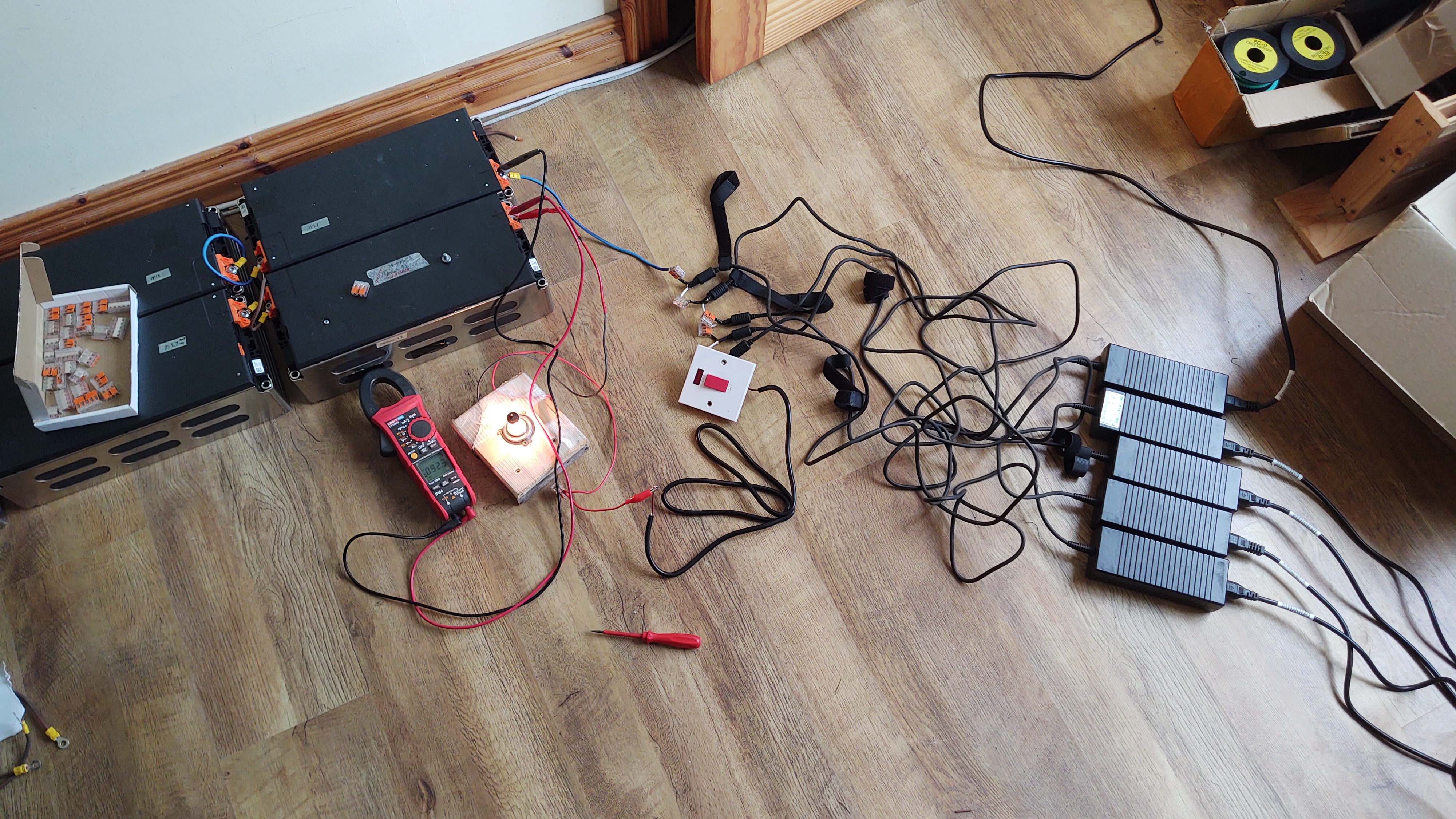

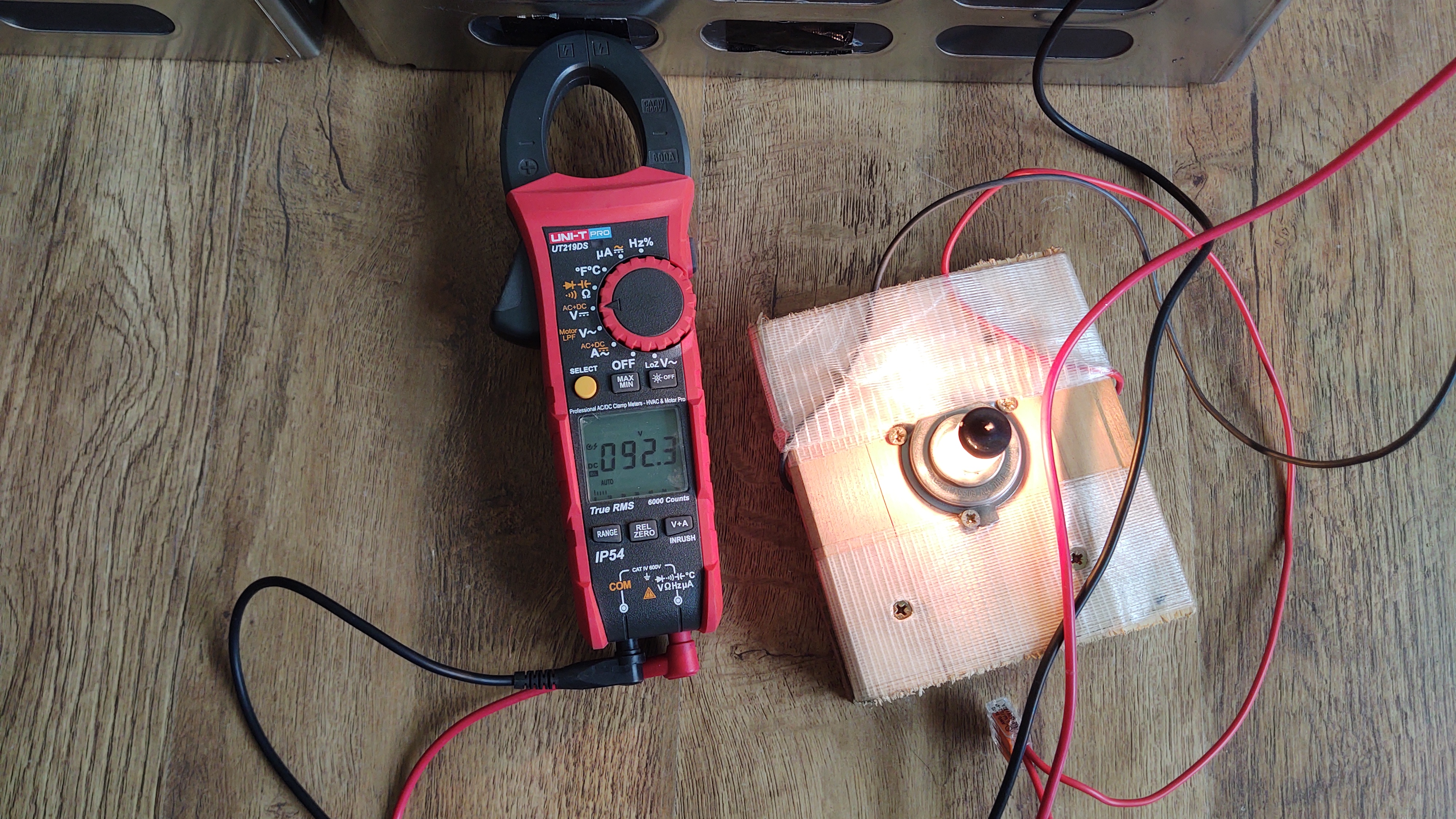

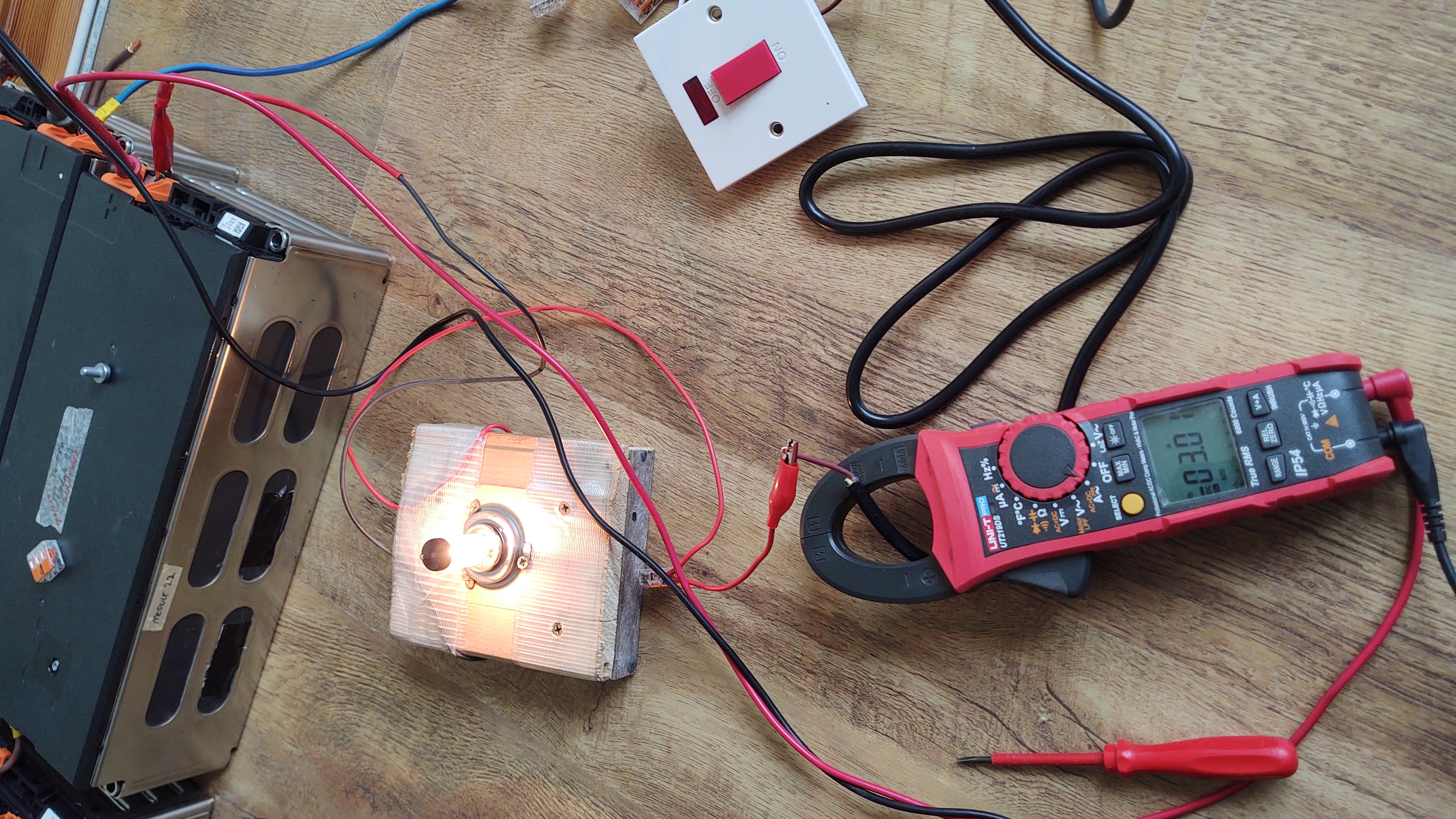

So it turns out multiple laptop chargers wired in series can be used to charge HV. :D
As a test I connected 6 x 4S modules to give 92V. I then connected 5 x 19.8V chargers in series to give 99V and after turning on the psu's connected them together.
This didn't go well as the chargers instantly shut down and refused to come back on until I disconnected them from the batteries.
I then connected a 12V 60W lamp in series and tried again and the result is below.
I'm seeing 3A and 92.3V at the batteries and 98V at the psu side of the lamp.
These are 6.9A psu's so are well within their comfort zone and the voltage is slowly rising at the batteries.
It's all a bit dodgy looking but as a proof of concept it works. :)
