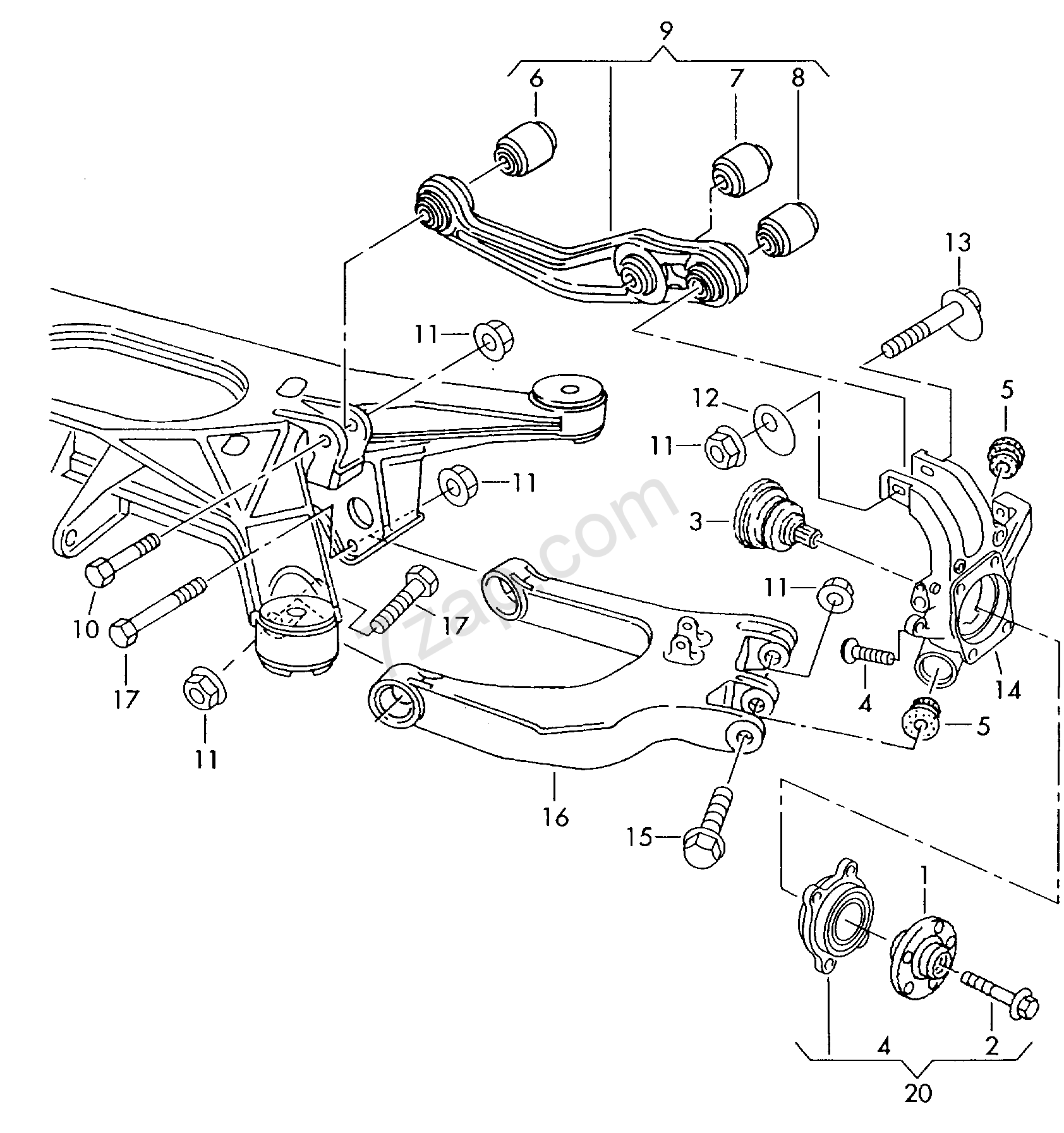

One thing I was surprised by is that this one is FWD only (not quattro despite the badges). Having looked through ETKA and the audi technical manuals though I am relieved that it might not be too big an issue to fix as the rear subframe and hubs are the same. Aim will be to buy a suitable diff, mounts and driveshafts to bolt in. Should then end up with a pair of stub axles which I can then swap to the front - we will see. Plan is for car to be RWD at the end.

You can just bolt on rear bearings from a Quattro which will accept the rear drive shafts.

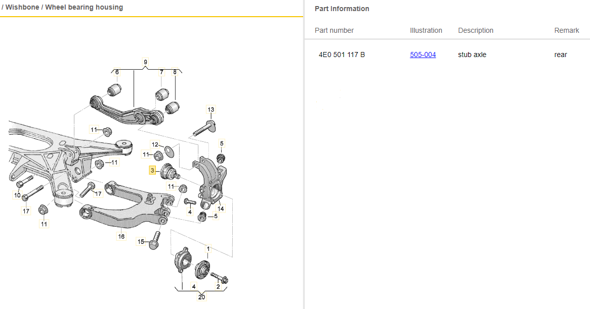

GS450H motor. According to part numbers from 7 zap, the hubs and bearings are same on quattro. Hoping the stub axles fit the front - Car is air suspension and is driven by an electric pump behind the front bumper. It also seems to hold air when parked.

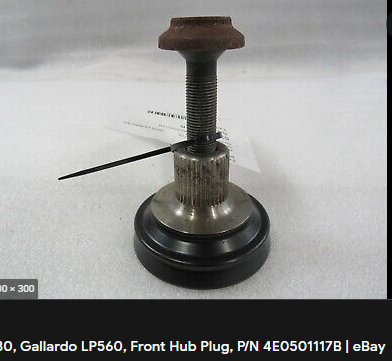

Ah yes - that's correct - even easier - just bolt in the driveshaft.GS450H motor. According to part numbers from 7 zap, the hubs and bearings are same on quattro. Hoping the stub axles fit the front -
They would usually have a blanked off the wheel bearing with no hole - but instead are using a plug - shared with the Gallardo no less!!

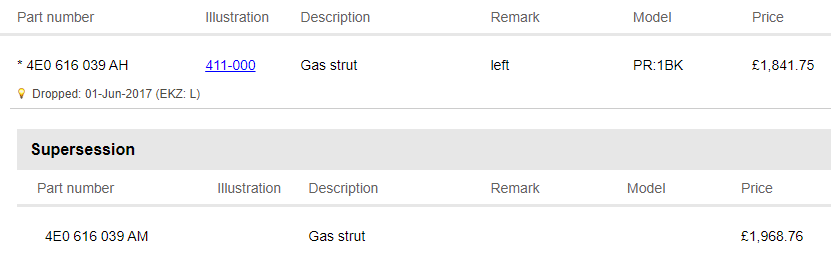

Just looked at the price of new front strut! Looks like you have hydraulic steeringSuperV8 wrote: ↑Fri Jun 17, 2022 7:25 amAh yes - that's correct - even easier - just bolt in the driveshaft.GS450H motor. According to part numbers from 7 zap, the hubs and bearings are same on quattro. Hoping the stub axles fit the front -
Hopefully the air suspension will just carry on doing it's thing with no engine.
