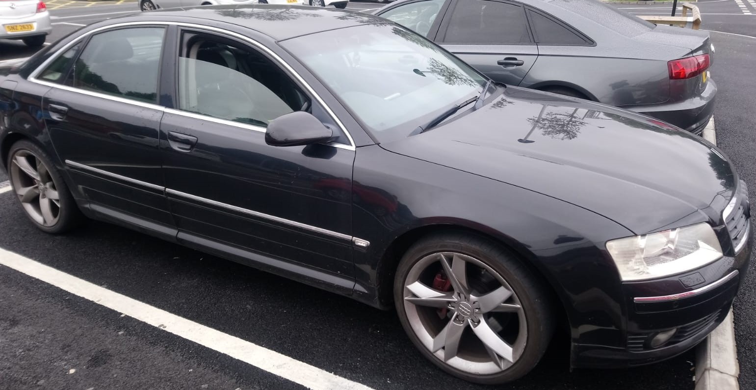

Hi, my name is Neil and I live near Belfast in Northern Ireland. Just starting out on my electric conversion journey though been daydreaming for a while now. Grateful to see the progress being made with OEM parts and hope to use this here and contribute something along the way.
Car is a 2005 Audi A8 D3. Attraction to me is aluminium body so lighter and less prone to corrosion as well as a nice spec. Cost to me was cheap because it had an oil pressure issue. Was able to solve this by changing the oil as the stuff in it must have been wrong grade (was like water). Was also lucky that the car was not far away from where I live. It drives nice and is first one I've had with CVT which is quite impressive. Almost seems a shame to take it apart but would not miss 25mpg...
One thing I was surprised by is that this one is FWD only (not quattro despite the badges). Having looked through ETKA and the audi technical manuals though I am relieved that it might not be too big an issue to fix as the rear subframe and hubs are the same. Aim will be to buy a suitable diff, mounts and driveshafts to bolt in. Should then end up with a pair of stub axles which I can then swap to the front - we will see. Plan is for car to be RWD at the end.
Not sure what the unexpected challenges will be yet, but I do anticipate some fun with the CAN bus side of things as there is a fair amount of stuff inside. So far I've got 4GB of CAN logs for the drivetrain and will work out how to share these on github soon. A few of the messages I've isolated so far seem to match up with some snippets I've found online. Next step is to isolate the gearbox and engine drivetrain can and see which messages go missing. Then hopefully spoof these and check I can get the car to turn on without weird error messages.
Have also bought a zombieverter and the transmission, oil pump, wiring loom and inverter though its not moved since I put them in the garage. My projects tend to be slow burners but perhaps posting here will keep things moving!

What motor are you planning?
You can just bolt on rear bearings from a Quattro which will accept the rear drive shafts.
Do you have air suspension? If yes is the compressor electric or driven off the engine?
Tom.

Thanks indeed Johannes. I found your github repo when searching as well. I think the CAN payload on 0x580 is different in my car and occasionally deviates from the sequence as well. Bit of actual testing needed. The A8 has can bus connectors at each end of the dashboard so I've bought 2x of these and hopefully can snap the pins off for engine and gearbox ecu. It also has an energy control module that I need to figure out how to keep happy or it will do annoying things like turn off the radio to save the battery - think it talks to the alternator over LIN.
SuperV8 wrote: Thu Jun 16, 2022 8:00 am
Tom.
GS450H motor. According to part numbers from 7 zap, the hubs and bearings are same on quattro. Hoping the stub axles fit the front -
Car is air suspension and is driven by an electric pump behind the front bumper. It also seems to hold air when parked.
Ah yes - that's correct - even easier - just bolt in the driveshaft.
They would usually have a blanked off the wheel bearing with no hole - but instead are using a plug - shared with the Gallardo no less!!

Hopefully the air suspension will just carry on doing it's thing with no engine.
Just looked at the price of new front strut!
Looks like you have hydraulic steering
