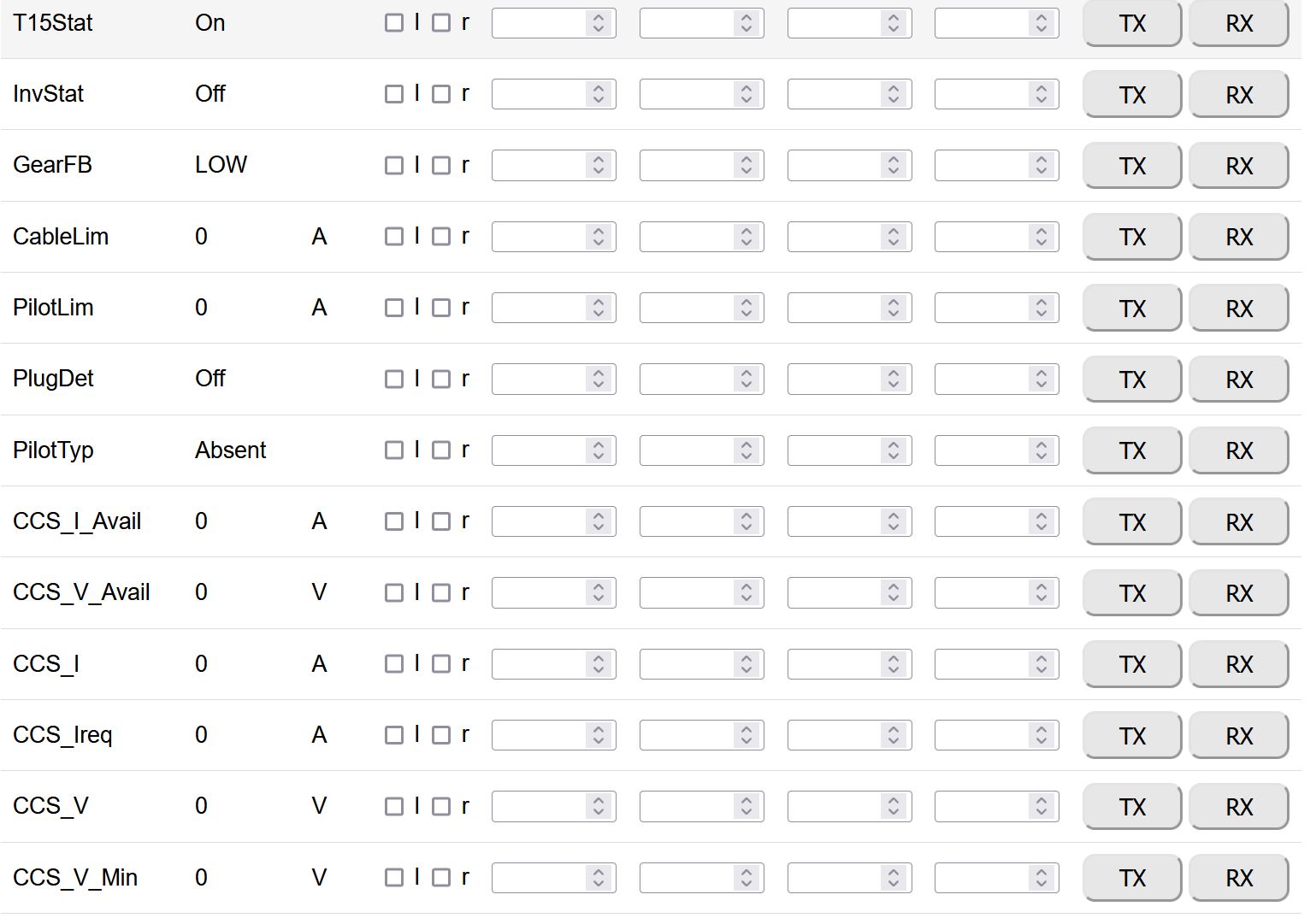

Just a short update on this. Uploaded a bin file Paaa sent me (working with his GS450H setup, thanks Paaa) and as above, disconnected the wires from the inverter power relay and just connected a meter to check if relay closes at any stage of the start up. Good news, relay to send power to inverter (IC6 controlled) comes on at ignition start signal and this time when ignition start signal removed, the relay stayed on as it should.
Wired up the relay to the inverter and tried again. Web interface still shows InvStat off, so checked voltage was actually getting to inverter and it is but the 12V battery is down to 10.2V from all the testing so I'm thinking the inverter may need to see higher voltage than that to be happy. Will get the 12V charger on tomorrow and try again.

nkiernan wrote: Fri May 06, 2022 8:16 pm Wired up the relay to the inverter and tried again. Web interface still shows InvStat off, so checked voltage was actually getting to inverter and it is but the 12V battery is down to 10.2V from all the testing so I'm thinking the inverter may need to see higher voltage than that to be happy. Will get the 12V charger on tomorrow and try again.
I noticed this same thing with my Leaf setup. INVstat reads "off", but in reality the inverter is on and it reports the INVudc and drives the motor.

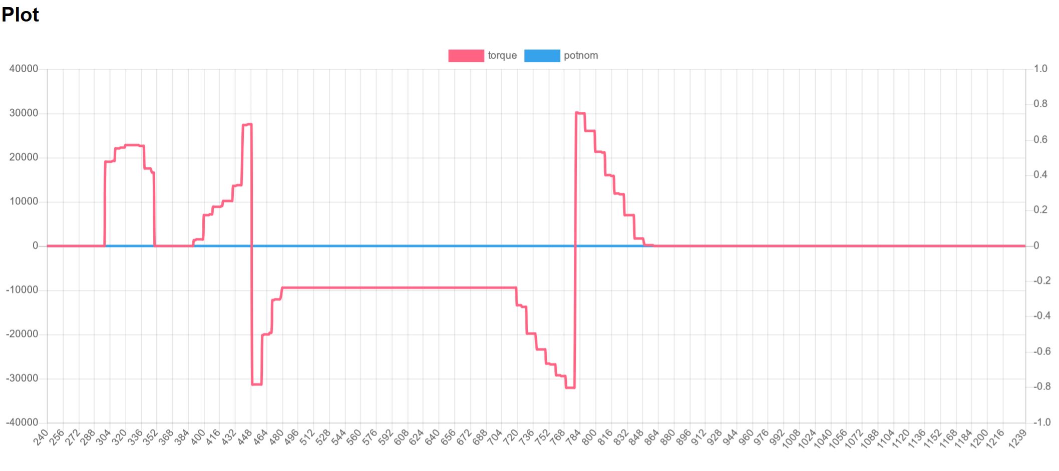

I tested this issue a bit further this evening.
When the motor surged, I had the parameters regentravel and regenmax, both set to zero.
This time I tried the following:
Regentravel 30% (default) and regenmax -30% (default) -> No motor torque @ zero throttle, smooth throttle response, when applied. If I take my foot of the throttle completely and too quickly, the motor starts rattling around zero speed and requires a gentle press of the throttle to come to a full stop.
Regentravel 30% (default) and regenmax -20% (default) -> No motor torque @ zero throttle, smooth throttle response, when applied
Regentravel 30% (default) and regenmax -10% (default) -> No motor torque @ zero throttle, smooth throttle response, when applied
This is as far as I went. I should still check what happens with values in the vicinity of zero, but I am suspecting that setting those two parameters to zero is what caused the surge so I'll avoid that situation for now.

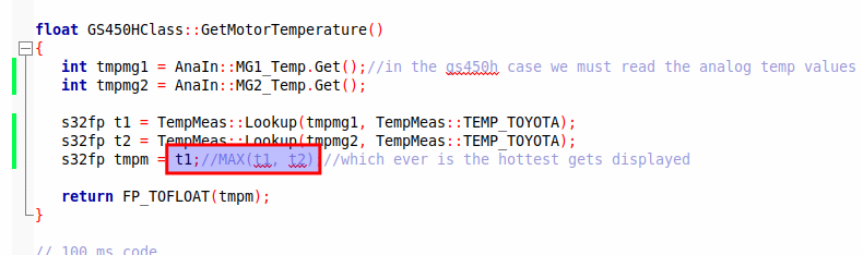

Zechy wrote: Wed May 04, 2022 1:26 pm My tmpm stays on 6400 no matter what I try.
I plugged a 10k Ohm pot in on MG2temp+ and - I can then measure a voltage of 0.2-3.8 on pin A6
When I plug the 10k Ohm pot into MG1temp+ and - I can only see 0.02-0.06 volt on pin A5
The value of tmpm never changes when I change the pot value.
I measured the voltages here:
I managed to get my motor temperature to work by bypassing MG2 temperature in the code
I think the ADC on pin A5 is not working.

I had a similar issue , check you inverter coms wirings correct, , also inverter should make a high pitched noise when powered up. Cant remember if I fixed the throttle scaling in that bin but think I did.

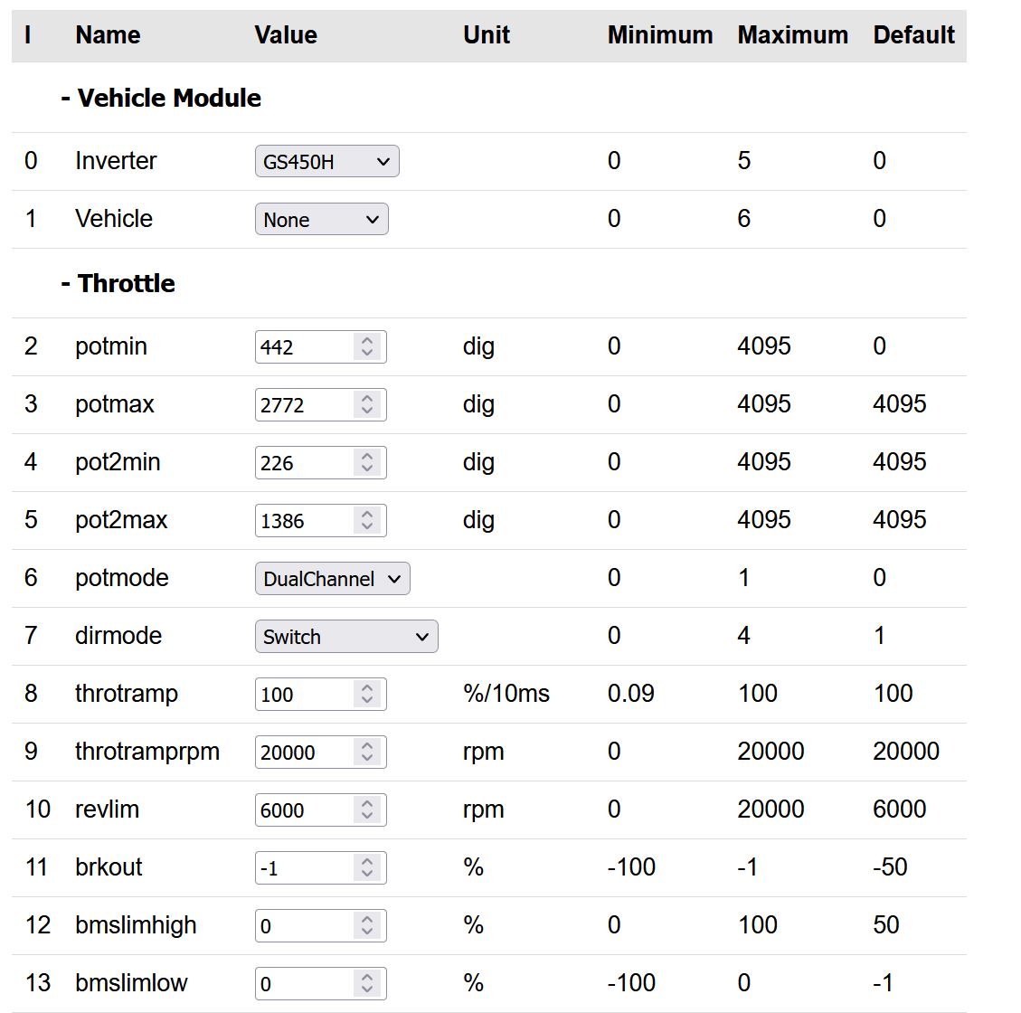

I will need to go back and recheck the comms wiring alright. Charged the 12V battery and retried but no whine from inverter and no motor spin. Tried connecting 12V PSU directly to inverter power pins out of curiosity and at 13V there is a 1.05A current draw, but no high pitch noise like I remember when using the GS450H vcu. I think I might retry that to make sure.
Appear to be getting zero potnom. Can get both accelerator pots graphed when moving pedal, but watching potnom and refreshing, it stays at zero. Funny torque curve too, so will check through my settings again.

Vehicle "None" is that correct? i think you need to select something there if i remember the code correctly.

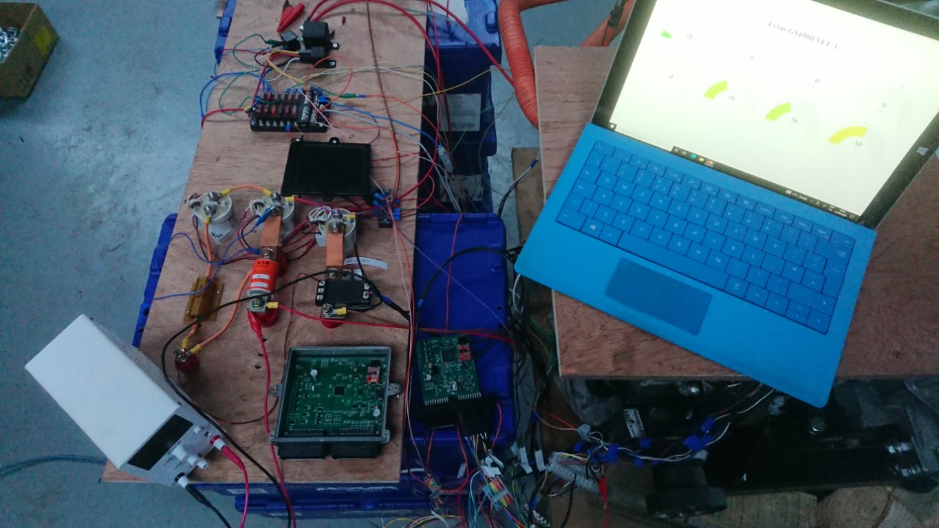

I think I have the same issue with my kit. I see clock signals on pin1 of both both IC18 and IC13 when power applied - when ignition plus "Start" is activated, I see the output IC18 pin7 go high but no signal passes through. I'm not sure of the correct working behaviour to benchmark it.
The overall issue is the inverter never hums and the motor doesn't turn but the software setup looks OK.
I have an update. Whilst trying to work out why I didn't have any output from the zombieverter, I notices these https://thepihut.com/products/can-board-sn65hvd230
This uses the same chip type as the zombieverter and there were five in stock. So, only needing four for the Lexus interface, I bought them and using a cheeky method to de-solder them using two soldering irons, I transplanted them onto the zombieinverter.
Shock horror - the bloody thing worked - it had been duff chips all along! - I have a running motor on the bench.
Now all I need to do is buy a shunt, learn and build the battery side of thing, do the same for charging, oh, then just sit it all in a car and go for a drive. I reckon I'm 95% there.... aren't I?

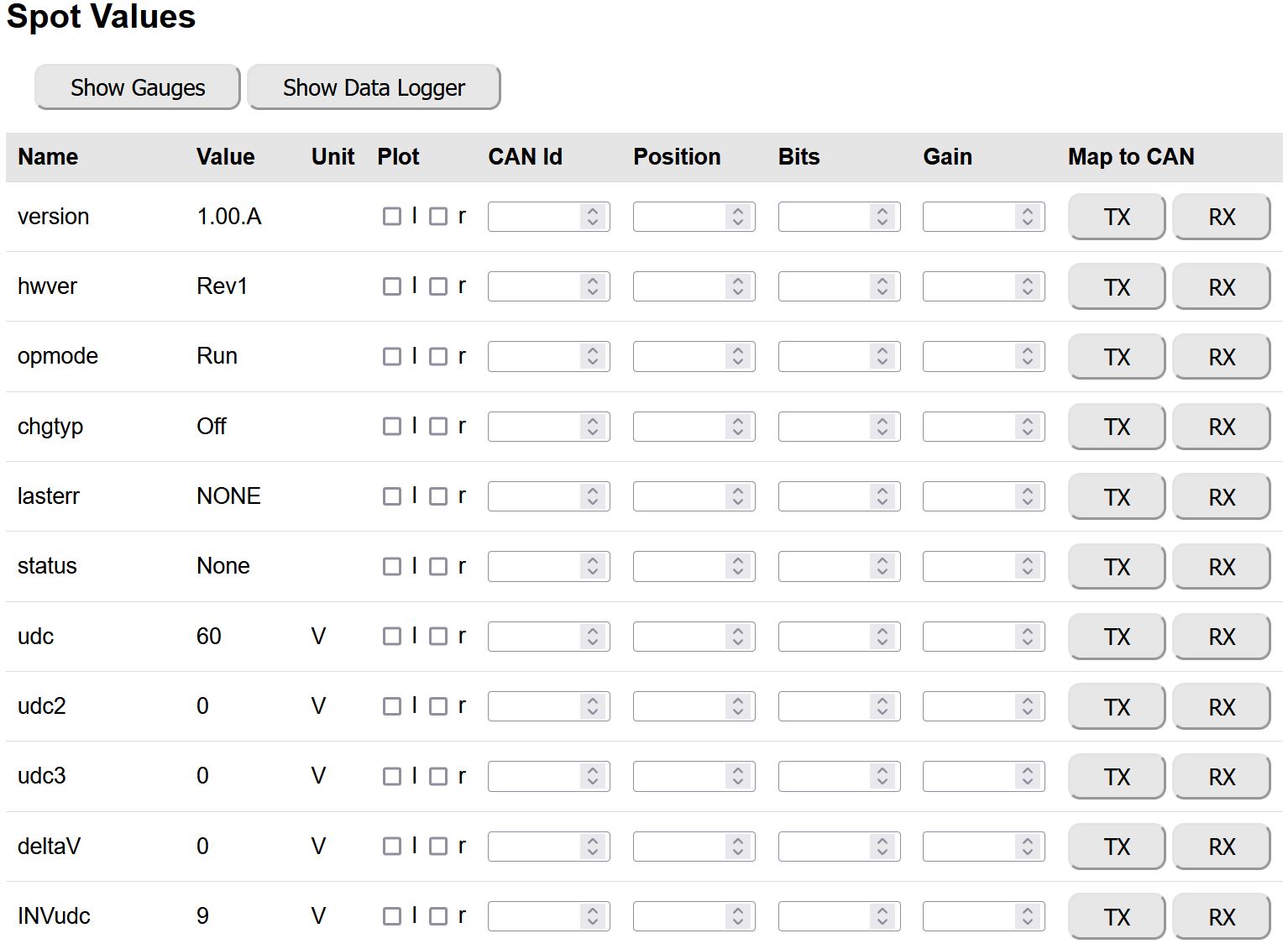

Quick query on INVudc. You'll see below the ISA shunt is providing the correct udc reading, 60V 3A bench supply. INVudc is showing 9V and I had assumed this was the 12V system voltage reading for whatever reason.
Its supposed to be the HV DC voltage, and match closely to udc yes?
From reading back through the thread, I believe it should be around the 60V also, so what might cause that (measuring 60V at the inverter HV inputs with meter).
