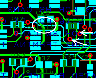

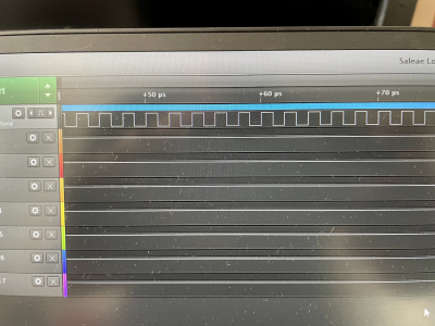

I can't get the sync serial working in my kit. No pulses on CLK, REQ and HTM.
I used a logic analyser to check the input on pin1 for IC18 (CLK) and it's receiving input:
Is there a trick in getting the can transceivers to work?
Could the can transceivers in the kit be faulty?
EV_Builder
Posts: 1205
Location: The Netherlands
Has thanked: 18 times
Been thanked: 37 times
Re: ZombieVerter VCU Support
Post by EV_Builder »
Zechy wrote: Sun May 01, 2022 3:24 am I can't get the sync serial working in my kit. No pulses on CLK, REQ and HTM.
Check wireing first. Who is supplying the clock?

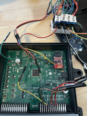

Is the inverter switched on?
Thanks. I checked and the wiring seems fine.
I then measured at the white arrows and didn't get any CLK+ and CLK- signal:
Then I used external can transceiver modules between the input pin 1 and the 56pin connector:
The syncserial then gets to the inverter and I get data back on the MTH cables.

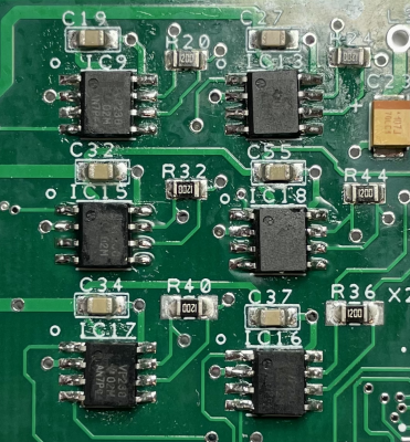

EV_Builder wrote: Sun May 01, 2022 11:40 am Pohh good job. Then it's time to check orientation?
I appreciate your help :)
The orientation of the ICs?
Here is a photo:
Domt177
Posts: 228
Location: West Midlands, UK
Been thanked: 13 times
Post by Domt177 »
Think the transceivers are bad, as im having the same issues.
Fed CAN to 2 of them and received nothing the other side
Fed the same CAN to 2 known working ones (from another project) and received the other side as expected.
