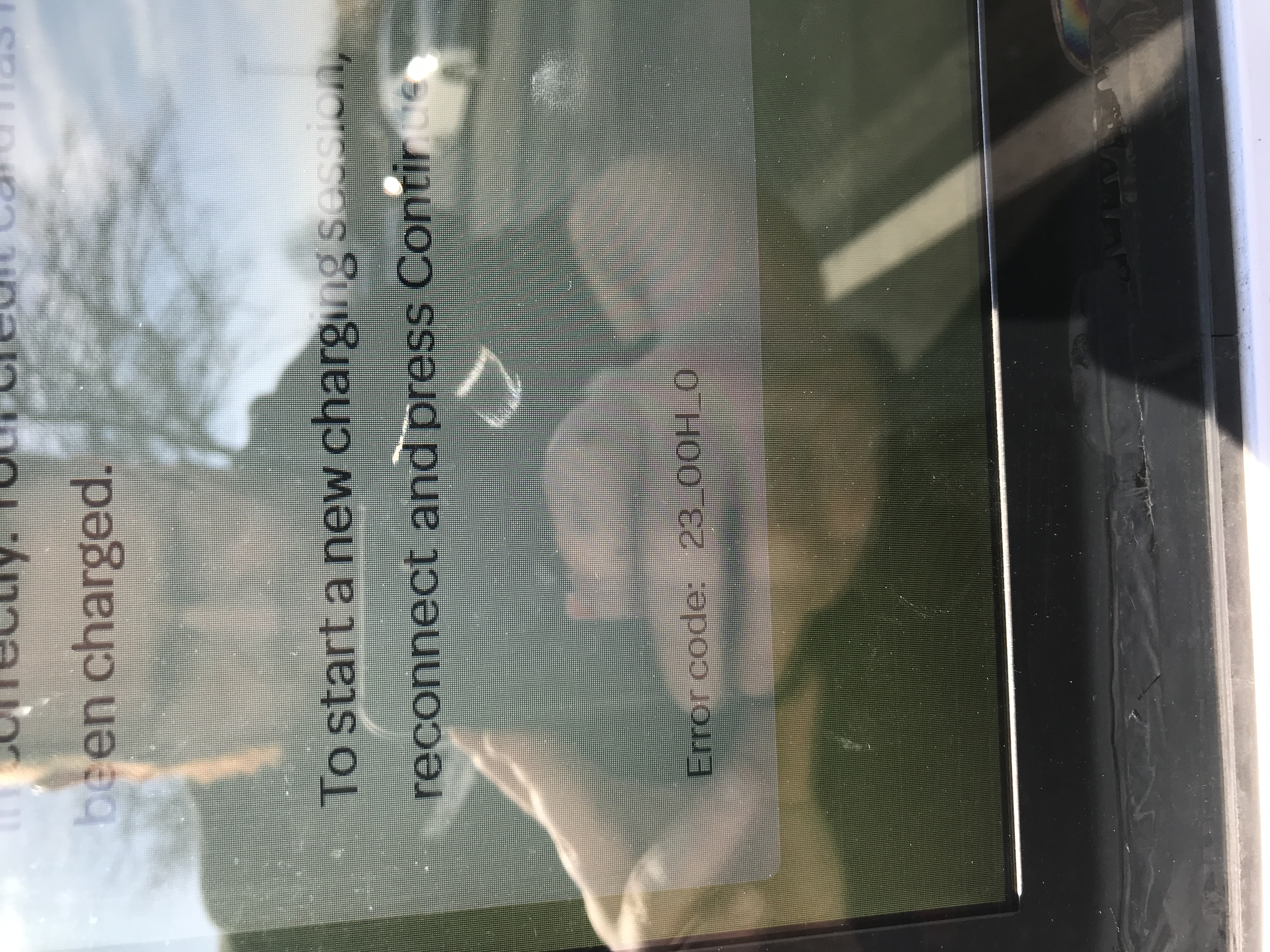

Ok so I tested several configurations and can't seem to find the issue, though I did have some interesting settings issues.
First, in all cases the error message from the Electrify America charger was 23_00H_0 This occurred after the station appeared to begin delivering power. Watching on the web interface, it appears the station does all of its checks (station side voltage rises, drops to zero, the rises back to the car's voltage), and I hear the contactors close in the car and the station, but then it throws the "Malfunction|Stop" error message in the web interface and the station says charging failed.
Second, I played around with the signs of various items from the shunt, and observed an interesting result.
- Regardless of the signs of Volts and Amps, the sign of kW stayed the same.
- Changing the setting for kW did not change the sign either.
- No matter what settings I use, I get negative kW when power is leaving the pack, and positive when it is entering (tested by running the motor with the car on jack stands). This seems like it should be what the controller wants, but I'm not sure at this point.
I can't seem to figure out what combination of signs the controller wants. Can anyone else that has this functioning tell me what they are seeing sign-wise in the web interface so I can attempt to match?

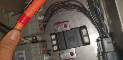

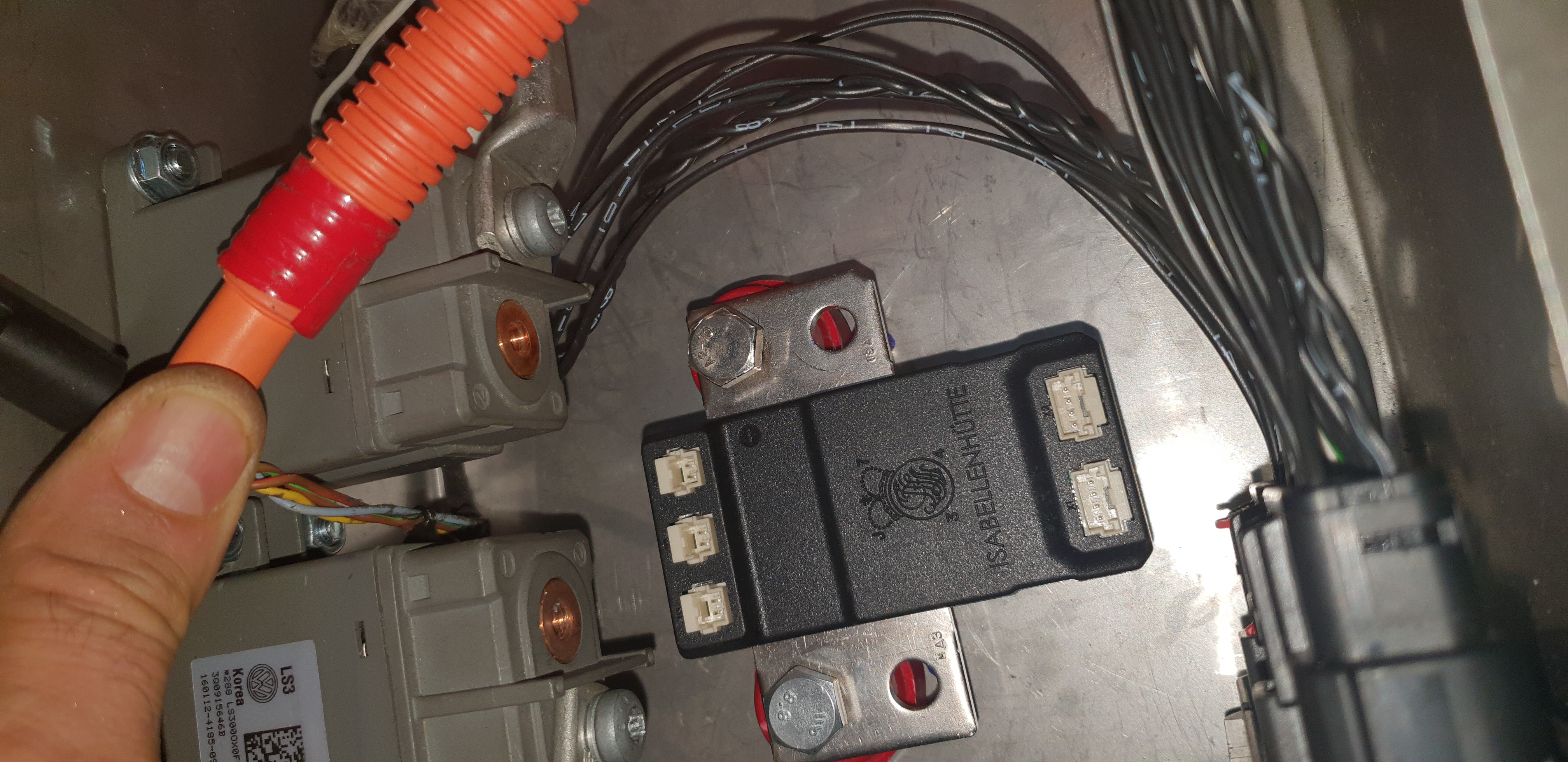

hmm is this again a case of the “wrong” orientation ? Might be worth flipping it just too see.P.S.Mangelsdorf wrote: ↑Sat Feb 12, 2022 2:24 pm

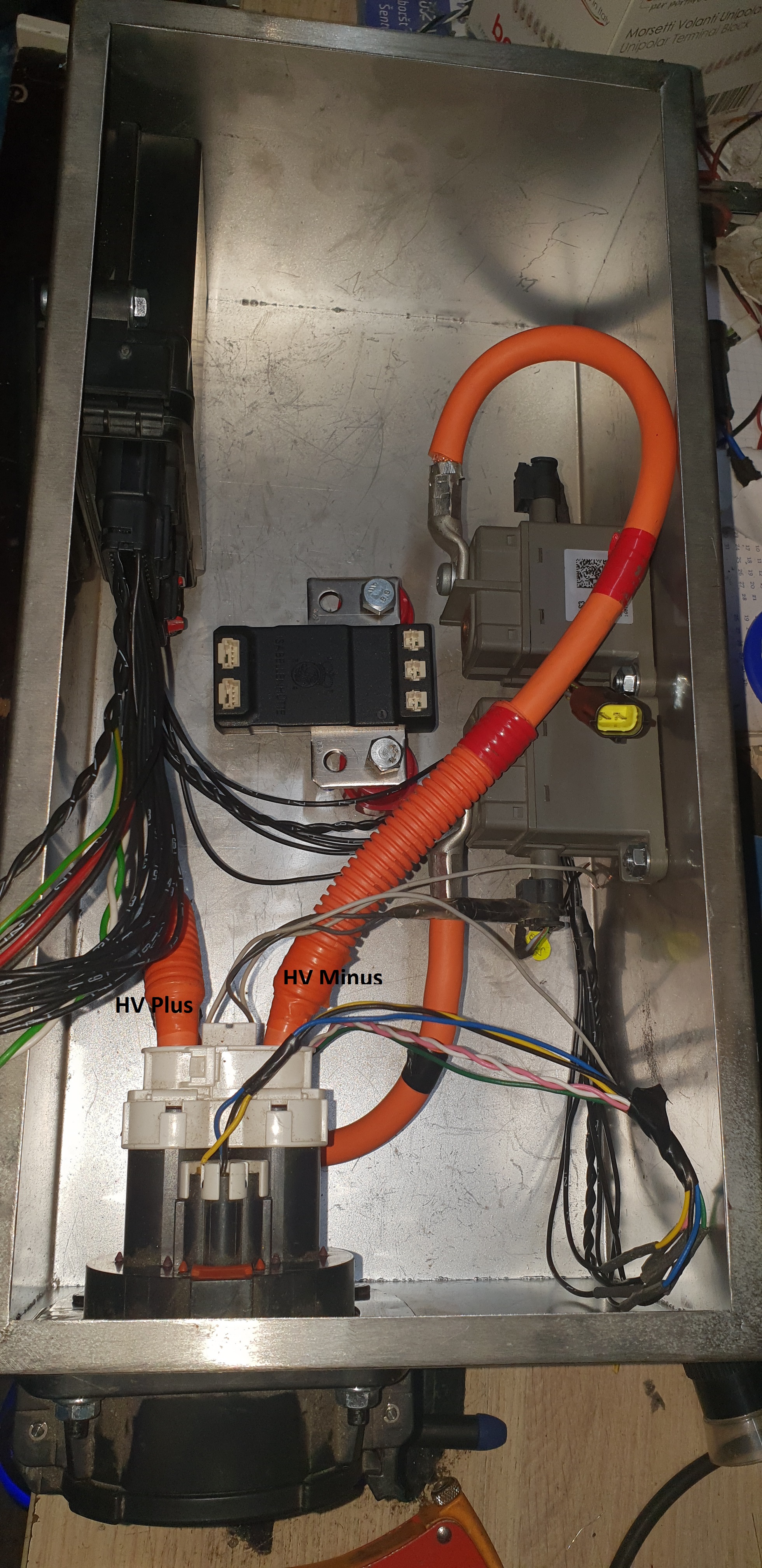

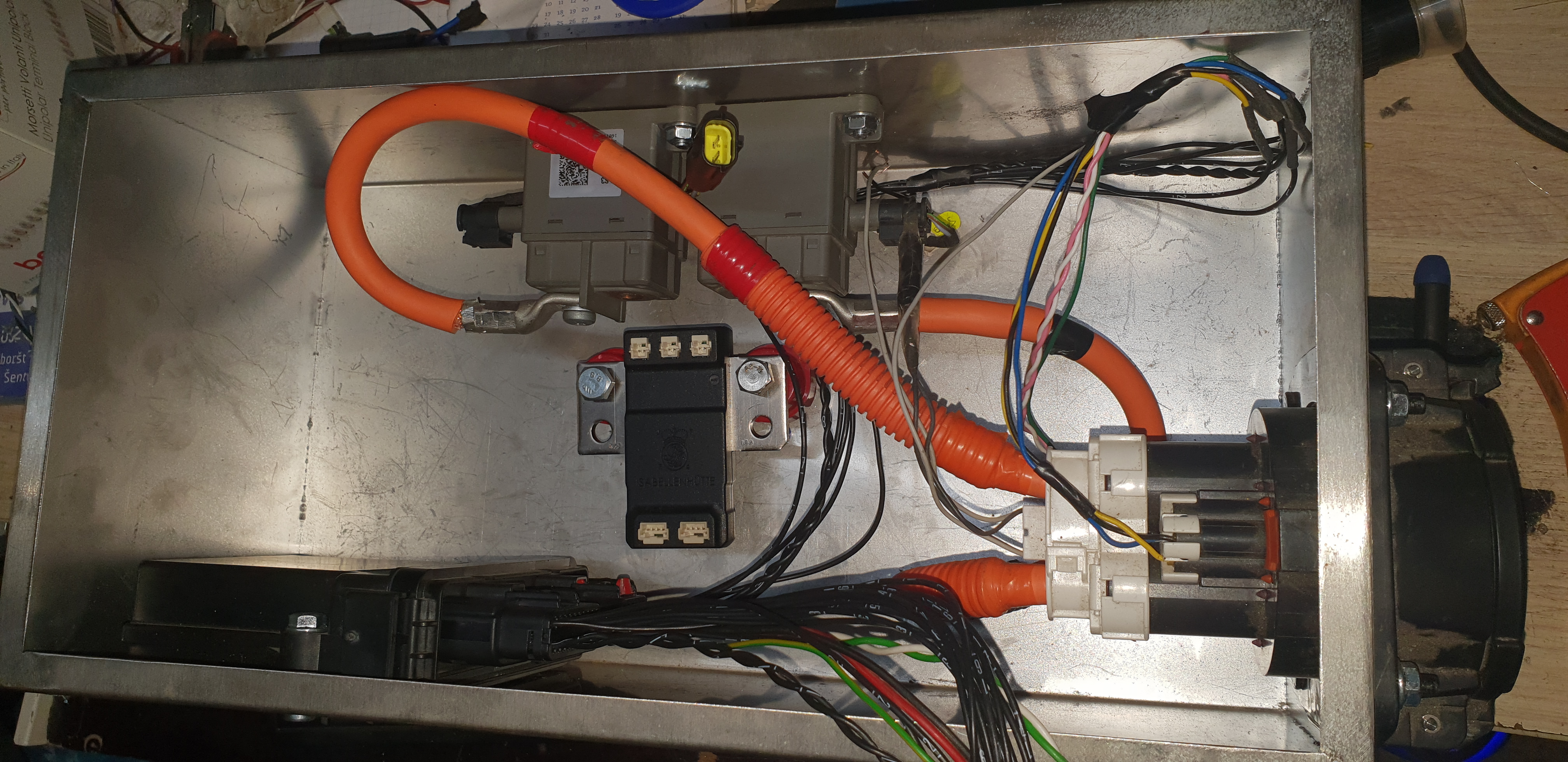

I've flipped it around so at least in terms of current flow it is in the "right" orientation, just off of the + side of the pack instead of the -.
What's odd to me is that the power sign won't change even when I tell it to. The shunt is more than happy to swap the sign of the voltage and amperage reading when I tell it to, but power won't change.
Based on everything I can easily test, the shunt is working correctly. Voltage matches what I see from a multimeter, and amperage seems correct when running my level 1 charger.

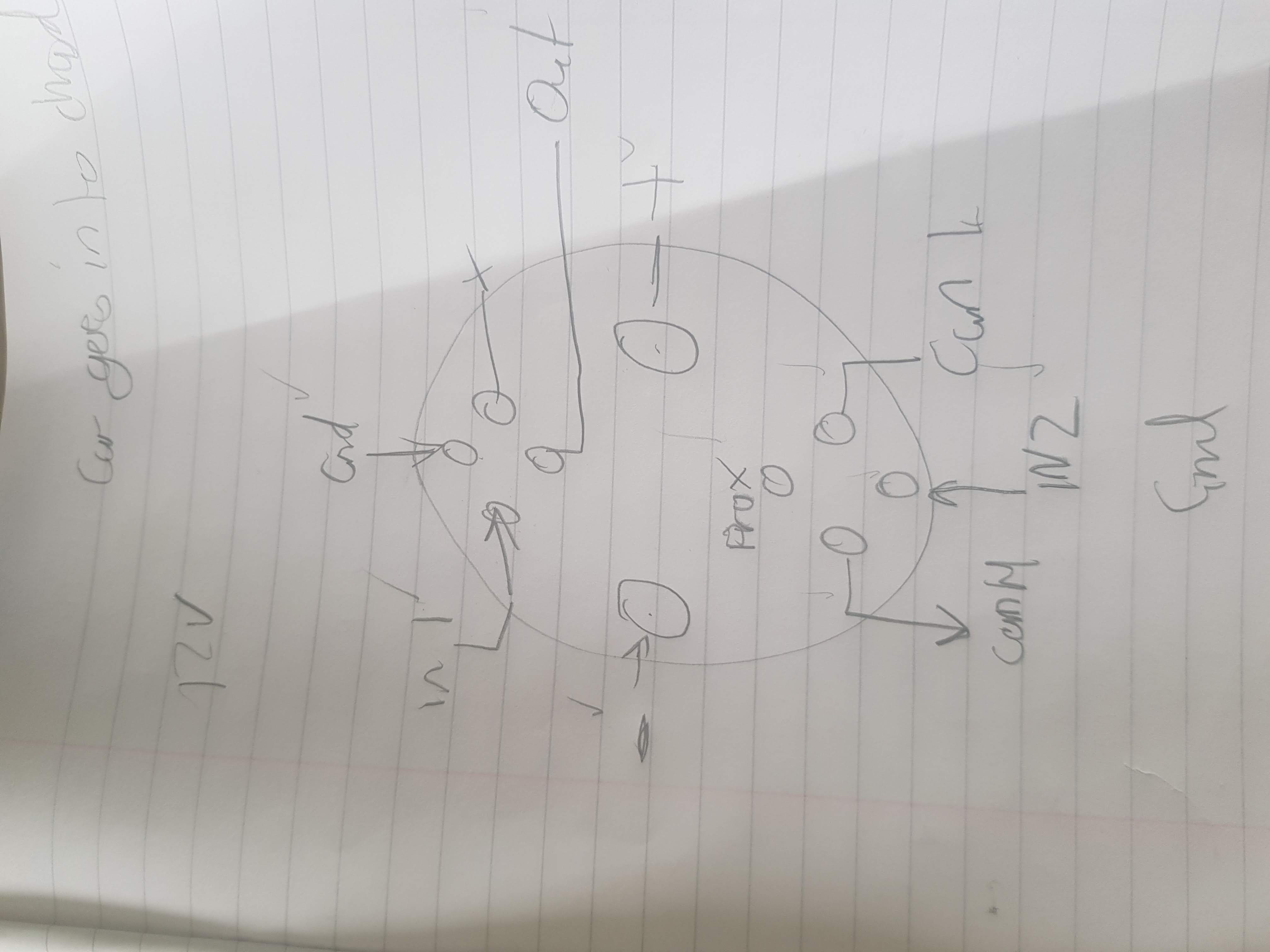

See attached sketch of my HV wiring.
To the best of my knowledge, there are no instructions for the STM32 version. I was hoping to put them together once I got this working.
Damien, if you're willing to share, how many STM32 versions were sold and do you know of others that may be working? (not to imply there is an issue with the board, but to find some help).

Okay, wiring looking good. Shunt on the HV side should not cause any issues but it's always possible, that might be a last thing to change.P.S.Mangelsdorf wrote: ↑Mon Feb 14, 2022 3:34 pm

Hi Isaac96Isaac96 wrote: ↑Sun Jan 30, 2022 10:14 pm Backwards installation shouldn't cause damage.
Looking at your picture: I don't see a voltage sensing connection?
One of the 2-pin connectors needs to be connected to the opposite side of the HV bus (if shunt is on negative then connect 2-pin to positive).
Here's how I had mine hooked up (this is in a RAV4 EV). Pack wiring is on the left, chademo power comes in on the right (orange wires).
EDIT Note that there are three voltage sense connectors; sensor 1 is used for power measurements and has highest priority, not sure which one is read by the Chademo VCU (since all can be accessed via CAN).
I would like to have a permanent connection for ISA voltage measurement. Why did you connect across contactors on chademo side? What if i would connect my ISA on the pack side? Would i need to connect in reverse of your connection to have correct current flow?
What i want is constant voltage measurement on the pack side. This should allow me to make a modular chademo box which i would be able to use with several cars as long as i would have direct DC link access. It would be a good excercise in jaguar cells thermal capability as well...

This attempt was at an Electrify America station. I got all the way through the process right up to delivering power, and then it failed.
I got a CAN log and a screen capture, but for some reason its not letting me add the screen capture.
The web interface is still showing 0% SOC, which I think is the error. I did have the shunt installed backwards for a while. Could I have damaged the shunt, where it is still communicating but not measuring properly?

In the end i wired CHADEMO box to receive 12V power from the car.
First testing went OK. I connected without DC battery connected and i got satisfying clicks when station tried to measure voltage and isolation. Of course i got an error because DC link was off.
Next tests were with battery connected. Here the bad starts. Station went through isolation monitoring and paused for a second and innitiated contactors to start charging process. Then almost immediately contactors went offline and station showed: "error, no CAN data from vehicle".
When i checked from VCU i got "error 32" msg. I am not sure what to do, since when i check the ISA interface everything works.
@Isaac96, any comments?

Hmm. Going through isolation and getting contactors on means CAN is working up to that point.
Error 32 is just "EVSE_STATUS_STOPPED" -- nothing really helpful there, but it means the car didn't throw the error, the station did.
Hmm. When D2 turns on (goes to ground) it should pull IN2 low. Maybe that polarity is reversed? I had issues when creating the code with all sorts of different hardware (I used some years ago, then used Leaf VCU, then 'official' chademo controller. Lots of different configurations.)

On top of that i found a bigger failure... i wired HV+/- cables in mirror
![Sad :(](./images/smilies/icon_e_sad.png)
EDIT: No joy! i made several tests and there is allways no CAN communication error on EVSE.
