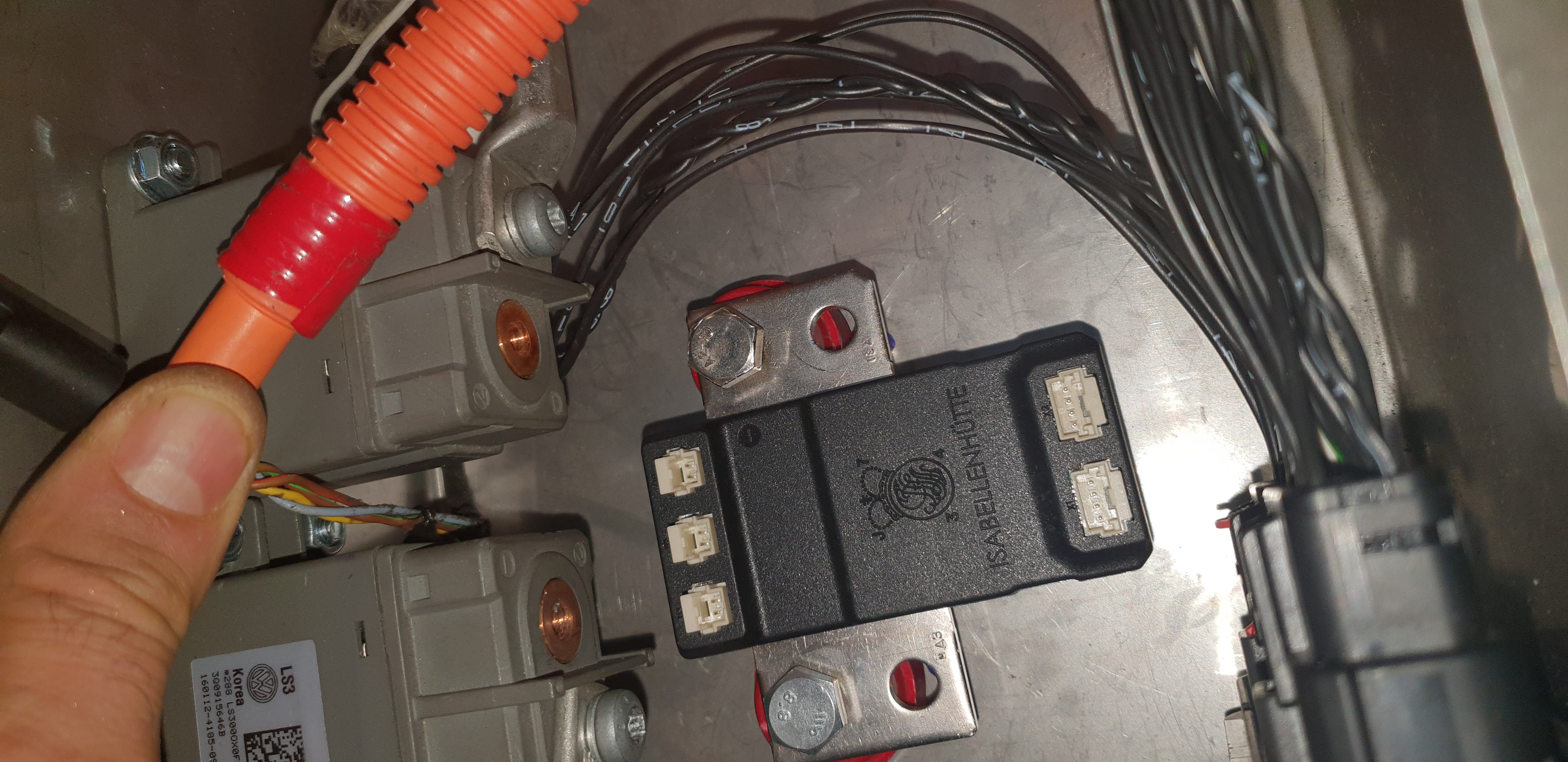

Ok so I tested several configurations and can't seem to find the issue, though I did have some interesting settings issues.
First, in all cases the error message from the Electrify America charger was 23_00H_0 This occurred after the station appeared to begin delivering power. Watching on the web interface, it appears the station does all of its checks (station side voltage rises, drops to zero, the rises back to the car's voltage), and I hear the contactors close in the car and the station, but then it throws the "Malfunction|Stop" error message in the web interface and the station says charging failed.
Second, I played around with the signs of various items from the shunt, and observed an interesting result.
- Regardless of the signs of Volts and Amps, the sign of kW stayed the same.
- Changing the setting for kW did not change the sign either.
- No matter what settings I use, I get negative kW when power is leaving the pack, and positive when it is entering (tested by running the motor with the car on jack stands). This seems like it should be what the controller wants, but I'm not sure at this point.
I can't seem to figure out what combination of signs the controller wants. Can anyone else that has this functioning tell me what they are seeing sign-wise in the web interface so I can attempt to match?

    P.S.Mangelsdorf wrote: Sat Feb 12, 2022 2:24 pm
    hmm is this again a case of the “wrong” orientation ? Might be worth flipping it just too see.
    you’ve verified that the shunt is working properly, outside of the vcu? which it seems like so it’s just the vcu running itself?

    Bratitude wrote: Sat Feb 12, 2022 4:05 pm hmm is this again a case of the “wrong” orientation ? Might be worth flipping it just too see.
    I've flipped it around so at least in terms of current flow it is in the "right" orientation, just off of the + side of the pack instead of the -.
    What's odd to me is that the power sign won't change even when I tell it to. The shunt is more than happy to swap the sign of the voltage and amperage reading when I tell it to, but power won't change.
    Based on everything I can easily test, the shunt is working correctly. Voltage matches what I see from a multimeter, and amperage seems correct when running my level 1 charger.

    Interesting. What do you have in terms of wiring diagrams? Is there an instruction manual for this STM32 chademo unit?
    Power sign really ought to change, that's quite strange.

    Isaac96 wrote: Sat Feb 12, 2022 9:33 pm Interesting. What do you have in terms of wiring diagrams?
    See attached sketch of my HV wiring.

    I went on and checked ISA output on serial monitor. It doesnt seem to output anything. I tried to innitialize it and hook it up to 14V for voltage measurement and 3A light bulb load for current. It doesnt seem to show anything. And i have two ISA sensors here that behave the same!!!
    Do you know an option to check if ithe sensors work?
    All i get are 0s.

    Well that is strange... i get plenty of raw CAN data on Canalyst and when i apply 12V battery or lamp load CAN data changes. Sensor works, its just that my VCU doesnt receive data...

    Which CAN bus are you on? And which firmware version is this? I think I had ISA on one bus and the EVSE on the other bus just to avoid any issue with bus load (also so you can have ISA talking to the rest of the car).
    Posts: 3795
    Been thanked: 411 times
    Isaac96 wrote: Wed May 04, 2022 12:54 am Which CAN bus are you on? And which firmware version is this? I think I had ISA on one bus and the EVSE on the other bus just to avoid any issue with bus load (also so you can have ISA talking to the rest of the car).
    There is something strange with VCU. Yesterday i connected via Canalyst tool to 1st CAN bus where i have ISA connected. When i provided pin 7 with pulldown ISA started to operate, but i got nothing out of the second CAN towards CHADEMO. When i persisted i noticed this is only transient and many times i could get good signal out... strange. I also tested this with HV connected and off and i must say failure happened more often if there was HV present.
    On top of that i found a bigger failure... i wired HV+/- cables in mirror :(. No wonder Chademo would throw a flag, it was seeing reverse voltage. I corrected that and i get good positive signal from ISA and i will confirm this in a test.
    EDIT: No joy! i made several tests and there is allways no CAN communication error on EVSE.
    I am connected to ISA via the CAN0 and the second CAN1 i use for Chademo. I see sometimes when PP pin pulls down relay on pin 7 and powers the VCU.
