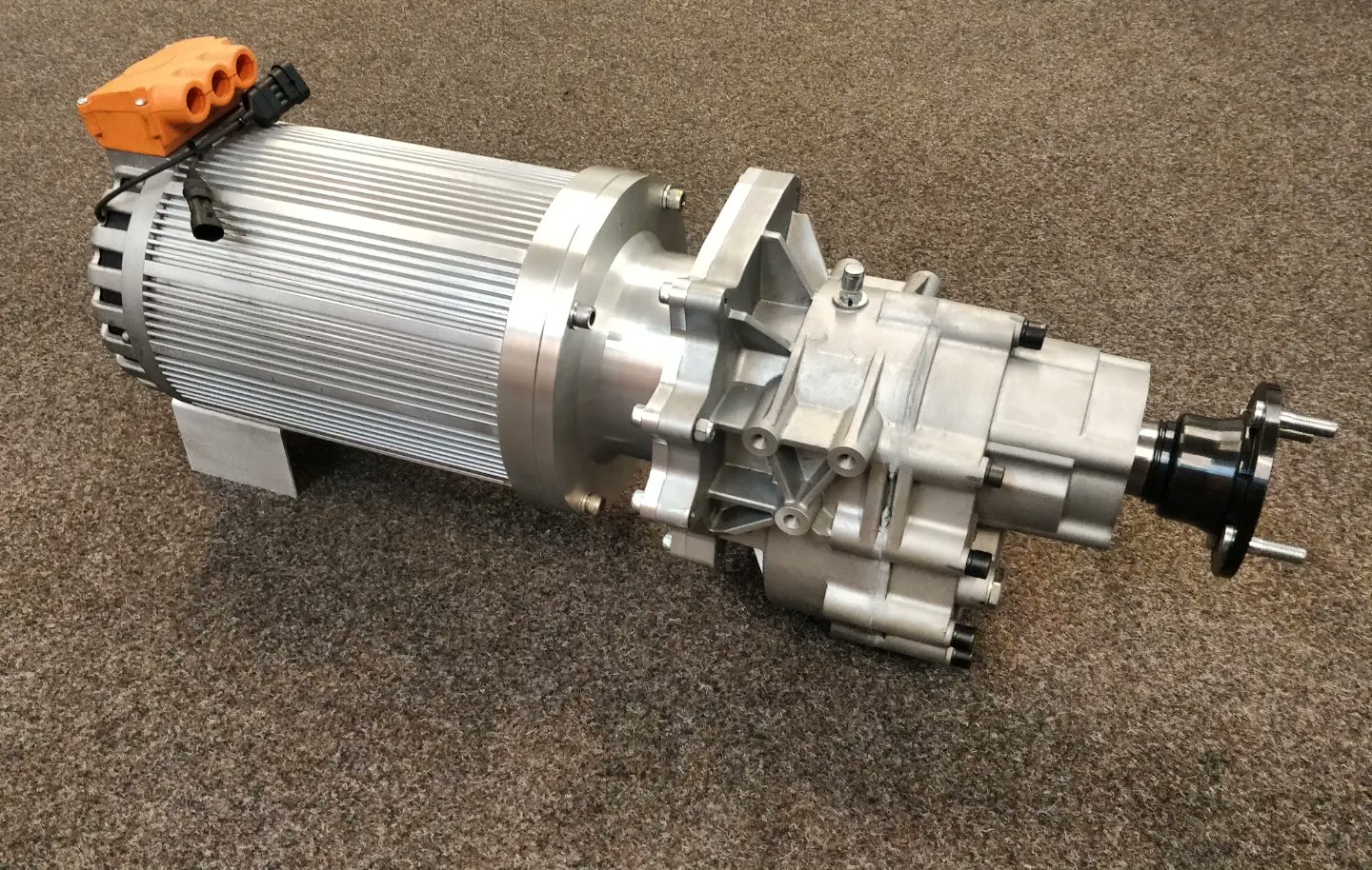

I was talking to Chris from Zero EV, about the reduction box they were testing to fit the Hyper 9. The first example was similar to the Torque Trends gearbox, but the epicyclic design was too noisy and generated too much heat. They've now found an existing reduction gearbox design that they could have modified to make it suitable for EV applications. It's officially rated at 280Nm, but Chris thinks it can take a fair bit more and said the cost was about £1600.
With a different coupler and adaptor, it could be mated to a Leaf motor.
Re: RWD reduction box
I just heard about this myself. It definitely sound interesting and they have two ratio options 2:1 and 1.75:1
I got adapter plates with the NEMA b face pattern, so that’s covered.
what’s the coupler look like?
This looks like the tail end of some transmission
I've emailed them for more info on this and one of their new motors.
It probably is an adaptation of a transmission output. And there could be some sort of changeable coupler in there as the hyper9 and their new motors have different shafts.
I'm hoping it has a speedo drive also.

Yes, what tail section is this from what is it? Who makes it?
