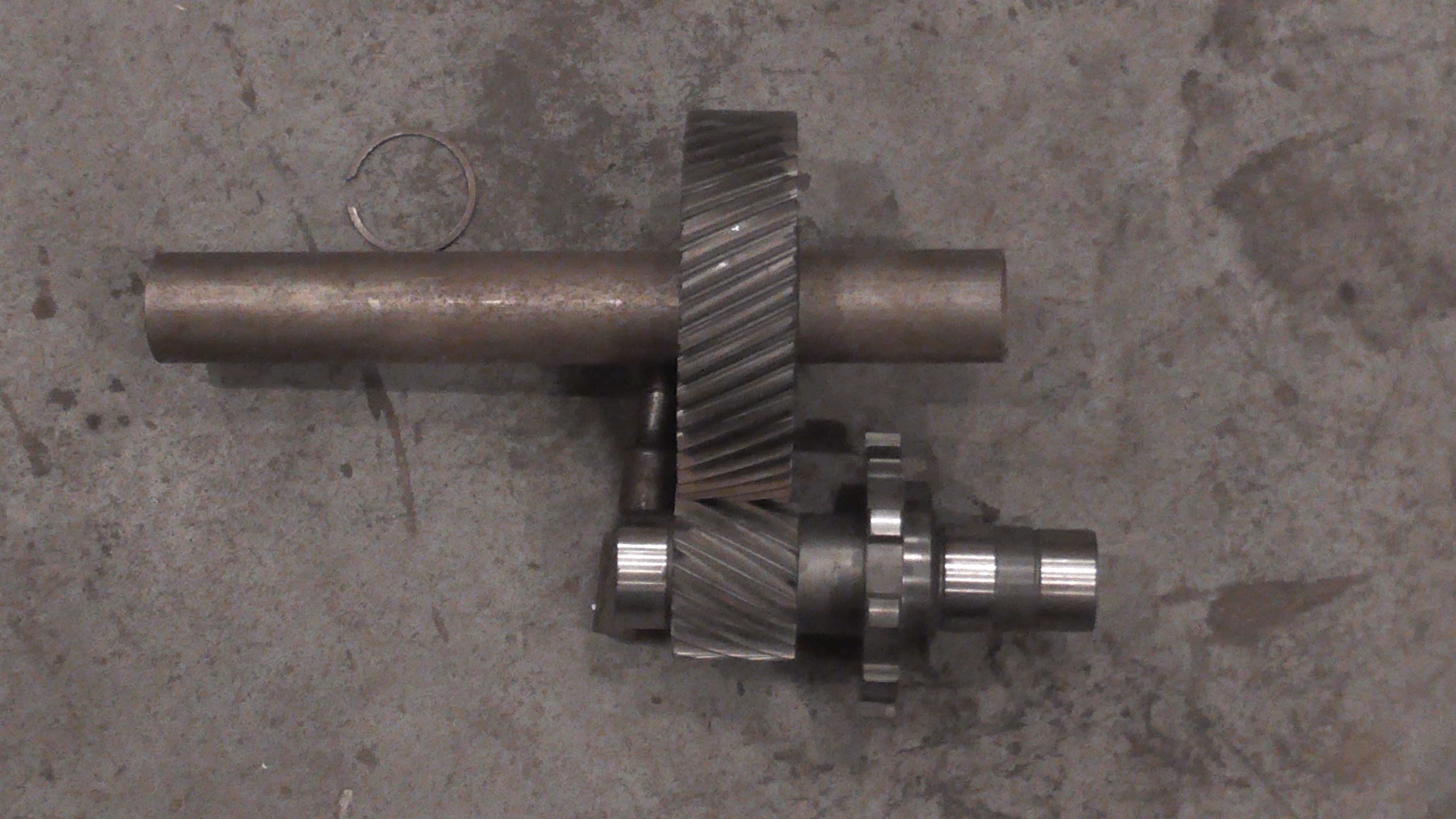

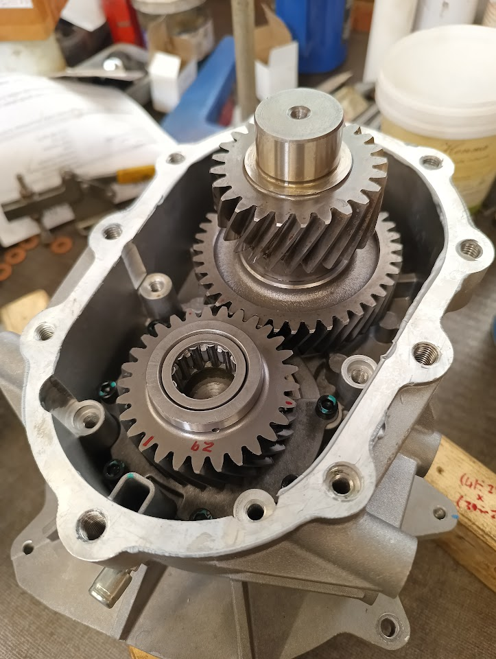

I've been considering using the first reduction stage of the Leaf gearbox as the basis for a rear wheel drive gearbox.
It appears that the gear driven from the input pinion is splined to its shaft, so it should be relatively simple to machine a new output shaft for it.
I'm hoping that the ratio changes between the Gen 1 gearbox and the Gen 2 were achieved by shifting the pitch diameters and the shaft centres are identical.
Gen 1 gears 17:31 / 17:74
Gen 2 gears 17:32 / 17:75
At the moment I have a Gen1 gearbox, but the Gen2 ratio looks a better match for my 4.1 final drive.

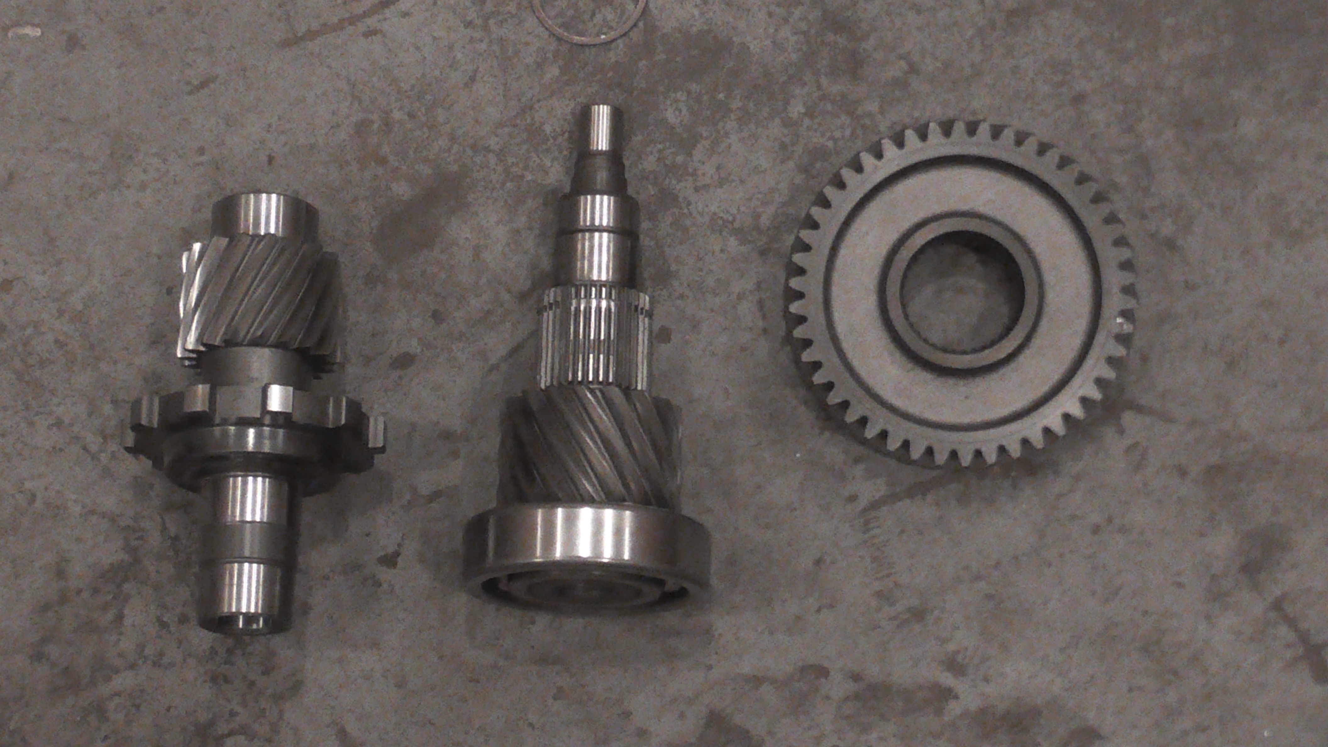

I'm looking into the idea of using parts of the Leaf transaxle to make a reduction drive to replace the original gearbox in rear wheel drive vehicles.

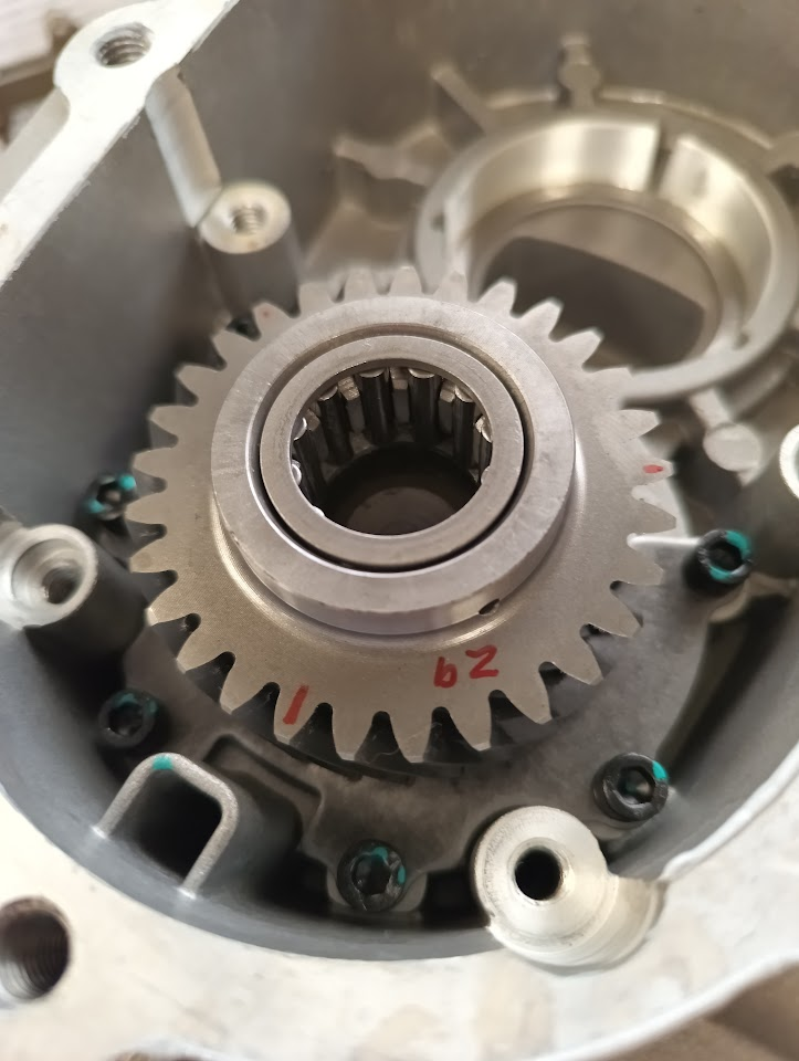

Thanks to zippy500, I have a set of gears and as I thought, the intermediate shaft input gear is splined and can easily be removed.
I'll have to make a new shaft, splined to take the gear and a new housing, but I think this will work as a RWD reduction drive.
Ratio is 32/17 or 1.882:1, which should work OK with the 4.1 diff ratio in my Lotus. That's taller gearing than the Leaf final drive, but the rolling radius is a little smaller too.
Leafs with the EM61 motor have slightly taller gearing of 31/17 or 1.824.

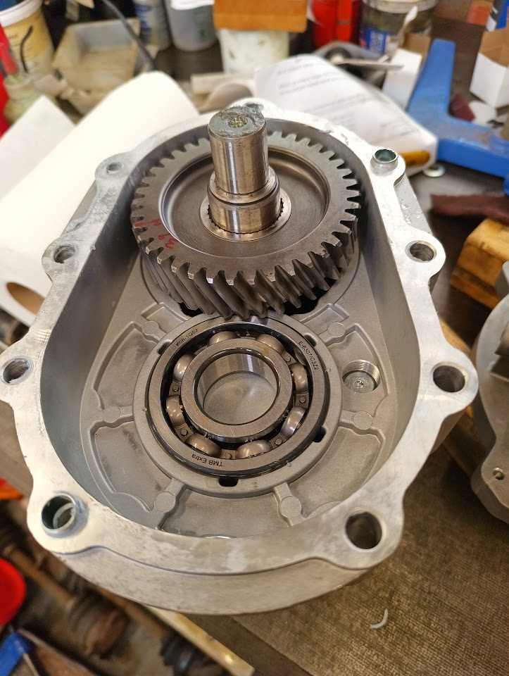

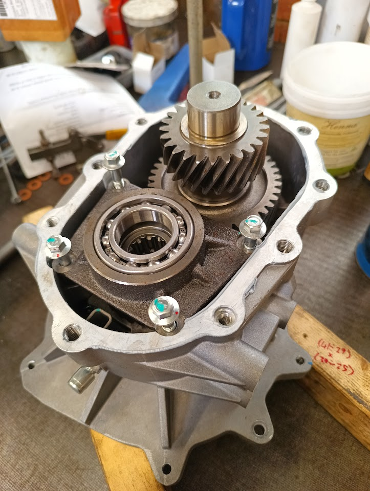

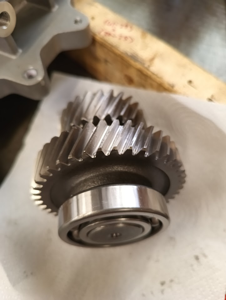

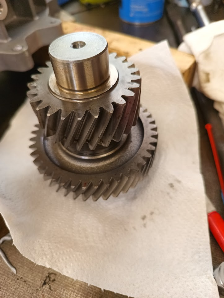

I’ve been working on this and had some ideas use the original gearbox case bit bulky I know
But it’s already there I’ve machined off the brush carrier housing for now which gives a flat area to bolts to adapter plate to bolt to gearbox transfer box whatever you need
The output shaft needs to be bigger and longer I’m going for 35mm in diameter bought a 72 x 35 x 17 bearing to go on the output end of the shaft that’s coming
And I’m trying to get my head around machining double spline shaft to go from the inner gear to output splines
Going to do a video on this hopefully out middle of this week
Stuart

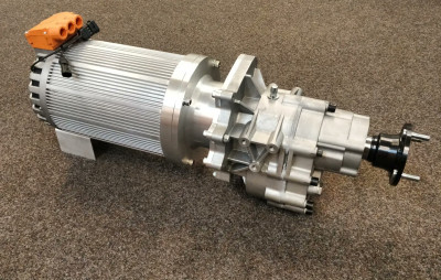

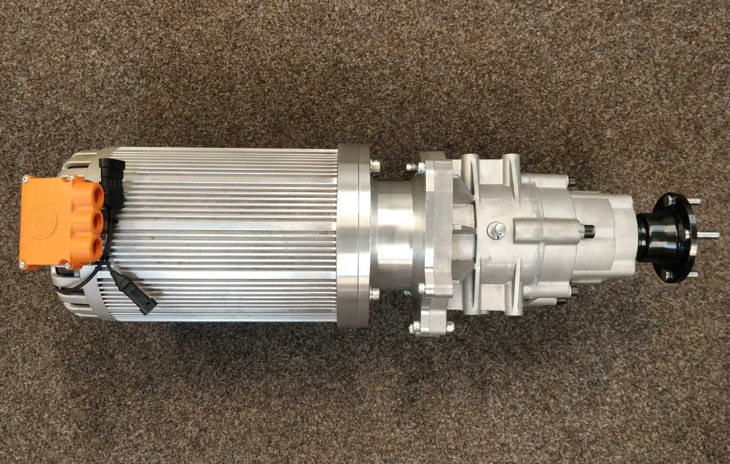

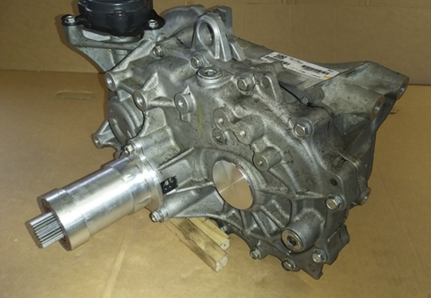

I was talking to Chris from Zero EV, about the reduction box they were testing to fit the Hyper 9. The first example was similar to the Torque Trends gearbox, but the epicyclic design was too noisy and generated too much heat. They've now found an existing reduction gearbox design that they could have modified to make it suitable for EV applications. It's officially rated at 280Nm, but Chris thinks it can take a fair bit more and said the cost was about £1600.
With a different coupler and adaptor, it could be mated to a Leaf motor.

I just heard about this myself. It definitely sound interesting and they have two ratio options 2:1 and 1.75:1

I got adapter plates with the NEMA b face pattern, so that’s covered.
what’s the coupler look like?
This looks like the tail end of some transmission

I've emailed them for more info on this and one of their new motors.
It probably is an adaptation of a transmission output. And there could be some sort of changeable coupler in there as the hyper9 and their new motors have different shafts.

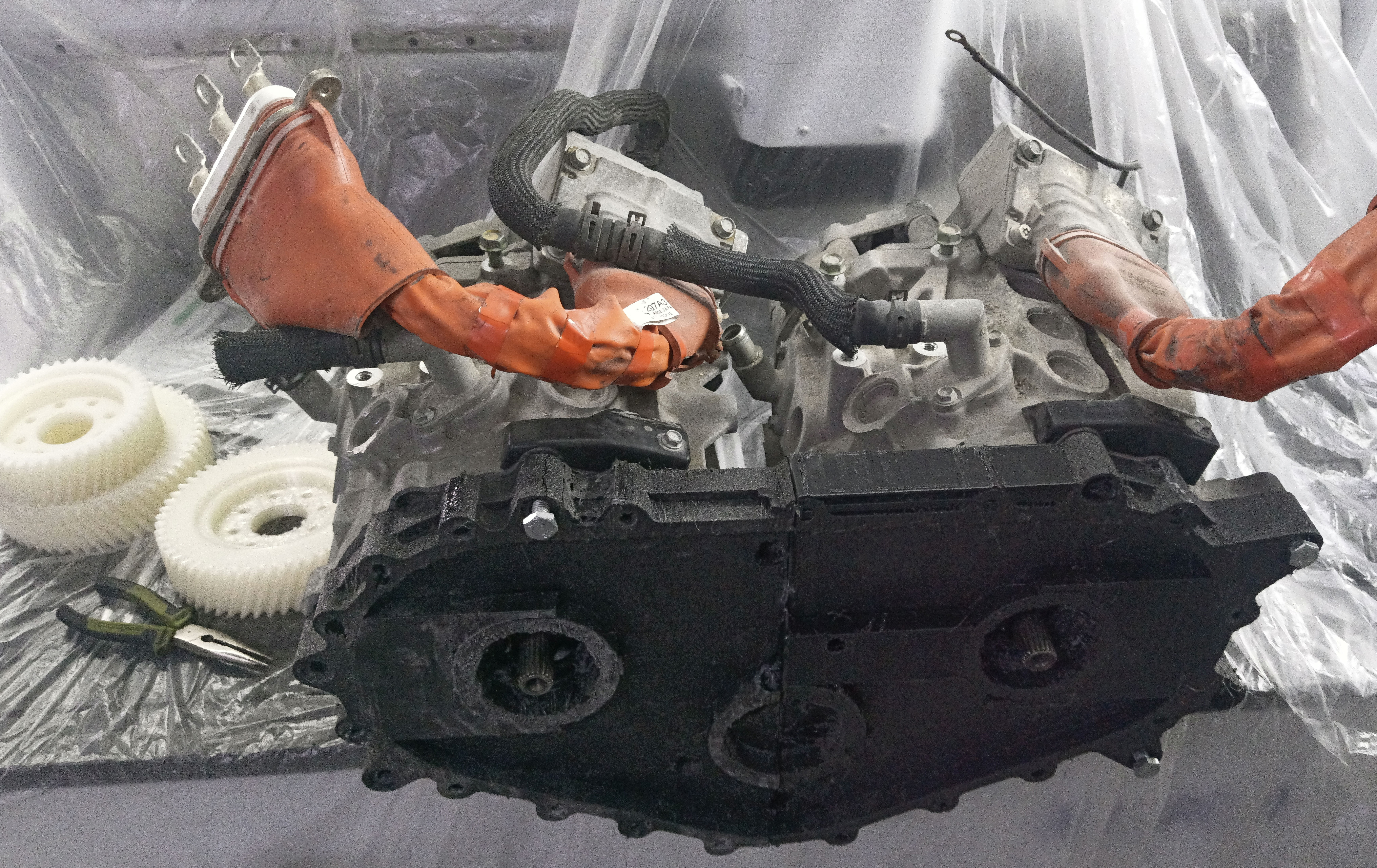

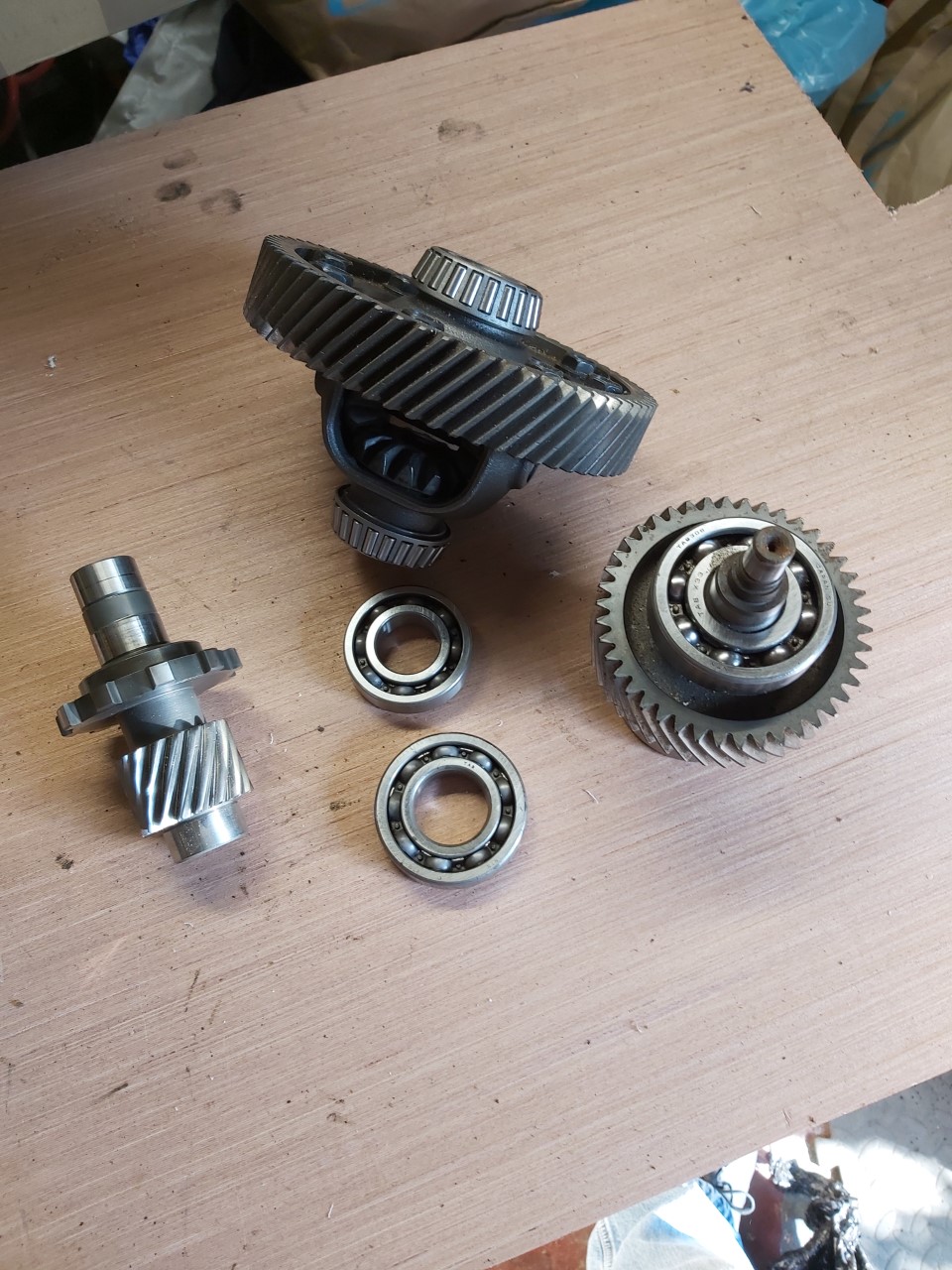

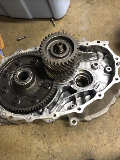

We have punched a hole through the Leaf gearbox, so we are not using its differential and connect the middle cog to the taxi differential.
This made us end up with about a fixed 8:1 reduction which has held very well for more than a thousand miles now.
I am not very mechanical, they talked a bunch about the oil in it, and something about brushes and seals but that is all solved it doesn't leak.
