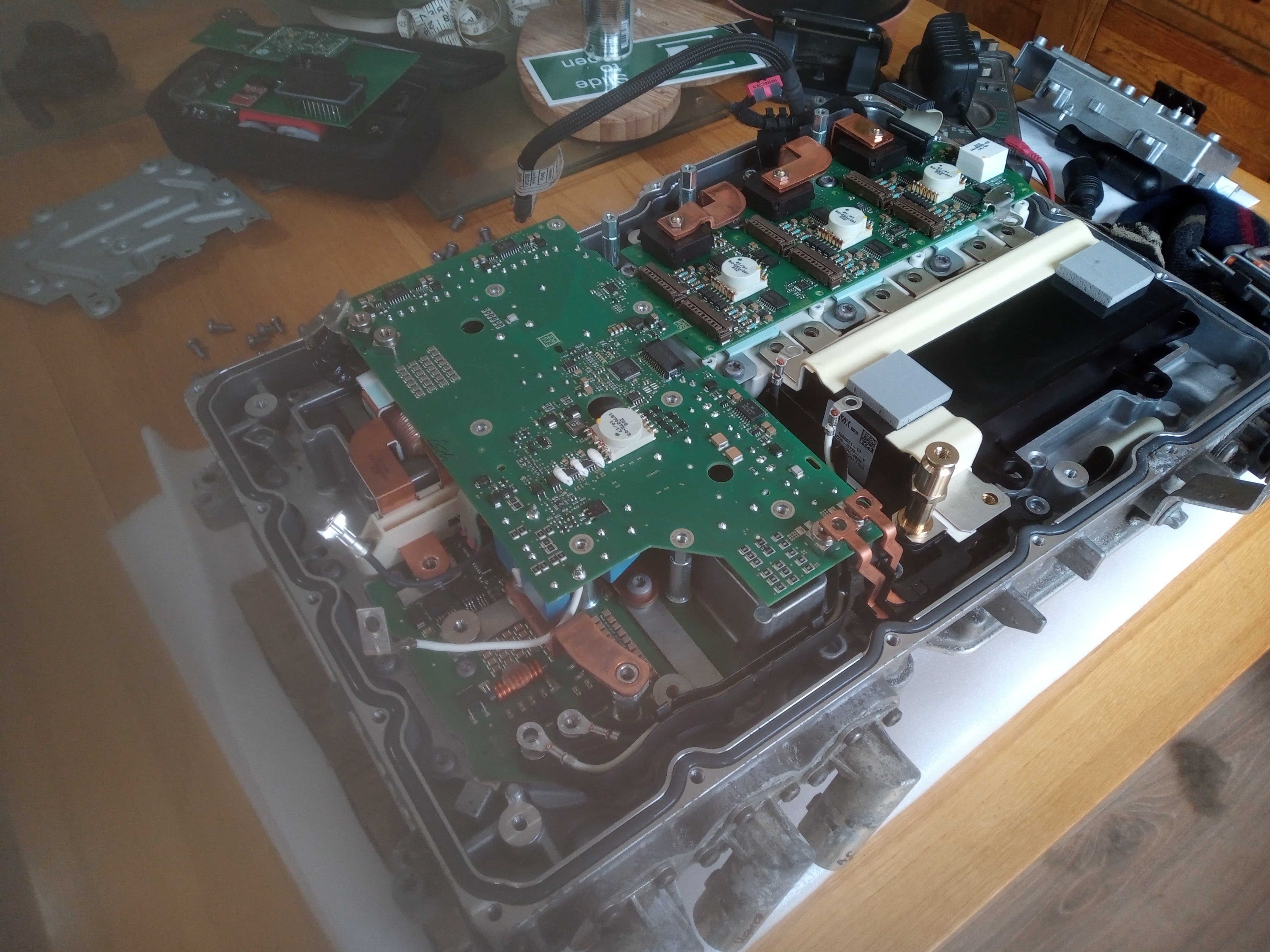

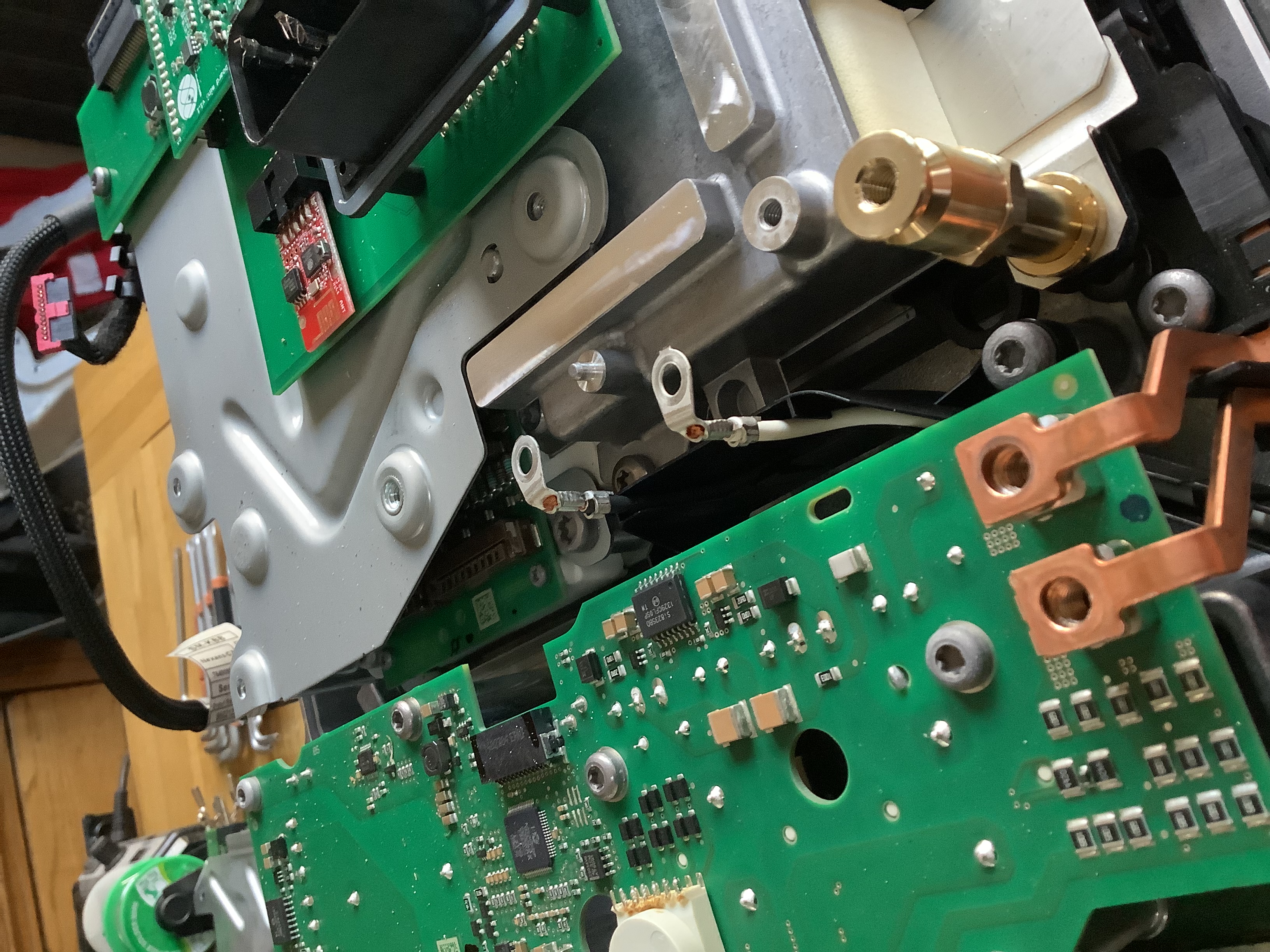

Does anyone know what the black an white wires do?
Is it power and earth to the old board?

Ok, thanks, I thought it looked like it had got hot.

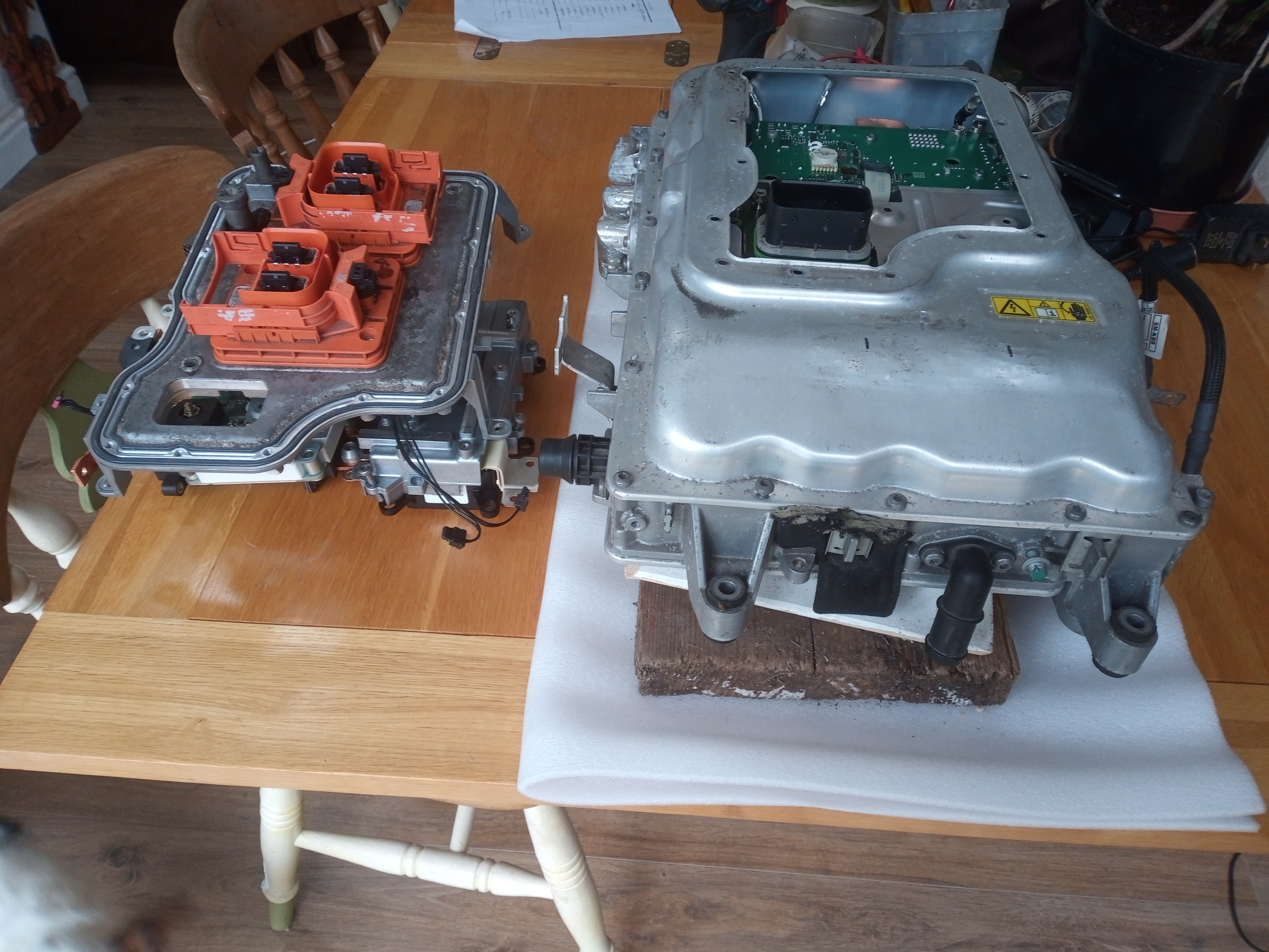

Sorry, I must have missed something, can we still not make use of the dc-dc converter?MrX wrote: ↑Sat Dec 18, 2021 9:42 am
3. Lastly, I've made some waterjet cut blanking plates to close off cooling for the charger and DCDC inside the housing. This is just to remove them whilst they aren't doing anything useful and remove some weight from the assembly. Unfortunately it's not straightforward to do this, as some posts have to be machined down for these flat plates to fit, and this exposes one of the threads from the liquid side. I've hydraulically sealed this one, so it shouldn't be a problem (fingers crossed). If people want DXF files for these I can definitely send some links. They are definitely not perfect, and will need some modification to fit well. I did as best I could for hole placement for a first-pass. Fine for now though!

Hi Hans,Hans Gustafsson wrote: ↑Sun Dec 26, 2021 5:12 pm Pinout with the colors for the resolver, suggestions and not verified.
With 12 pin adapter card and solder directly to the card.
Please forgive my stupidity, I am new to all of this.
So the resolver is detecting the rotation of the motor and feeding that info back via the board you have added, is that right?
I notice that you as well as MrX have removed the dc-dc charger, is this because you will use an aftermarket one?
Cheers

Wow!
How did you guys get the dc-dc converter out?
It looks like I'm going to have to go in from the other side to get to the bolt beneath the capacitor

So I've been having a bit of a think and due to the size of the mIni engine bay I am thinking of separating out the inverter parts from the inverter casing and finding something more suitable to house them. I'll probably then go for a separate dc-dc converter and charger in the back of the car.

That sounds very sane. The chances of that DC-DC converter and charger getting hacked are minimal

So I would start with measurements on the PCB.
From Chip to BMW part.

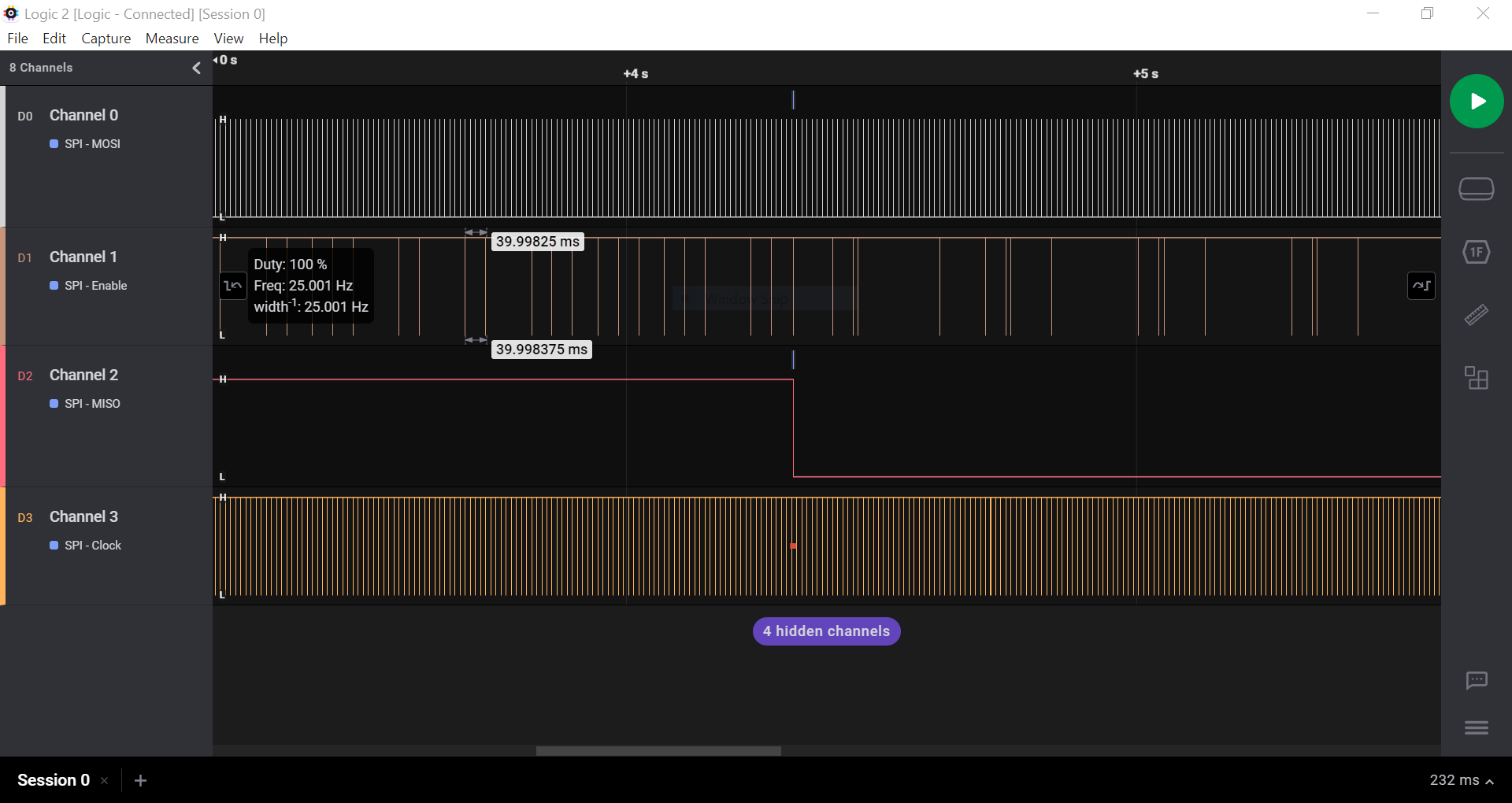

Yep, solder jumper checked. Just in case this helps at all Johannes, I have confirmed 32V reg, and I’m supplying 30V to the DC bus. It seems to have around 1W of consumption on the DC bus side, I’m guessing from the isolated gate drive power.johu wrote: ↑Mon Apr 25, 2022 4:55 pm Also, did you check the solder jumper? viewtopic.php?p=36365#p36365
Going to get a logic analyser from my mate and see what’s going on…
Re: i3 controller hacking from diyelectriccar.com
Well that's strange. MOSI and *CLK cycling together, with no data. Garbage on SCK, and nothing on MISO. I'm also only seeing pulses at 1kHz intervals, so I suspect I need to get an oscilloscope on the thing.
Note there is one transition on MISO, which is when I turn on 30V to the DC bus to power the isolated side.
