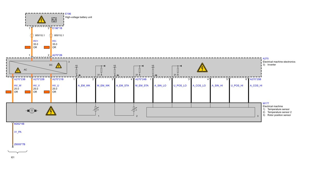

Hans Gustafsson
Posts: 20
Joined: Tue Feb 09, 2021 9:13 am
Location: Sweden
Re: i3 controller hacking from diyelectriccar.com
Post by Hans Gustafsson »
Have updated resolver wiring to my latest belief.
1. 12V
2. BRAKE_IN
3. PRECHARGE_OUT
4. CANL
5. CANH
6. DCSW_OUT
7. FORWARD_IN
8. REVERSE_IN
9. 5V (OUT)
10. RESOLVER_S2/ENCODER_A Blue (Sin2, Sin L)
11. GND
12. RESOLVER_S1 Red (Cos1, Cos H)
13. THROTTLE1
14. THROTTLE2
15. RESOLVER_R1 Yellow (REF1, Ex H)
16. RESOLVER_S3/ENCODER_B White (Cos2, Cos L)
17. MTEMP+ Blue
18. MTEMP- Grey
19. RESOLVER_S4 Brown (Sin1, Sin H)
20. EMCYSTOP_IN
21. GND
22. RESOLVER_R2 Green (Ref2, Ex L)
23. START_IN
golfdubcrazy
Posts: 88
Been thanked: 11 times
Post by golfdubcrazy »
hopefully this helps.
A_SIN_HI and A_SIN_LO
Setpoint value: 22.4 ohm to 33.6 ohm
A_COS_HI and A_COS_LO
U_POS_HI and U_POS_LO
Setpoint value: 13.6 ohm to 20.4 ohm
Nominal values
‐-20 °C 318 kOhm
‐10 °C 175 kOhm
‐5 °C 132 kOhm
0 °C 101 kOhm
5 °C 78 kOhm
10 °C 60 kOhm
15 °C 47 kOhm
20 °C 37 kOhm
25 °C 30 kOhm
30 °C 24 kOhm
40 °C 16 kOhm
50 °C 11 kOhm
60 °C 7 kOhm
Been thanked: 1913 times
Good, will add that. Matches none of the existing sensors unfortunately.

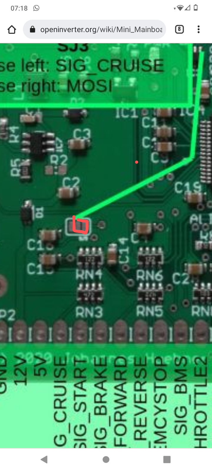

I noticed that I forgot to close SJ3 for you: https://openinverter.org/wiki/Mini_Mainboard
Just put a solder blob on to the direction of C4 on there.

I'm not sure how to add photos on here, if this works is this where you want the solder Johu?

Do you mean the centre connection to the connection on the right (nearest C4)?

You can post photos in the attachment tab below the editing field

Exactly, that one, those two pads

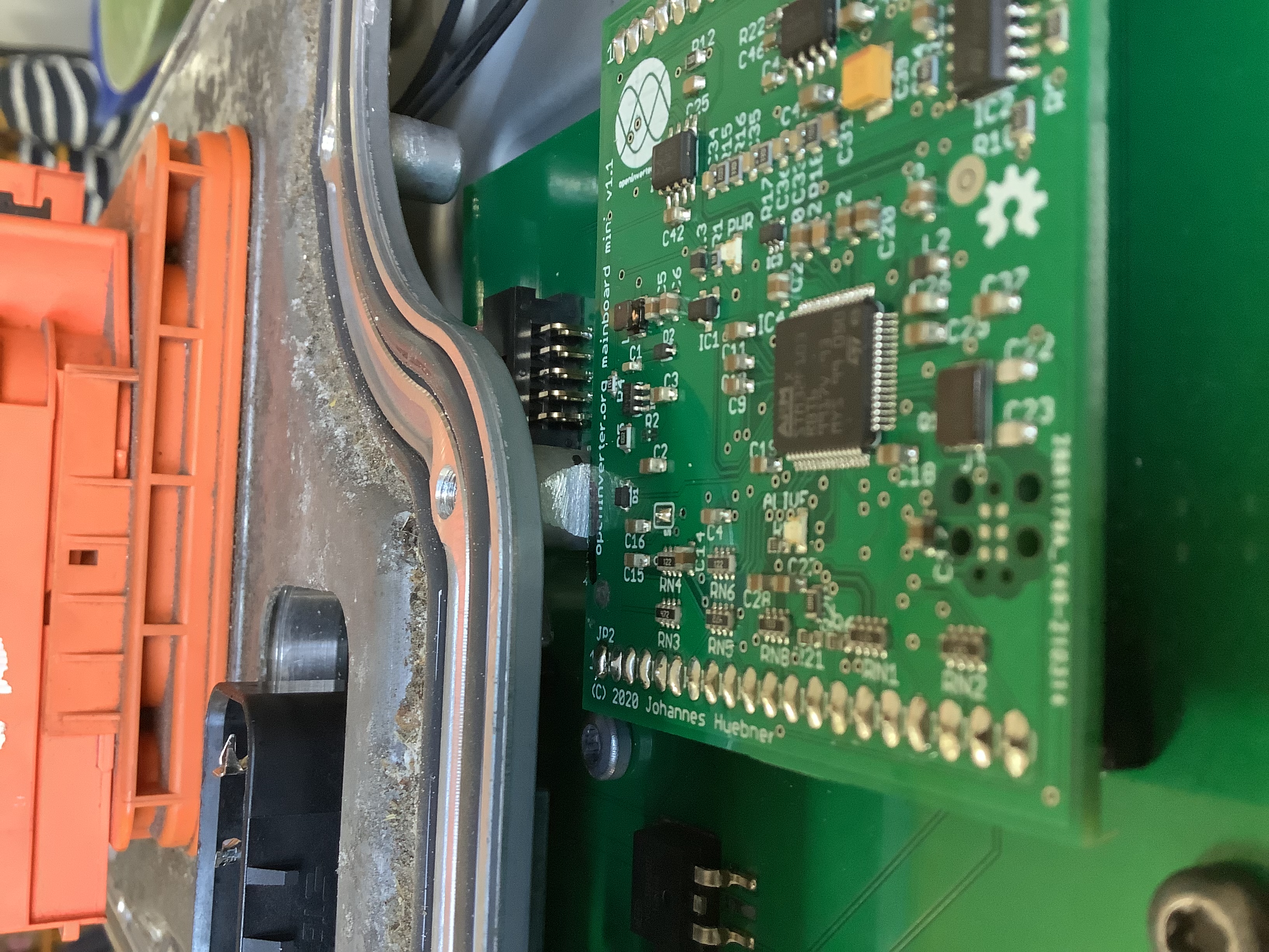

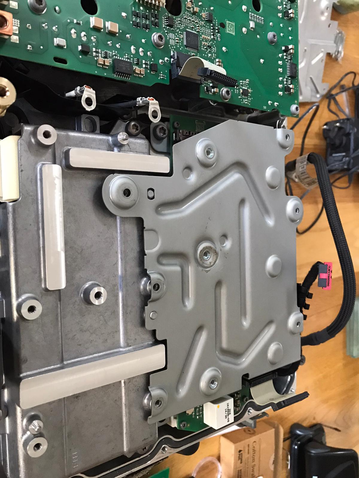

I've bent the backing plate using a socket and vice to give clearance to the board. Is anyone else looking to put the plate on top of the board too?
Restoring and converting a Classic Mini, I have mad ideas, semi sensible ideas and NO idea if I’ll ever get it done :lol:

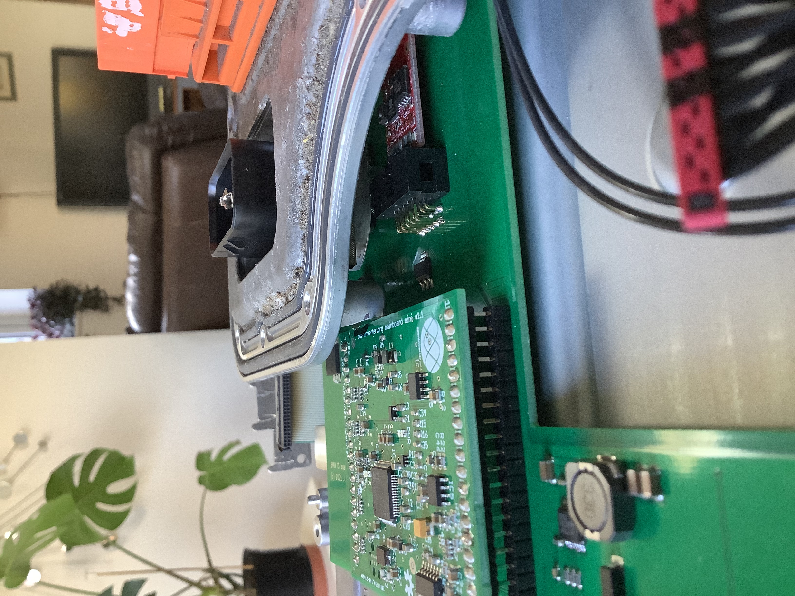

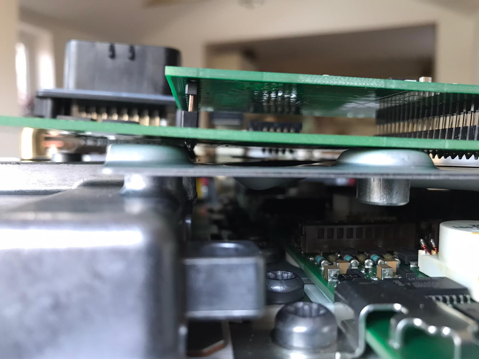

Putting the bits back together as someone mentioned on here before the board comes into contact with one of the bolt holes from the upper plate. If the small board could be moved 4 or 5 mm towards the edge it would have clearance.

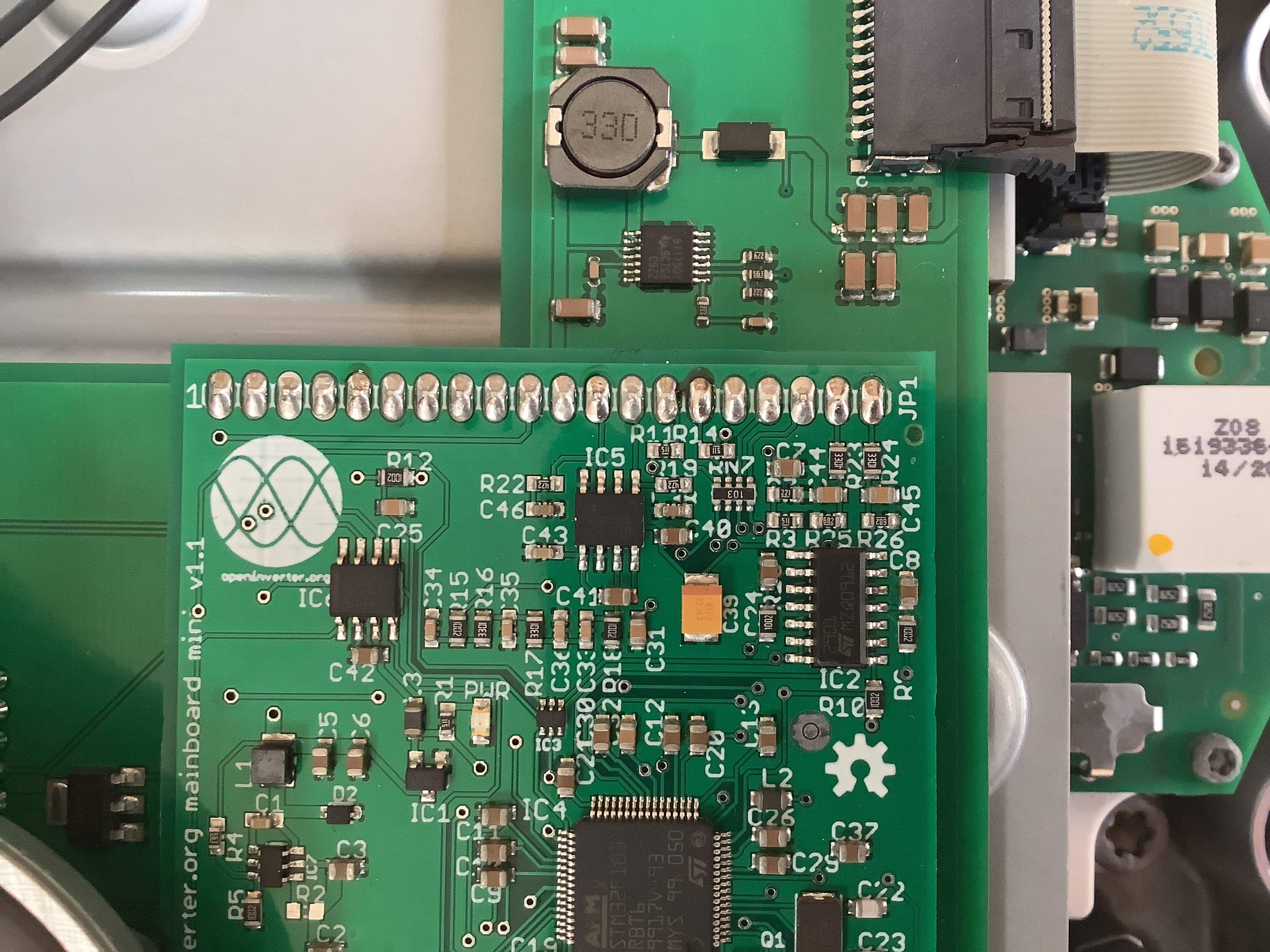

Bugger, I have signs of overheating already on the 6th pin from the right, any ideas?
Why do you think it's overheating? I can just see some excess flux. There is no serious current on any of the pins

I’ve managed to file the upper plate bolt retainer without going through to the thread, hopefully that’s enough clearance

I’ve had to reshape the lid a bit, pushing it out away from the board between the two lines.
