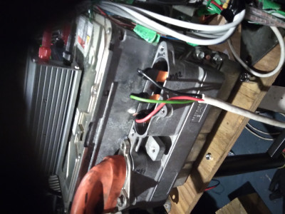

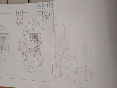

Re: Hyper car hybrid
Have revisited the Lexus gs450h inverter and the MG2 driving Q211, from a Hylander rear Motor Generator. Using Damien's gs450h board, so I believe the Zombie board will do the same.
Here are the connections that gave fwd and rev .

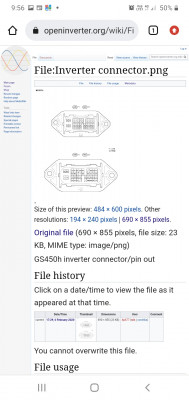

Why are the connections so vastly different from the Camry connectors?Have revisited the Lexus gs450h inverter and the MG2 driving Q211, from a Hylander rear Motor Generator. Using Damien's gs450h board, so I believe the Zombie board will do the same.
https://openinverter.org/wiki/images/9/ ... con-et.png
Did you trace them back inside the inverter?
It does seam odd that Toyota/Lexus use the same type of connectors but with completely different pin connections
or am I missing something here?
A great job to get it working !
Hi Dale, plug pin connections from wiki, which was my starting point. Seems that the Camray do have quite different pin connections...

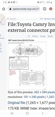

Wiki Lexus gs450h open inverter.
Just a bit further down the page is this Camry pinout.
Seems all the resolvers are separate, probably for ease of assembly....
