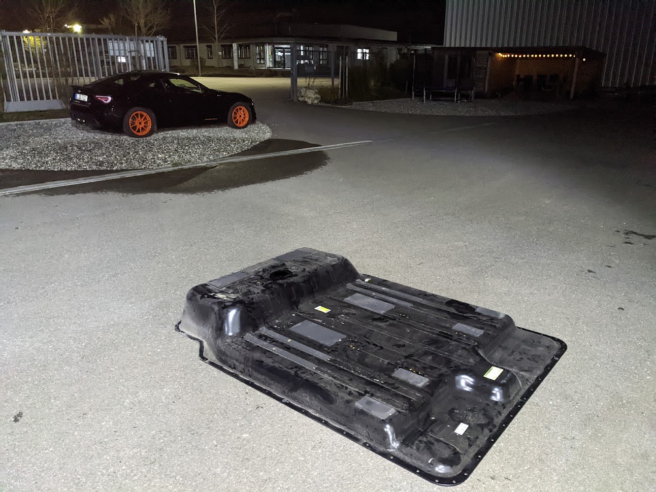

Yesterday i took the battery apart. To get 96 of the 98 Kona-Cells in the Impreza it'll be the same puzzle as it was on the GT86 Project.
Also i have to convert 6 of the 8 10S3P Blocks to 9S3P. Two of the Blocks are by factory 9S3P (8x 10S3P + 2x 9S3P = 98 Cells). The Orion BMS can only support 96 Cells in my version, so i won't use 2 of them which equals in 1,3 Kwh less.
Done taking the batteries out!
Water Cooling Plates on bottom, secured with a lot of screws and heat sink pad inbetween the cells and the cooling module.
Left: All 10 Battery Blocks
Right: Impreza-Drivetrain-Parts

Some details on the battery:
Interesting: I found this sensor, i guess it detects a leak of the cooling liquid
The relais-box with precharge, i'm going to reuse that of course
The Connectors i'm not reusing.
Shutoff-Plug with seperate fuse rated 400V 400A = 160Kw

Zapatero wrote: Mon Apr 11, 2022 7:07 am Yesterday i took the battery apart. To get 96 of the 98 Kona-Cells in the Impreza it'll be the same puzzle as it was on the GT86 Project.
