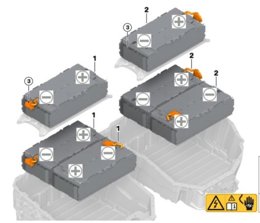

QUESTION: Why must we, or why do 100% electric cars run 360 volt battery packs and not 240 for example and just boost the voltage to a higher number?

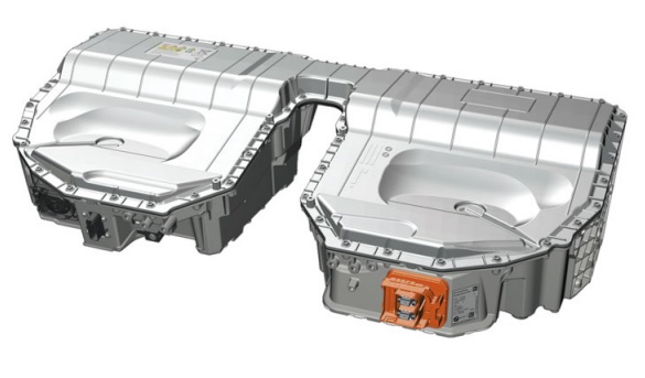

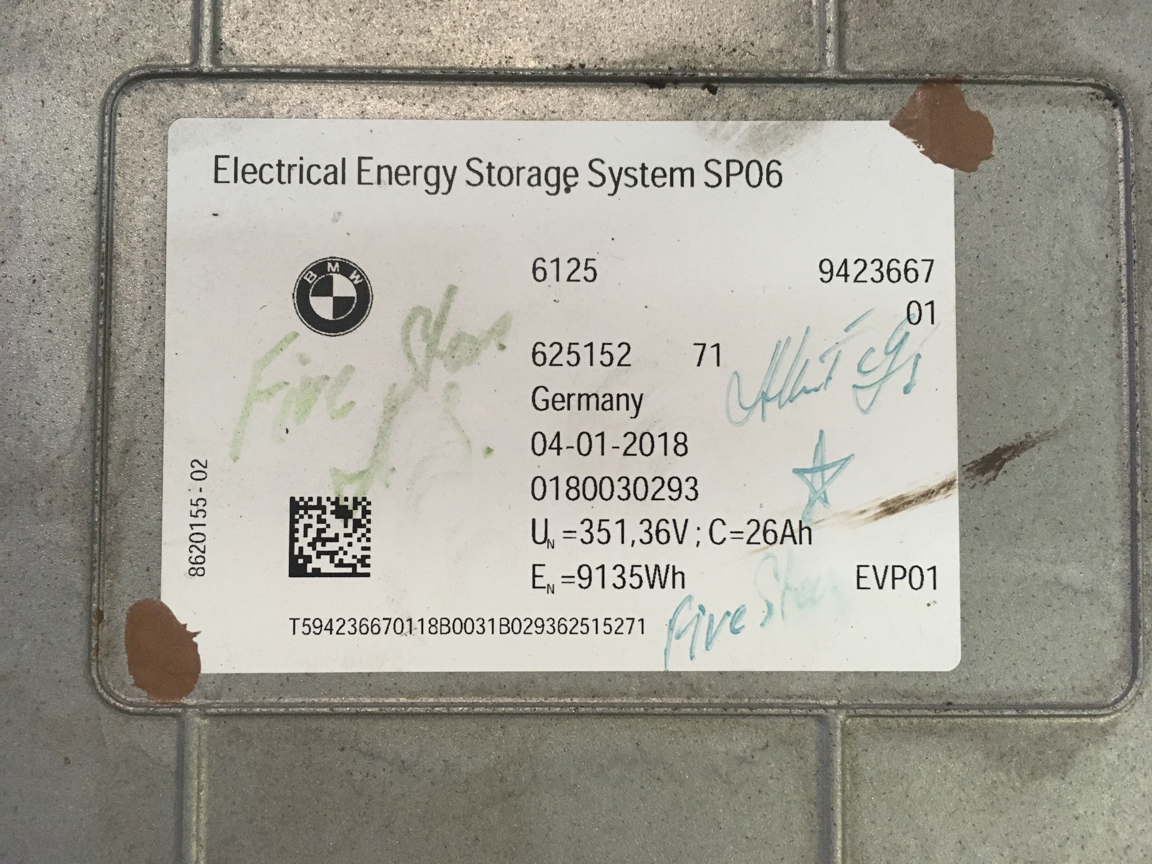

I have two battery packs from BMW 530e plug in hybrids, (each pack consists of six 60 volt cell modules) they are approximately 360 volts nominal and 9 Kwh each in parallel that would be 18 Kwh however if I was to reconfigure them into three packs of 240 volts that would yield more range wouldn't it, or would it? I recon none boosted 240 volts at what ever amps would not give me the speed and power equivalent of 360 volts at same amps, but that's where the booster converter comes in, no?

No. Range is governed (amongst other things, such as weight of driver's right foot) by energy stored. Whether the battery contains (say) 30Ah (amp hours) at 360V or 360Ah at 30V, the energy stored is the same (30Ah x 360V = 10.8kWh kilowatt hours).
