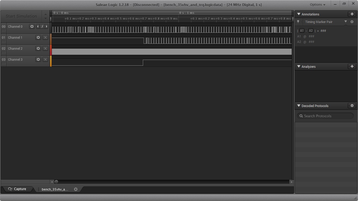

The data exchange is indeed a 2 direction array, 80 bytes to the inverter and 100 bytes from the inverter.
The data is in the array is modified to request torque, -3500 to 3500, see DRIVE and REVERSE below.
The data needs to be exchanged at 10mS to keep the Inverter happy
Now I have to link it to a Prius inverter and see what happens then, or doesn't...
Anyone done this yet?
I might need Damien's help there, how do I contact him?
BTW >>> the gs450h_vcu can be reprogrammed to be a SPI sync serial bus sniffer, so there is no need to design your own, or you can borrow Damien's design.

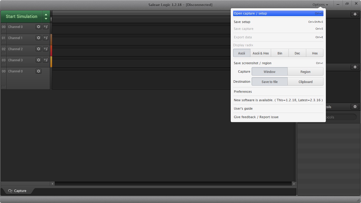

evbuilder wrote: ↑Wed Mar 09, 2022 9:40 am If you could get the logic analyser viewer loaded, tell me what SPI mode to expect, clock rate etc that would be awesome!
Download from here. logic 1.2.18 (not logic 2)
https://support.saleae.com/logic-softwa ... load-links
Then you can open Damien's logfiles
It looks like this
