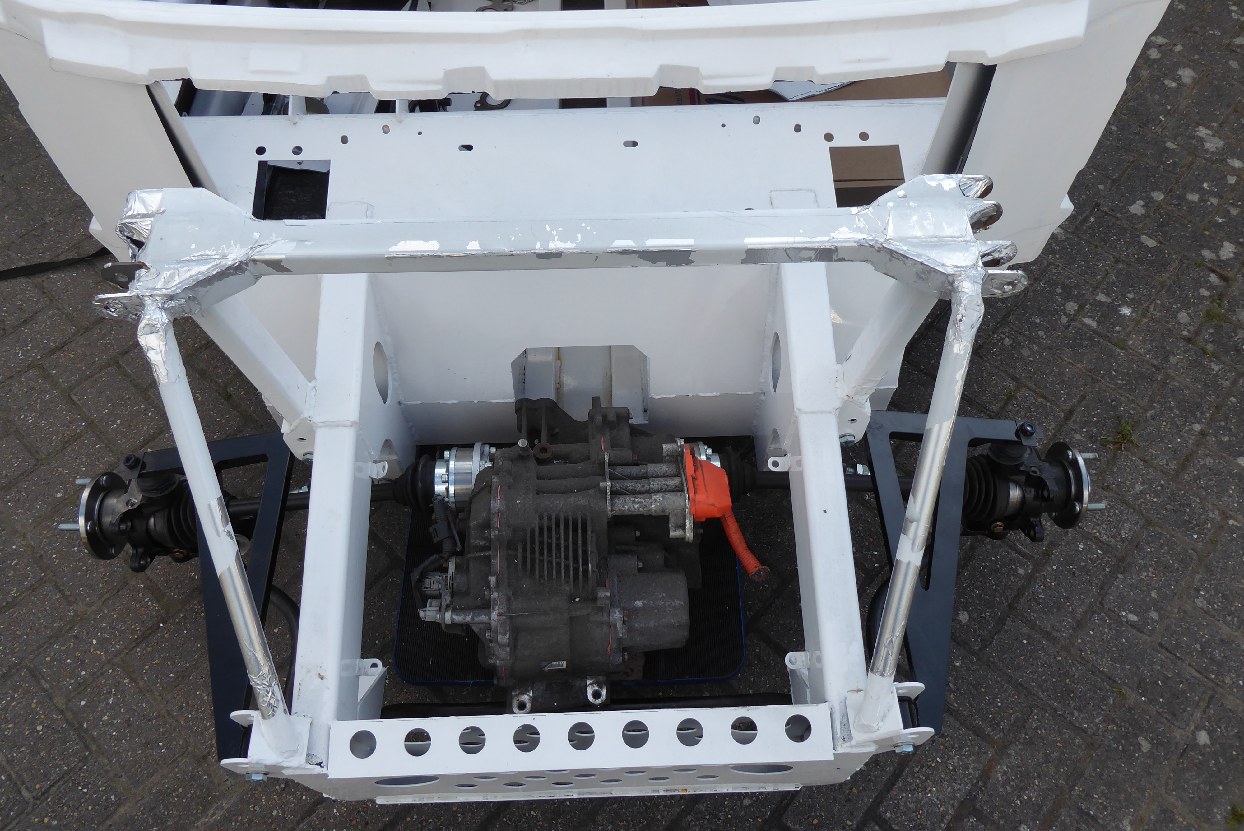

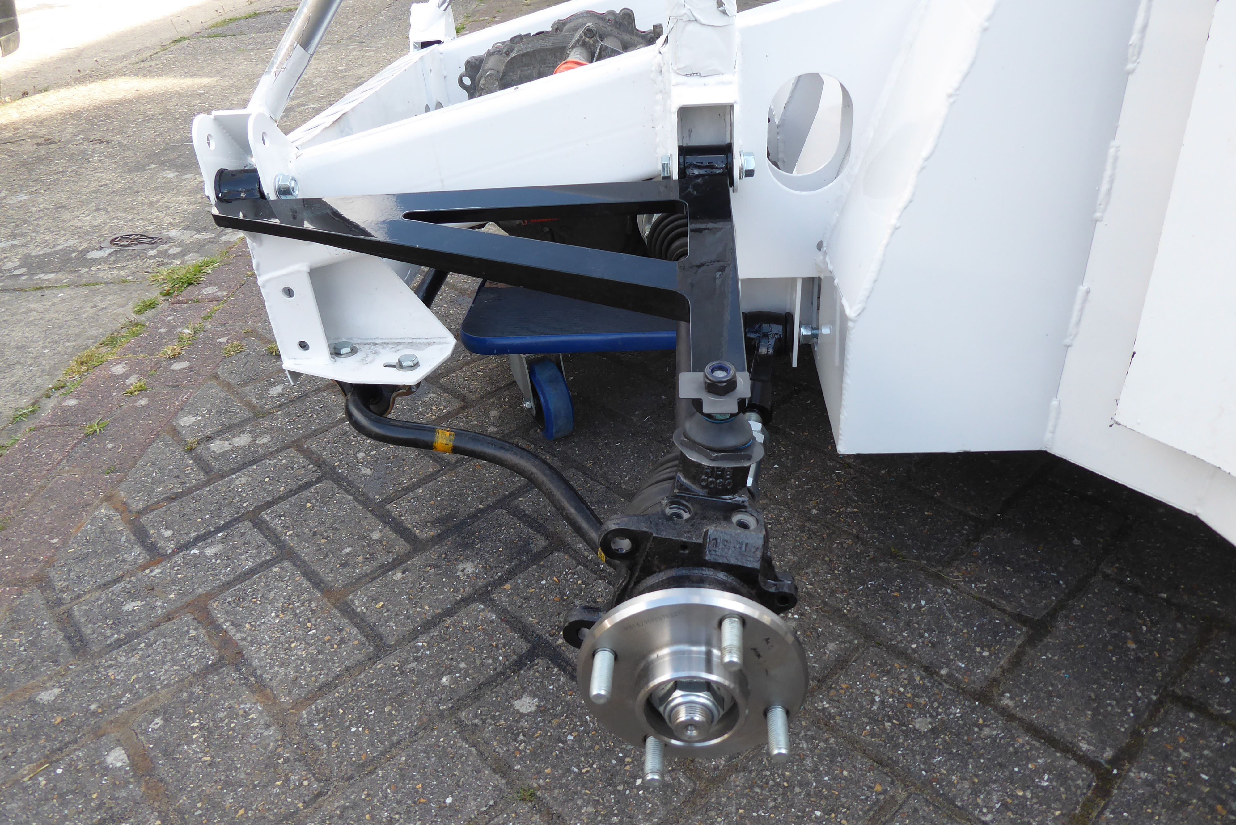

I am building a Ford RS200 with 650bhp V8 engine in the back (wheels) and MGR Q211 for the front wheels to give on demand extra power and 4WD.
I am using a Pruis GEN-3 Inverter, Zombie VCU, Toyota Q211 MGR and a Prius battery (not chosen yet)
I want to use the Sync Serial communications from the Zombie VCU to control the Prius inverter which is connected to the MGR Q211 resolvers.
I need the regen from the inverter to charge the onboard batteries (only a Prius Pack) and then tell the inverter to use the battery under demand from the engine ECU (Can Bus or Analog).
Had this been done before? I have seen Damien's video running the Prius inverter from the Sync Serial (SPI) comms.
I am an embedded C code software programmer for Texas, Atmel, and Microchip.
I have bought the Inverter, MGR, and the Zombie VCU and a Variac.
Can I have some help please to get this project rolling.
The cars are here
https://rsretro.smugmug.com/Design/RS200-2/

Hi Isaac,
thank you for the info. This is my first EV build so I want to start with low power to learn the systems and progress up the ladder to bigger power and higher voltages. The first car will have a 200bhp petrol engine in the back and the EV in the front that will assist the 4wd aspect. Like a GX450h but the other way around. The advantage of EV is torque rather than power which is what I am looking for. My logic for the MGR + Prius inverter; the resolvers are the 'same' and the 3 phase is the 'same' and both made by Toyota so why not. My logic for using Sync Serial and Zombie VCU is simplicity (maybe). Using the new control board option the FOC looks unstable. I have both boards ready to try.
My biggest ask is "how do I get the regen to charge the batteries" how is this done?"
Where do I need to look to find previous working examples.
I Have more streamlined body options.

The primary use for the MGR is to add occasional front wheel assistance to the cars handling and some performance.
Its primary job is to provide 4wd front grip as in the original RS200. The front split varies from 0% to 50% of the total power (the other proportion from the engine), but in reality it is probably around 10% as mechanical 4x4 road car systems that this was based on have an open front differential so the power would be wasted by the spinning wheel. The 4wd on the front adds grip in cornering on the road when it is needed. This can be from 75% throttle or a pre-settable value, or the difference between steering angle and the cars yaw angle (Misti EVO).
The biggest difference with an electric motor is instant torque at any speed? and an electric motor has more torque, x3? because of the gearing from a 18,000 rpm electric motor down to a 3,000 rpm wheel drive speed, which multiplies up the torque above what a petrol engine would give.
At launch the electric motor is only used from 0-60, then the petrol motor (turbo charged) provides all of the power at high speed.
I want to start with a small MGR to prove functionality, then move onto larger MGR (Outlander?) and higher battery voltages.

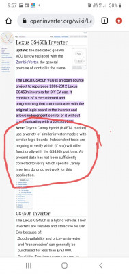

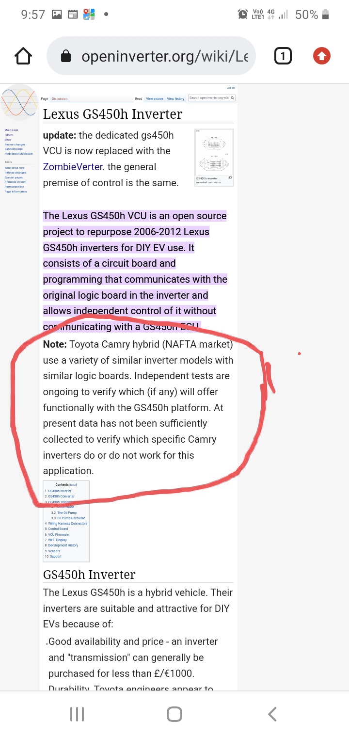

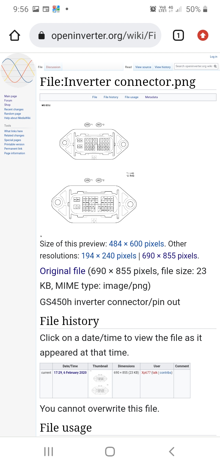

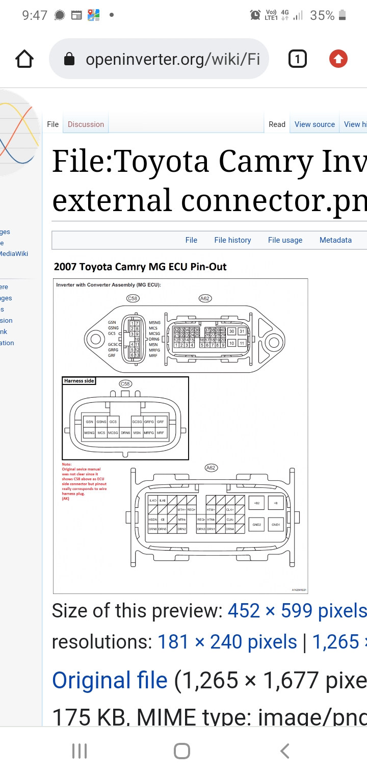

I've found a ToyotaInverters page on the wiki which looks to be intended for this info. So far I added it to Toyota and OEM categories so it is more easily found. I should probably add the above to it to help the next guy! I've only been looking at this for a week or two.

evbuilder wrote: โ†‘Sun Mar 06, 2022 9:36 pm I've found a ToyotaInverters page on the wiki which looks to be intended for this info. So far I added it to Toyota and OEM categories so it is more easily found. I should probably add the above to it to help the next guy! I've only been looking at this for a week or two.
Thanks for the guidance, now have a gs450h_vcu up and running with source code that I can modify.
It took me a few hours to find all of the pieces and get working.
Here is a link to the whole set for a working example, and a small write up How To for getting it started.
https://www.dropbox.com/sh/1ulm2gir3jfy ... SQgBa?dl=0

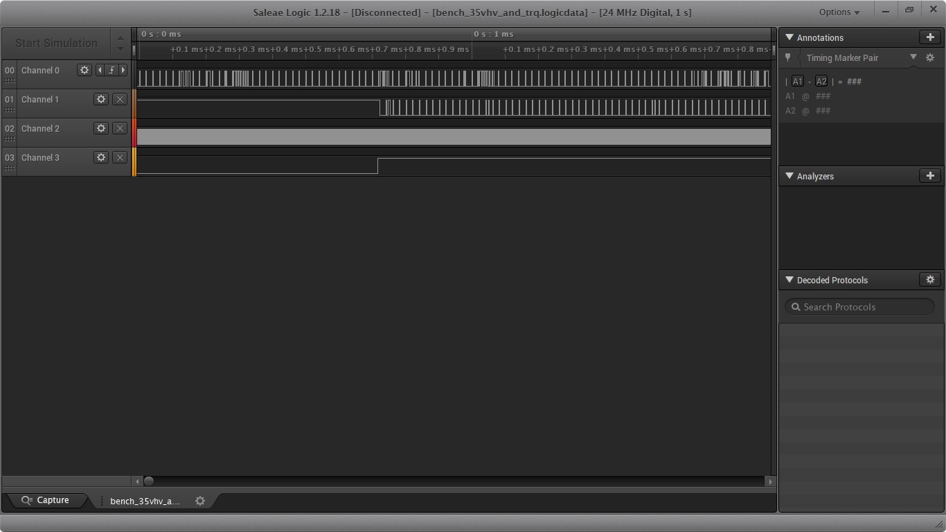

The data exchange is indeed a 2 direction array, 80 bytes to the inverter and 100 bytes from the inverter.
The data is in the array is modified to request torque, -3500 to 3500, see DRIVE and REVERSE below.
The data needs to be exchanged at 10mS to keep the Inverter happy
Now I have to link it to a Prius inverter and see what happens then, or doesn't...
Anyone done this yet?
I might need Damien's help there, how do I contact him?
BTW >>> the gs450h_vcu can be reprogrammed to be a SPI sync serial bus sniffer, so there is no need to design your own, or you can borrow Damien's design.

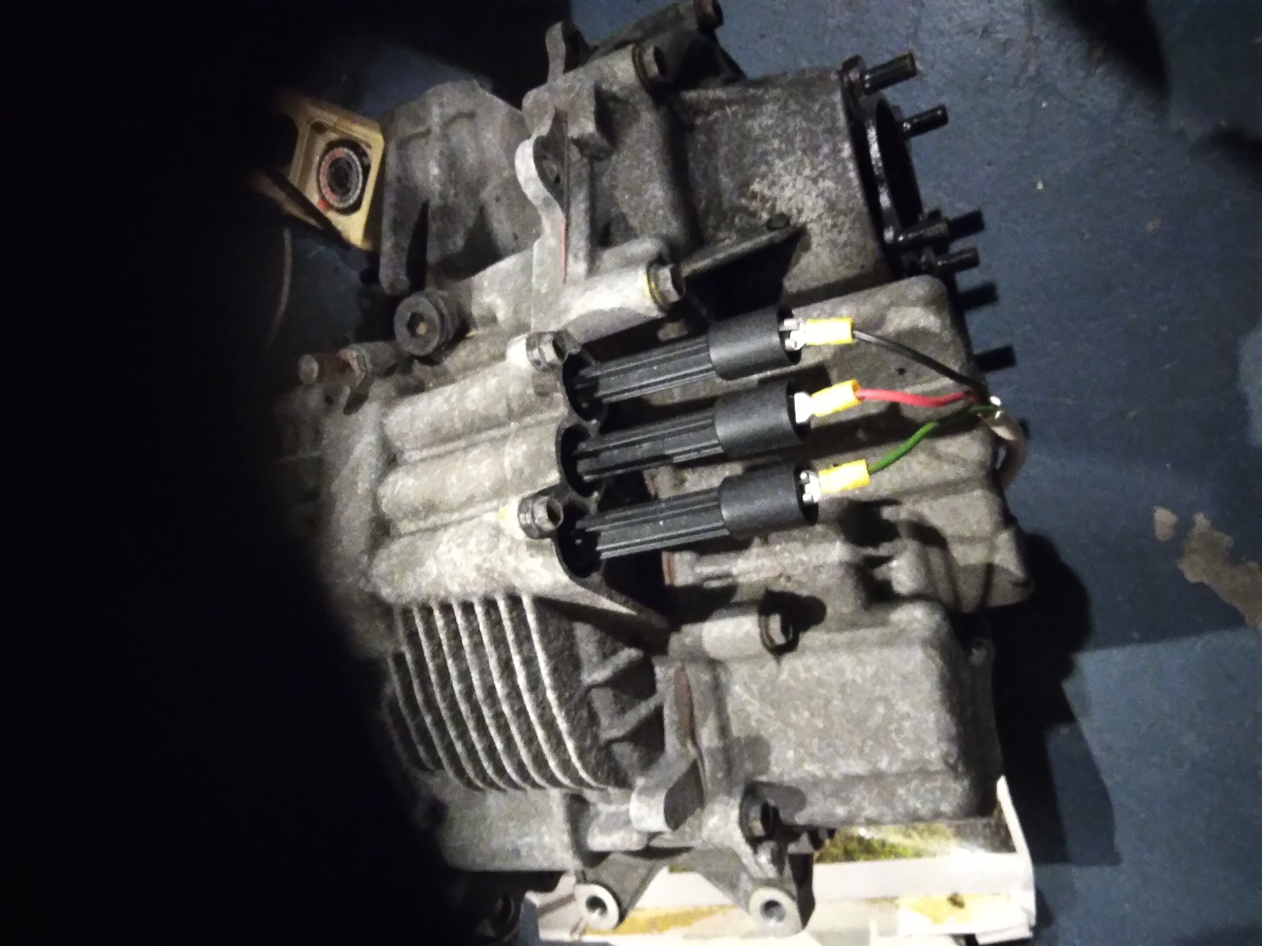

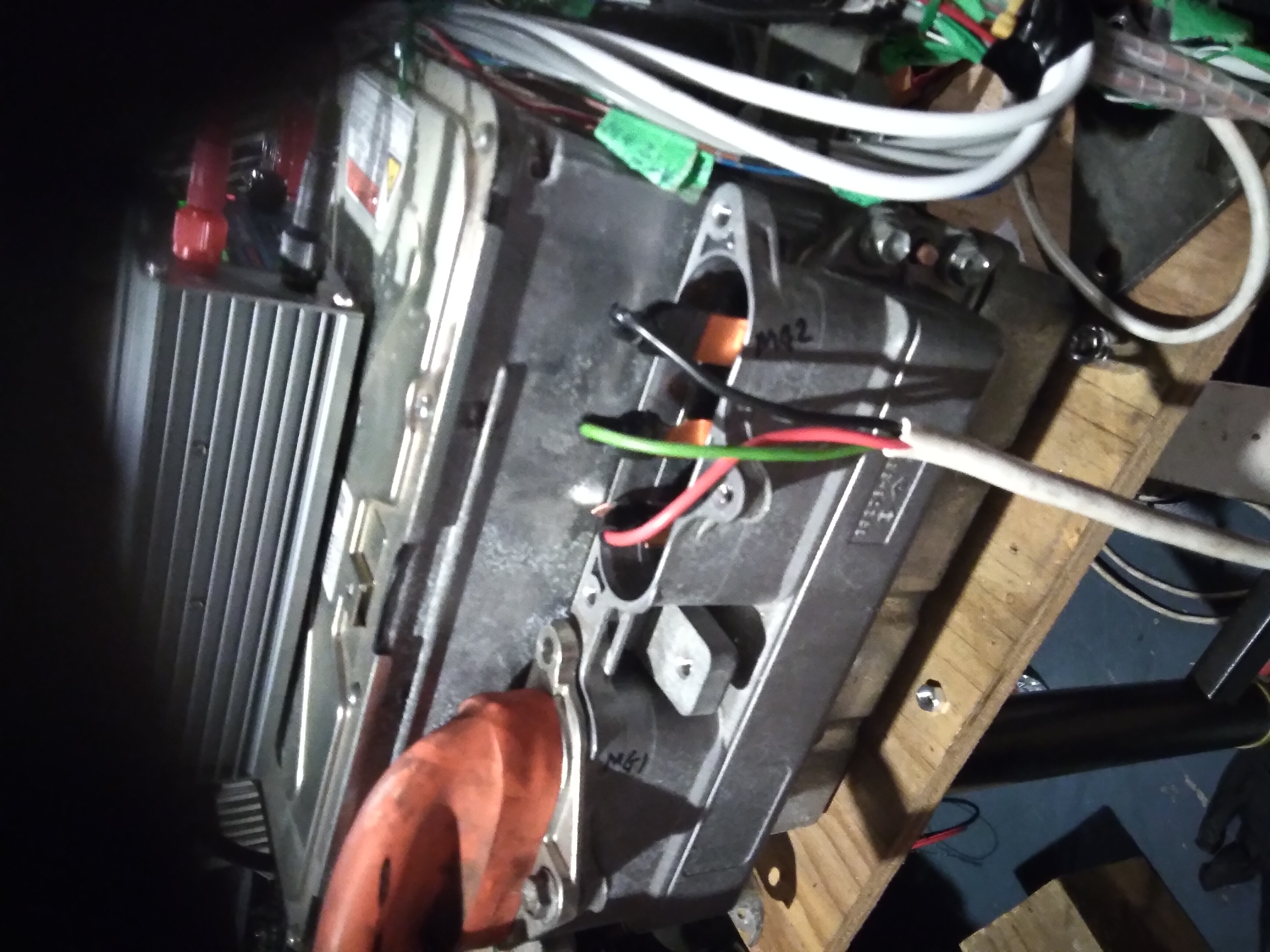

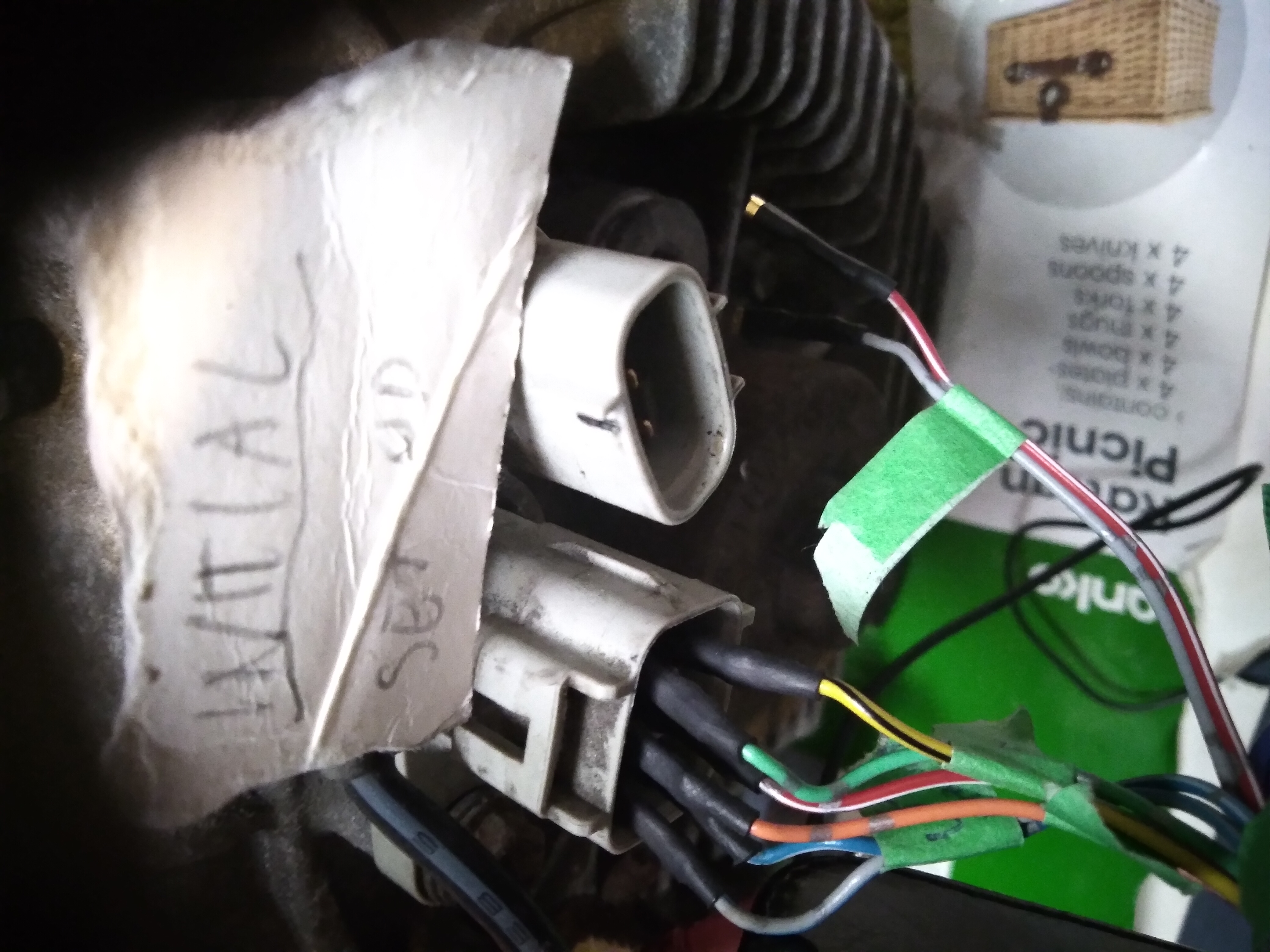

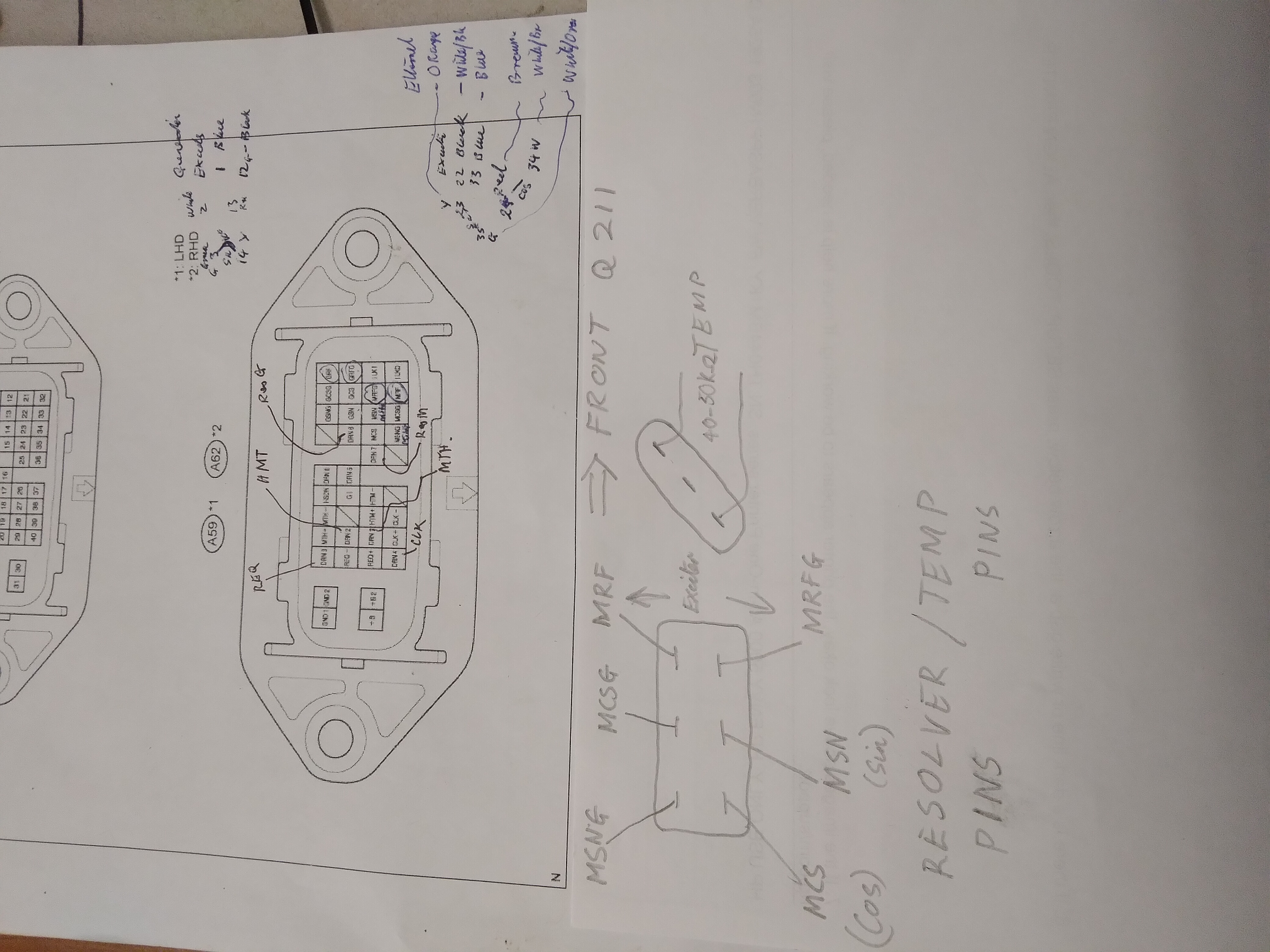

Re Q211 ...Wiring of inverter and resolver.
Had established Damien's gs450h vcu, Lexus inverter and transmission running on bench. I have a 2006 Lexus, which have made into a Phev, and ordered a transmission and inverter of the same model. the numbers off inverter is G9200-30030. This is presently being installed in a well aged Bedford campervan, to operate as a Phev.
The set up now has two separate "throttles" for want of a better word, ( I would normally think of a throttle as a butterfly valve for throttling, an air or gaseous mixture)
MG1 has one throttle input set up to give fwd and rev from a linear potentiometer, with 50% being the null position, and clockwise IC input shaft rotation , when potentiometer is turned up, say above 60% and anti clockwise rotation when turned down below 40%.
MG 2 is operated with Toyota pedal unit .
The Q211 test set up, takes the place of Lexus MG2,
The exciter MRF, and MRFG connected to the forward end of the six pin plug .. the combinations of sin and cos tried, then moved UVW inverter to VWU from Q211, another combination of sin and cos, and rotation was achieved, and fwd , rev when fwd, rev input to the vcu was selected. If a diagram or picture of the Q211 socket pins helps let me know.

evbuilder wrote: โ†‘Wed Mar 09, 2022 9:40 am If you could get the logic analyser viewer loaded, tell me what SPI mode to expect, clock rate etc that would be awesome!
The code in the gs450h_vcu shows a SPI rate of 250000
The Spi in normal 8 bit, nothing special, from what I can see.
The one difference is the additional sync pulse at the start of the SPI transfer, after that its MISO, MOSI and CLK. No /CS.
Why not use Damien's code from the gs450h_vcu and use it to listen to the bi directional data?

Woodfie wrote: โ†‘Wed Mar 09, 2022 3:32 pm The Q211 test set up, takes the place of Lexus MG2,
That's very clever, a wiring diagram always helps so yes please.
How do you tell each motor separately what throttle (torque) you require?
Did you hack Damien's gs450h_vcu code to do this?
What happens if the inverter cannot see one of the motors, i.e. by unplugging the resolver?
Does the other motor still run, or does the system stop?
What model Lexus inverter did you use, so I can buy the same and create the same setup but with 2 Q211 motors.
Then I can do some serious hacking and sniffing to share.
I like it, a lot. Well done. ๐Ÿ‘๐Ÿ‘

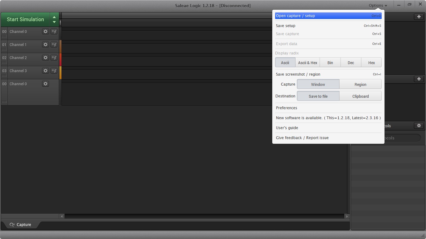

Download from here. logic 1.2.18 (not logic 2)
https://support.saleae.com/logic-softwa ... load-links
Then you can open Damien's logfiles
It looks like this
