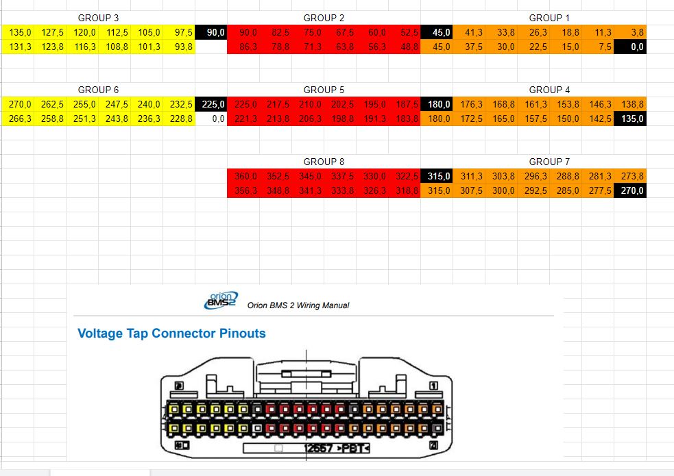

Hi does anyone have a orion bms 2 cell tap validation tool I can rent or buy?
Zero are out of stock and could do with one asap...
Thanks...

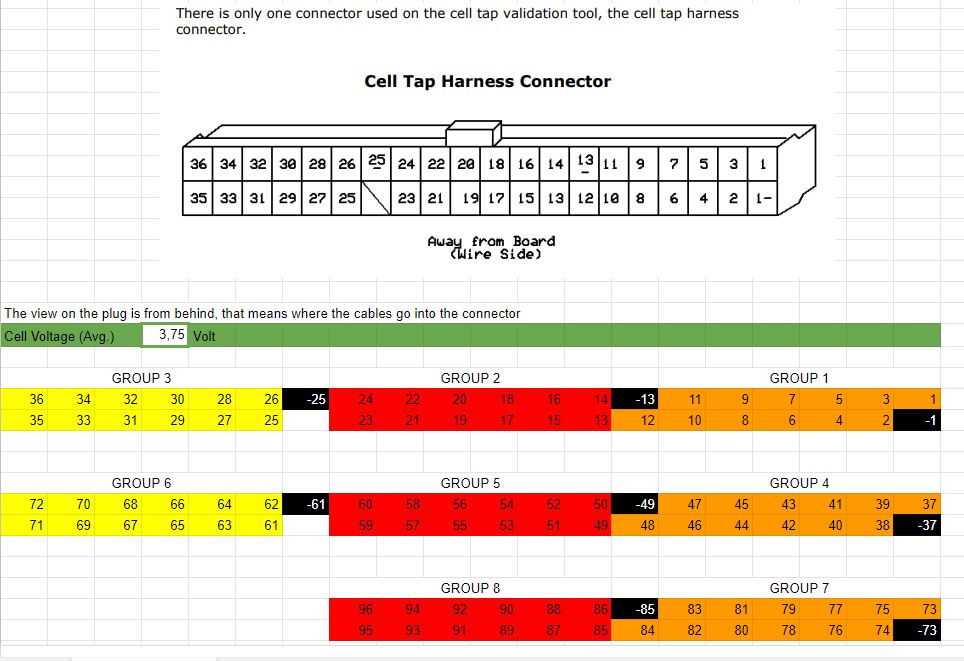

I did the wiring without it, it is actually fairly easy with a multileter if you follow the excel-instructions that i've made for myself:
