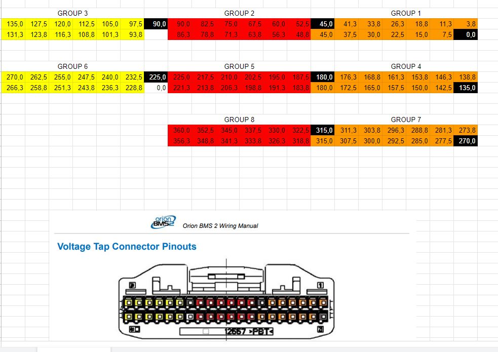

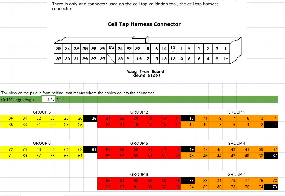

Re: Orion cell tap validation tool
I did the wiring without it, it is actually fairly easy with a multileter if you follow the excel-instructions that i've made for myself:
