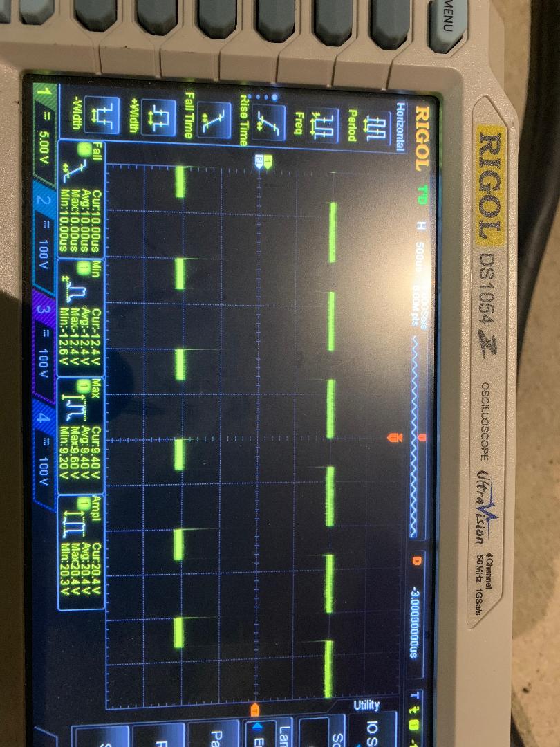

Chasing down the "Gen2 US EVSE SinglePhase 16Amp limited - Only one module will activate" problem.
Data Points for my setup
1) Modules are measuring only 16Amp available from the EVSE
2) EVSE duty cycle is 67% or 40Amps
3) Only 1 module will run, any of the three modules, but only 1 at a time, otherwise resets on Activate (state = 1 in Code)
Further up the thread it was reported that "US SinglePhase in EVSE mode always gets 16amps" which got me thinking. So I started investigating the Control Pilot signal. Per the J1772 details on Wikipedia ( https://en.wikipedia.org/wiki/SAE_J1772 ) "Control Pilot (Mode): The charging station sends a 1 kHz square wave on the control pilot that is connected back to the protected earth on the vehicle side by means of a resistor and a diode (voltage range ±12.0±0.4 V). The live wires of public charging stations are always dead if the CP-PE (Protective Earth) circuit is open, although the standard allows a charging current as in Mode 1 (maximum 16 A).". I know the software is reading the duty cycle correctly, but the 16A reference was intriguing.
So I stuck an oscilloscope on the control pilot line from the EVSE (with a reference ground back to the GND on the charger). When the EVSE was not activated the amplitude of the square wave was 20V (??? expected 12V). When the EVSE was activated the square wave amplitude fell to 17V. I only use the oscilloscope once in a blue moon so please correct me if I'm reading this wrong.
Per J1772 the EV signals to the EVSE that it is ready for charging by dropping the voltage on the control pilot line to 6V. I'm assuming that if it doesn't drop into the 6V range then the EVSE does whatever it's default is - which for my EVSE is 16Amps.
Could this be the source of the 16Amp limit / only 1 module problem?
Jeff

Posts: 2962
Has thanked: 328 times
Been thanked: 847 times
The full swing is -12 to +12V. So you need the centre to V positive measurement.
The EVSE signal interpretation is not the issue, if the logic board says it is sending a 16A per module command the modules only see canbus commands that says 16A.
No the EVSE does not change anything, it is dumb and just tells you the limit. As soon as it sees the pull down by the charger it just closes an AC relay/contactor.

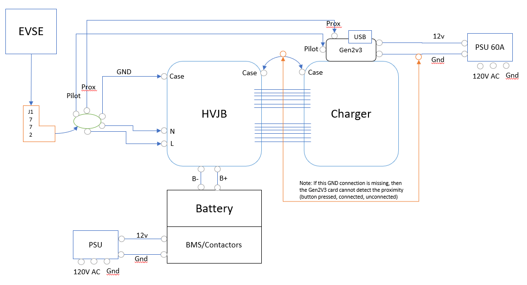

DrJeff wrote: Mon Oct 28, 2019 1:55 pm Help needed - I'm open to any ideas no matter how wild
Some random ideas speculating that something is different about your location in the US and ours in Europe;
What have you done with the charger case earth? How is that earth connected in the building?
Try using an isolation transformer and testing at 110V and 220V.
Try modifying the controller code to bypass EVSE functionality and use a regular mains socket connection.
Try a different EVSE at your location.
Take the charger/battery to another location and test there with multiple EVSE.

Thanks for the ideas... To get started on chasing things down, I drew up a diagram of my HV and power connections for the desktop charger testing.
1. Charger Case Earth
- The 'primary' earth for the charger case would be via the case on the HVJB, which gets earth from the J1772. The orange ground line in the diagram connects the cases to the GND (companion to the 12v) supply to the Gen2V3 charger controller card. If I don't include this ground connection then the Gen2V3 card cannot accurately detect the PROX status (if oscillates between connected and button pressed - which I guess is floating).
- Ground for the building (my house) runs back to the main panel and to a copper earth rod (nothing unusual).
- I ran the 12v to the Charger Gen2V3 card off a PSU that runs from 120v house power, generating 12v up to 60A.
2. Alternative EVSE
- I only have one EVSE installed at the house. I use it daily to charge my Fiat 500e.
Thanks for the help
Jeff

DrJeff wrote: Tue Oct 29, 2019 2:55 amIf I don't include this ground connection then the Gen2V3 card cannot accurately detect the PROX status (if oscillates between connected and button pressed - which I guess is floating).
That's interesting... can you try replacing the 12V power supply for the controller card with a car battery? Maybe the power supply you're using has a leak to ground.
Any possibility your BMS is providing a leakage path to mains earth? Does anything change if you use the same power supply for the controller card and the BMS? What happens if you use a car battery to power both systems?
How thick is the ground wire from the J1772 socket to the Junction Box case? Can you verify the connection from the J1772 socket to the Junction Box case has a low resistance? Same with the ground connection from the Junction Box to the Charger.
Do you have a computer plugged into the USB port? If you do how is that grounded?

DrJeff wrote: Fri Oct 25, 2019 4:13 amSo I stuck an oscilloscope on the control pilot line from the EVSE (with a reference ground back to the GND on the charger). When the EVSE was not activated the amplitude of the square wave was 20V (??? expected 12V). When the EVSE was activated the square wave amplitude fell to 17V. I only use the oscilloscope once in a blue moon so please correct me if I'm reading this wrong.
Something wrong here. Can you measure the pilot signal and ground at the J1772 connector without any connection to the charger? You're looking for a solid +/- 12V signal.
See Basics of SAE J1772 (here)

Kevin Sharpe wrote: Tue Oct 29, 2019 9:24 am
When connected to the Proximity line on the controller card, I'm getting +9-12V which is consistent with the EV Connected Ready signal. When I disconnect from the Gen2V3 card (so EVSE connected to nothing I get +12V - no square wave. I used the GND connection from the EVSE to baseline these measurements. Tomorrow I'm going to check the consistency between the GND connections in the garage (I saw a slight difference when measuring yesterday which used a GND from a separate line. All the lines are all feed from the same sub-panel.
Jeff
