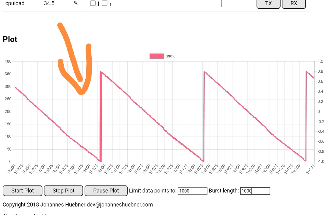

during the manual wheel turn by hand there is very short moment when angle starts jumping from 0 to 360 and back to 0. maybe it is a resolver fault?
In picture it is thick line. If i stop motor there the angle is changing 0-360-0 indefinitaly.
Also... Shouldnt the angle be rising not falling when wheels are spinning in forward direction?

- Been thanked: 1913 times
Re: Need help with FOC tuning (prius gen2 inv+ gen2 MG2)
That explains why it wants to go backwards. You can now indeed try setting pinswap to 7 (this time I mean it). It swaps resolver sin/cos. See if that makes it go 0-360 instead. But then it might not move at all. Maybe just accept that you need to select reverse to go forward. Will check this once I get this far.geduxaz wrote: ↑Fri Feb 04, 2022 10:48 am during the manual wheel turn by hand there is very short moment when angle starts jumping from 0 to 360 and back to 0. maybe it is a resolver fault?
I am going to the car (100km) this evening and will have there 1 day. It is still too cold to work long with it. Need to do as many test as possivble to get it working or else it is gonna burn!
hovering 0-360-0 is normal. There is like 0.5-1° jitter typically and if that happens to be at the turnaround point, that's what happens
