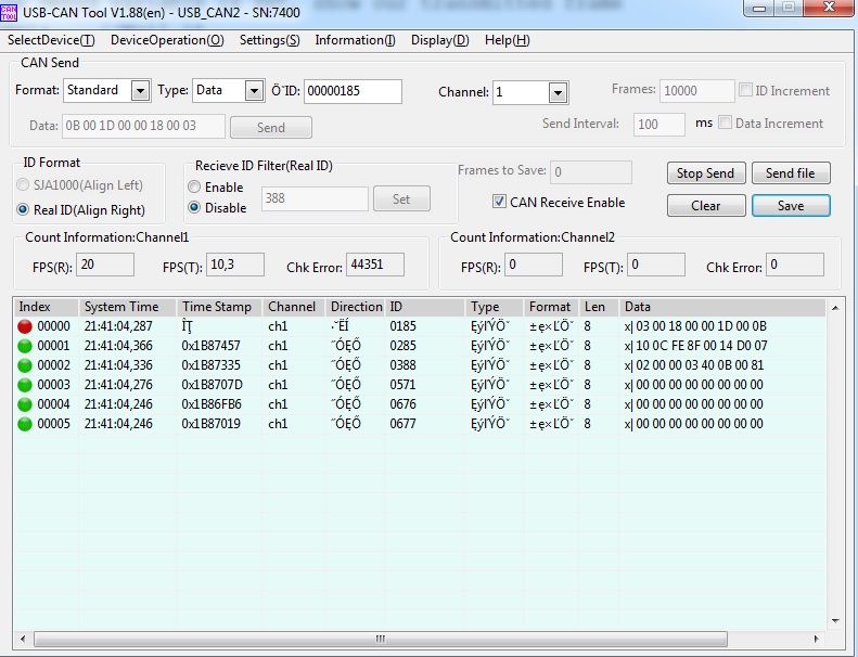

Well after having an ac pump sitting around for ages meaning to log an outlander but never getting round to it some data in the outlander heater thread cracked it! most can logs i have found round the web have been missing many messages so thanks to the people in that thread. it appears to run quite easily requiring only 2 messages to get it going.
message 0x285 appears to enable it i believe this message says that the contactors are closed possibly.
Message 0x185 this one enables the pump and controls the speed/power.
message 0x185 byte 0 appears to be an enable byte 0x08 disables and 0x0B enables the operation. Byte 5 appears to be some sort of speed control. value 0x07 is off, 0x08 appears to run at the lowest speed and values up to 0x54 over that it will continue running if it was already running but will not start up. messages returned from the pump:

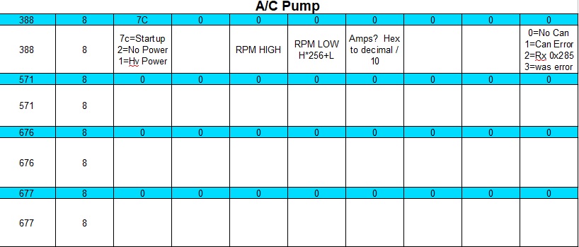

0x388 is the only message i can see anything useful coming out of it it contains what i believe to be some basic faults and diagnostics, a rpm value and possibly a current value. The connector contains a 12v supply from IGCT (1), ground (2) and CANH (3) + CANL (4) I believe the corresponding connector for it to be 90980-10942 im sure thats what i got anyway they're pretty cheap on aliexpress!

Yeah... its seems like torque control. but it is really expotential.
When i tried to command b5=50 compressor quickly stalled and reset.
I changed to b5=35 and this lasted a bit longer.
Finally i set b5=25 and control was much more stable. it ran almost with the AC clutch signal. But when i observed the 0x388 values i noticed RPM was over 6000RPM! No wonder compressor was reducing power.
My closed loop doesnt work yet. I have to adjust my variables, but i will keep experimenting with b5 values.
Here is my recording of CAN traffic for b5=25.
