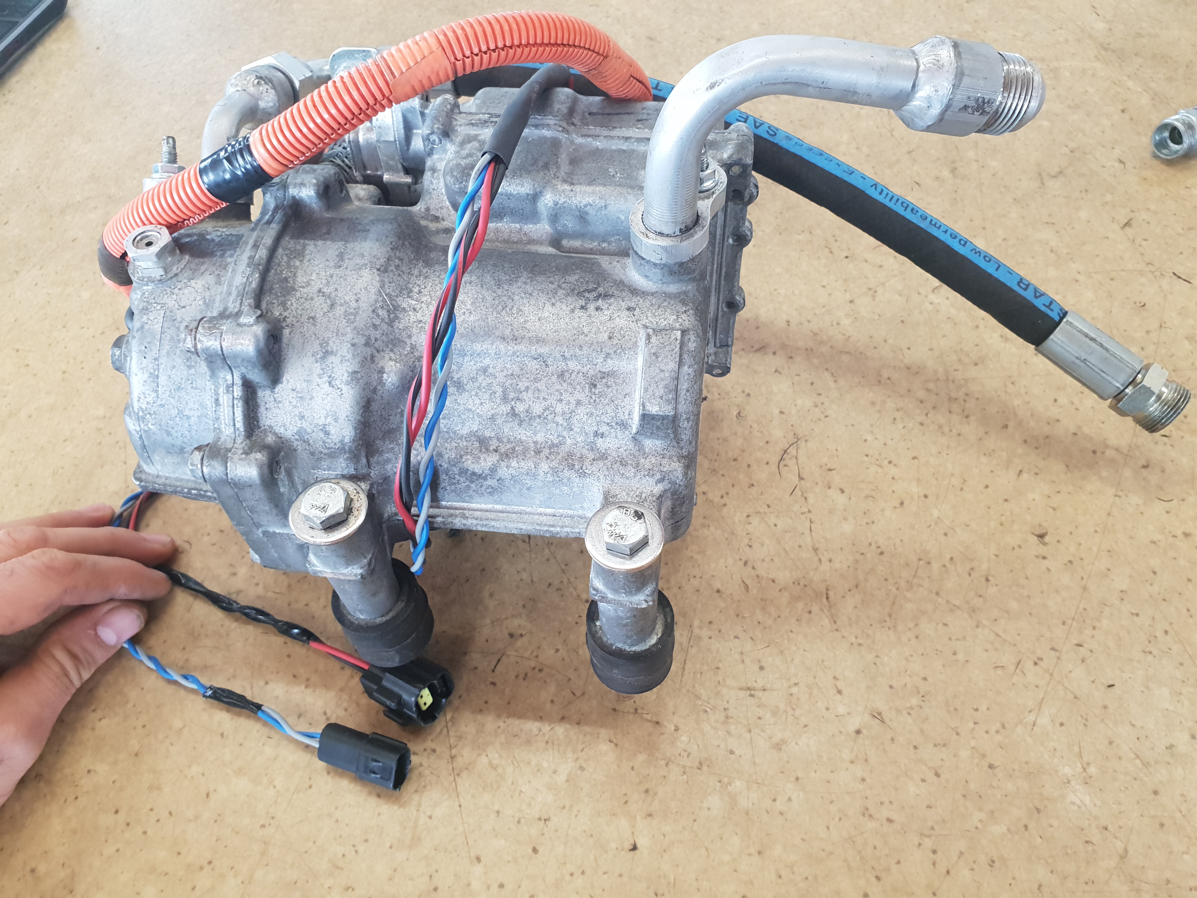

After a lot of time probing the Outlander PHEV AC compressor it finally came to installation. I got compressor off some car dissasembly company and i took it because it also had AC pipes on. This way i will be absolutely certain everything will fit.
I wrote about it in detail here: https://leafdriveblog.wordpress.com/202 ... installed/
This compressor is a little higher than Prius compressor on account of its inverter. This interfered with previous spot on the side of front motor mount.
I installed compressor on some sealant blocks with M8 threaded inserts. I also made new flexible hose connections that will allow me to rout new hoses in the engine bay.
When i had everything prepared i put some Denso ND11 hybrid oil into it. This is neccessary because compressor oil is used to cool its motor. Any other oil may cause wire laquer damage and eventual short in the motor. So no other oil is allowed. I filled 130ml of oil using a syringe. Most of it i pushed in the motor side and at least 30ml i also sent to the compressor side. Compressor will eventually spatter the oil through the hoses also.
I tightened the hoses and connected everything electrical under the car. I am using old AC compressor clutch signal to turn on a relay. This relay i will use to pull DUE signal to GND and this will signal for it to start transmitting correct CAN telegram.
Works like magic. Compressor spools up and runs and when it is not needed anymore is slowly spools down. This is way smoother than before with Prius compressor.

Anyone has any experience with AC compressor mounting. I need an opinion.
I have made my mount from inox steel and welded a brace down the middle to stop it wobbling under compressor weight. This made the mount much sturdier and unmovable. As shock absorbing mounts i used 3 M8 rubber blocks. Compressor mounts on them which in turn makes it quieter.
https://leafdriveblog.wordpress.com/#jp-carousel-2191
Now it still seems compressor is shaking under the car when it starts acceleration. Is that ok or are that kind of vibrations undesirable?
Should i use solid blocks to mount compressor?

I would add some 45/90/45 degrees small sheet to your bended angles. That will stiffen the mount allot and prevent it becoming a spring. Just for that, stiffness don't think it will break but that way the mounting gets solid and I suspect your M8 silent blocks start to work.

Yes i made it just so, but later on off camera :). I added 2 simple straight 2mm inox sections 10cm x 2cm and welded in in the middle from behind and front of the mount. It did stiffen the upper mount section quite a lot. I was concerned that vibration could damage AC compressor internals. For now it just works... Hm... there is still some flex from the rubbber blocks. I hope compressor will be ok. With OEM car mounts i see compressors are bolted to the engine block directly!!??
I will take a photo when i need to go under the car. Its not easy because i added 1.5mm alu panel on the underside to protect compressor and steering pump from debris and maybe get some drag reduction.
