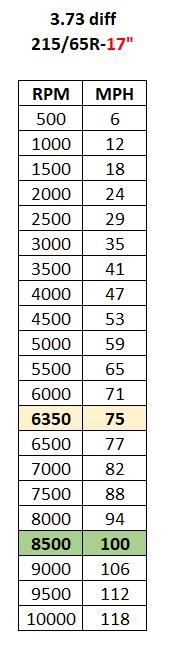

Since my 1971 Chevy truck aka GMC used a mechanical speedometer which I am ditching I plan on using MG2_Speed to calculate my miles per hour MPH
so I punched some numbers into the good ol' Lotus 1-2-3 (pronounced: Excel) ha ha to correlate RPMs to Miles Per Hour based on my 3.73 rear end and 215/65R-17 wheels
I relied on the good ol' folks at x-engineer.org to provide the complicated formulas, (and our daughter to recite pi to the 57th digit):
How to calculate wheel and vehicle speed from engine speed
How to calculate wheel radius

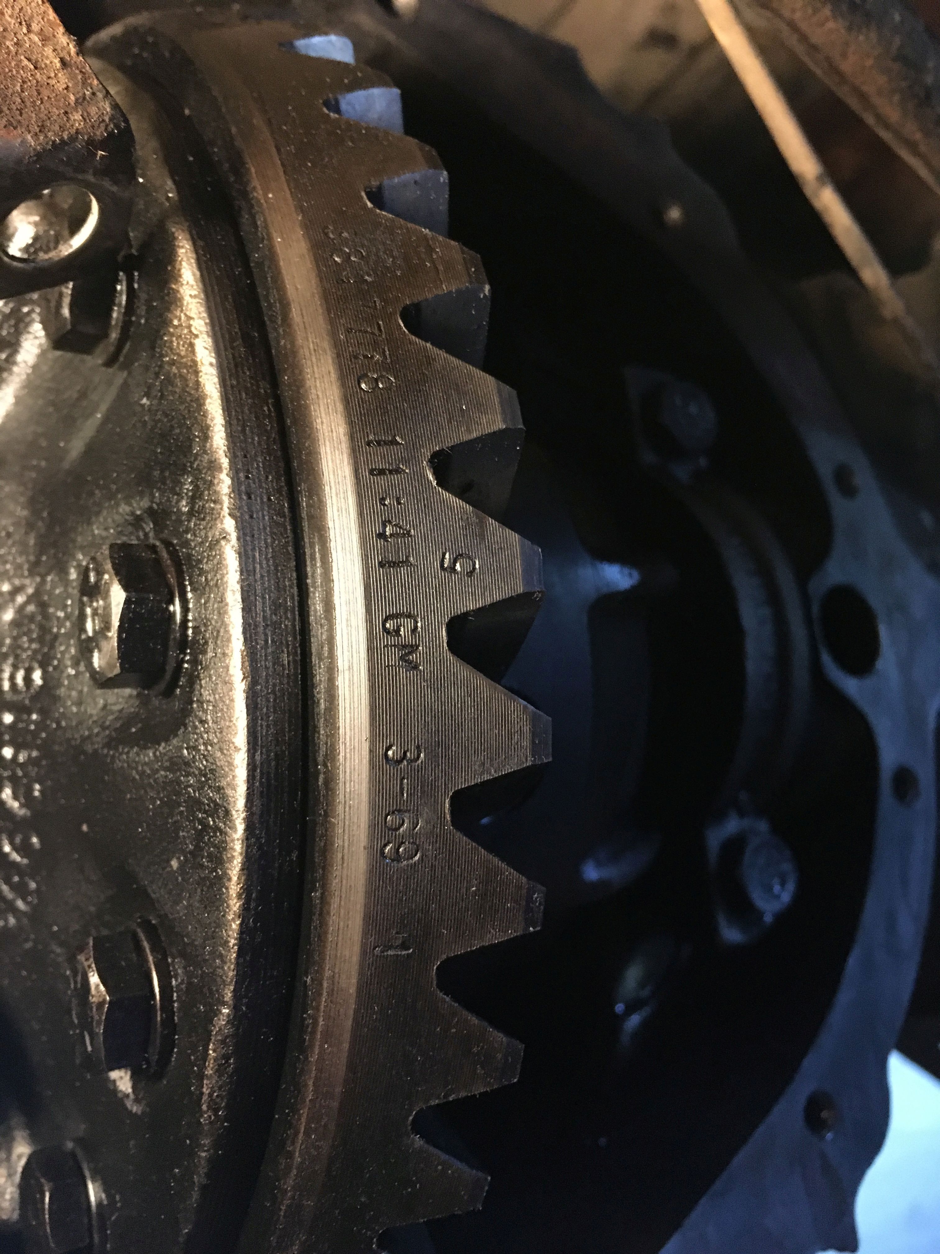

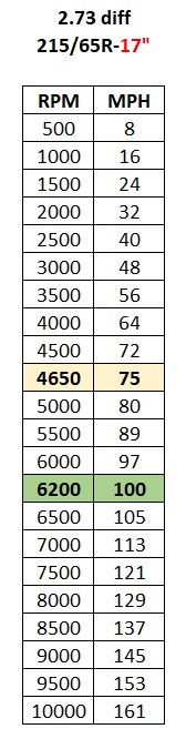

this made me consider Taller / higher differential gears like the 2.73 for my GM 12 bolt to drop the RPMs by approximately 2 grand, I'm pretty sure (97.1%) that electric motors don't have a traditional Power Band, so did the "Royal We" determine at what RPMs this Unicorn is most happy happy?

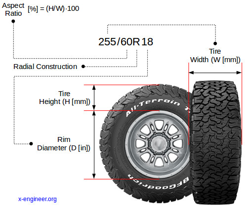

and let's not forget how simply changing our tire aka wheel size can impact RPMing and MPHing
below I use the exact same tire profile on three different size rims 16", 17", and 18"

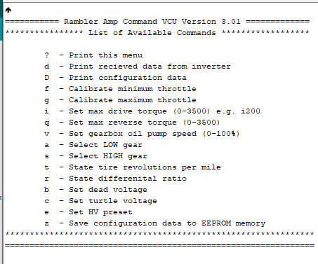

I even added tire RPM and rear diff (since I’m not entirely sure what mine is) to the serial menu for easy updating.xp677 wrote: ↑Sat Dec 11, 2021 12:49 pm I covered this a while back in another thread: viewtopic.php?f=14&t=396&p=32431#p32431
