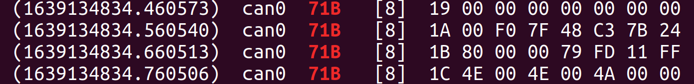

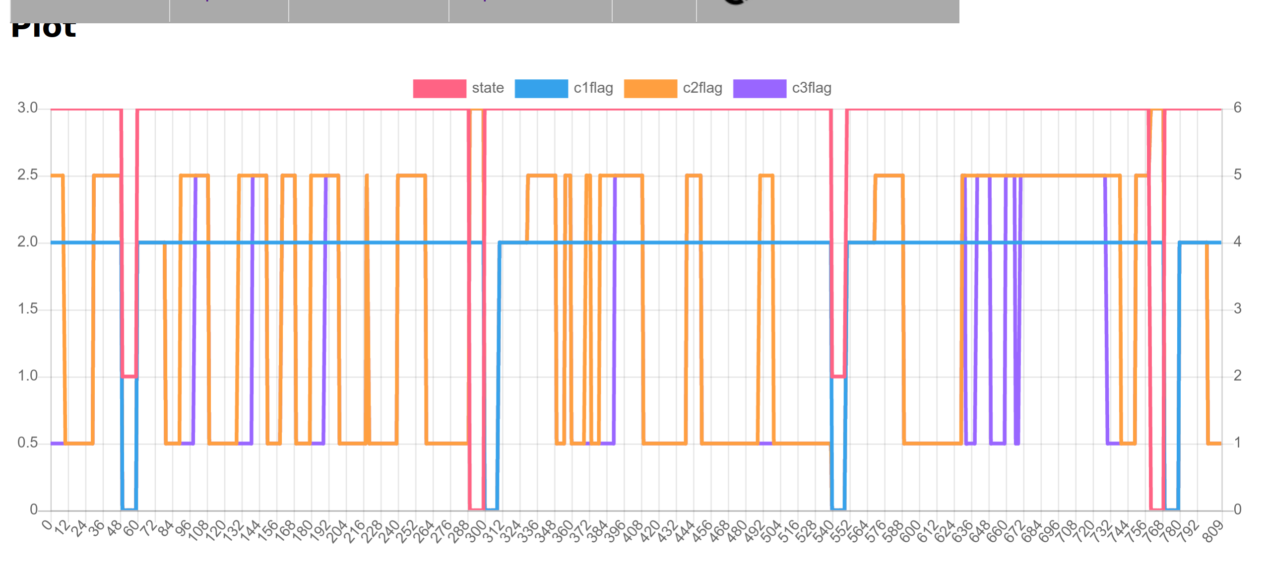

I have a charger here that is dropping out. It worked previously. (Fun fact, it is the X-rayed patient).
Some plots below, it looked like charger1 was dropping out, so I set chargena to 6 to run on 2+3 only, same behaviour. I can hear the EVSE clicking in and immediately dying, no current drawn on AC side.
modaclim is ramping up, then drops.
all chargers enabled, c1flag going to 0
only 2+3,c1flag still goes to 0?
I took a CAN log at the same time, did a quick grep and 0x109, 0x71B are in the log, so I am cautiously optimistic that CAN is not the issue.

janosch wrote: Fri Dec 10, 2021 11:34 am I have a charger here that is dropping out. It worked previously. (Fun fact, it is the X-rayed patient).
Screenshot from 2021-12-10 11-41-44.pngScreenshot from 2021-12-10 11-42-07.png
You’ve probably already checked this, but whenever I’ve suffered with an EVSE spasm, it was due to the charger ground not being clean enough.

Boxster EV wrote: Fri Dec 10, 2021 1:03 pm
janosch wrote: Fri Dec 10, 2021 11:34 am ... my charger drops out before drawing AC amps ...
Very good shout, I hadn't tightened the charge cable earth to the case properly. However, something else seems to be amiss. I took it off the CAN and just gave it its own 120 Ohm resistor too, but that didn't change the behaviour yet.
It will be one of those little ones I hope, but I can't find which one it is. Noticed udc is reading 0V! Investigating, although I measured 360V earlier with the multimeter at my measuring point. Maybe I will add a "common errors" section to the GEN2 charger wiki.
Edit: Found it! 20A PV fuse has died quietly in the loom. Regular automotive 20A fuse is still intact (makes sense that PV pops first), no bang though, and surprising that the charger went up and down on the EVSE like that.
