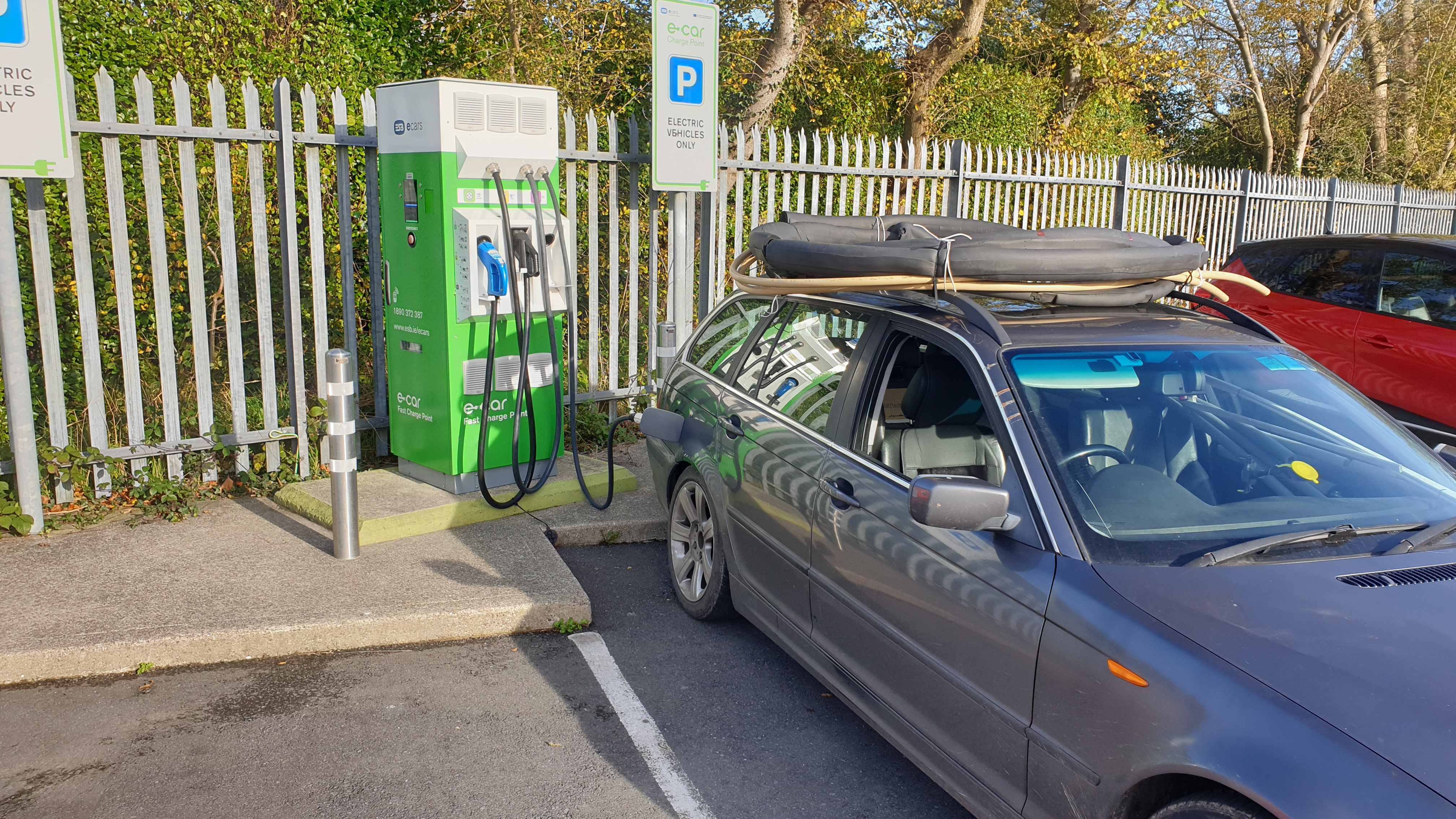

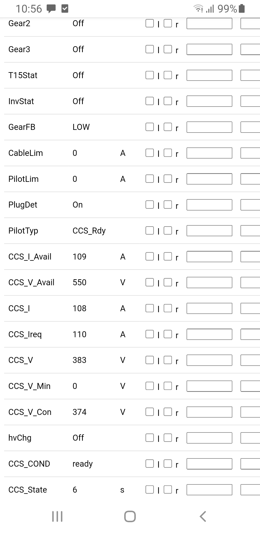

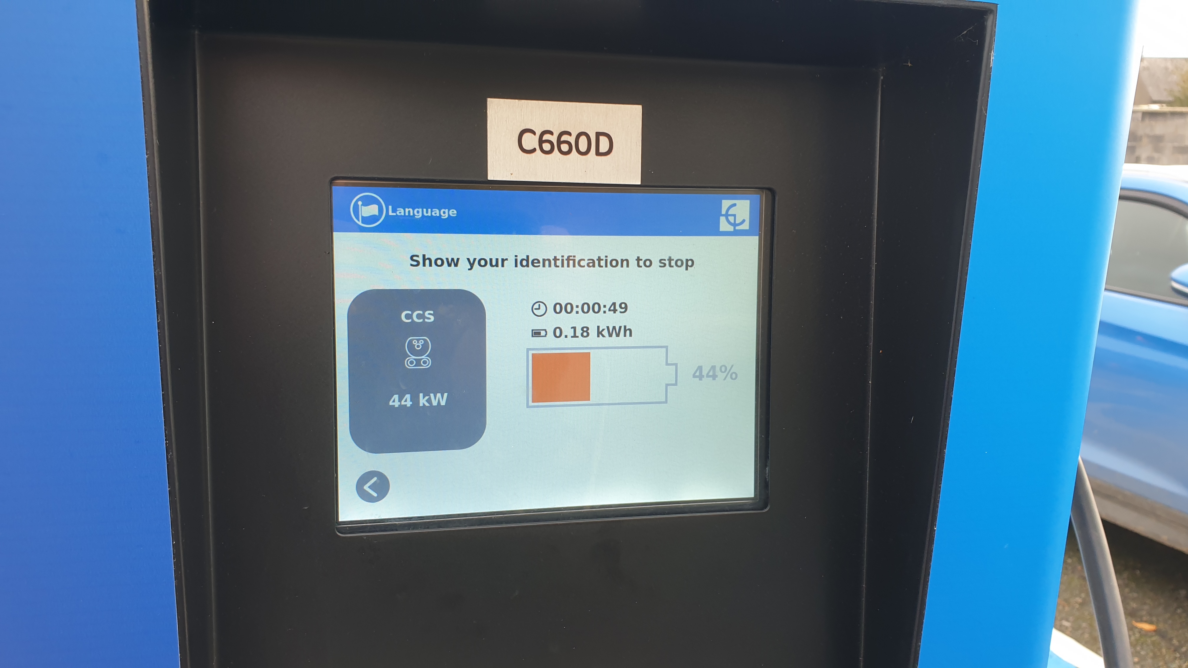

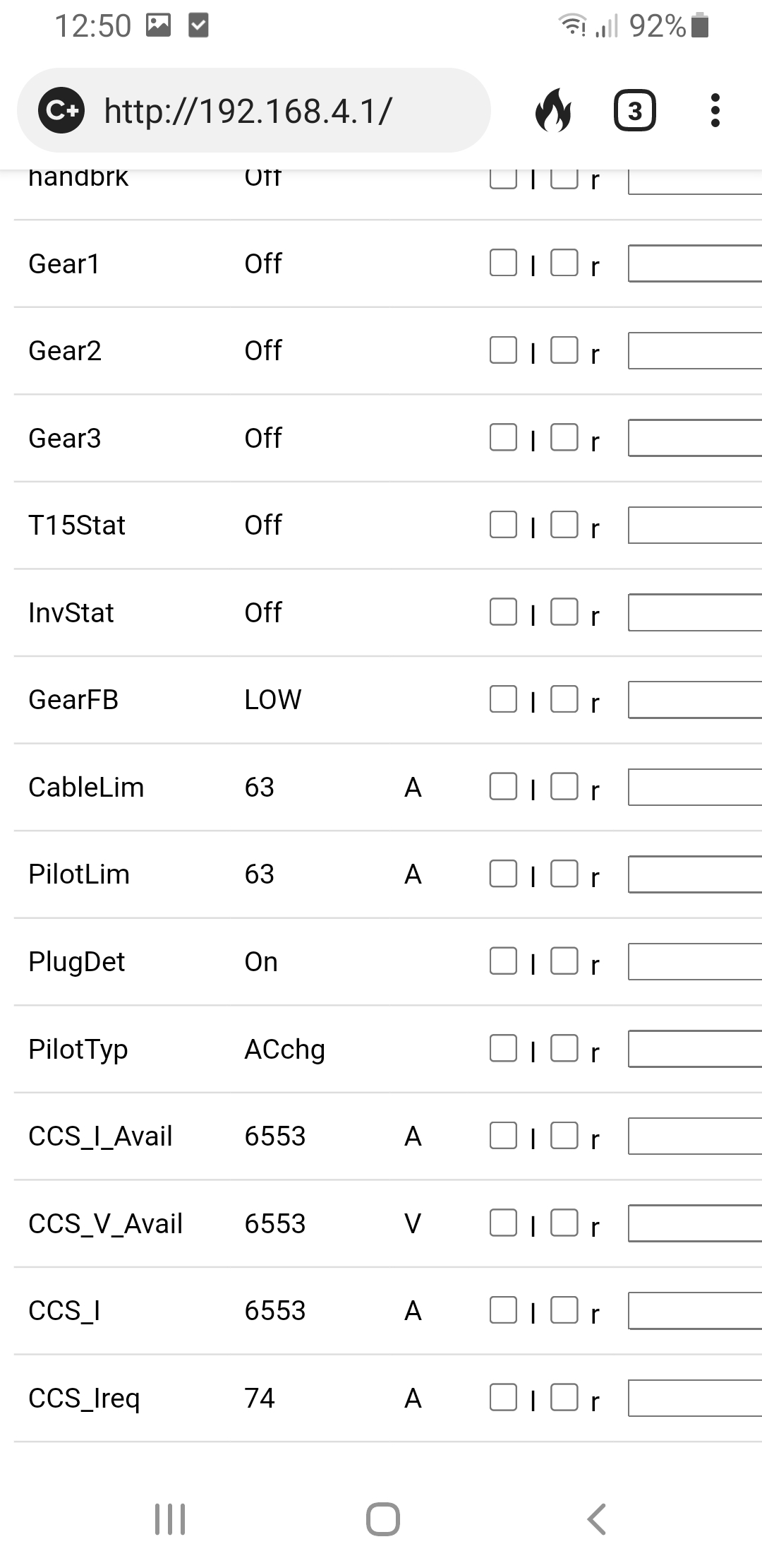

Okay. Today I had to go on a little adventure to pick up some plumbing parts for the new place. Pro tip : Strapping 30 metres of pex to the roof of your ev will certainly increase the ol' Wh/Mile figure! Anyway, rolled up to my first stop at a Circontrol station. Flawless. Next up a nice friendly Efacec that I have used in the past. I mean what could go wrong? I just tested on a different Efacec yesterday and all was well. I confidently swipe the card and plug in contemplating the potential lunch menu in the service station. Well guess what? It don't work! Mr.Efacec say "Plug the cable" which is Efacec for "Please start PLC comms" and times out. I can see on the vcu that we are getting pilot and prox detection just fine but PLC is not happening. Hmmmm...where have we seen this behaviour before ??
So onto AC at 10kw we go and as I enjoy a leisurely lunch thoughts as they tend turn to what could be wrong here? Could the CCS end of the station be broken? Unlikely as an ID4 was charging before me. Why would one Efacec work but not another. Why would Circontrol work but not this Efacec in the space of about 90 mins?
Then this qoute from CCSknowitall springs to mind : ironically, a lot of these SECCs use CAN to communicate back to the rest of the station components because it works so much better and PLC IS SO STUPID.
Now I have a question : What frequency band does CCS PLC use?
The only cars I have seen with CCS (Model 3 and i3) Have their charge controllers VERY near the charge port ....
