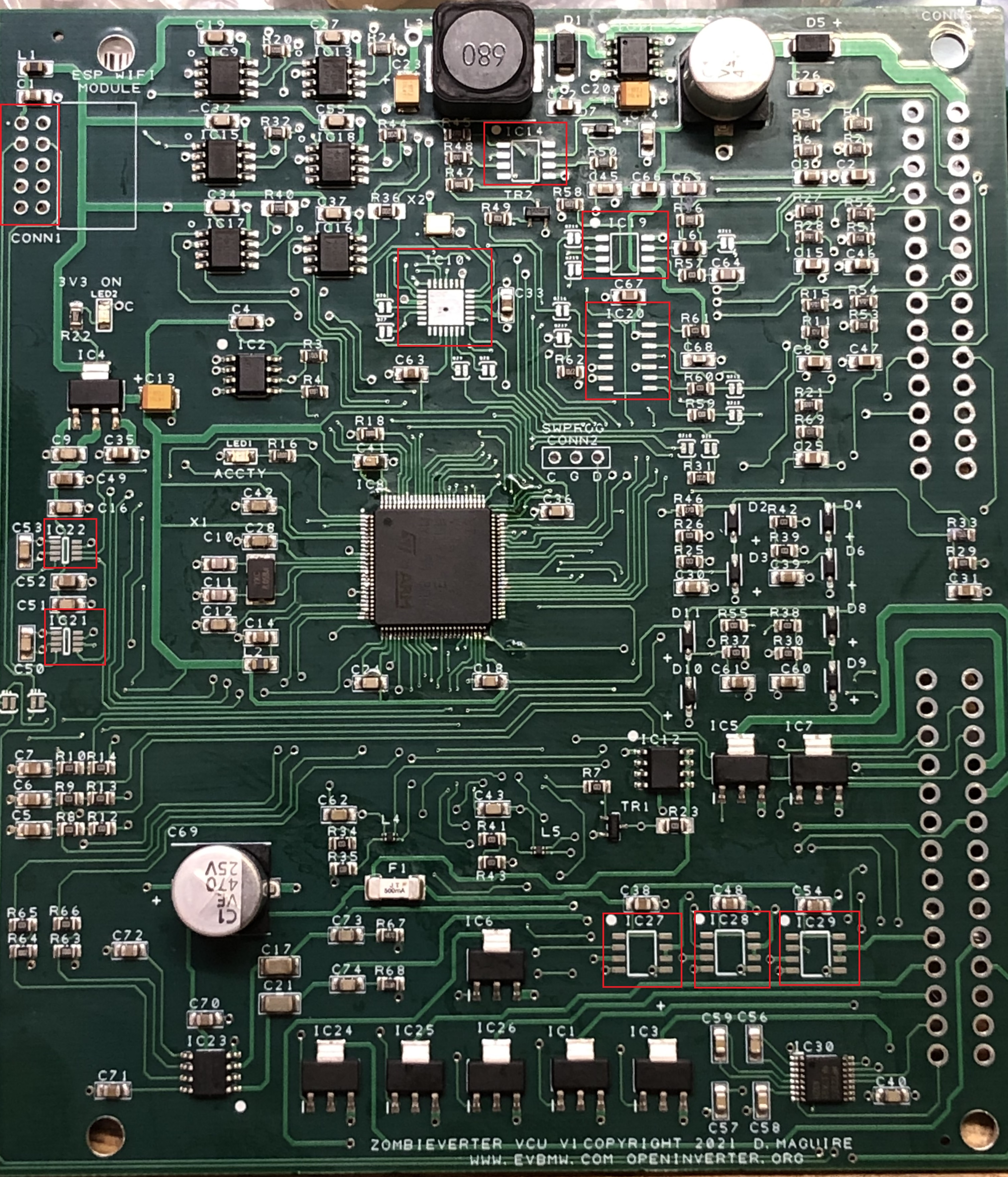

Second board arrived! A lot more parts to fit this time, and I have a couple of questions.
The unpopulated spaces on the PCB vs the parts listed on the schematic are:
IC10 = MCP25625T
IC14 = TJA1020
IC19 = NCV7356
IC20 = TJA1055T
IC21, 22 = AD5160
IC27, 28, 29 = FAN3122
The parts supplied are as below, they match apart from:
There is an extra 8 pin SOP which looks like the digi pot, but no place for it.
The remaining IC which should be IC14 is marked SN65185 as far as I can tell.
On the old board, the IC14 is marked "1020", so that seems correct.
The one supplied seems to be an RS-485 transceiver, so that is presumably a replacement for the LIN transceiver? Just checking..

The TJA1020 is a lin transciever that of course can't be obtained due to the chip shortage. There should be an MCP2004 supplied as a replacement. Now however it looks as if I can't even trust RS to put the right parts in my orders. Great. Looks like I gave you an extra digi pot by mistake.

No biggie, it's built, we can use without IC14 for now.
Posts: 4000
Been thanked: 1115 times
Re: ZombieVerter VCU Support
Yeah LIN is not used at the minute in software anyway. I'll send over an mcp2004 to you in a few days.
